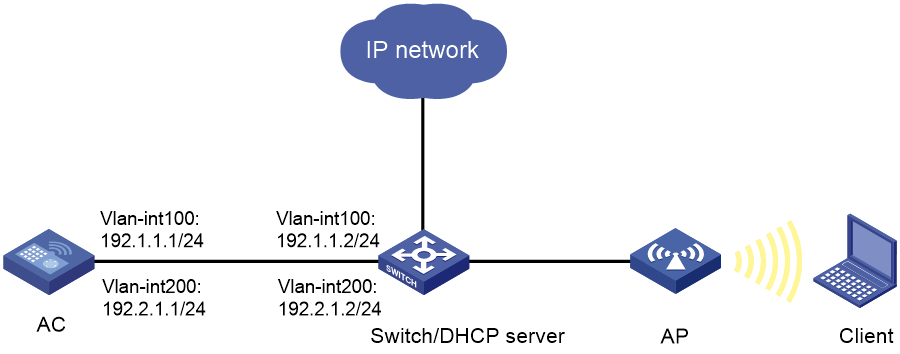

As shown in Figure 1, the switch acts as a DHCP server to assign IP addresses to the AP and client. The AP and AC establish CAPWAP tunnels in VLAN 100. The client accesses the wireless network in VLAN 200.
Configure the AC to use the default IPS policy for attack detection and prevention.
Figure 1 Network diagram
Use the actual serial ID of an AP to uniquely identify that AP.
