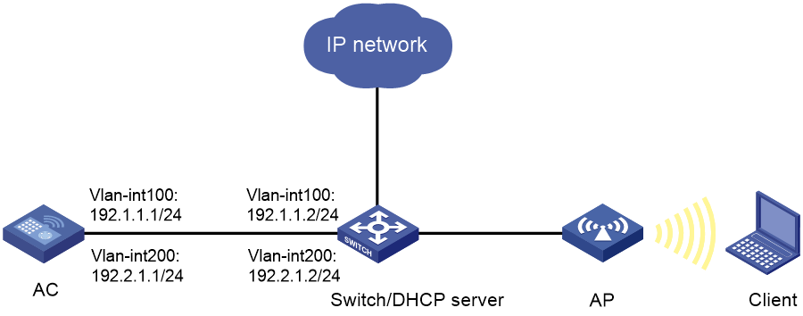

Example: Configuring URL filtering
As shown in Figure 1, the switch acts as a DHCP server to assign IP addresses to the AP and client. The AP and AC establish CAPWAP tunnels in VLAN 100. The client accesses the wireless network in VLAN 200.
Configure a URL filtering policy on the AC so the AC performs the following operations:
· Permits the client to access website http://www.sina.com on the IP network.
· Drops and logs packets that match the Pre-Game URL category.
· Drops and logs packets that do not match any filtering rule in the URL filtering policy.
Use the actual serial ID of an AP to uniquely identify that AP.
