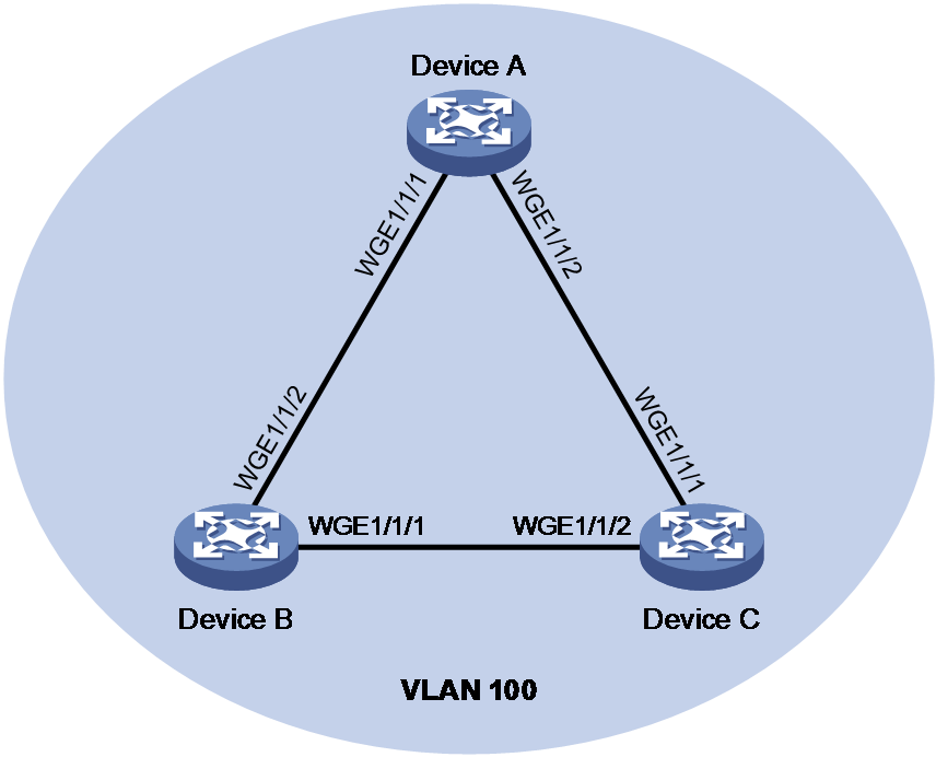

Example: Configuring basic loop detection functions
As shown in Figure 3, configure loop detection on Device A to meet the following requirements:
·     Device A generates a log as a notification.
·     Device A automatically shuts down the interface on which a loop is detected.
Figure 3 Network diagram
1.     Configure Device A:
# Create VLAN 100, and globally enable loop detection for the VLAN.
<DeviceA> system-view
[DeviceA] vlan 100
[DeviceA-vlan100] quit
[DeviceA] loopback-detection global enable vlan 100
# Configure Twenty-FiveGigE 1/1/11 and Twenty-FiveGigE 1/1/12 as trunk ports, and assign them to VLAN 100.
[DeviceA] interface twenty-fivegige 1/1/11
[DeviceA-Twenty-FiveGigE1/1/11] port link-type trunk
[DeviceA-Twenty-FiveGigE1/1/11] port trunk permit vlan 100
[DeviceA-Twenty-FiveGigE1/1/11] quit
[DeviceA] interface twenty-fivegige 1/1/12
[DeviceA-Twenty-FiveGigE1/1/12] port link-type trunk
[DeviceA-Twenty-FiveGigE1/1/12] port trunk permit vlan 100
[DeviceA-Twenty-FiveGigE1/1/12] quit
# Set the global loop protection action to shutdown.
[DeviceA] loopback-detection global action shutdown
# Set the loop detection interval to 35 seconds.
[DeviceA] loopback-detection interval-time 35
2.     Configure Device B:
# Create VLAN 100.
<DeviceB> system-view
[DeviceB] vlan 100
[DeviceB–vlan100] quit
[DeviceB] interface twenty-fivegige 1/1/11
[DeviceB-Twenty-FiveGigE1/1/11] port link-type trunk
[DeviceB-Twenty-FiveGigE1/1/11] port trunk permit vlan 100
[DeviceB-Twenty-FiveGigE1/1/11] quit
[DeviceB] interface twenty-fivegige 1/1/12
[DeviceB-Twenty-FiveGigE1/1/12] port link-type trunk
[DeviceB-Twenty-FiveGigE1/1/12] port trunk permit vlan 100
[DeviceB-Twenty-FiveGigE1/1/12] quit
3.     Configure Device C:
# Create VLAN 100.
<DeviceC> system-view
[DeviceC] vlan 100
[DeviceC–vlan100] quit
[DeviceC] interface twenty-fivegige 1/1/11
[DeviceC-Twenty-FiveGigE1/1/11] port link-type trunk
[DeviceC-Twenty-FiveGigE1/1/11] port trunk permit vlan 100
[DeviceC-Twenty-FiveGigE1/1/11] quit
[DeviceC] interface twenty-fivegige 1/1/12
[DeviceC-Twenty-FiveGigE1/1/12] port link-type trunk
[DeviceC-Twenty-FiveGigE1/1/12] port trunk permit vlan 100
[DeviceC-Twenty-FiveGigE1/1/12] quit
# View the system logs on devices, for example, Device A.
[DeviceA]
%Feb 24 15:04:29:663 2013 DeviceA LPDT/4/LPDT_LOOPED:  A loop was detected on Twenty-FiveGigE1/1/11.
%Feb 24 15:04:29:664 2013 DeviceA LPDT/4/LPDT_VLAN_LOOPED: A loop was detected on Twenty-FiveGigE1/1/11 in VLAN 100.
%Feb 24 15:04:29:667 2013 DeviceA LPDT/4/LPDT_LOOPED: A loop was detected on Twenty-FiveGigE1/1/12.
%Feb 24 15:04:29:668 2013 DeviceA LPDT/4/LPDT_VLAN_LOOPED: A loop was detected on Twenty-FiveGigE1/1/12 in VLAN 100.
%Feb 24 15:04:44:243 2013 DeviceA LPDT/5/LPDT_VLAN_RECOVERED: A loop was removed on Twenty-FiveGigE1/1/11 in VLAN 100.
%Feb 24 15:04:44:243 2013 DeviceA LPDT/5/LPDT_RECOVERED: All loops were removed on Twenty-FiveGigE1/1/11.
%Feb 24 15:04:44:248 2013 DeviceA LPDT/5/LPDT_VLAN_RECOVERED: A loop was removed on Twenty-FiveGigE1/1/12 in VLAN 100.
%Feb 24 15:04:44:248 2013 DeviceA LPDT/5/LPDT_RECOVERED: All loops were removed on Twenty-FiveGigE1/1/12
The output shows the following information:
·     Device A detected loops on Twenty-FiveGigE 1/1/11 and Twenty-FiveGigE 1/1/12 within a loop detection interval.
·     Loops on  Twenty-FiveGigE 1/1/11 and Twenty-FiveGigE 1/1/12 were removed.
# Use the display loopback-detection command to display the loop detection configuration and status on devices, for example, Device A.
[DeviceA] display loopback-detection
Loop detection is enabled.
Global loop detection interval is 35 second(s).
Loop is detected on following interfaces:
* indicates the loop protection action was not triggered because of low priority.
# indicates the loop protection action failed.
  Interface                      Action mode     VLANs/VSI
      Shutdown        100
  Twenty-FiveGigE1/1/12      Shutdown        100
The output shows that the device has removed the loops from Twenty-FiveGigE 1/1/11 and Twenty-FiveGigE 1/1/12 according to the shutdown action.
# Display the status of Twenty-FiveGigE 1/1/11 on devices, for example, Device A.
[DeviceA] display interface twenty-fivegige 1/1/11
Twenty-FiveGigE1/1/11 current state: DOWN (Loopback detection down)
The output shows that Twenty-FiveGigE 1/1/11 is already shut down by the loop detection module.
# Display the status of Twenty-FiveGigE 1/1/12 on devices, for example, Device A.
[DeviceA] display interface twenty-fivegige 1/1/12
Twenty-FiveGigE1/1/12 current state: DOWN (Loopback detection down)
The output shows that Twenty-FiveGigE 1/1/12 is already shut down by the loop detection module.
