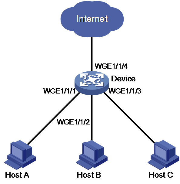

As shown in Figure 1:
·     LAN users Host A, Host B, and Host C are connected to Twenty-FiveGigE 1/1/1, Twenty-FiveGigE 1/1/2, and Twenty-FiveGigE 1/1/3 on the device, respectively.
·     The device connects to the Internet through Twenty-FiveGigE 1/1/4.
Configure the device to provide Internet access for the hosts, and isolate them from one another at Layer 2.
Figure 1 Network diagram

The output shows that Twenty-FiveGigE 1/1/1, Twenty-FiveGigE 1/1/2, and Twenty-FiveGigE 1/1/3 are assigned to isolation group 2. As a result, Host A, Host B, and Host C are isolated from one another at layer 2.
