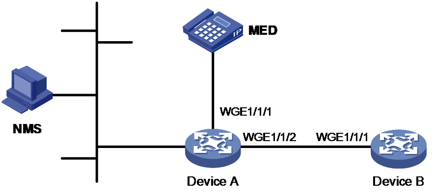

Configuring CDP compatibility
To enable your device to exchange information with a directly connected Cisco device that supports only CDP, you must enable CDP compatibility.
CDP compatibility enables your device to receive and recognize CDP packets from the neighboring CDP device and send CDP packets to the neighboring device. The CDP packets sent to the neighboring CDP device carry the following information:
· Device ID.
· ID of the port connecting to the neighboring device.
· Port IP address.
· TTL.
The port IP address is the primary IP address of a VLAN interface in up state. The VLAN ID of the VLAN interface must be the lowest among the VLANs permitted on the port. If no VLAN interfaces of the permitted VLANs are assigned an IP address or all VLAN interfaces are down, no port IP address will be advertised.
You can view the neighboring CDP device information that can be recognized by the device in the output of the display lldp neighbor-information command. For more information about the display lldp neighbor-information command, see LLDP commands in Layer 2—LAN Switching Command Reference.
To make your device work with Cisco IP phones, you must enable CDP compatibility.
If your LLDP-enabled device cannot recognize CDP packets, it does not respond to the requests of Cisco IP phones for the voice VLAN ID configured on the device. As a result, a requesting Cisco IP phone sends voice traffic without any tag to your device. Your device cannot differentiate the voice traffic from other types of traffic.
For more information about voice VLANs, see "Configuring voice VLANs."
When the device is connected to a Cisco IP phone that has a host attached to its data port, the host must access the network through the Cisco IP phone. If the data port goes down, the IP phone will send a CDP packet to the device so the device can log out the user.
CDP-compatible LLDP operates in one of the following modes:
· TxRx—CDP packets can be transmitted and received.
· Rx—CDP packets can be received but cannot be transmitted.
· Disable—CDP packets cannot be transmitted or received.
When you configure CDP compatibility for LLDP, follow these restrictions and guidelines:
· To make CDP-compatible LLDP take effect on a port, follow these steps:
a. Enable CDP-compatible LLDP globally.
b. Configure CDP-compatible LLDP to operate in TxRx mode on the port.
· The maximum TTL value that CDP allows is 255 seconds. To make CDP-compatible LLDP work correctly with Cisco IP phones, configure the LLDP frame transmission interval to be no more than 1/3 of the TTL value.

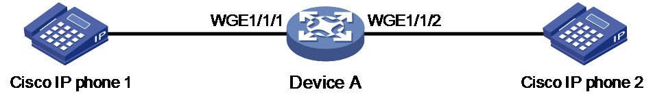

Example: Configuring CDP-compatible LLDP
As shown in Figure 6, Twenty-FiveGigE 1/1/1 and Twenty-FiveGigE 1/1/2 of Switch A are each connected to a Cisco IP phone, which sends tagged voice traffic.
Configure voice VLAN 2 on Switch A. Enable CDP compatibility of LLDP on Switch A to allow the Cisco IP phones to automatically configure the voice VLAN. The voice VLAN feature performs the following operations:
· Confines the voice traffic to the voice VLAN.
· Isolates the voice traffic from other types of traffic.
1. Configure a voice VLAN on Switch A:
# Create VLAN 2.
<SwitchA> system-view
[SwitchA] vlan 2
[SwitchA-vlan2] quit
# Set the link type of Twenty-FiveGigE 1/1/1 and Twenty-FiveGigE 1/1/2 to trunk, and enable voice VLAN on them.
[SwitchA] interface twenty-fivegige 1/1/1
[SwitchA-Twenty-FiveGigE1/1/1] port link-type trunk
[SwitchA-Twenty-FiveGigE1/1/1] voice-vlan 2 enable
[SwitchA-Twenty-FiveGigE1/1/1] quit
[SwitchA] interface twenty-fivegige 1/1/2
[SwitchA-Twenty-FiveGigE1/1/2] port link-type trunk
[SwitchA-Twenty-FiveGigE1/1/2] voice-vlan 2 enable
[SwitchA-Twenty-FiveGigE1/1/2] quit
2. Configure CDP-compatible LLDP on Switch A:
# Enable LLDP globally, and enable CDP compatibility globally.
[SwitchA] lldp global enable
[SwitchA] lldp compliance cdp
# Enable LLDP on Twenty-FiveGigE 1/1/1. By default, LLDP is enabled on ports.
[SwitchA-Twenty-FiveGigE1/1/1] lldp enable
# Configure LLDP to operate in TxRx mode on Twenty-FiveGigE 1/1/1.
[SwitchA-Twenty-FiveGigE1/1/1] lldp admin-status txrx
# Configure CDP-compatible LLDP to operate in TxRx mode on Twenty-FiveGigE 1/1/1.
[SwitchA-Twenty-FiveGigE1/1/1] lldp compliance admin-status cdp txrx
# Enable LLDP on Twenty-FiveGigE 1/1/2. By default, LLDP is enabled on ports.
[SwitchA-Twenty-FiveGigE1/1/2] lldp enable
# Configure LLDP to operate in TxRx mode on Twenty-FiveGigE 1/1/2.
[SwitchA-Twenty-FiveGigE1/1/2] lldp admin-status txrx
# Configure CDP-compatible LLDP to operate in TxRx mode on Twenty-FiveGigE 1/1/2.
[SwitchA-Twenty-FiveGigE1/1/2] lldp compliance admin-status cdp txrx
# Verify that Switch A has completed the following operations:
· Discovering the IP phones connected to Twenty-FiveGigE 1/1/1 and Twenty-FiveGigE 1/1/2.
· Obtaining IP phone information.
[SwitchA] display lldp neighbor-information
CDP neighbor-information of port 1[Twenty-FiveGigE1/1/1]:
LLDP agent nearest-bridge:
CDP neighbor index : 1
Chassis ID : SEP00141CBCDBFE
Port ID : Port 1
CDP neighbor-information of port 2[Twenty-FiveGigE1/1/2]:
CDP neighbor index : 2
Chassis ID : SEP00141CBCDBFF
Port ID : Port 1

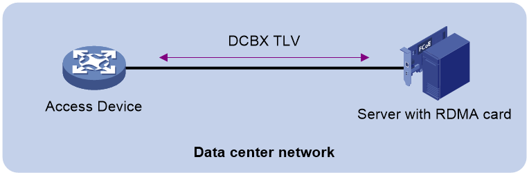

DCBX application scenario
Figure 7 DCBX application scenario
DCBX enables lossless packet transmission on DCE networks.
As shown in Figure 7, DCBX applies to an RoCE-based data center network, and operates on an access switch. DCBX enables the switch to control the server or storage adapter, and simplifies the configuration and guarantees configuration consistency. DCBX extends LLDP by using the IEEE 802.1 organizationally specific TLVs (DCBX TLVs) to transmit DCBX data, including:
· In DCBX Rev 1.00 and DCBX Rev 1.01:
¡ Application Protocol (APP).
¡ Enhanced Transmission Selection (ETS).
¡ Priority-based Flow Control (PFC).
· In IEEE Std 802.1Qaz-2011:
¡ ETS Configuration.
¡ ETS Recommendation.
¡ PFC.
¡ APP.
H3C devices can send these types of DCBX information to a server or storage adapter. However, H3C devices cannot accept these types of DCBX information.

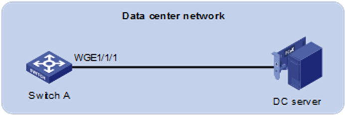

DCBX configuration examples
Example: Configuring DCBX
As shown in Figure 8, Twenty-FiveGigE 1/1/1 of the access switch (Switch A) connects to the RDMA adapter of the data center server (DC server).
Configure Switch A to implement lossless RoCE frame transmission to DC server.
NOTE: In this example, both Switch A and the DC server support DCBX Rev 1.01. |
1. Enable LLDP and DCBX TLV advertising:
# Enable LLDP globally.
# Enable LLDP and DCBX TLV advertising on Twenty-FiveGigE 1/1/1.
[SwitchA-Twenty-FiveGigE1/1/1] lldp tlv-enable dot1-tlv dcbx
2. Set the DCBX version to Rev. 1.01 on Twenty-FiveGigE 1/1/1.
[SwitchA-Twenty-FiveGigE1/1/1] dcbx version rev101
3. Configure ETS parameters:
# Enable byte-count WRR queuing on Twenty-FiveGigE 1/1/1, and configure queue 3 on the interface to use SP queuing.
[SwitchA-Twenty-FiveGigE1/1/1] qos wrr byte-count
[SwitchA-Twenty-FiveGigE1/1/1] qos wrr 3 group sp
4. Configure PFC:
# Enable PFC in auto mode on Twenty-FiveGigE 1/1/1.
[SwitchA-Twenty-FiveGigE1/1/1] priority-flow-control auto
# Enable PFC for 802.1 priority 3.
[SwitchA-Twenty-FiveGigE1/1/1] priority-flow-control no-drop dot1p 3
No packet loss is detected on the server.
