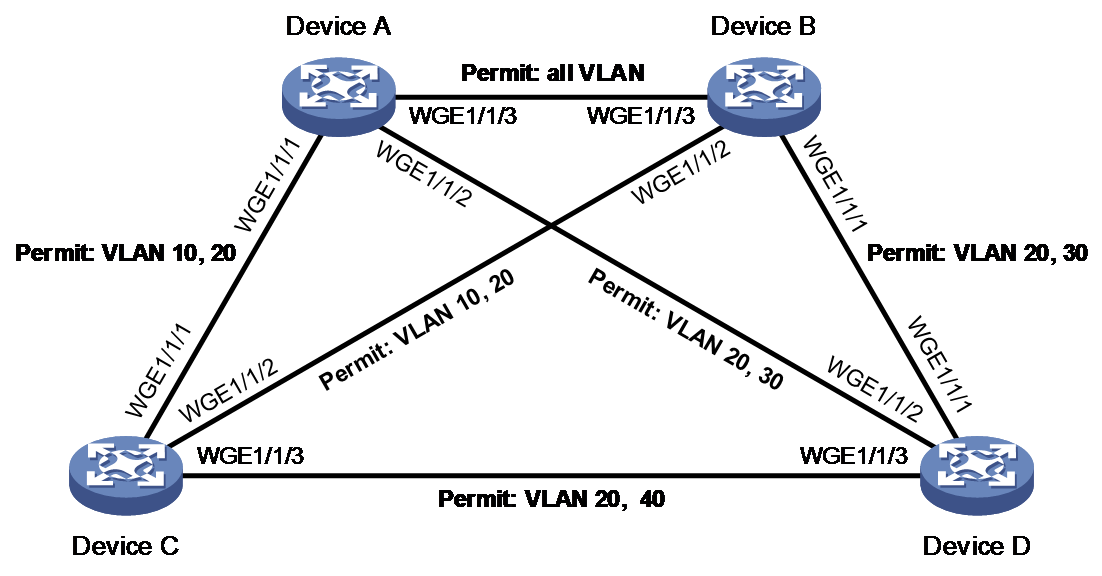

Figure 9 shows a switched network that contains four MST regions, each MST region containing four MSTP devices. Figure 10 shows the networking topology of MST region 3.
Figure 9 Basic concepts in MSTP
Figure 10 Network diagram and topology of MST region 3

In Figure 10, MST region 3 contains three MSTIs, MSTI 1, MSTI 2, and MSTI 0.
VLAN-to-instance mapping table
As an attribute of an MST region, the VLAN-to-instance mapping table describes the mapping relationships between VLANs and MSTIs.
In Figure 10, the VLAN-to-instance mapping table of MST region 3 is as follows:
· VLAN 1 to MSTI 1.
· VLAN 2 and VLAN 3 to MSTI 2.
· Other VLANs to MSTI 0.

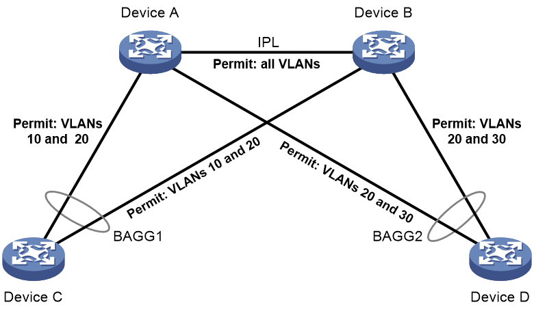

A port can play different roles in different MSTIs. As shown in Figure 11, an MST region contains Device A, Device B, Device C, and Device D. Port A1 and port A2 of Device A connect to the common root bridge. Port B2 and Port B3 of Device B form a loop. Port C3 and Port C4 of Device C connect to other MST regions. Port D3 of Device D directly connects to a host.
MSTP calculation involves the following port roles:
· Root port—Forwards data for a non-root bridge to the root bridge. The root bridge does not have any root port.
· Designated port—Forwards data to the downstream network segment or device.
· Alternate port—Acts as the backup port for a root port or master port. When the root port or master port is blocked, the alternate port takes over.
· Backup port—Acts as the backup port of a designated port. When the designated port is invalid, the backup port becomes the new designated port. A loop occurs when two ports of the same spanning tree device are connected, so the device blocks one of the ports. The blocked port acts as the backup.
· Edge port—Directly connects to a user host rather than a network device or network segment.
· Master port—Acts as a port on the shortest path from the local MST region to the common root bridge. The master port is not always located on the regional root. It is a root port on the IST or CIST and still a master port on the other MSTIs.
· Boundary port—Connects an MST region to another MST region or to an STP/RSTP-running device. In MSTP calculation, a boundary port's role on an MSTI is consistent with its role on the CIST. However, that is not true with master ports. A master port on MSTIs is a root port on the CIST.

P/A transition
The P/A transition enables a designated port to rapidly transit to the forwarding state after a handshake with its peer. The P/A transition applies only to point-to-point links.
P/A transition for RSTP and PVST
In RSTP or PVST, the ports on a new link or recovered link are designated ports in blocking state. When one of the designated ports transits to the discarding or learning state, it sets the proposal flag in its BPDU. Its peer bridge receives the BPDU and determines whether the receiving port is the root port. If it is the root port, the bridge blocks the other ports except edge ports. The bridge then replies an agreement BPDU to the designated port. The designated port immediately transits to the forwarding state upon receiving the agreement BPDU. If the designated port does not receive the agreement BPDU, it waits for twice the forward delay to transit to the forwarding state.
As shown in Figure 14, the P/A transition operates as follows:
1. Device A sends a proposal BPDU to Device B through Port A1.
2. Device B receives the proposal BPDU on Port B2. Port B2 is elected as the root port.
3. Device B blocks its designated port Port B1 and alternate port Port B3 to eliminate loops.
4. The root port Port B2 transits to the forwarding state and sends an agreement BPDU to Device A.
5. The designated port Port A1 on Device A immediately transits to the forwarding state after receiving the agreement BPDU.
Figure 14 P/A transition for RSTP and PVST
P/A transition for MSTP
In MSTP, an upstream bridge sets both the proposal and agreement flags in its BPDU. If a downstream bridge receives the BPDU and its receiving port is elected as the root port, the bridge blocks all the other ports except edge ports. The downstream bridge then replies an agreement BPDU to the upstream bridge. The upstream port immediately transits to the forwarding state upon receiving the agreement BPDU. If the upstream port does not receive the agreement BPDU, it waits for twice the forward delay to transit to the forwarding state.
As shown in Figure 15, the P/A transition operates as follows:
1. Device A sets the proposal and agreement flags in its BPDU and sends it to Device B through Port A1.
2. Device B receives the BPDU. Port B1 of Device B is elected as the root port.
3. Device B then blocks all its ports except the edge ports.
4. The root port Port B1 of Device B transits to the forwarding state and sends an agreement BPDU to Device A.
5. Port A1 of Device A immediately transits to the forwarding state upon receiving the agreement BPDU.
Figure 15 P/A transition for MSTP

Configuring TC Snooping
As shown in Figure 18, an IRF fabric connects to two user networks through double links.
· Device A and Device B form the IRF fabric.
· The spanning tree feature is disabled on Device A and Device B and enabled on all devices in user network 1 and user network 2.
· The IRF fabric transparently transmits BPDUs for both user networks and is not involved in the calculation of spanning trees.
When the network topology changes, it takes time for the IRF fabric to update its MAC address table and ARP table. During this period, traffic in the network might be interrupted.
Figure 18 TC Snooping application scenario
To avoid traffic interruption, you can enable TC Snooping on the IRF fabric. After receiving a TC-BPDU through a port, the IRF fabric updates MAC address table and ARP table entries associated with the port's VLAN. In this way, TC Snooping prevents topology change from interrupting traffic forwarding in the network. For more information about the MAC address table and the ARP table, see "Configuring the MAC address table" and Layer 3—IP Services Configuration Guide.
· TC Snooping and the spanning tree feature are mutually exclusive. You must globally disable the spanning tree feature before enabling TC Snooping.
· The priority of BPDU tunneling is higher than that of TC Snooping. When BPDU tunneling is enabled on a port, the TC Snooping feature does not take effect on the port.
· TC Snooping does not support the PVST mode.

Disabling dispute guard
Dispute guard can be triggered by unidirectional link failures. If an upstream port receives inferior BPDUs from a downstream designated port in forwarding or learning state because of a unidirectional link failure, a loop appears. Dispute guard blocks the upstream designated port to prevent the loop.
As shown in Figure 19, in normal conditions, the spanning tree calculation result is as follows:
· Device A is the root bridge, and Port A1 is a designated port.
· Port B1 is blocked.
When the link between Port A1 and Port B1 fails in the direction of Port A1 to Port B1 and becomes unidirectional, the following events occur:
1. Port A1 can only receive BPDUs and cannot send BPDUs to Port B1.

As shown in Figure 22, all devices on the network are in the same MST region. Device A and Device B work at the distribution layer. Device C and Device D work at the access layer.
Configure MSTP so that frames of different VLANs are forwarded along different spanning trees.
· VLAN 10 frames are forwarded along MSTI 1.
· VLAN 30 frames are forwarded along MSTI 3.
· VLAN 40 frames are forwarded along MSTI 4.
· VLAN 20 frames are forwarded along MSTI 0.
VLAN 10 and VLAN 30 are terminated on the distribution layer devices, and VLAN 40 is terminated on the access layer devices. The root bridges of MSTI 1 and MSTI 3 are Device A and Device B, respectively, and the root bridge of MSTI 4 is Device C.

As shown in Figure 24, Device A and Device B work at the distribution layer, and Device C and Device D work at the access layer.
Configure PVST to meet the following requirements:
· Frames of a VLAN are forwarded along the spanning trees of the VLAN.
· VLAN 10, VLAN 20, and VLAN 30 are terminated on the distribution layer devices, and VLAN 40 is terminated on the access layer devices.
· The root bridge of VLAN 10 and VLAN 20 is Device A.
· The root bridge of VLAN 30 is Device B.
· The root bridge of VLAN 40 is Device C.

[DeviceD] stp mode pvst
# Enable the spanning tree feature globally and in VLAN 20, VLAN 30, and VLAN 40.
[DeviceD] stp global enable
[DeviceD] stp vlan 20 30 40 enable
When the network is stable, you can use the display stp brief command to display brief spanning tree information on each device.
# Display brief spanning tree information on Device A.
[DeviceA] display stp brief
VLAN ID Port Role STP State Protection
10 Twenty-FiveGigE1/1/11 DESI FORWARDING NONE
10 Twenty-FiveGigE1/1/13 DESI FORWARDING NONE
20 Twenty-FiveGigE1/1/11 DESI FORWARDING NONE
20 Twenty-FiveGigE1/1/12 DESI FORWARDING NONE
20 Twenty-FiveGigE1/1/13 DESI FORWARDING NONE
30 Twenty-FiveGigE1/1/12 DESI FORWARDING NONE
30 Twenty-FiveGigE1/1/13 ROOT FORWARDING NONE
# Display brief spanning tree information on Device B.
[DeviceB] display stp brief
10 Twenty-FiveGigE1/1/12 DESI FORWARDING NONE
10 Twenty-FiveGigE1/1/13 ROOT FORWARDING NONE
20 Twenty-FiveGigE1/1/13 ROOT FORWARDING NONE
30 Twenty-FiveGigE1/1/11 DESI FORWARDING NONE
30 Twenty-FiveGigE1/1/13 DESI FORWARDING NONE
# Display brief spanning tree information on Device C.
[DeviceC] display stp brief
10 Twenty-FiveGigE1/1/11 ROOT FORWARDING NONE
10 Twenty-FiveGigE1/1/12 ALTE DISCARDING NONE
20 Twenty-FiveGigE1/1/11 ROOT FORWARDING NONE
20 Twenty-FiveGigE1/1/12 ALTE DISCARDING NONE
40 Twenty-FiveGigE1/1/13 DESI FORWARDING NONE
# Display brief spanning tree information on Device D.
[DeviceD] display stp brief
20 Twenty-FiveGigE1/1/11 ALTE DISCARDING NONE
20 Twenty-FiveGigE1/1/12 ROOT FORWARDING NONE
20 Twenty-FiveGigE1/1/13 ALTE DISCARDING NONE
30 Twenty-FiveGigE1/1/11 ROOT FORWARDING NONE
30 Twenty-FiveGigE1/1/12 ALTE DISCARDING NONE
40 Twenty-FiveGigE1/1/13 ROOT FORWARDING NONE
Based on the output, you can draw a topology for each VLAN spanning tree, as shown in Figure 25.
Figure 25 VLAN spanning tree topologies
Example: Configuring DRNI with PVST
As shown in Figure 26, Device A and Device B work at the distribution layer, and Device C and Device D work at the access layer.
Configure DRNI on Device A and Device B. In the DR system, Device A is the primary DR device, and Device B is the secondary DR device.
Configure PVST on the devices to meet the following requirements:
· VLAN 10, VLAN 20, and VLAN 30 are terminated on the distribution layer devices.
· The root bridge of VLAN 10, VLAN 20, and VLAN 30 is the DR system formed by Device A and Device B.
NOTE: · As a best practice, do not connect ports on Device A and Device B that have the same port ID with each other, for example Layer 2 aggregate ports. Otherwise, when Device A and Device B communicate through the link, the spanning tree protocol determines that the device receives its own BPDUs. Loop guard will block the link, though spanning tree features are not affected. · You can view port IDs of interfaces on the device by using the display stp interface command. · The preceding restrictions do not apply to IPPs and their member ports. |
1. Configure VLANs and VLAN member ports. (Details not shown.)
¡ Create VLAN 10, VLAN 20, and VLAN 30 on both Device A and Device B.
¡ Create VLAN 10, and VLAN 20 on Device C.
¡ Create VLAN 20, and VLAN 30 on Device D.
¡ Configure the ports on these devices as trunk ports and assign them to related VLANs.
2. Configure DRNI on Device A and Device B. (Details not shown.)
For more information about DRNI, see "Configuring DRNI."
3. Configure Device A:
# Set the spanning tree mode to PVST.
<DeviceA> system-view
[DeviceA] stp mode pvst
# Configure the device as the root bridge of VLAN 10 and VLAN 20.
[DeviceA] stp vlan 10 20 root primary
# Enable the spanning tree feature globally and in VLAN 10, VLAN 20, and VLAN 30.
[DeviceA] stp global enable
[DeviceA] stp vlan 10 20 30 enable
4. Configure Device B in the same way Device A is configured. (Details not shown.)
5. Configure Device C:
<DeviceC> system-view
[DeviceC] stp mode pvst
# Enable the spanning tree feature globally and in VLAN 10, and VLAN 20.
[DeviceC] stp global enable
[DeviceC] stp vlan 10 20 enable
6. Configure Device D:
<DeviceD> system-view
# Enable the spanning tree feature globally and in VLAN 20, and VLAN 30.
[DeviceD] stp vlan 20 30 enable
# Display brief spanning tree information of the DR system on the primary DR device, Device A.
10 Bridge-Aggregation1 DESI FORWARDING NONE
20 Bridge-Aggregation1 DESI FORWARDING NONE
20 Bridge-Aggregation2 DESI FORWARDING NONE
30 Bridge-Aggregation2 DESI FORWARDING NONE
10 Bridge-Aggregation1 ROOT FORWARDING NONE
20 Bridge-Aggregation1 ROOT FORWARDING NONE
20 Bridge-Aggregation2 ROOT FORWARDING NONE
30 Bridge-Aggregation2 ROOT FORWARDING NONE
