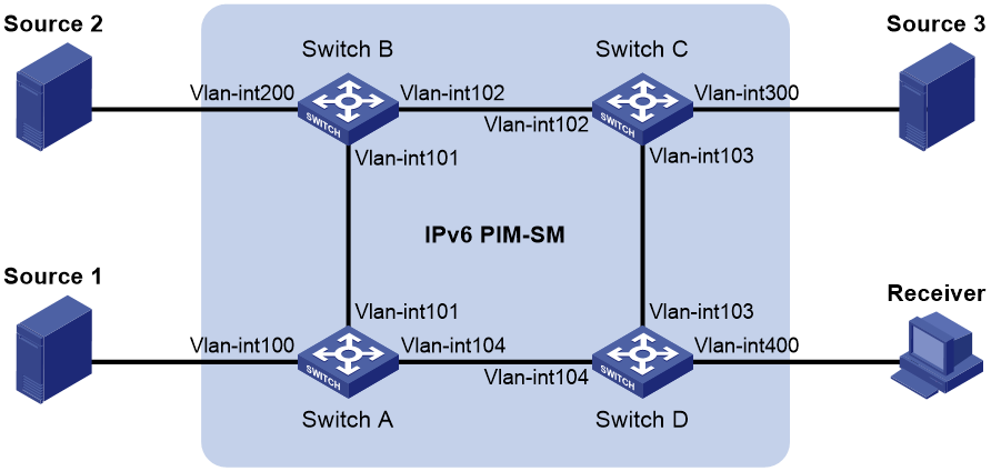

Figure 1 MLD queries and reports
As shown in Figure 1, Host B and Host C want to receive the IPv6 multicast data addressed to IPv6 multicast group G1. Host A wants to receive the IPv6 multicast data addressed to G2. The following process describes how the hosts join the IPv6 multicast groups and how the MLD querier (Device B in Figure 1) maintains the IPv6 multicast group memberships:
1.     The hosts send unsolicited MLD reports to the IPv6 multicast groups they want to join without having to wait for the MLD queries.
2.     The MLD querier periodically multicasts MLD queries (with the destination address FF02::1) to all hosts and devices on the local subnet.
3.     After receiving a query, the host whose report delay timer expires first sends an MLD report to the IPv6 multicast group G1 to announce its membership for G1. In this example, Host B sends the report. After hearing the report from Host B, Host C, which is on the same subnet as Host B, suppresses its own report for G1.
Because the MLD devices already know that G1 has a minimum of one member, other members do not need to report their memberships. This mechanism, known as the host MLD report suppression, helps reduce traffic on the local subnet.
4.     At the same time, because Host A is interested in G2, it sends a report to the IPv6 multicast group G2.
5.     Through the query/report process, the MLD devices determine that G1 and G2 have members on the local subnet. The IPv6 multicast routing protocol (for example, IPv6 PIM) that is running on the devices generates (*, G1) and (*, G2) multicast forwarding entries. These entries are the basis for subsequent IPv6 multicast forwarding. The asterisk (*) represents any IPv6 multicast source.
6.     When the IPv6 multicast data addressed to G1 or G2 reaches an MLD device, the device looks up the IPv6 multicast forwarding table. Based on the (*, G1) and (*, G2) entries, the device forwards the IPv6 multicast data to the local subnet. Then, the receivers on the subnet receive the data.

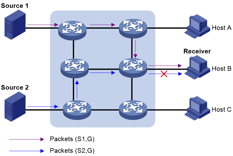

As shown in Figure 2, the network has two IPv6 multicast sources, Source 1 (S1) and Source 2 (S2). Both of the sources can send IPv6 multicast data to IPv6 multicast group G. Host B wants to receive IPv6 multicast data addressed to G from Source 1 but not from Source 2.
Figure 2 Flow paths of multicast-address-and-source-specific multicast traffic
In MLDv1, Host B cannot select IPv6 multicast sources when it joins IPv6 multicast group G. The IPv6 multicast streams from both Source 1 and Source 2 flow to Host B whether it needs them or not.
In MLDv2, Host B can explicitly express its interest in IPv6 multicast data destined to G from Source 1 but not from Source 2. Then, Host B receives only IPv6 multicast data from Source 1.

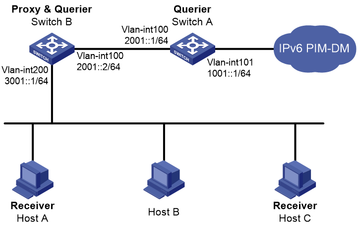

Figure 3 Network diagram
As shown in Figure 3, Host A and Host B on the IPv6 SSM network run MLDv1, and Host C runs MLDv2. To provide the SSM service for Host A and Host B, you must configure the MLD SSM mapping feature on Device A.
After MLD SSM mappings are configured, Device A checks the IPv6 multicast group address G carried in the message, and performs the following operations:
·     If G is not in the IPv6 SSM group range, Device A provides the ASM service.
·     If G is in the IPv6 SSM group range but does not match any MLD SSM mapping, Device A drops the report.
·     If G is in the IPv6 SSM group range and matches MLD SSM mappings, Device A translates (*, G) in the report to (G, INCLUDE, (S1, S2...)) to provide SSM services.
The MLD SSM mapping feature does not process MLDv2 reports.
For more information about the IPv6 SSM group ranges, see "IPv6 PIM overview" and "Configuring IPv6 PIM."

Example: Configuring MLD SSM mapping
As shown in Figure 6:
·     OSPFv3 runs on the network.
·     The IPv6 PIM-SM domain uses the SSM model for IPv6 multicast delivery. The SSM group range is FF3E::/64.
·     MLDv2 runs on VLAN-interface 400 of Switch D. The receiver host runs MLDv1, and does not support MLDv2. The receiver host cannot specify IPv6 multicast sources in its membership reports.
·     Source 1, Source 2, and Source 3 send IPv6 multicast packets to multicast groups in IPv6 SSM group range FF3E::/64.
Configure the MLD SSM mapping feature on Switch D so that the receiver host will receive IPv6 multicast data only from Source 1 and Source 3.
Figure 6 Network diagram
Table 1 Interface and IPv6 address assignment

Assign an IPv6 address and prefix length to each interface as shown in Table 1, and configure OSPFv3 on the switches in the IPv6 PIM-SM domain.
1.     Enable IPv6 multicast routing, and enable IPv6 PIM-SM and MLD:
# On Switch D, enable IPv6 multicast routing.
<SwitchD> system-view
[SwitchD] ipv6 multicast routing
[SwitchD-mrib6] quit
# Enable MLDv2 on the receiver-side interface (VLAN-interface 400).
[SwitchD] interface vlan-interface 400
[SwitchD-Vlan-interface400] mld enable
[SwitchD-Vlan-interface400] mld version 2
[SwitchD-Vlan-interface400] quit
# Enable IPv6 PIM-SM on the other interfaces.
[SwitchD] interface vlan-interface 103
[SwitchD-Vlan-interface103] ipv6 pim sm
[SwitchD-Vlan-interface103] quit
[SwitchD] interface vlan-interface 104
[SwitchD-Vlan-interface104] ipv6 pim sm
[SwitchD-Vlan-interface104] quit
# On Switch A, enable IPv6 multicast routing.
<SwitchA> system-view
[SwitchA] ipv6 multicast routing
[SwitchA-mrib6] quit
# Enable IPv6 PIM-SM on each interface.
[SwitchA-Vlan-interface100] ipv6 pim sm
[SwitchA] interface vlan-interface 101
[SwitchA-Vlan-interface101] ipv6 pim sm
[SwitchA-Vlan-interface101] quit
[SwitchA] interface vlan-interface 104
[SwitchA-Vlan-interface104] ipv6 pim sm
[SwitchA-Vlan-interface104] quit
# Configure Switch B and Switch C in the same way Switch A is configured. (Details not shown.)
2.     Configure the IPv6 SSM group range:
# On Switch D, specify FF3E::/64 as the IPv6 SSM group range.
[SwitchD] acl ipv6 basic 2000
[SwitchD-acl-ipv6-basic-2000] rule permit source ff3e:: 64
[SwitchD-acl-ipv6-basic-2000] quit
[SwitchD] pim ipv6
[SwitchD-pim6] ssm-policy 2000
[SwitchD-pim6] quit
# Configure Switch A, Switch B and Switch C in the same way Switch D is configured. (Details not shown.)
3.     Configure MLD SSM mappings on Switch D.
[SwitchD] mld
[SwitchD-mld] ssm-mapping 1001::1 2000
[SwitchD-mld] ssm-mapping 3001::1 2000
[SwitchD-mld] quit
# Display MLD SSM mappings for IPv6 multicast group FF3E::101 on Switch D.
[SwitchD] display mld ssm-mapping ff3e::101
 Group: FF3E::101
 Source list:
        1001::1
        3001::1
# On Switch D, display information about MLD multicast groups that hosts have dynamically joined.
[SwitchD] display mld group
MLD groups in total: 1
 Vlan-interface400(FE80::101):
  MLD groups reported in total: 1
   Group address: FF3E::101
    Last reporter: FE80::1
    Uptime: 00:02:04
    Expires: Off
# Display IPv6 PIM routing entries on Switch D.
[SwitchD] display ipv6 pim routing-table
 Total 0 (*, G) entry; 2 (S, G) entry
 (1001::1, FF3E::101)
     Protocol: pim-ssm, Flag:
     UpTime: 00:13:25
     Upstream interface: Vlan-interface104
         Upstream neighbor: FE80::1
         RPF prime neighbor: FE80::1
     Downstream interface(s) information:
     Total number of downstreams: 1
         1: Vlan-interface400
             Protocol: mld, UpTime: 00:13:25, Expires: -
 (3001::1, FF3E::101)
     UpTime: 00:13:25
     Upstream interface: Vlan-interface103
Example: Configuring MLD proxying
As shown in Figure 7:
·     IPv6 PIM-DM runs on the core network.
·     Host A and Host C on the stub network receive VOD information destined to IPv6 multicast group FF3E::101.
Configure the MLD proxying feature on Switch B so that Switch B can maintain group memberships and forward IPv6 multicast traffic without running IPv6 PIM-DM.
Figure 7 Network diagram
Assign an IPv6 address and prefix length to each interface, as shown in Figure 7.
1.     Enable IPv6 multicast routing, IPv6 PIM-DM, MLD, and MLD proxying:
# Enable IPv6 PIM-DM on VLAN-interface 101.
[SwitchA-Vlan-interface101] ipv6 pim dm
# Enable MLD on VLAN-interface 100.
[SwitchA-Vlan-interface100] mld enable
# On Switch B, enable IPv6 multicast routing.
<SwitchB> system-view
[SwitchB] multicast ipv6 routing-enable
[SwitchB-mrib6] quit
# Enable MLD proxying on VLAN-interface 100.
[SwitchB-Vlan-interface100] mld proxying enable
# Enable MLD on VLAN-interface 200.
[SwitchB] interface vlan-interface 200
[SwitchB-Vlan-interface200] mld enable
[SwitchB-Vlan-interface200] quit
# Display IPv6 multicast group membership information maintained by the MLD proxy on Switch B.
[SwitchB] display mld proxy group
MLD proxy group records in total: 1
 Vlan-interface100(FE80::16:1):
   Group address: FF1E::1
    Member state: Delay
    Expires: 00:00:02
