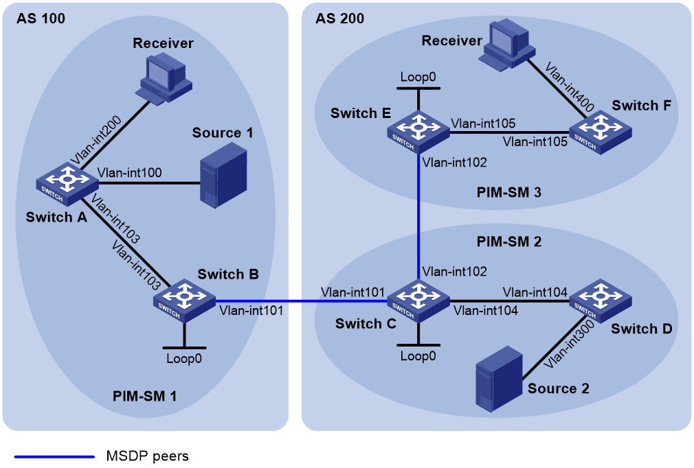

Example: Configuring PIM-SM inter-domain multicast
As shown in Figure 5:
·     OSPF runs within AS 100 and AS 200 and BGP runs between them.
·     Each PIM-SM domain has a minimum of one multicast source or receiver.
Set up MSDP peering relationships between the RPs in the PIM-SM domains to share multicast source information among the PIM-SM domains.
Figure 5 Network diagram
Device
Interface
IP address
Device
Interface
IP address
Switch A
Vlan-int103
10.110.1.2/24
Switch D
Vlan-int104
10.110.4.2/24
Switch A
Vlan-int100
10.110.2.1/24
Switch D
Vlan-int300
10.110.5.1/24
Switch A
Vlan-int200
10.110.3.1/24
Switch E
Vlan-int105
10.110.6.1/24
Switch B
Vlan-int103
10.110.1.1/24
Switch E
Vlan-int102
192.168.3.2/24
Switch B
Vlan-int101
192.168.1.1/24
Switch E
Loop0
3.3.3.3/32
Switch B
Loop0
1.1.1.1/32
Switch F
Vlan-int105
10.110.6.2/24
Switch C
Vlan-int104
10.110.4.1/24
Switch F
Vlan-int400
10.110.7.1/24
Switch C
Vlan-int102
192.168.3.1/24
Source 1
10.110.2.100/24
Switch C
Vlan-int101
192.168.1.2/24
Source 2
10.110.5.100/24
Switch C
Loop0
2.2.2.2/32
Switch D
Vlan-int104
10.110.4.2/24
Assign an IP address and subnet mask to each interface as shown in Figure 5, and configure OSPF on the switches in the ASs.

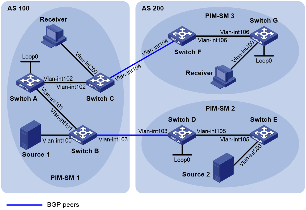

Example: Configuring inter-AS multicast by leveraging static RPF peers
As shown in Figure 6:
·     The network has two ASs: AS 100 and AS 200. OSPF runs within each AS. BGP runs between the two ASs.
·     PIM-SM 1 belongs to AS 100, and PIM-SM 2 and PIM-SM 3 belong to AS 200. Each PIM-SM domain has a minimum of one multicast source or receiver.
Configure inter-AS multicast as follows:
·     Configure Loopback 0 as the C-BSR and C-RP of the related PIM-SM domain on Switch A, Switch D and Switch G.
·     According to the peer-RPF forwarding rule, the switches accept SA messages that pass the filtering policy from its static RPF peers. To share multicast source information among PIM-SM domains without changing the unicast topology structure, configure MSDP peering relationships for the RPs of the PIM-SM domains and configure the static RPF peering relationships.
Figure 6 Network diagram
Device
Interface
IP address
Device
Interface
IP address
Source 1
192.168.1.100/24
Switch D
Vlan-int105
10.110.5.1/24
Source 2
192.168.3.100/24
Switch D
Vlan-int103
10.110.3.2/24
Switch A
Vlan-int101
10.110.1.1/24
Switch D
Loop0
2.2.2.2/32
Switch A
Vlan-int102
10.110.2.1/24
Switch E
Vlan-int105
10.110.5.2/24
Switch A
Loop0
1.1.1.1/32
Switch E
Vlan-int300
192.168.3.1/24
Switch B
Vlan-int101
10.110.1.2/24
Switch F
Vlan-int106
10.110.6.1/24
Switch B
Vlan-int100
192.168.1.1/24
Switch F
Vlan-int104
10.110.4.2/24
Switch B
Vlan-int103
10.110.3.1/24
Switch G
Vlan-int106
10.110.6.2/24
Switch C
Vlan-int102
10.110.2.2/24
Switch G
Vlan-int400
192.168.4.1/24
Switch C
Vlan-int200
192.168.2.1/24
Switch G
Loop0
3.3.3.3/32
Switch C
Vlan-int104
10.110.4.1/24
Assign an IP address and subnet mask to each interface as shown in Table 2, and configure OSPF on the switches in the ASs.
1.     Enable IP multicast routing, PIM-SM, and IGMP, and configure PIM-SM domain borders:
# On Switch C, enable IP multicast routing.
<SwitchC> system-view
[SwitchC] multicast routing
[SwitchC-mrib] quit
# Enable PIM-SM on each interface, and enable IGMP on the receiver-side interface (VLAN-interface 200).
[SwitchC] interface vlan-interface 102
[SwitchC-Vlan-interface102] pim sm
[SwitchC-Vlan-interface102] quit
[SwitchC] interface vlan-interface 200
[SwitchC-Vlan-interface200] igmp enable
[SwitchC-Vlan-interface200] quit
[SwitchC] interface vlan-interface 104
[SwitchC-Vlan-interface104] pim sm
[SwitchC-Vlan-interface104] quit
# Configure Switch A, Switch B, Switch D, Switch E, Switch F, and Switch G in the same way Switch C is configured. (Details not shown.)
# On Switch B, configure the PIM domain borders.
[SwitchB] interface vlan-interface 103
[SwitchB-Vlan-interface103] pim bsr-boundary
[SwitchB-Vlan-interface103] quit
# Configure the PIM domain borders on Switch C, Switch D, and Switch F in the same way Switch B is configured. (Details not shown.)
2.     Configure C-BSRs and C-RPs:
# On Switch A, configure Loopback 0 as a C-BSR and a C-RP.
[SwitchA] pim
[SwitchA-pim] c-bsr 1.1.1.1
[SwitchA-pim] c-rp 1.1.1.1
[SwitchA-pim] quit
# Configure C-BSRs and C-RPs on Switch D and Switch G in the same way Switch A is configured. (Details not shown.)
3.     Configure BGP, and redistribute BGP routing information into OSPF and OSPF routing information into BGP:
# On Switch B, configure an EBGP peer, and redistribute OSPF routing information.
[SwitchB] bgp 100
[SwitchB-bgp] router-id 1.1.1.2
[SwitchB-bgp] peer 10.110.3.2 as-number 200
[SwitchB-bgp] address-family ipv4 unicast
[SwitchB-bgp-ipv4] peer 10.110.3.2 enable
[SwitchB-bgp-ipv4] import-route ospf 1
[SwitchB-bgp-ipv4]quit
[SwitchB-bgp] quit
# On Switch D, configure an EBGP peer, and redistribute OSPF routing information.
[SwitchD] bgp 200
[SwitchD-bgp] router-id 2.2.2.2
[SwitchD-bgp] peer 10.110.3.1 as-number 100
[SwitchD-bgp] address-family ipv4 unicast
[SwitchD-bgp-ipv4] peer 10.110.3.1 enable
[SwitchD-bgp-ipv4] import-route ospf 1
[SwitchD-bgp-ipv4]quit
[SwitchD-bgp] quit
# On Switch C, configure an EBGP peer, and redistribute OSPF routing information.
[SwitchC] bgp 100
[SwitchC-bgp] router-id 1.1.1.3
[SwitchC-bgp] peer 10.110.4.2 as-number 200
[SwitchC-bgp] address-family ipv4 unicast
[SwitchC-bgp-ipv4] peer 10.110.4.2 enable
[SwitchC-bgp-ipv4] import-route ospf 1
[SwitchC-bgp-ipv4]quit
[SwitchC-bgp] quit
# On Switch F, configure an EBGP peer, and redistribute OSPF routing information.
[SwitchF] bgp 200
[SwitchF-bgp] router-id 3.3.3.1
[SwitchF-bgp] peer 10.110.4.1 as-number 100
[SwitchF-bgp] address-family ipv4 unicast
[SwitchF-bgp-ipv4] peer 10.110.4.1 enable
[SwitchF-bgp-ipv4] import-route ospf 1
[SwitchF-bgp-ipv4]quit
[SwitchF-bgp] quit
# On Switch B, redistribute BGP routing information into OSPF.
[SwitchB] ospf 1
[SwitchB-ospf-1] import-route bgp
[SwitchB-ospf-1] quit
# On Switch D, redistribute BGP routing information into OSPF.
[SwitchD] ospf 1
[SwitchD-ospf-1] import-route bgp
[SwitchD-ospf-1] quit
# On Switch C, redistribute BGP routing information into OSPF.
[SwitchC] ospf 1
[SwitchC-ospf-1] import-route bgp
[SwitchC-ospf-1] quit
# On Switch F, redistribute BGP routing information into OSPF.
[SwitchF] ospf 1
[SwitchF-ospf-1] import-route bgp
[SwitchF-ospf-1] quit
4.     Configure MSDP peers and static RPF peers:
# On Switch A, configure Switch D and Switch G as the MSDP peers and static RPF peers.
[SwitchA] ip prefix-list list-dg permit 10.110.0.0 16 greater-equal 16 less-equal 32
[SwitchA] msdp
[SwitchA-msdp] peer 10.110.3.2 connect-interface vlan-interface 101
[SwitchA-msdp] peer 10.110.6.2 connect-interface vlan-interface 102
[SwitchA-msdp] static-rpf-peer 10.110.3.2 rp-policy list-dg
[SwitchA-msdp] static-rpf-peer 10.110.6.2 rp-policy list-dg
[SwitchA-msdp] quit
# On Switch D, configure Switch A as the MSDP peer and static RPF peer.
[SwitchD] ip prefix-list list-a permit 10.110.0.0 16 greater-equal 16 less-equal 32
[SwitchD] msdp
[SwitchD-msdp] peer 10.110.1.1 connect-interface vlan-interface 103
[SwitchD-msdp] static-rpf-peer 10.110.1.1 rp-policy list-a
[SwitchD-msdp] quit
# On Switch G, configure Switch A as the MSDP peer and static RPF peer.
[SwitchG] ip prefix-list list-a permit 10.110.0.0 16 greater-equal 16 less-equal 32
[SwitchG] msdp
[SwitchG-msdp] peer 10.110.2.1 connect-interface vlan-interface 106
[SwitchG-msdp] static-rpf-peer 10.110.2.1 rp-policy list-a
[SwitchG-msdp] quit
# Display the BGP peering relationships on Switch A.
[SwitchA] display bgp peer
No information is output, because no BGP peering relationship has been established between Switch A and Switch D, or between Switch A and Switch G. This means that the unicast topology is not changed.
# Display brief information about MSDP peers on Switch A.
[SwitchA] display msdp brief
Configured   Established  Listen       Connect      Shutdown     Disabled
2            2            0            0            0            0
Peer address    State       Up/Down time    AS         SA count   Reset count
10.110.3.2      Established 01:07:08        ?          8          0
10.110.6.2      Established 00:16:39        ?          13         0
# Display brief information about MSDP peers on Switch D.
[SwitchD] display msdp brief
1            1            0            0            0            0
10.110.1.1      Established 01:07:09        ?          8          0
# Display brief information about MSDP peers on Switch G.
[SwitchG] display msdp brief
1            1            0            0            0            0
10.110.2.1      Established 00:16:40        ?          13         0
# Verify that receivers in PIM-SM 1 and PIM-SM 3 can receive the multicast data from Source 1 and Source 2 to a multicast group. (Details not shown.)

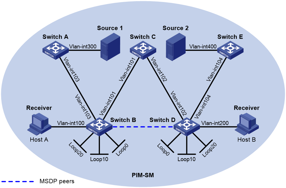

Example: Configuring Anycast RP
As shown in Figure 7, OSPF runs within the domain to provide unicast routes.
Configure the Anycast RP application so that the receiver-side DRs and the source-side DRs can initiate a join process to their respective RPs that are topologically closest to them.
Configure the router IDs of Switch B and Switch D as 1.1.1.1 and 2.2.2.2, respectively. Set up an MSDP peering relationship between Switch B and Switch D.
Figure 7 Network diagram
Table 3 Interface and IP address assignment
Device
Interface
IP address
Device
Interface
IP address
Source 1
10.110.5.100/24
Switch C
Vlan-int101
192.168.1.2/24
Source 2
10.110.6.100/24
Switch C
Vlan-int102
192.168.2.2/24
Switch A
Vlan-int300
10.110.5.1/24
Switch D
Vlan-int200
10.110.3.1/24
Switch A
Vlan-int103
10.110.2.2/24
Switch D
Vlan-int104
10.110.4.1/24
Switch B
Vlan-int100
10.110.1.1/24
Switch D
Vlan-int102
192.168.2.1/24
Switch B
Vlan-int103
10.110.2.1/24
Switch D
Loop0
2.2.2.2/32
Switch B
Vlan-int101
192.168.1.1/24
Switch D
Loop10
4.4.4.4/32
Switch B
Loop0
1.1.1.1/32
Switch D
Loop20
10.1.1.1/32
Switch B
Loop10
3.3.3.3/32
Switch E
Vlan-int400
10.110.6.1/24
Switch B
Loop20
10.1.1.1/32
Switch E
Vlan-int104
10.110.4.2/24
Assign an IP address and subnet mask to each interface as shown in Figure 7, and configure OSPF on the switches.
1.     Enable IP multicast routing, IGMP, and PIM-SM:
# On Switch B, enable IP multicast routing.
<SwitchB> system-view
[SwitchB] multicast routing
[SwitchB-mrib] quit
# Enable IGMP on the receiver-side interface (VLAN-interface 100).
[SwitchB-Vlan-interface100] igmp enable
# Enable PIM-SM on the other interfaces.
[SwitchB-Vlan-interface103] pim sm
[SwitchB] interface Vlan-interface 101
[SwitchB-Vlan-interface101] pim sm
[SwitchB-Vlan-interface101] quit
[SwitchB] interface loopback 0
[SwitchB-LoopBack0] pim sm
[SwitchB-LoopBack0] quit
[SwitchB] interface loopback 10
[SwitchB-LoopBack10] pim sm
[SwitchB-LoopBack10] quit
[SwitchB] interface loopback 20
[SwitchB-LoopBack20] pim sm
[SwitchB-LoopBack20] quit
# Enable IP multicast routing, IGMP, and PIM-SM on Switch A, Switch C, Switch D, and Switch E in the same way Switch B is configured. (Details not shown.)
# Configure Loopback 10 as a C-BSR and Loopback 20 as a C-RP on Switch B.
[SwitchB] pim
[SwitchB-pim] c-bsr 3.3.3.3
[SwitchB-pim] c-rp 10.1.1.1
[SwitchB-pim] quit
# Configure a C-BSR and a C-RP on Switch D in the same way Switch B is configured. (Details not shown.)
3.     Configure MSDP peers:
# Configure an MSDP peer on Loopback 0 of Switch B.
[SwitchB] msdp
[SwitchB-msdp] originating-rp loopback 0
[SwitchB-msdp] peer 2.2.2.2 connect-interface loopback 0
[SwitchB-msdp] quit
# Configure an MSDP peer on Loopback 0 of Switch D.
[SwitchD] msdp
[SwitchD-msdp] originating-rp loopback 0
[SwitchD-msdp] peer 1.1.1.1 connect-interface loopback 0
[SwitchD-msdp] quit
# Display brief information about MSDP peers on Switch B.
[SwitchB] display msdp brief
1            1            0            0            0            0
2.2.2.2         Established 00:10:57        ?          0          0
1            1            0            0            0            0
1.1.1.1         Established 00:10:57        ?          0          0
# Send an IGMP report from Host A to join multicast group 225.1.1.1. (Details not shown.)
# Send multicast data from Source 1 to multicast group 225.1.1.1. (Details not shown.)
# Display the PIM routing table on Switch D.
[SwitchD] display pim routing-table
No information is output on Switch D.
# Display the PIM routing table on Switch B.
[SwitchB] display pim routing-table
 Total 1 (*, G) entry; 1 (S, G) entry
 (*, 225.1.1.1)
     RP: 10.1.1.1 (local)
     Protocol: pim-sm, Flag: WC
     UpTime: 00:15:04
     Upstream interface: Register-Tunnel0
         Upstream neighbor: NULL
         RPF prime neighbor: NULL
     Downstream interface(s) information:
     Total number of downstream interfaces: 1
         1: Vlan-interface100
             Protocol: igmp, UpTime: 00:15:04, Expires: -
 (10.110.5.100, 225.1.1.1)
     Protocol: pim-sm, Flag: SPT 2MSDP ACT
     UpTime: 00:46:28
     Upstream interface: Vlan-interface103
         Upstream neighbor: 10.110.2.2
         RPF prime neighbor: 10.110.2.2
             Protocol: pim-sm, UpTime:  - , Expires:  -
The output shows that Switch B now acts as the RP for Source 1 and Host A.
# Send an IGMP leave message from Host A to leave multicast group 225.1.1.1. (Details not shown.),
# Send an IGMP report from Host B to join multicast group 225.1.1.1. (Details not shown.)

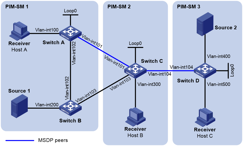

Example: Configuring SA message filtering
As shown in Figure 8:
·     OSPF runs within and among the PIM-SM domains to provide unicast routing.
·     Set up an MSDP peering relationship between Switch A and Switch C and between Switch C and Switch D.
·     Source 1 sends multicast data to multicast groups 225.1.1.0/30 and 226.1.1.0/30, and Source 2 sends multicast data to the multicast group 227.1.1.0/30.
Configure SA message policies so that:
·     Host A and Host B receive the multicast data only addressed to multicast groups 225.1.1.0/30 and 226.1.1.0/30.
·     Host C receives the multicast data only addressed to multicast groups 226.1.1.0/30 and 227.1.1.0/30.
Figure 8 Network diagram
Table 4 Interface and IP address assignment
Device
Interface
IP address
Device
Interface
IP address
Source 1
10.110.3.100/24
Switch C
Vlan-int300
10.110.4.1/24
Source 2
10.110.6.100/24
Switch C
Vlan-int104
10.110.5.1/24
Switch A
Vlan-int100
10.110.1.1/24
Switch C
Vlan-int101
192.168.1.2/24
Switch A
Vlan-int102
10.110.2.1/24
Switch C
Vlan-int103
192.168.2.2/24
Switch A
Vlan-int101
192.168.1.1/24
Switch C
Loop0
2.2.2.2/32
Switch A
Loop0
1.1.1.1/32
Switch D
Vlan-int400
10.110.6.1/24
Switch B
Vlan-int200
10.110.3.1/24
Switch D
Vlan-int500
10.110.7.1/24
Switch B
Vlan-int102
10.110.2.2/24
Switch D
Vlan-int104
10.110.5.2/24
Switch B
Vlan-int103
192.168.2.1/24
Switch D
Loop0
3.3.3.3/32
Assign an IP address and subnet mask to each interface as shown in Figure 8, and configure OSPF on the switches in the PIM-SM domains.
1.     Enable IP multicast routing, IGMP, and PIM-SM, and configure PIM domain borders:
# On Switch A, enable IP multicast routing.
<SwitchA> system-view
[SwitchA] multicast routing
[SwitchA-mrib] quit
[SwitchA-Vlan-interface100] igmp enable
[SwitchA] interface vlan-interface 101
[SwitchA-Vlan-interface101] pim sm
[SwitchA-Vlan-interface101] quit
[SwitchA] interface vlan-interface 102
[SwitchA-Vlan-interface102] pim sm
[SwitchA-Vlan-interface102] quit
[SwitchA] interface loopback 0
[SwitchA-LoopBack0] pim sm
[SwitchA-LoopBack0] quit
# Enable IP multicast routing, IGMP, and PIM-SM on Switch B, Switch C, and Switch D in the same way Switch A is configured. (Details not shown.)
# Configure a PIM domain border on Switch C.
[SwitchC] interface vlan-interface 101
[SwitchC-Vlan-interface101] pim bsr-boundary
[SwitchC-Vlan-interface101] quit
[SwitchC] interface vlan-interface 103
[SwitchC-Vlan-interface103] pim bsr-boundary
[SwitchC-Vlan-interface103] quit
[SwitchC-Vlan-interface104] pim bsr-boundary
# Configure PIM domain borders on Switch A, Switch B, and Switch D in the same way Switch C is configured. (Details not shown.)
# Configure Loopback 0 as a C-BSR and a C-RP on Switch A.
[SwitchA] pim
[SwitchA-pim] quit
# Configure C-BSRs and C-RPs on Switch C and Switch D in the same way Switch A is configured. (Details not shown.)
# Configure an MSDP peer on Switch A.
[SwitchA] msdp
[SwitchA-msdp] peer 192.168.1.2 connect-interface vlan-interface 101
[SwitchA-msdp] quit
# Configure MSDP peers on Switch C.
[SwitchC] msdp
[SwitchC-msdp] peer 192.168.1.1 connect-interface vlan-interface 101
[SwitchC-msdp] peer 10.110.5.2 connect-interface vlan-interface 104
[SwitchC-msdp] quit
# Configure an MSDP peer on Switch D.
[SwitchD] msdp
[SwitchD-msdp] peer 10.110.5.1 connect-interface vlan-interface 104
[SwitchD-msdp] quit
4.     Configure SA message policies:
# Configure an SA accepting and forwarding policy on Switch C so that Switch C will not forward SA messages for (Source 1, 225.1.1.0/30) to Switch D.
[SwitchC] acl advanced 3001
[SwitchC-acl-ipv4-adv-3001] rule deny ip source 10.110.3.100 0 destination 225.1.1.0 0.0.0.3
[SwitchC-acl-ipv4-adv-3001] rule permit ip source any destination any
[SwitchC-acl-ipv4-adv-3001] quit
[SwitchC] msdp
[SwitchC-msdp] peer 10.110.5.2 sa-policy export acl 3001
[SwitchC-msdp] quit
# Configure an SA creation policy on Switch D so that Switch D will not create SA messages for Source 2.
[SwitchD] acl basic 2001
[SwitchD-acl-ipv4-basic-2001] rule deny source 10.110.6.100 0
[SwitchD-acl-ipv4-basic-2001] quit
[SwitchD] msdp
[SwitchD-msdp] import-source acl 2001
[SwitchD-msdp] quit
# Display the (S, G) entries in the SA message cache on Switch C.
[SwitchC] display msdp sa-cache
 MSDP Total Source-Active Cache - 8 entries
 Matched 8 entries
Source        Group          Origin RP       Pro  AS     Uptime   Expires
10.110.3.100  225.1.1.0      1.1.1.1         ?    ?      02:03:30 00:05:31
10.110.3.100  225.1.1.1      1.1.1.1         ?    ?      02:03:30 00:05:31
10.110.3.100  225.1.1.2      1.1.1.1         ?    ?      02:03:30 00:05:31
10.110.3.100  225.1.1.3      1.1.1.1         ?    ?      02:03:30 00:05:31
10.110.3.100  226.1.1.0      1.1.1.1         ?    ?      02:03:30 00:05:31
10.110.3.100  226.1.1.1      1.1.1.1         ?    ?      02:03:30 00:05:31
10.110.3.100  226.1.1.2      1.1.1.1         ?    ?      02:03:30 00:05:31
10.110.3.100  226.1.1.3      1.1.1.1         ?    ?      02:03:30 00:05:31
# Display the (S, G) entries in the SA message cache on Switch D.
[SwitchD] display msdp sa-cache
 MSDP Total Source-Active Cache - 4 entries
 Matched  4 entries
10.110.3.100  226.1.1.0      1.1.1.1         ?    ?      00:32:53 00:05:07
10.110.3.100  226.1.1.1      1.1.1.1         ?    ?      00:32:53 00:05:07
10.110.3.100  226.1.1.2      1.1.1.1         ?    ?      00:32:53 00:05:07
10.110.3.100  226.1.1.3      1.1.1.1         ?    ?      00:32:53 00:05:07
