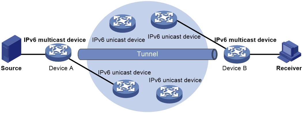

IPv6 multicast forwarding across IPv6 unicast subnets
IPv6 multicast data transmission over a 6to4 tunnel is not supported in the current software version.
Devices forward the IPv6 multicast data from an IPv6 multicast source hop by hop along the forwarding tree, but some devices might not support IPv6 multicast protocols in a network. When the IPv6 multicast data is forwarded to a device that does not support IPv6 multicast, the forwarding path is blocked. In this case, you can enable IPv6 multicast data forwarding across the IPv6 unicast subnets by establishing a tunnel between the devices at both ends of the IPv6 unicast subnets.
Figure 2 IPv6 multicast data transmission through a tunnel
As shown in Figure 2, a tunnel is established between Device A and Device B. Device A encapsulates the IPv6 multicast data in unicast IPv6 packets, and forwards them to Device B across the tunnel through unicast devices. Then, Device B strips off the unicast IPv6 header and continues to forward the IPv6 multicast data down toward the receivers.

As shown in Figure 3:
·     IPv6 multicast routing and IPv6 PIM-DM are enabled on Switch A and Switch C.
·     Switch B does not support IPv6 multicast.
·     Switch A, Switch B, and Switch C run OSPFv3. The source-side interface VLAN-interface 100 on Switch A does not run OSPFv3.
Configure the switches so that the receiver host can receive the IPv6 multicast data from Source.
Figure 3 Network diagram
Assign an IPv6 address and prefix length to each interface as shown in Figure 3, and configure OSPFv3 on the switches (Do not run OSPFv3 on VLAN-interface 100 on Switch A.)
1.     Configure a GRE tunnel:

3.     On Switch C, configure a static IPv6 route with the destination address 1001::1/64 and the outgoing interface Tunnel 2.
[SwitchC] ipv6 route-static 1001::1 64 tunnel 2
# Send an MLD report from Receiver to join the IPv6 multicast group FF1E::101. (Details not shown.)
# Send IPv6 multicast data from Source to the IPv6 multicast group FF1E::101. (Details not shown.)

The output shows the following information:
·     Switch A is the RPF neighbor of Switch C.
·     IPv6 multicast data from Switch A is delivered over the GRE tunnel to Switch C.
