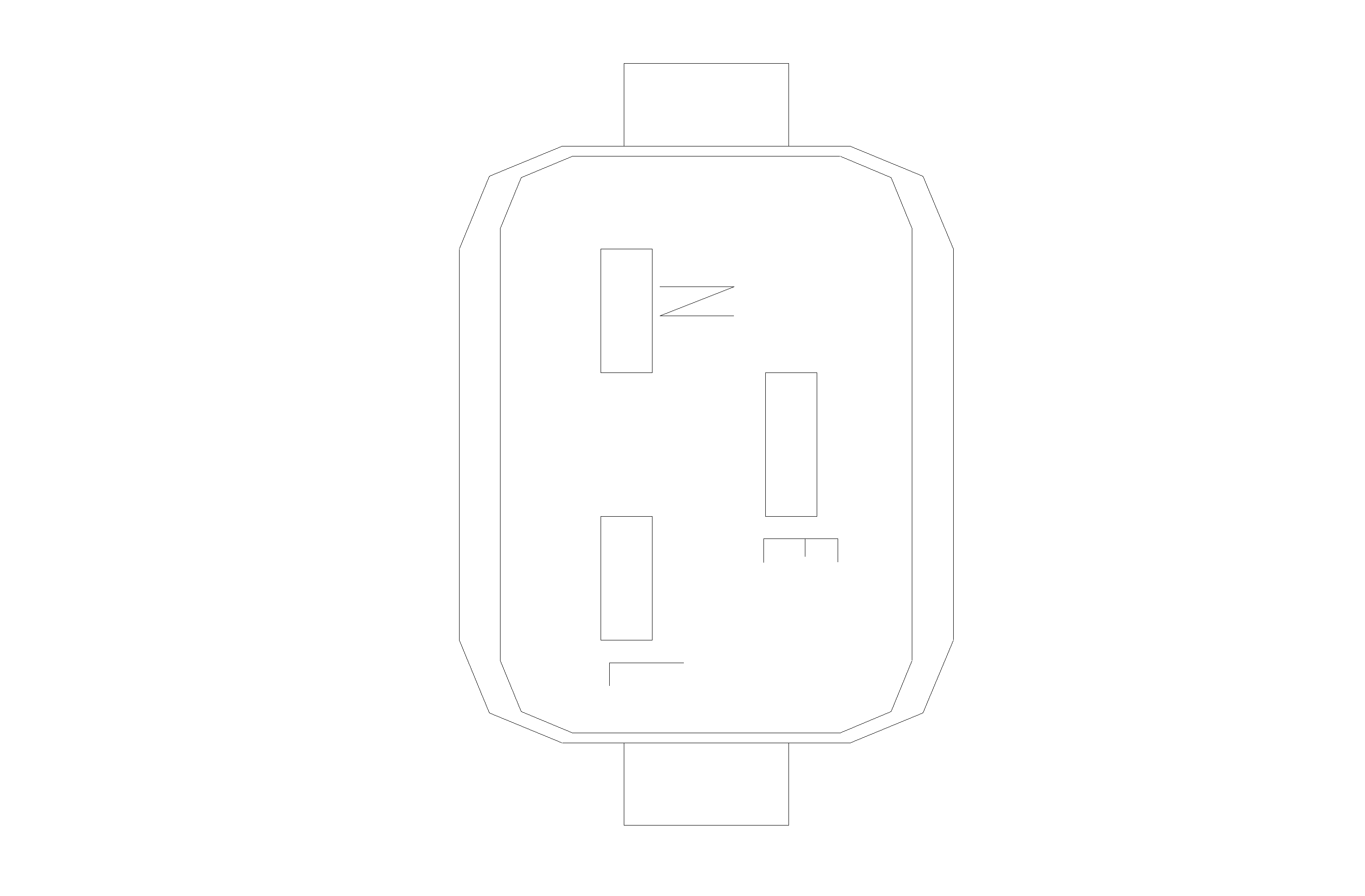

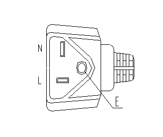

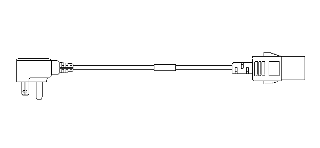

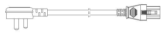

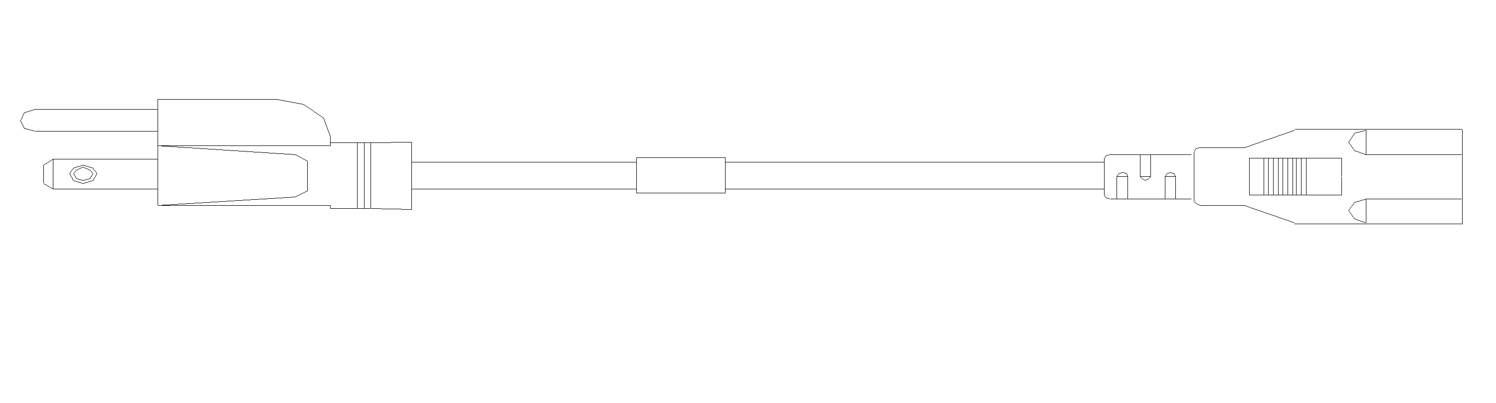

AC power cords
An AC power cord is used to connect an AC power supply of a router to the external AC power supply system.
To select an AC power cord for an AC power supply, consider the following items:
· Power capacity of the power supply.
· Current-carrying capacity of the power cord.
· Region-and country-specific plug type.

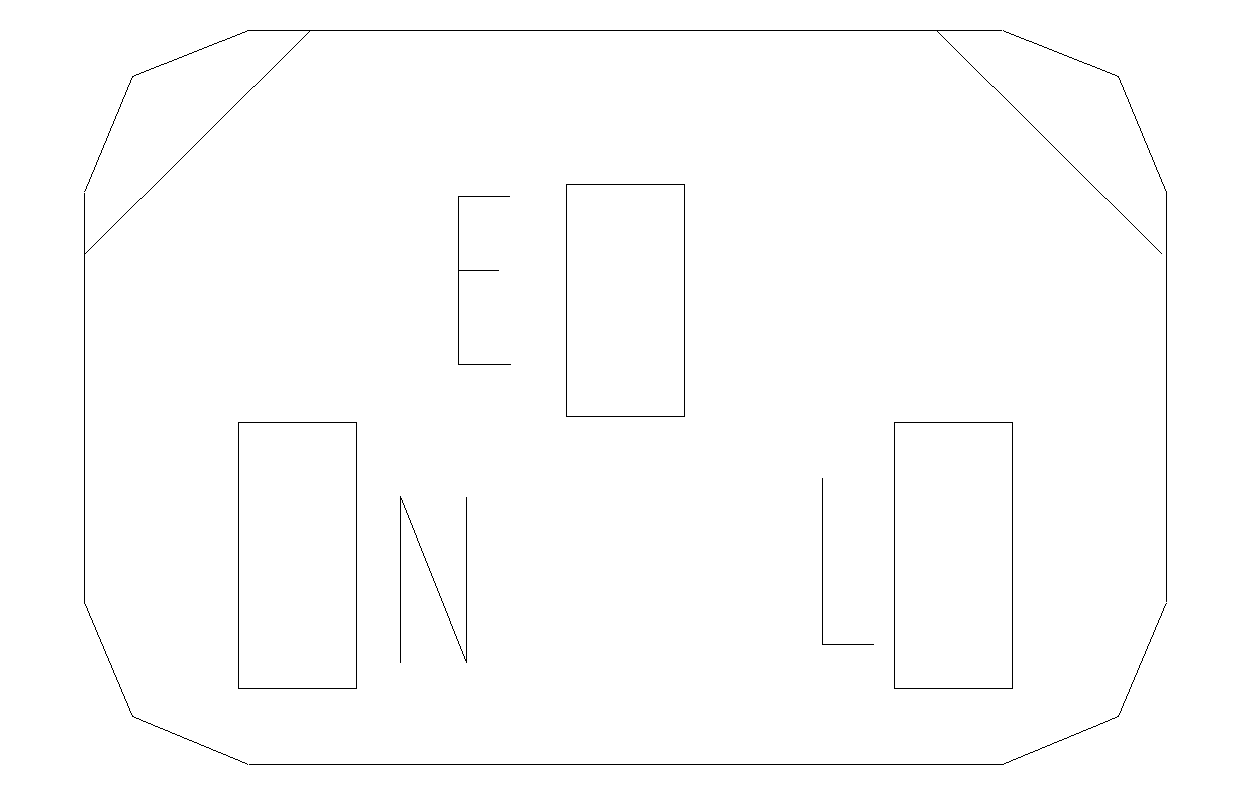

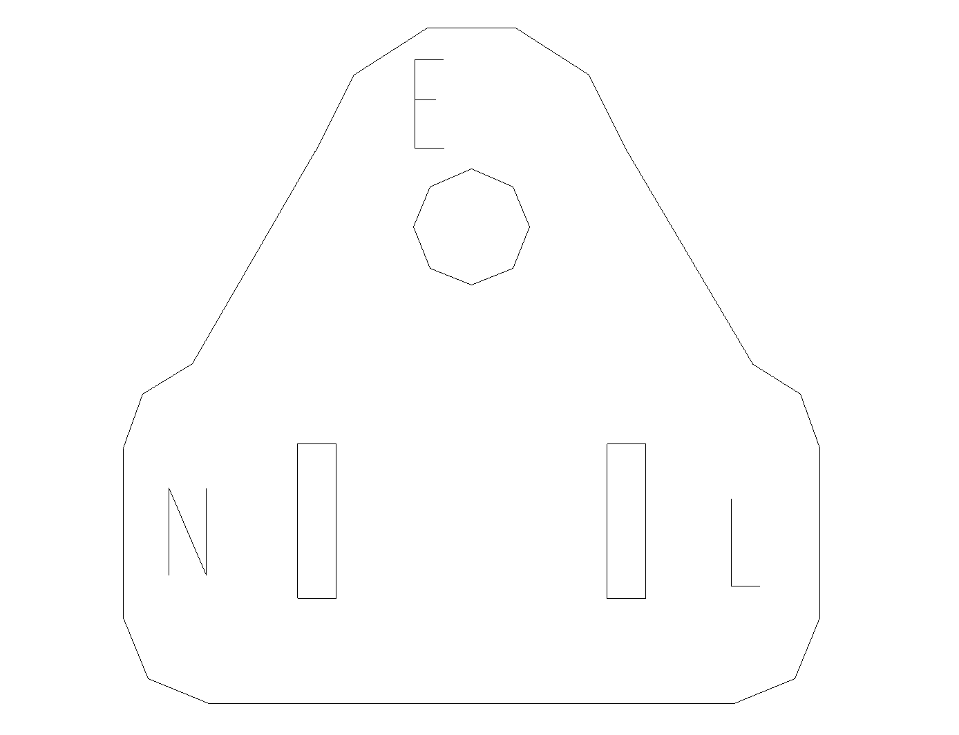

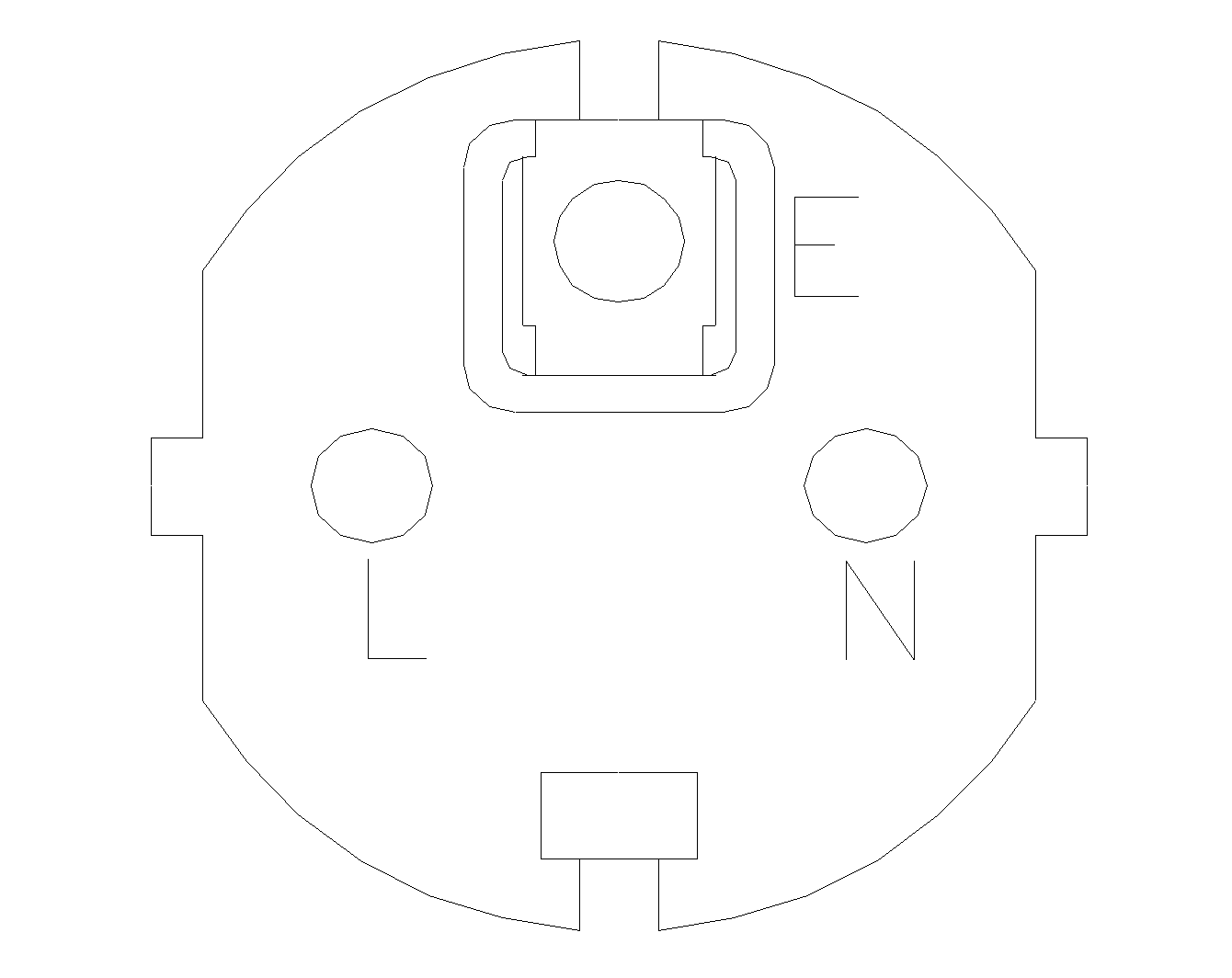

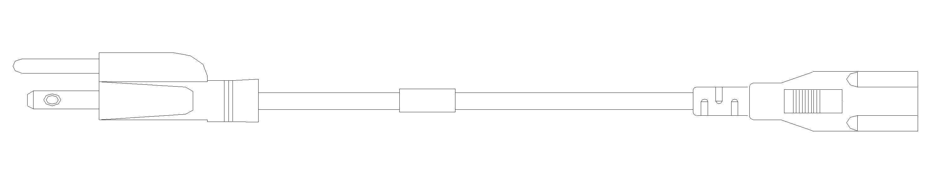

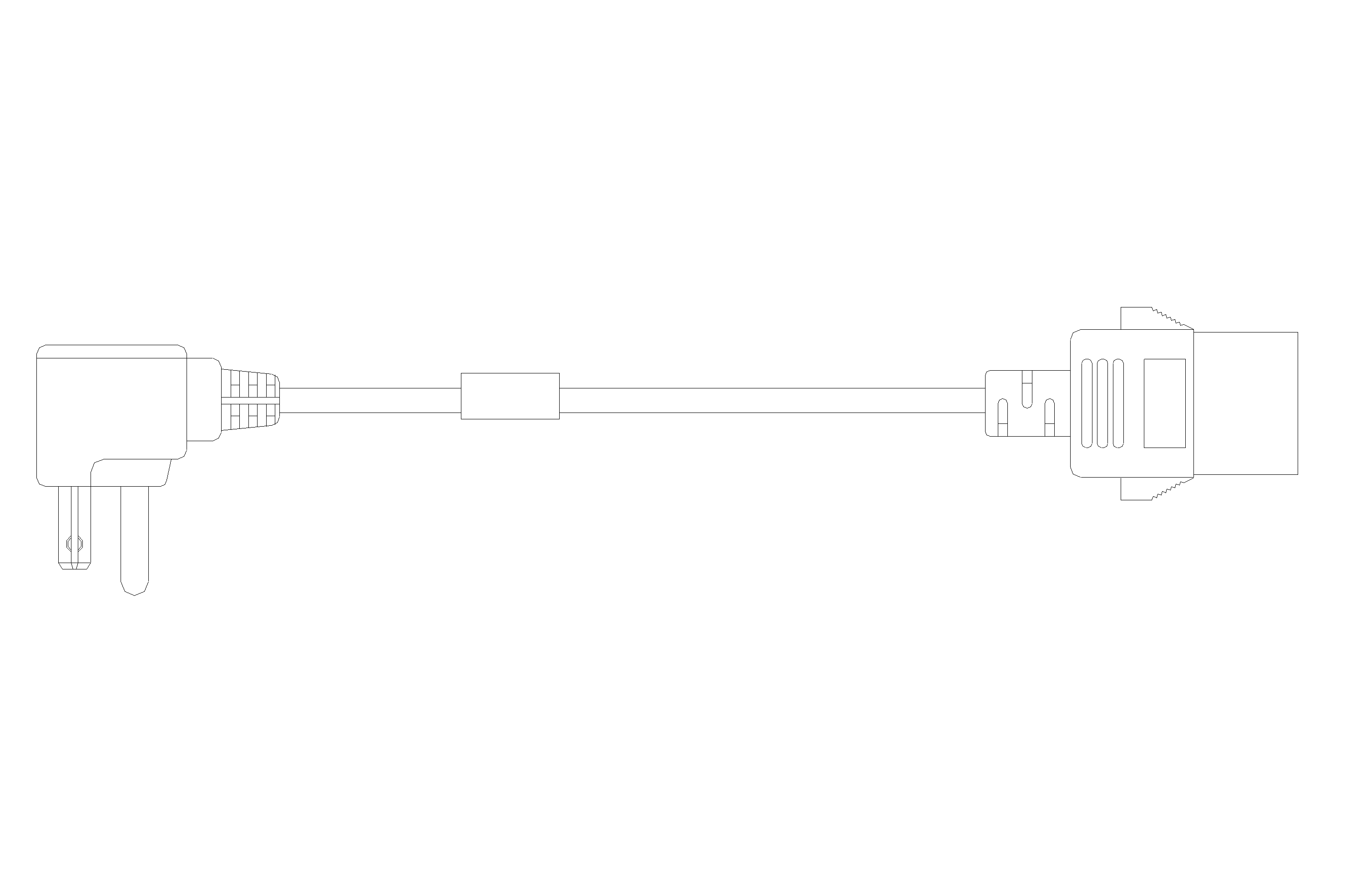

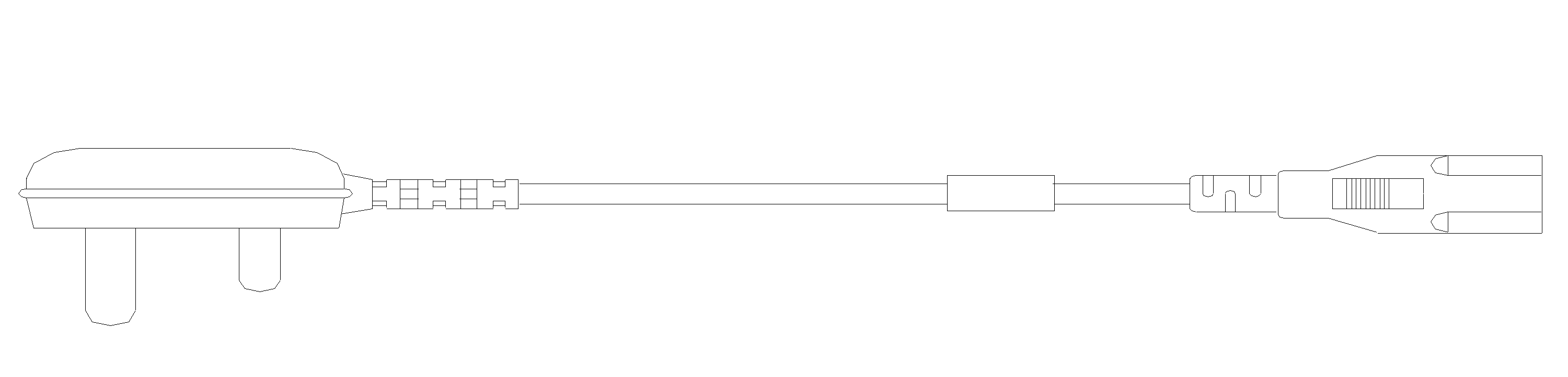

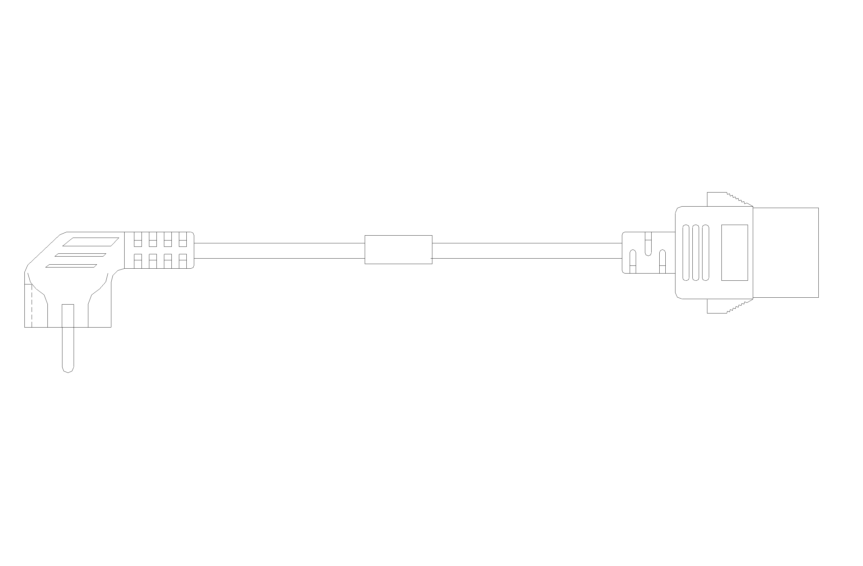

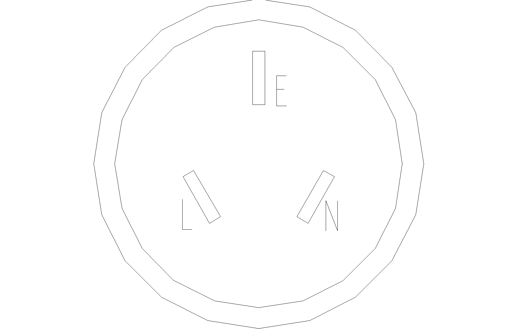

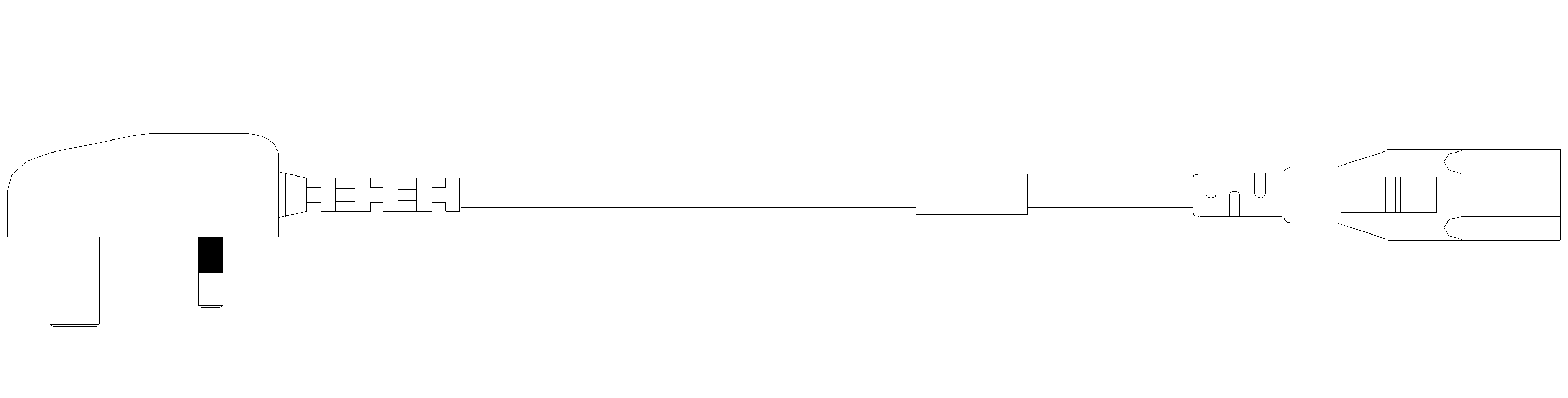

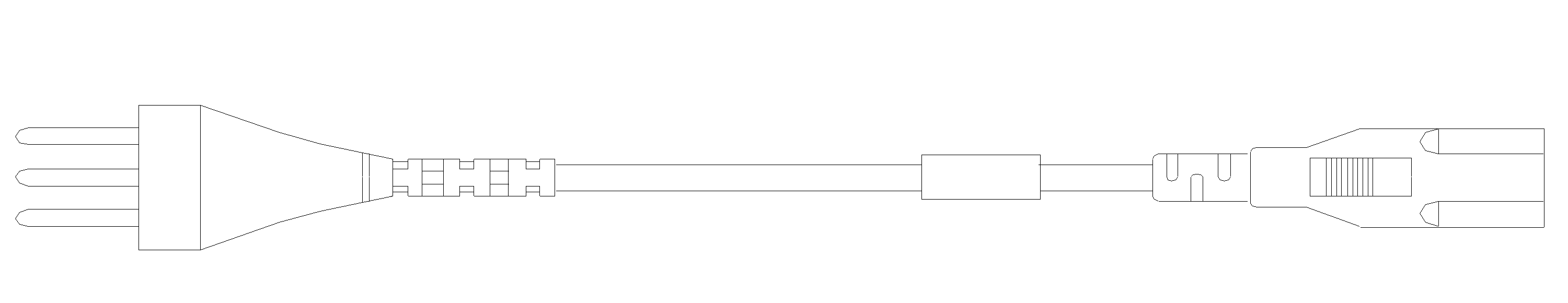

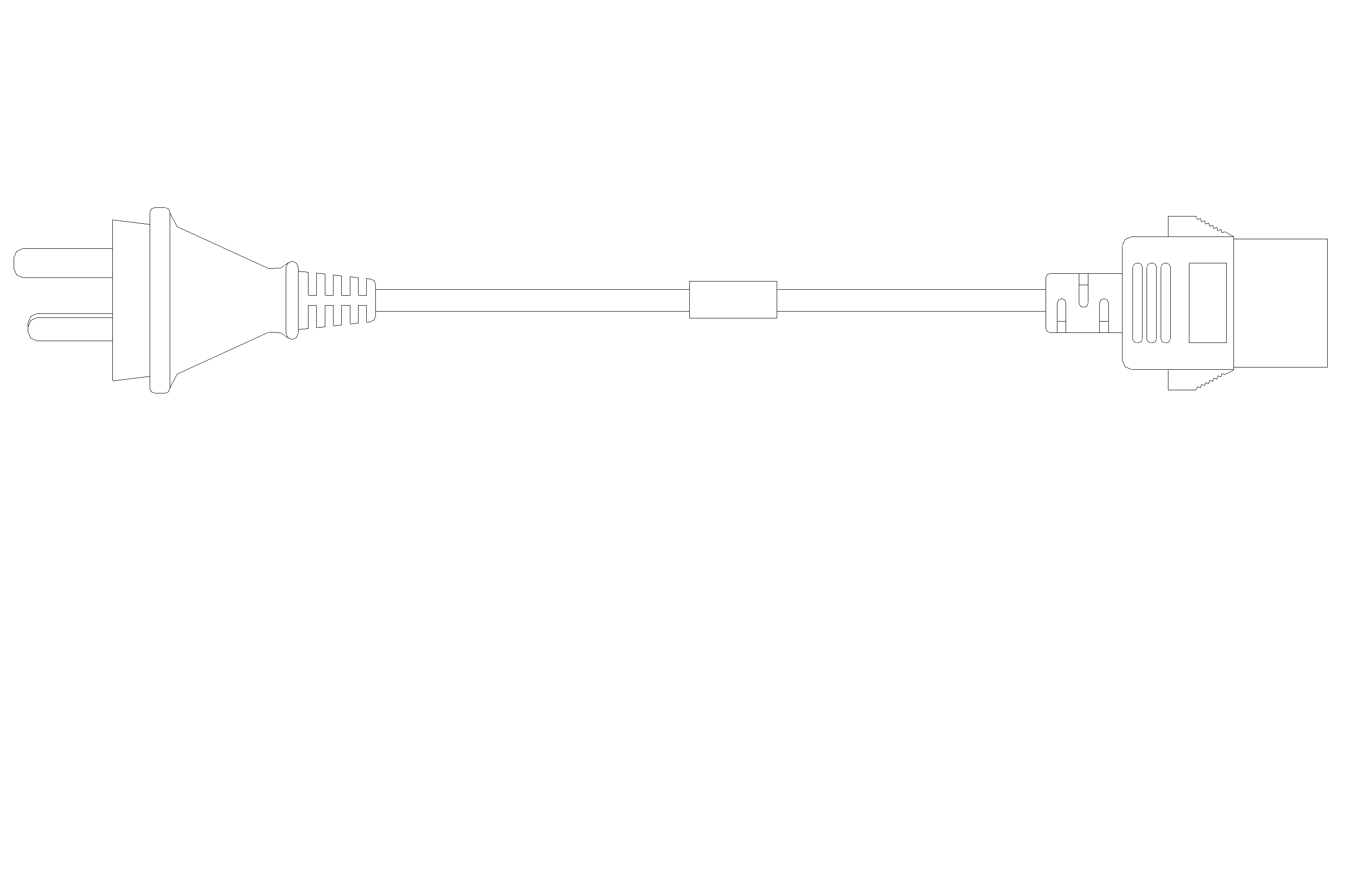

The PSR320-A and PSR650-A power supplies require a 10A AC power cord. Table 16 describes the region-and country-specific plug types for 10A AC power cords.
The PSR1200-A, PSR1400-A, and PSR2500-12AHD power supplies require a 16A AC power cord. Table 17 describes the region-and country-specific plug types for 16A AC power cords. The 0404A0RP and 0404A0RQ AC power cords are available for the PSR2500-12AHD power supply.

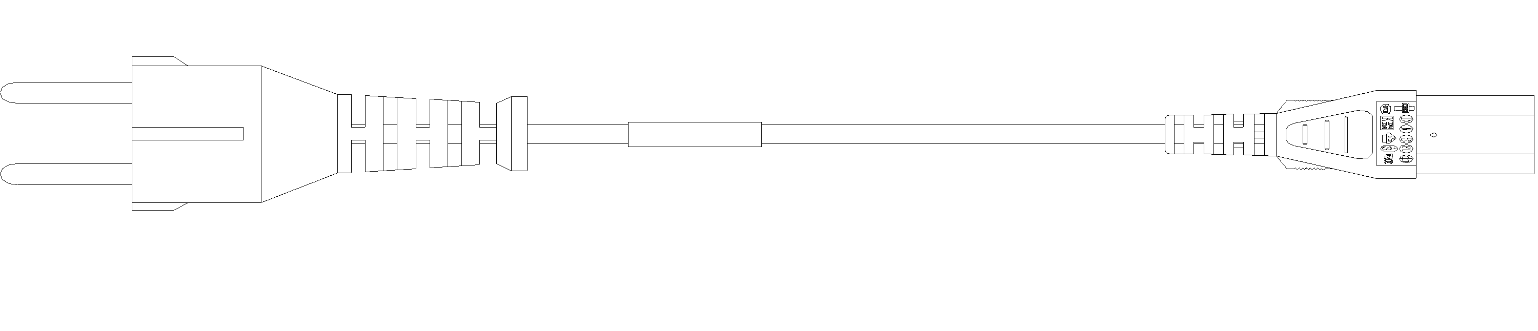

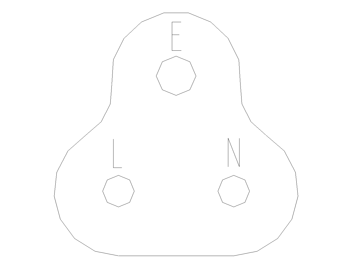

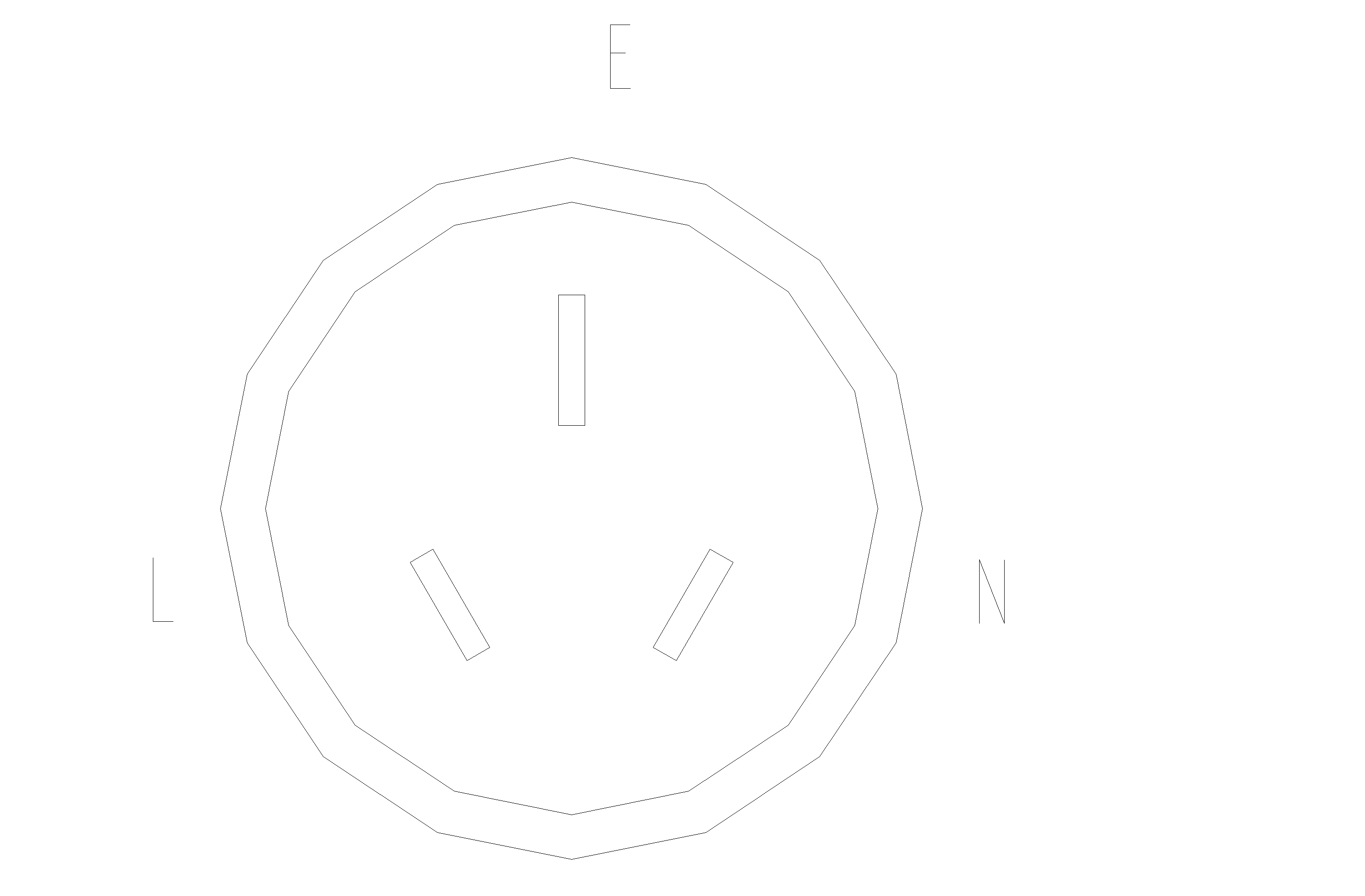

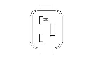

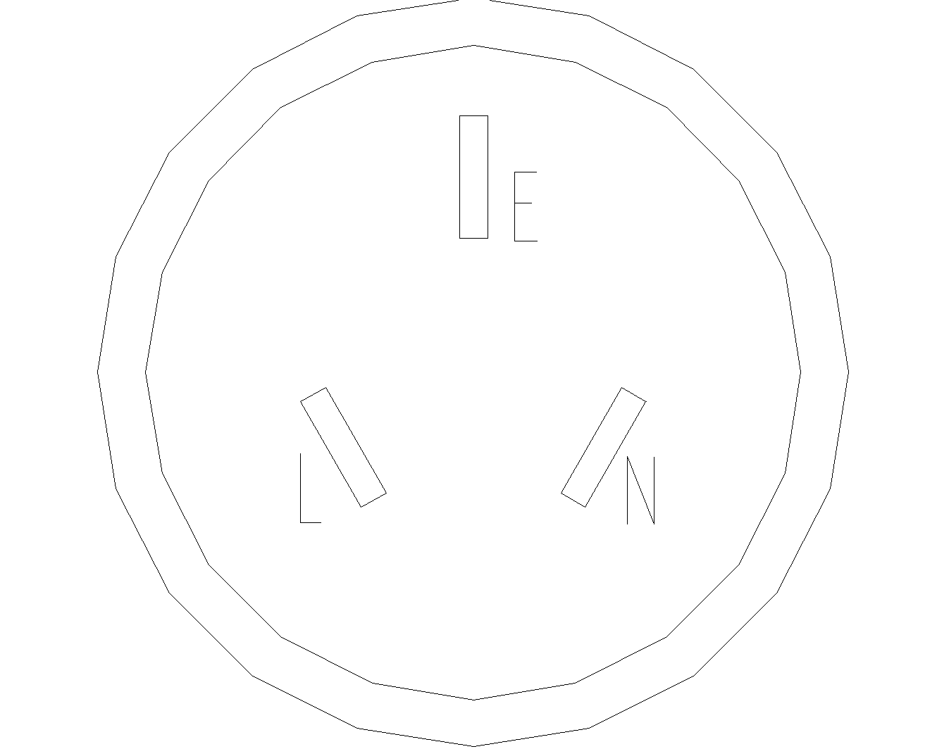

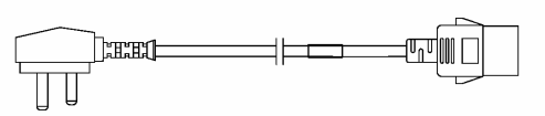

Table 16 10A AC power cords used in different countries or regions
1 |
Plug type |
Code (Length) |
Countries or regions where the type of power cords conforms to local safety regulations and can be used legally |
Other countries or regions using this type of power cords |
Countries or regions seldom using this type of power cords |

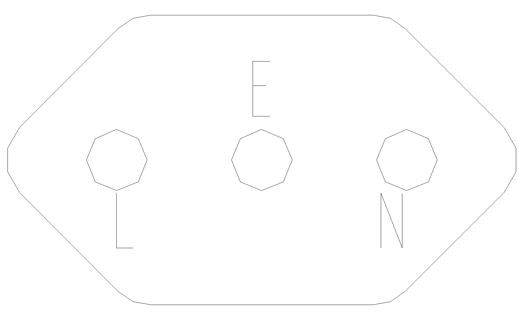

I type |
04041104: 3 m (9.8 ft) |
Mainland China |
N/A |
N/A |
Plug outline |
Power cord outline |
Connector outline |

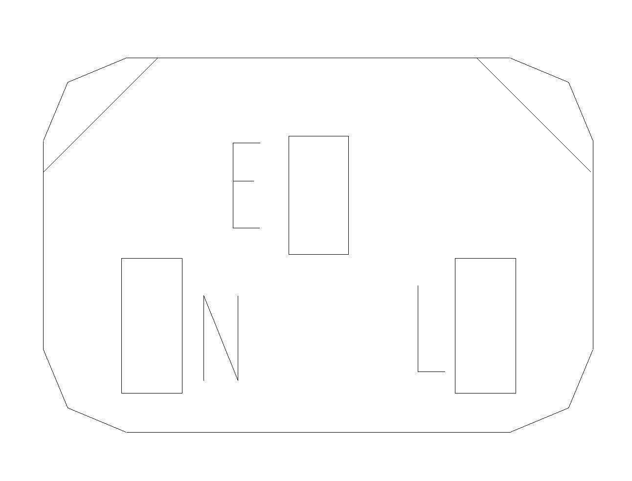

2 |
Plug type |
Code (Length) |
B type |
04020728: 3 m (9.8 ft) |
Canada and U.S.A |
Mexico, Argentina, Brazil, Columbia, Venezuela, Thailand, Peru, Philippine, and A6 countries or regions |
N/A |
Plug outline |
Connector outline |

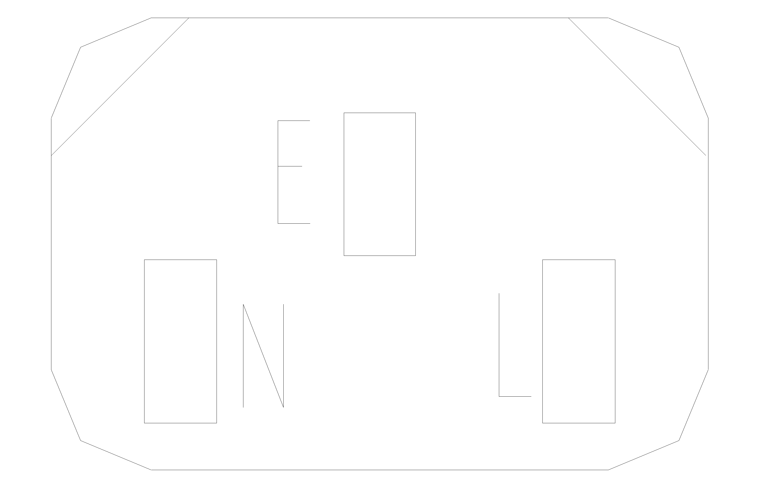

3 |
Plug type |
Code (Length) |
F type |
04041056: 3 m (9.8 ft) |
Holland, Denmark, Sweden, Finland, Norway, Germany, France, Austria, Belgium, and Italy |
Indonesia, Türkiye, Russia, and CIS |
N/A |
Plug outline |
Connector outline |

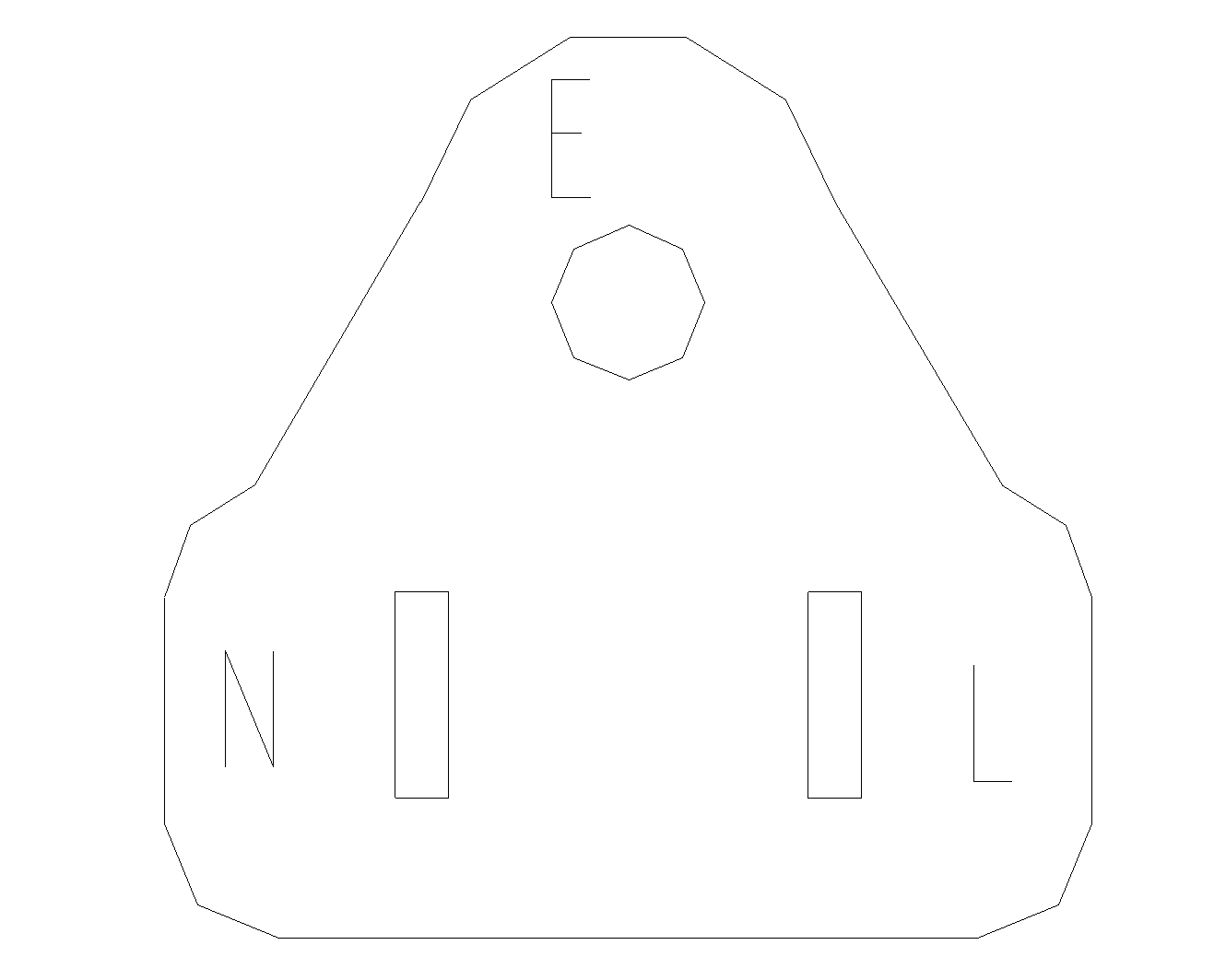

4 |
Plug type |
Code (Length) |
G type |
04040890: 3 m (9.8 ft) |
U.K. |
Malaysia, Hong Kong, and Egypt |
N/A |
Plug outline |
Connector outline |

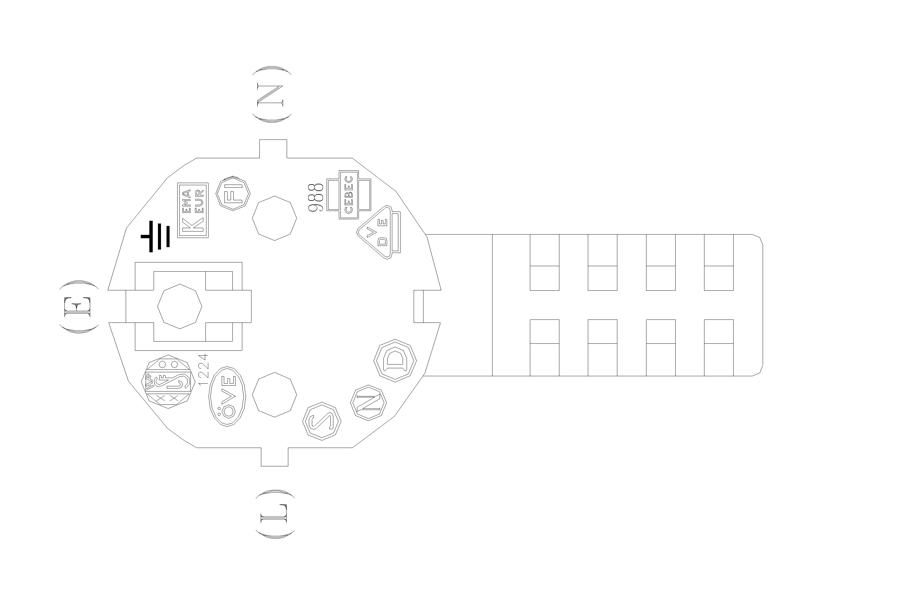

5 |
Plug type |
Code (Length) |
B type |
04040887: 3 m (9.8 ft) |
Japan |
N/A |
N/A |
Plug outline |
