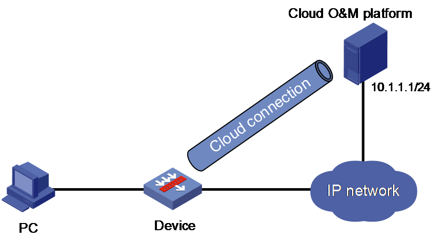

Example: Configuring a cloud connection
As shown in Figure 2, configure the device to establish a cloud connection with the cloud O&M platform.
Figure 2 Network diagram
1.     Configure IP addresses for interfaces, routes, security domains, and security policies. (Details not shown.)
2.     Log in to the cloud O&M platform to add the serial number of the device to the platform. (Details not shown.)
3.     Configure the domain name of the cloud O&M platform as ops.seccloud.h3c.com on the device.
<Device> system-view
[Device] cloud-management server domain ops.seccloud.h3c.com
Make sure a DNS server is configured to translate the domain name of the cloud O&M platform.
