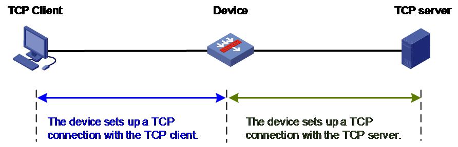

TCP proxy
As shown in Figure 1, the device implements TCP proxy for traffic between the TCP client and server. After receiving traffic from the TCP client to the server, the device becomes a TCP proxy. It proxies the server to establish a connection with the client and proxies the client to establish a connection with the server, respectively. The client and server exchange data through the two TCP connections. This mechanism provides TCP-layer isolation between the TCP client and server and helps effectively block unauthorized access attempts and malicious attacks.
Figure 1 TCP proxy

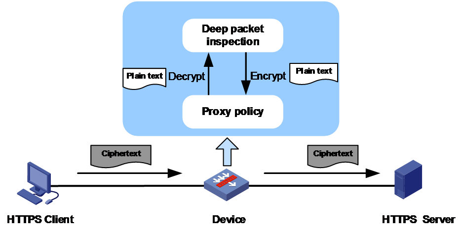

SSL proxy
SSL proxy enables the device to decrypt SSL traffic and perform deep packet inspection on the traffic.
As shown in Figure 2, the device implements SSL decryption on HTTPS traffic from the HTTPS client to the HTTPS server. After receiving HTTP traffic from the HTTPS client to the server, the device becomes an SSL proxy. It proxies the server to complete the SSL handshake and establish an SSL connection with the client and proxies the client to establish an SSL connection with the server. When the HTTPS client and server exchange data, the device performs the following operations:
1.     Decrypts the HTTPS traffic.
2.     Performs deep packet inspection and audit on the traffic according to the DPI service configuration.
For more information about DPI services, see DPI Configuration Guide.
3.     Re-encrypts the traffic and send it to the server or client.
Figure 2 SSL proxy

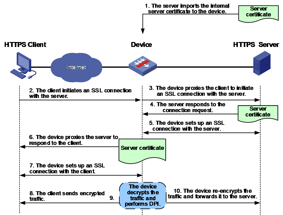

Mechanism for protecting internal clients
The SSL proxy function is implemented based on the TCP proxy function. When the device detects SSL traffic that needs SSL proxy, it first acts as the TCP proxy to set up TCP connections, and then implements SSL proxy.
Figure 3 shows how the device acts as an SSL proxy to protect the internal client when it accesses the external server.
Figure 3 SSL proxy mechanism for protecting the internal client
1.     The client sends a request to initiate an SSL connection with the server.
2.     The device receives the request from the client and proxies the client to send a new SSL connection request to the server.
3.     The server responds to the request and sends the server certificate to the device.
4.     The device verifies the legitimacy of the server certificate, completes the SSL handshake with the server on behalf of the SSL client, and sets up an SSL connection.
5.     The device acts as the SSL proxy server to respond to the client connection request and send a proxy server certificate to the client. The proxy server certificate is issued by using the SSL decryption certificate based on the content of the real server certificate.
6.     The client verifies the proxy server certificate, completes the SSL handshake with the device, and sets up an SSL connection.
7.     The client and server transmit encrypted SSL traffic with the device, respectively.
8.     The device decrypts the SSL traffic from the client or server and performs deep packet inspection and audit on the traffic.
9.     The device re-encrypts the traffic and sends it to the server.

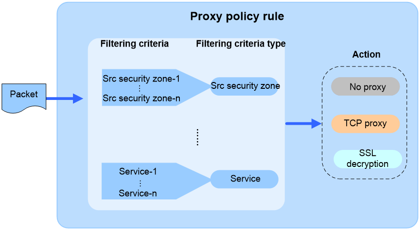

Proxy policy rules
The device supports only one proxy policy.
The proxy policy contains a set of user-defined proxy policy rules. Each rule defines a set of traffic filtering criteria and an action (TCP proxy, SSL decryption, or no-proxy) for traffic matching the rule.
Naming and numbering of proxy policy rules
Each proxy policy rule is identified by a unique rule name and ID. The rule name is required but the rule ID is optional when you create a rule. If you do not specify a rule ID, the system automatically assigns an ID to the rule.
Traffic filtering criteria in a proxy policy rule
You can configure the following types of criteria to filter the traffic to which a proxy policy rule applies:
·     Source security zone.
·     Destination security zone.
·     Source IP address.
·     Destinations IP address.
·     User.
·     User group.
·     Service.
You can configure multiple criteria for each filtering criteria type. A packet matches a filtering criteria type if it matches a filtering criterion of the type. For example, you can configure multiple source security zone filtering criteria in a proxy policy rule. A packet passes the source security zone filtering if it matches any of the configured source security zone filtering criteria.
Proxy policy rule match order
By default, proxy policy rules are matched in the order they were created. A rule created earlier has a higher priority. You can change the rule match order by rearranging proxy policy rules. The match process stops once a matching rule is found.
The more refined the traffic filtering criteria are, the smaller the application range of the proxy policy rule. Configure the proxy policy rules in ascending order of their application ranges as a best practice.
Proxy policy rule actions
The device supports the following actions for traffic matching a proxy policy rule:
·     TCP-proxy—The device acts as a TCP proxy and provides TCP-layer isolation between the TCP client and TCP server.
·     SSL-decryption—The device acts as an SSL proxy to decrypt the SSL traffic between the SSL client and server and to implement deep packet inspection on the decrypted traffic.
The SSL decryption supports the following protection services:
¡     Internal client protection.
¡     Internal server protection.
·     No-proxy—The device directly transmits the traffic without TCP or SSL proxy.
Matching process
Figure 5 Matching process
As shown in Figure 5, a packet is compared against the proxy policy rules as follows:
1.     The device compares the packet against the proxy policy rule with the highest priority.
The proxy policy rule can contain multiple filtering criteria types and each filtering criteria type can contain multiple filtering criteria. The packet matches a filtering criteria type if it matches any filtering criterion of the type.
2.     The device determines that the packet matches the proxy policy rule if the packet matches each of following filtering criteria types in the rule:
¡     Source security zone.
¡     Destination security zone.
¡     Source IP address.
¡     Destinations IP address.
¡     Service.
¡     Either the user or user group filtering criteria type.
3.     If the packet does not match the highest priority rule, the device continues the match process. The match process stops until a matching rule is found, and the action associated with the matching rule is applied.
4.     If the packet does not match any rules in the proxy policy, the device applies the default action specified in the proxy policy to the packet.

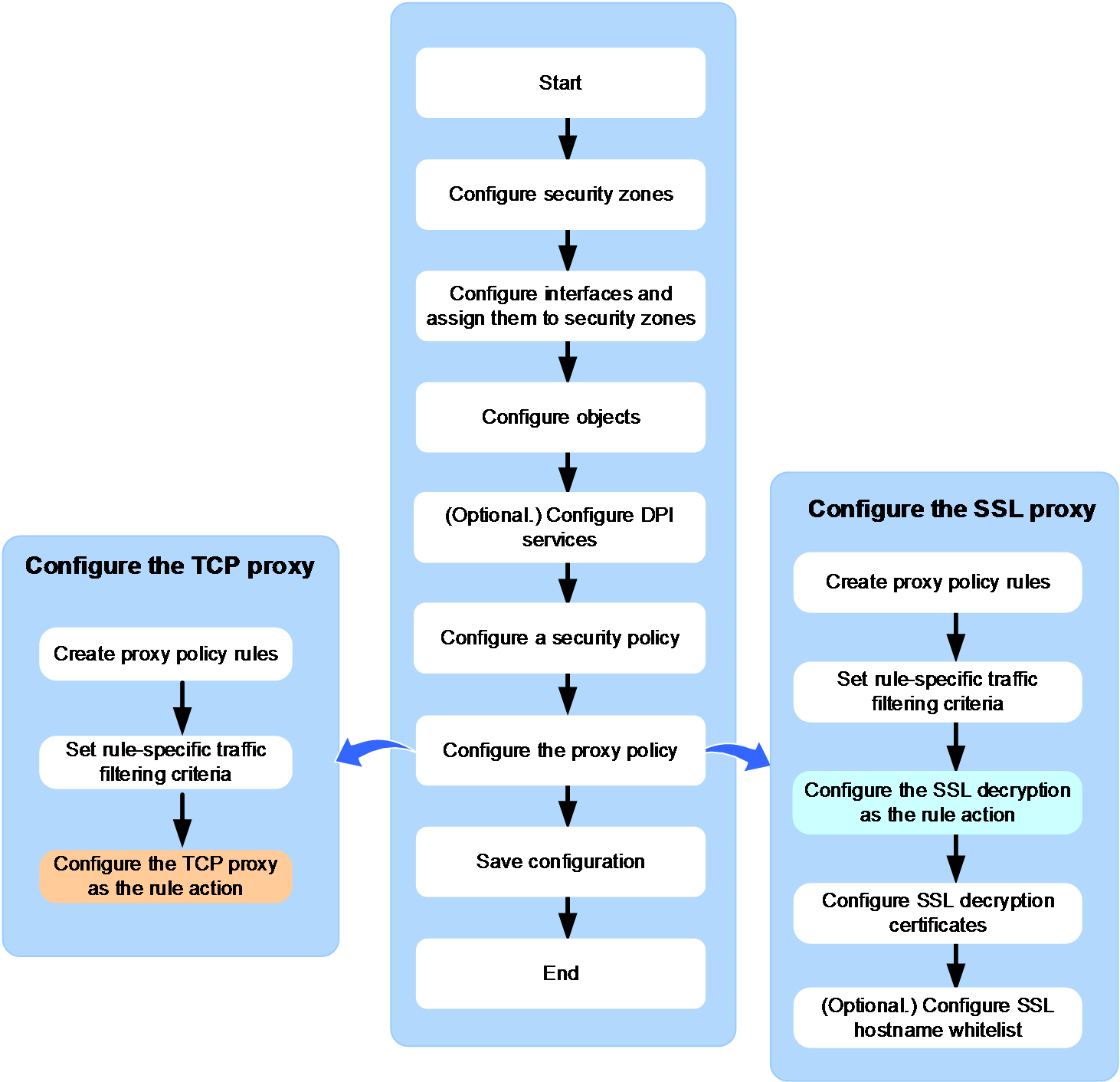

Proxy policy configuration procedure summary
Figure 6 shows how to configure the proxy policy.
Figure 6 Proxy policy configuration procedure
Proxy policy tasks at a glance
To configure the proxy policy:
1.     Configuring attributes in the proxy policy
a.     Setting the default action for the proxy policy
b.     Creating a proxy policy rule
c.     Configuring the traffic filtering criteria for a proxy policy rule
d.     Setting the action for a proxy policy rule
2.     (Optional.) Managing proxy policy rules
a.     Changing the rule match order
b.     Disabling a proxy policy rule
3.     Configuring SSL decryption certificates
The SSL decryption certifications are required in the scenario of protecting internal clients.
a.     Importing an SSL decryption certificate
b.     (Optional.) Channing the credibility of an SSL decryption certificate
c.     (Optional.) Deleting an SSL decryption certificate
4.     Configuring internal server certificates
The internal server certificates are required in the scenario of protecting internal servers.
a.     Importing an internal server certificate
b.     (Optional.) Deleting an internal server certificate
5.     (Optional.) Configuring the SSL proxy whitelist
a.     Add a hostname to the user-defined SSL hostname whitelist
b.     Disabling hostnames on the predefined SSL hostname whitelist
c.     Activating SSL hostname whitelist settings
A proxy policy rule that does not contain any filtering criteria matches all packets.
A filtering criterion is ignored during packet matching if it is associated with a nonexistent or empty object group.
2.     Enter proxy policy view.
app-proxy-policy
3.     Enter the view of a proxy policy rule.
rule { rule-id | [ rule-id ] name rule-name }
4.     Configure the traffic filtering criteria as needed:
¡     Configure a source security zone filtering criterion.
source-zone source-zone-name
By default, a proxy policy rule does not contain any source security zone filtering criterion.
¡     Configure a destination security zone filtering criterion.
destination-zone destination-zone-name
By default, a proxy policy rule does not contain any destination security zone filtering criterion.
¡     Configure a source IP address filtering criterion.
source-ip object-group object-group-name
By default, a proxy policy rule does not contain any source IP address filtering criterion.
¡     Configure a destination IP address filtering criterion.
destination-ip object-group object-group-name
By default, a proxy policy rule does not contain any destination IP address filtering criterion.
¡     Configure a service filtering criterion.
service object-group { object-group-name | any }
By default, a proxy policy rule does not contain any service filtering criterion.
¡     Configure a user filtering criterion.
user username [ domain domain-name ]
By default, a proxy policy rule does not contain any user filtering criterion.
¡     Configure a user group filtering criterion.
user-group user-group-name [ domain domain-name ]
By default, a proxy policy rule does not contain any user group filtering criterion.
app-proxy-policy
4.     Set the action for traffic matching the proxy policy rule.
action { no-proxy | ssl-decrypt | tcp-proxy }
By default, the device transmits packets that match a proxy policy rule directly without TCP or SSL proxy.
5.     Specify an SSL decryption protection mode for the proxy policy rule.
ssl-decrypt protect-mode { client | server }
By default, the SSL decryption protection mode of a proxy policy rule is client.
Configure this command only when the SSL decryption action is used as the default action for the proxy policy.
