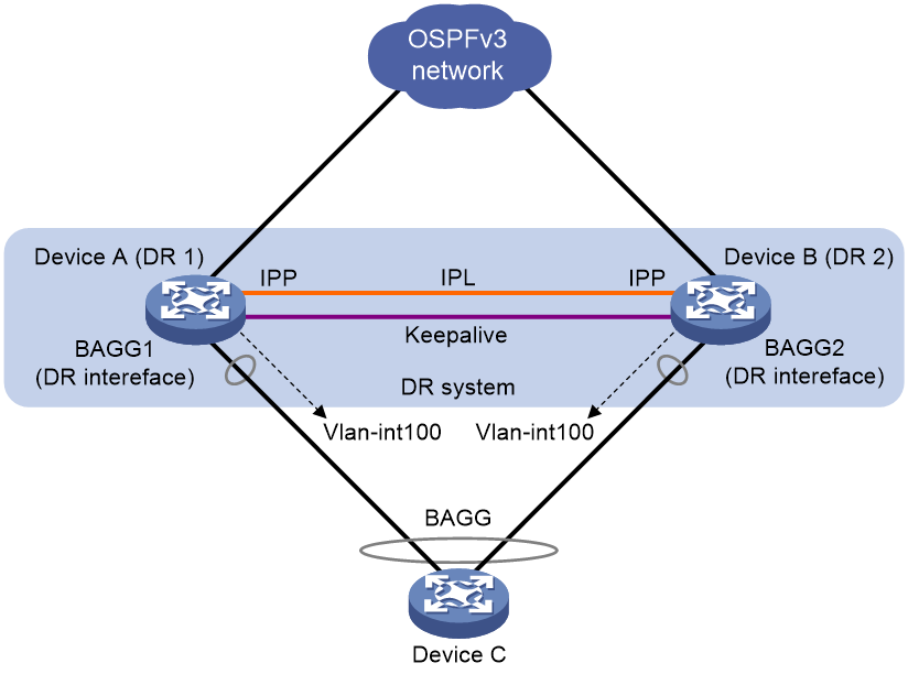

Establishing OSPFv3 neighbor relationships on a DRNI network
When a customer-side device accesses the OSPFv3 network through both DR member devices in a DR system, the DR member devices provide Layer 3 gateway services. The gateway interfaces (such as VLAN or VSI interfaces) on different DR member devices generate the same link-local address when they have the same IP address and MAC address. In this case, the DR member devices cannot establish OSPFv3 neighbor relationships with the customer-side device.
To resolve this issue, configure the gateway interfaces to use DRNI virtual IPv6 addresses for OSPFv3 neighbor relationship establishment. The DRNI virtual IPv6 address configured for a gateway interface must be a link-local address because OSPFv3 uses link-local addresses for OSPFv3 neighbor relationship establishment. For more information about DRNI, see DRNI configuration in Layer 2—LAN Switching Configuration Guide.
As shown in Figure 1, Device C accesses the OSPFv3 network through the DR system that consists of Device A and Device B. Device A and Device B provide Layer 3 gateway services. The gateway interface VLAN-interface 100 on Device A and the gateway interface VLAN-interface 100 on Device B have the same IP address and the same MAC address. To ensure that both Device A and Device B can establish an OSPFv3 neighbor relationship with Device C, configure different DRNI virtual IPv6 addresses for the VLAN interfaces on Device A and Device B.
Figure 1 OSPFv3 neighbor relationship establishment on a DRNI network

3.     Specify a link-local address as the DRNI virtual IPv6 address to be assigned to the interface.
port drni ipv6 virtual-ip ipv6-address link-local
By default, no DRNI virtual IPv6 address is assigned to an interface.
For more information about this command, see DRNI commands in Layer 2—LAN Switching Ethernet Command Reference.
