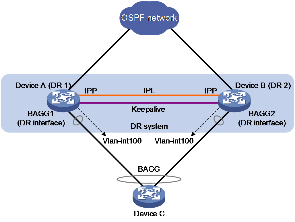

Establishing OSPF neighbor relationships on a DRNI network
When a customer-side device accesses the OSPF network through both DR member devices in a DR system, the DR member devices provide Layer 3 gateway services. The gateway interfaces (such as VLAN or VSI interfaces) on different DR member devices might have the same IP address and the same MAC address. In this case, the DR member devices cannot establish OSPF neighbor relationships with the customer-side device.
To resolve this issue, configure the gateway interfaces to use DRNI virtual IPv4 addresses for OSPF neighbor relationship establishment. For more information about DRNI, see DRNI configuration in Layer 2—LAN Switching Configuration Guide.
As shown in Figure 7, Device C accesses the OSPF network through the DR system that consists of Device A and Device B. Device A and Device B provide Layer 3 gateway services. The gateway interface VLAN-interface 100 on Device A and the gateway interface VLAN-interface 100 on Device B have the same IP address and the same MAC address. To ensure that both Device A and Device B can establish an OSPF neighbor relationship with Device C, perform the following tasks:
1.     Configure different DRNI virtual IPv4 addresses for the VLAN interfaces on Device A and Device B.
2.     Configure the VLAN interface to use the DRNI virtual IPv4 address for OSPF neighbor relationship establishment on both Device A and Device B.
Figure 7 OSPF neighbor relationship establishment on a DRNI network
2.     Enter interface view.
3.     Configure a DRNI virtual IPv4 address for the interface.
port drni virtual-ip ipv4-address { mask-length | mask }
By default, no DRNI virtual IPv4 address is configured for an interface.
A DRNI virtual IPv4 address is similar to a secondary IP address. For more information about this command, see DRNI commands in Layer 2—LAN Switching Command Reference.
4.     Configure the interface to use the DRNI virtual IPv4 address for OSPF neighbor relationship establishment.
ospf peer sub-address enable ip-address
By default, an interface uses the primary IP address for OSPF neighbor relationship establishment.
The IP address specified in this command must be the same as the IPv4 address specified in the port drni virtual-ip command.
