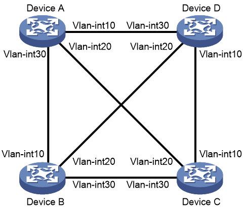

IS-IS topology
Figure 2 shows one IS-IS network topology. Area 1 is the backbone that comprises a set of Level-2 routers. The other four areas are non-backbone areas connected to the backbone through Level-1-2 routers.
Figure 2 IS-IS topology 1
Figure 3 shows another IS-IS topology. No area is defined as the backbone in this topology. The backbone comprises all contiguous Level-2 and Level-1-2 routers in different areas. The IS-IS backbone does not need to be a specific area.
Figure 3 IS-IS topology 2
Both the Level-1 and Level-2 routers use the SPF algorithm to generate the shortest path tree.

Configuring IPv6 IS-IS MTR
On a network, IPv4 and IPv6 topologies must be consistent so that both IPv6 IS-IS and IPv4 IS-IS can use the SPF algorithm to perform route calculation. If they are different, routers supporting both IPv4 and IPv6 might send IPv6 packets to routers that do not support IPv6, resulting in packet loss.
To resolve this issue, configure IPv6 IS-IS MTR to perform route calculation separately in IPv4 and IPv6 topologies.
Figure 7 Network diagram
As shown in Figure 7, the numbers refer to the link costs. Router A, Router B, and Router D support both IPv4 and IPv6. Router C supports only IPv4 and cannot forward IPv6 packets.
Enable IPv6 IS-IS MTR on Router A, Router B, Router C, and Router D to make them perform route calculation separately in IPv4 and IPv6 topologies. With this configuration, Router A does not forward IPv6 packets destined to Router D through Router B, avoiding packet loss.
As a best practice to avoid route calculation failures, configure this feature when both IPv4 and IPv6 topologies exist in the network.

Limiting LSP flooding
As shown in Figure 8, many P2P links exist, Devices A, B, C and D run IS-IS. When Device A generates an LSP, it floods the LSP out of VLAN-interface10, VLAN-interface20, and VLAN-interface30. After Device D receives the LSP from VLAN-interface30, it floods it out of VLAN-interface10 and VLAN-interface20 to Device B and Device C. However, Device B and Device C have already received the LSP from Device A. Repeated LSP flooding consumes extra bandwidth.
Figure 8 Network diagram of a fully meshed network
To avoid this problem, you can add interfaces to a mesh group or block some interfaces.
·     An interface in a mesh group floods a received LSP only to interfaces not in the mesh group.
·     A blocked interface sends LSPs only after receiving LSP requests.
Before you configure this task, you must consider redundancy for interfaces in case LSP packets cannot be flooded because of link failures.

As shown in Figure 10, Switch A, Switch B, Switch C, and Switch D reside in an IS-IS AS.
Switch A and B are Level-1 switches, Switch D is a Level-2 switch, and Switch C is a Level-1-2 switch. Switch A, Switch B, and Switch C are in Area 10, and Switch D is in Area 20.
Figure 10 Network diagram

1.     Configure IP addresses for interfaces. (Details not shown.)
2.     Configure IS-IS:
# Configure Switch A.
<SwitchA> system-view
[SwitchA] isis 1
[SwitchA-isis-1] is-level level-1
[SwitchA-isis-1] network-entity 10.0000.0000.0001.00
[SwitchA-isis-1] quit
[SwitchA-Vlan-interface100] isis enable 1
# Configure Switch B.
<SwitchB> system-view
[SwitchB] isis 1
[SwitchB-isis-1] is-level level-1
[SwitchB-isis-1] network-entity 10.0000.0000.0002.00
[SwitchB-isis-1] quit
[SwitchB] interface vlan-interface 200
[SwitchB-Vlan-interface200] isis enable 1
[SwitchB-Vlan-interface200] quit
# Configure Switch C.
<SwitchC> system-view
[SwitchC] isis 1
[SwitchC-isis-1] network-entity 10.0000.0000.0003.00
[SwitchC-isis-1] quit
[SwitchC] interface vlan-interface 100
[SwitchC-Vlan-interface100] isis enable 1
[SwitchC-Vlan-interface100] quit
[SwitchC] interface vlan-interface 200
[SwitchC-Vlan-interface200] isis enable 1
[SwitchC-Vlan-interface200] quit
[SwitchC] interface vlan-interface 300
[SwitchC-Vlan-interface300] isis enable 1
[SwitchC-Vlan-interface300] quit
# Configure Switch D.
<SwitchD> system-view
[SwitchD] isis 1
[SwitchD-isis-1] is-level level-2
[SwitchD-isis-1] network-entity 20.0000.0000.0004.00
[SwitchD-isis-1] quit
[SwitchD] interface vlan-interface 100
[SwitchD-Vlan-interface100] isis enable 1
[SwitchD-Vlan-interface100] quit
[SwitchD] interface vlan-interface 300
[SwitchD-Vlan-interface300] isis enable 1
[SwitchD-Vlan-interface300] quit
# Display the IS-IS LSDB on each switch to verify the LSPs.

Example: Configuring DIS election
As shown in Figure 11, Switches A, B, C, and D reside in IS-IS area 10 on a broadcast network (Ethernet). Switch A and Switch B are Level-1-2 switches, Switch C is a Level-1 switch, and Switch D is a Level-2 switch.
Change the DIS priority of Switch A to make it elected as the Level-1-2 DIS router.
Figure 11 Network diagram
IMPORTANT
IMPORTANT:
By default, interfaces on the device are disabled (in ADM or Administratively Down state). To have an interface operate, you must use the undo shutdown command to enable that interface.
2.     Enable IS-IS:
[SwitchA] isis 1
[SwitchB] isis 1
[SwitchB-Vlan-interface100] isis enable 1
[SwitchC] isis 1
[SwitchD] isis 1
[SwitchD-isis-1] network-entity 10.0000.0000.0004.00
# Display information about IS-IS neighbors on Switch A.
[SwitchA] display isis peer
                          Peer information for IS-IS(1)
  System ID: 0000.0000.0002
  Interface: Vlan-interface100       Circuit Id: 0000.0000.0003.01
  State: Up     HoldTime: 21s        Type: L1(L1L2)     PRI: 64
  System ID: 0000.0000.0003
  State: Up     HoldTime: 27s        Type: L1           PRI: 64
  Interface: Vlan-interface100       Circuit Id: 0000.0000.0004.01
  State: Up     HoldTime: 28s        Type: L2(L1L2)     PRI: 64
  System ID: 0000.0000.0004
  State: Up     HoldTime: 30s        Type: L2          PRI: 64
# Display information about IS-IS interfaces on Switch A.
[SwitchA] display isis interface
                       Interface information for IS-IS(1)
  Index     IPv4 state      IPv6 state     Circuit ID   MTU   Type   DIS
  00001     Up              Down           1            1497  L1/L2  No/No
# Display information about IS-IS interfaces on Switch C.
[SwitchC] display isis interface
  00001     Up              Down           1            1497  L1/L2  Yes/No
# Display information about IS-IS interfaces on Switch D.
[SwitchD] display isis interface
  00001     Up              Down           1            1497  L1/L2  No/Yes
The output shows that when the default DIS priority is used, Switch C is the DIS for Level-1, and Switch D is the DIS for Level-2. The pseudonodes of Level-1 and Level-2 are 0000.0000.0003.01 and 0000.0000.0004.01.
#Configure the DIS priority of Switch A.
[SwitchA-Vlan-interface100] isis dis-priority 100
# Display IS-IS neighbors on Switch A.
  Interface: Vlan-interface100       Circuit Id: 0000.0000.0001.01
  00001     Up              Down           1            1497  L1/L2  Yes/Yes
The output shows that after the DIS priority configuration, Switch A becomes the DIS for Level-1-2, and the pseudonode is 0000.0000.0001.01.
# Display information about IS-IS neighbors and interfaces on Switch C.
[SwitchC] display isis peer
  State: Up     HoldTime: 25s        Type: L1           PRI: 64
  System ID: 0000.0000.0001
  State: Up     HoldTime: 7s         Type: L1           PRI: 100
# Display information about IS-IS neighbors and interfaces on Switch D.
[SwitchD] display isis peer
  State: Up     HoldTime: 9s         Type: L2           PRI: 100
  State: Up     HoldTime: 28s        Type: L2           PRI: 64

Example: Configuring IS-IS authentication
As shown in Figure 13, Switch A, Switch B, Switch C, and Switch D reside in the same IS-IS routing domain. Run IS-IS among them.
Switch A, Switch B, and Switch C belong to Area 10, and Switch D belongs to Area 20.
·     Configure neighbor relationship authentication between neighbors.
·     Configure area authentication in Area 10 to prevent untrusted routes from entering into the area.
·     Configure routing domain authentication on Switch C and Switch D to prevent untrusted routes from entering the routing domain.
Figure 13 Network diagram
IMPORTANT
IMPORTANT:

IPv6 IS-IS configuration examples
Example: Configuring IPv6 IS-IS basics
As shown in Figure 18, Switch A, Switch B, Switch C, and Switch D, all enabled with IPv6, reside in the same AS. Configure IPv6 IS-IS on the switches so that they can reach each other.
Switch A and Switch B are Level-1 switches, Switch D is a Level-2 switch, and Switch C is a Level-1-2 switch.
Figure 18 Network diagram
IMPORTANT
IMPORTANT:
1.     Configure IPv6 addresses for interfaces. (Details not shown.)
2.     Configure IPv6 IS-IS:
[SwitchA] isis 1
[SwitchA-isis-1] address-family ipv6
[SwitchA-isis-1-ipv6] quit
[SwitchA-Vlan-interface100] isis ipv6 enable 1
[SwitchB] isis 1
[SwitchB-isis-1] address-family ipv6
[SwitchB-isis-1-ipv6] quit
[SwitchB-Vlan-interface200] isis ipv6 enable 1
[SwitchC] isis 1
[SwitchC-isis-1] address-family ipv6
[SwitchC-isis-1-ipv6] quit
[SwitchC-Vlan-interface100] isis ipv6 enable 1
[SwitchC-Vlan-interface200] isis ipv6 enable 1
[SwitchC-Vlan-interface300] isis ipv6 enable 1
[SwitchD] isis 1
[SwitchD-isis-1] address-family ipv6
[SwitchD-isis-1-ipv6] quit
[SwitchD-Vlan-interface300] isis ipv6 enable 1
[SwitchD] interface vlan-interface 301
[SwitchD-Vlan-interface301] isis ipv6 enable 1
[SwitchD-Vlan-interface301] quit
# Display the IPv6 IS-IS routing table on Switch A.
[SwitchA] display isis route ipv6
                         Route information for IS-IS(1)
                         Level-1 IPv6 Forwarding Table
 Destination : ::                                      PrefixLen: 0
 Flag        : R/-/-                                   Cost     : 10
 Next Hop    : FE80::200:FF:FE0F:4                     Interface: Vlan100
 Destination : 2001:1::                                PrefixLen: 64
 Flag        : D/L/-                                   Cost     : 10
 Next Hop    : Direct                                  Interface: Vlan100
 Destination : 2001:2::                                PrefixLen: 64
 Flag        : R/-/-                                   Cost     : 20
 Destination : 2001:3::                                PrefixLen: 64
      Flags: D-Direct, R-Added to Rib, L-Advertised in LSPs, U-Up/Down Bit Set

Example: Configuring BFD for IPv6 IS-IS
As shown in Figure 19:
·     Configure IPv6 IS-IS on Switch A and Switch B so that they can reach other.
·     Enable BFD on VLAN-interface 10 of Switch A and Switch B.
After the link between Switch B and the Layer 2 switch fails, BFD can quickly detect the failure and notify IPv6 IS-IS of the failure. Then Switch A and Switch B communicate through Switch C.
Figure 19 Network diagram
Table 6 Interface and IP address assignment
Device
Interface
IPv6 address
Device
Interface
IPv6 address
Switch A
Vlan-int10
2001::1/64
Switch B
Vlan-int10
2001::2/64
Vlan-int11
2001:2::1/64
Vlan-int13
2001:3::2/64
Switch C
Vlan-int11
2001:2::2/64
Vlan-int13
2001:3::1/64
IMPORTANT
IMPORTANT:
[SwitchA] isis 1
[SwitchA-Vlan-interface10] isis ipv6 enable 1
[SwitchA-Vlan-interface10] quit
[SwitchA] interface vlan-interface 11
[SwitchA-Vlan-interface11] isis ipv6 enable 1
[SwitchA-Vlan-interface11] quit
[SwitchB] isis 1
[SwitchB] interface vlan-interface 10
[SwitchB-Vlan-interface10] isis ipv6 enable 1
[SwitchB-Vlan-interface10] quit
[SwitchB] interface vlan-interface 13
[SwitchB-Vlan-interface13] isis ipv6 enable 1
[SwitchB-Vlan-interface13] quit
[SwitchC] isis 1
[SwitchC] interface vlan-interface 11
[SwitchC-Vlan-interface11] isis ipv6 enable 1
[SwitchC-Vlan-interface11] quit
[SwitchC] interface vlan-interface 13
[SwitchC-Vlan-interface13] isis ipv6 enable 1
[SwitchC-Vlan-interface13] quit
3.     Configure BFD functions:
# Enable BFD and configure BFD parameters on Switch A.
[SwitchA] bfd session init-mode active
[SwitchA-Vlan-interface10] isis ipv6 bfd enable
[SwitchA-Vlan-interface10] bfd min-transmit-interval 500
[SwitchA-Vlan-interface10] bfd min-receive-interval 500
[SwitchA-Vlan-interface10] bfd detect-multiplier 7
[SwitchA-Vlan-interface10] return
# Enable BFD and configure BFD parameters on Switch B.
[SwitchB] bfd session init-mode active
[SwitchB-Vlan-interface10] isis ipv6 bfd enable
[SwitchB-Vlan-interface10] bfd min-transmit-interval 500
[SwitchB-Vlan-interface10] bfd min-receive-interval 500
[SwitchB-Vlan-interface10] bfd detect-multiplier 6
# Display BFD session information on Switch A.
<SwitchA> display bfd session
 Total Session Num: 1            Init Mode: Active
 IPv6 session working in control packet mode:
     Local Discr: 1441                Remote Discr: 1450
       Source IP: FE80::20F:FF:FE00:1202 (link-local address of Vlan-interface10 on Switch A)
  Destination IP: FE80::20F:FF:FE00:1200 (link-local address of Vlan-interface10 on Switch B)
   Session State: Up                     Interface: Vlan10
       Hold Time: 2319ms
# Display routes destined for 2001:4::0/64 on Switch A.
<SwitchA> display ipv6 routing-table 2001:4::0 64
Summary Count : 1
Destination: 2001:4::/64                                 Protocol  : IS_L1
NextHop    : FE80::20F:FF:FE00:1200                      Preference: 15
Interface  : Vlan10                                      Cost      : 10
The output shows that Switch A and Switch B communicate through VLAN-interface 10. Then the link over VLAN-interface 10 fails.
Summary Count : 1
NextHop    : FE80::BAAF:67FF:FE27:DCD0                   Preference: 15
Interface  : Vlan11                                      Cost      : 20
The output shows that Switch A and Switch B communicate through VLAN-interface 11.
