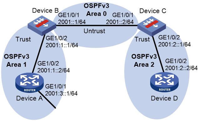

Example: Configuring OSPFv3 stub area
As shown in Figure 2:
· Enable OSPFv3 on all devices.
· Split the AS into three areas.
· Configure Device B and Device C as ABRs to forward routing information between areas.
· Configure Area 2 as a stub area to reduce LSAs in the area without affecting route reachability.

1. Configure IPv6 addresses for interfaces correctly according to Figure 2.
a. Configure an IP address for GigabitEthernet 1/0/1.
<DeviceB> system-view
[DeviceB-GigabitEthernet1/0/1] ipv6 address 2001::1 64
[DeviceB-GigabitEthernet1/0/1] quit
b. Configure IP addresses for other interfaces in the same way GigabitEthernet 1/0/1 is configured. (Details not shown.)

4. Configure basic OSPFv3 functions:
# On Device A, enable OSPFv3 and specify the device ID as 1.1.1.1.
<DeviceA> system-view
[DeviceA] ospfv3 1
[DeviceA-ospfv3-1] router-id 1.1.1.1
[DeviceA-ospfv3-1] quit
[DeviceA-GigabitEthernet1/0/1] ospfv3 1 area 1
[DeviceA-GigabitEthernet1/0/1] quit
[DeviceA] interface gigabitethernet 1/0/2
[DeviceA-GigabitEthernet1/0/2] ospfv3 1 area 1
[DeviceA-GigabitEthernet1/0/2] quit
# On Device B, enable OSPFv3 and specify the device ID as 2.2.2.2.
[DeviceB] ospfv3 1
[DeviceB-ospfv3-1] router-id 2.2.2.2
[DeviceB-ospfv3-1] quit
[DeviceB-GigabitEthernet1/0/1] ospfv3 1 area 0
[DeviceB] interface gigabitethernet 1/0/2
[DeviceB-GigabitEthernet1/0/2] ospfv3 1 area 1
[DeviceB-GigabitEthernet1/0/2] quit
# On Device C, enable OSPFv3 and specify the device ID as 3.3.3.3.
[DeviceC] ospfv3 1
[DeviceC-ospfv3-1] router-id 3.3.3.3
[DeviceC-ospfv3-1] quit
[DeviceC] interface gigabitethernet 1/0/1
[DeviceC-GigabitEthernet1/0/1] ospfv3 1 area 0
[DeviceC-GigabitEthernet1/0/1] quit
[DeviceC] interface gigabitethernet 1/0/2
[DeviceC-GigabitEthernet1/0/2] ospfv3 1 area 2
[DeviceC-GigabitEthernet1/0/2] quit
# On Device D, enable OSPFv3 and specify the device ID as 4.4.4.4.
<DeviceD> system-view
[DeviceD] ospfv3 1
[DeviceD-ospfv3-1] router-id 4.4.4.4
[DeviceD-ospfv3-1] quit
[DeviceD] interface gigabitethernet 1/0/2
[DeviceD-GigabitEthernet1/0/2] ospfv3 1 area 2
[DeviceD-GigabitEthernet1/0/2] quit
5. Configure Area 2 as a stub area:
# Configure Device D.
[DeviceD] ospfv3
[DeviceD-ospfv3-1] area 2
[DeviceD-ospfv3-1-area-0.0.0.2] stub
[DeviceD-ospfv3-1-area-0.0.0.2] quit
# Configure Device C, and specify the cost of the default route sent to the stub area as 10.
[DeviceC] ospfv3
[DeviceC-ospfv3-1] area 2
[DeviceC-ospfv3-1-area-0.0.0.2] stub
[DeviceC-ospfv3-1-area-0.0.0.2] default-cost 10
# Display OSPFv3 routing table on Device D.
[DeviceD] display ospfv3 routing
OSPFv3 Process 1 with Router ID 4.4.4.4
I - Intra area route, E1 - Type 1 external route, N1 - Type 1 NSSA route
IA - Inter area route, E2 - Type 2 external route, N2 - Type 2 NSSA route
* - Selected route
*Destination: ::/0
Type : IA Area : 0.0.0.2
AdvRouter : 1.1.1.1 Preference : 10
NibID : 0x23000002 Cost : 11
Interface : GE1/0/2 BkInterface: N/A
Nexthop : FE80::CCA:73FF:FEA2:206
BkNexthop : N/A
*Destination: 2001::/64
NibID : 0x23000002 Cost : 2
BkNexthop : N/A
*Destination: 2001:1::/64
NibID : 0x23000002 Cost : 3
BkNexthop : N/A
*Destination: 2001:2::/64
Type : I Area : 0.0.0.2
AdvRouter : 4.4.4.4 Preference : 10
NibID : 0x23000001 Cost : 1
Nexthop : ::
BkNexthop : N/A
*Destination: 2001:3::/64
NibID : 0x23000002 Cost : 4
BkNexthop : N/A
Total: 5
Intra area: 1 Inter area: 4 ASE: 0 NSSA: 0
# Verify that devices in area 1 can ping devices in area 2, and vice versa.
