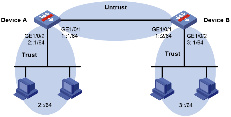

RIPng configuration examples
Example: Configuring basic RIPng
As shown in Figure 2, Device A and Device B are attached to networks 2::/64 and 3::/64, respectively. Configure RIPng on Device A and Device B to enable communication between the two networks.

# Display the RIPng routing table of Device A.
[Device A] display ripng 1 route
Route Flags: A - Aging, S - Suppressed, G - Garbage-collect, D - Direct
O - Optimal, F - Flush to RIB
Peer FE80::76A5::A3FF:FE7B:205 on GigabitEthernet1/0/1
Destination 3::/64,
via FE80::76A5:A3FF:FE7B:205, cost 1, tag 0, AOF, 17 secs
Local route
Destination 2::/64,
via ::, cost 0, tag 0, DOF
Destination 1::/64,
The output shows that the hosts in network 2::/64 can communicate with the hosts in network 3::/64.
