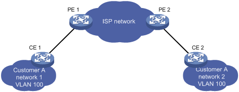

As shown in Figure 1, Customer A's network is divided into network 1 and network 2, which are connected by the service provider network. For Customer A's network to implement Layer 2 protocol calculations, the Layer 2 protocol packets must be transmitted across the service provider network.
Upon receiving a Layer 2 protocol packet, the PEs cannot determine whether the packet is from the customer network or the service provider network. They must deliver the packet to the CPU for processing. In this case, the Layer 2 protocol calculation in Customer A's network is mixed with the Layer 2 protocol calculation in the service provider network. Neither the customer network nor the service provider network can implement independent Layer 2 protocol calculations.
Figure 1 L2PT application scenarios
L2PT is introduced to resolve the problem. L2PT provides the following functions:

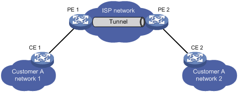

As shown in Figure 2, L2PT operates as follows:
·          When a port of PE 1 receives a Layer 2 protocol packet from the customer network in a VLAN, it performs the following operations:
¡  Multicasts the packet out of all customer-facing ports in the VLAN except the receiving port.
¡  Changes the packet's destination multicast MAC address to a specified multicast address, and multicasts it out of all ISP-facing ports in the VLAN. The modified packet is called the tunneled packet.
·          When a port of PE 2 in the VLAN receives the tunneled packet from the service provider network, it performs the following operations:
¡  Multicasts the packet out of all ISP-facing ports in the VLAN except the receiving port.
¡  Changes the destination multicast MAC address to the original MAC address, and multicasts the packet out of all customer-facing ports in the VLAN.
