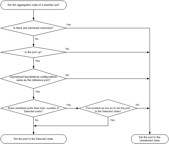

Reference port selection process
When setting the aggregation states of the ports in an aggregation group, the system automatically chooses a member port as the reference port. A Selected port must have the same operational key and attribute configurations as the reference port.
The system chooses a reference port from the member ports in up state.
The candidate reference ports are organized into different priority levels following these rules:
1.        In descending order of port priority.
2.        Full duplex.
3.        In descending order of speed.
4.        Half duplex.
5.        In descending order of speed.
From the candidate ports with the same attribute configurations as the aggregate interface, the one with the highest priority level is chosen as the reference port.
·          If multiple ports have the same priority level, the port that has been Selected (if any) is chosen. If multiple ports with the same priority level have been Selected, the one with the smallest port number is chosen.
·          If multiple ports have the same priority level and none of them has been Selected, the port with the smallest port number is chosen.
To identify the port numbers of aggregation member ports, execute the display link-aggregation verbose command and examine the Index field in the command output.

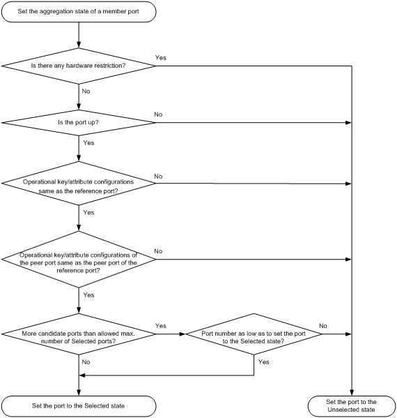

 Setting the aggregation state of each member port
After the reference port is chosen, the system sets the aggregation state of each member port in the static aggregation group.
Figure 2 Setting the aggregation state of a member port in a static aggregation group
After the limit on Selected ports is reached, the aggregation state of a new member port varies by following conditions:
·          The port is placed in Unselected state if the port and the Selected ports have the same port priority. This mechanism prevents traffic interruption on the existing Selected ports. A device reboot can cause the device to recalculate the aggregation states of member ports.
·          The port is placed in Selected state when the following conditions are met:
¡  The port and the Selected ports have different port priorities, and the port has a higher port priority than a minimum of one Selected port.
¡  The port has the same attribute configurations as the aggregate interface.
Any operational key or attribute configuration change might affect the aggregation states of link aggregation member ports.

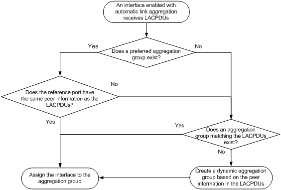

Automatic link aggregation
Automatic link aggregation enables two devices to automatically create a dynamic link aggregation between them by using LLDP.
After you enable automatic link aggregation and LLDP on two connected devices, they automatically establish a dynamic link aggregation based on the information in incoming LLDP frames. The devices each automatically create a dynamic aggregate interface and assign the redundant ports connected to the peer to the aggregation group of that interface. When assigning the first member port to the aggregate group, the device synchronizes the member port's attribute configuration to the aggregate interface.
An automatically created dynamic aggregation group selects a reference port and Selected ports as described in "How dynamic link aggregation works." The aggregation group creation methods do not change the processes of reference port selection and Selected port selection.
After the reference port is chosen, the system with the smaller system ID sets the state of each member port on its side.
Figure 4 Setting the state of a member port in a dynamic aggregation group
The system with the greater system ID can detect the aggregation state changes on the peer system. The system with the greater system ID sets the aggregation state of local member ports the same as their peer ports.
When you aggregate interfaces in dynamic mode, follow these guidelines:
·          A dynamic link aggregation group chooses only full-duplex ports as the Selected ports.
·          For stable aggregation and service continuity, do not change the operational key or attribute configurations on any member port.
·          After the Selected port limit is reached, a newly joining port becomes a Selected port if it is more eligible than a current Selected port.

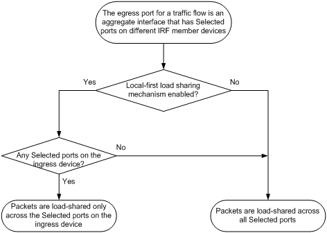

(Optional.) Configuring load sharing for link aggregation groups:
·         Setting load sharing modes for link aggregation groups
·         Enabling local-first load sharing for link aggregation

Configuring automatic link aggregation
Overview
On a SmartMC network, you can use automatic link aggregation to aggregate the redundant physical links between devices to ease management and increase bandwidth and availability. For more information about SmartMC, see Network Management and Monitoring Configuration Guide.
On an interface, the port link-aggregation group setting takes precedence over automatic link aggregation. The interface will not be added to the aggregation group of an automatically created aggregate interface if it has been the member port of a manually created aggregate interface.
When automatic link aggregation is enabled, subinterface creation might fail on LLDP-enabled Layer 3 Ethernet interfaces.
As a best practice to ensure correct operation of dynamic aggregation groups, do not use automatic link aggregation and automatic member port assignment together.
Overview
Use local-first load sharing in a multichassis link aggregation scenario to distribute traffic preferentially across member ports on the ingress card or device.
When you aggregate ports on different member devices in an IRF fabric, you can use local-first load sharing to reduce traffic on IRF links, as shown in Figure 6. For more information about IRF, see Virtual Technologies Configuration Guide.
This feature takes effect only on known unicast traffic.
Figure 6 Load sharing for multichassis link aggregation in an IRF fabric
This feature is available only in IRF mode.
To perform local-first load sharing on an aggregation, you must configure local-first load sharing both globally and on the aggregate interface.
Configuration procedure

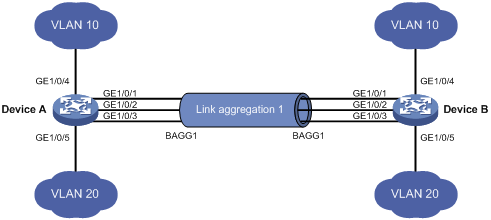

Layer 2 static aggregation configuration example
Network requirements
On the network shown in Figure 7, perform the following tasks:
·          Configure a Layer 2 static aggregation group on both Device A and Device B.
·          Enable VLAN 10 at one end of the aggregate link to communicate with VLAN 10 at the other end.
·          Enable VLAN 20 at one end of the aggregate link to communicate with VLAN 20 at the other end.
Figure 7 Network diagram

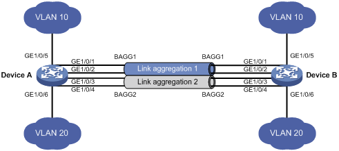

Layer 2 aggregation load sharing configuration example
On the network shown in Figure 9, perform the following tasks:
·          Configure Layer 2 static aggregation groups 1 and 2 on Device A and Device B, respectively.
·          Configure link aggregation groups 1 and 2 to load share traffic across aggregation group member ports.
¡  Configure link aggregation group 1 to load share packets based on source MAC addresses.
¡  Configure link aggregation group 2 to load share packets based on destination MAC addresses.
Figure 9 Network diagram
