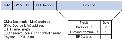

STP protocol frames
STP uses bridge protocol data units (BPDUs), also known as configuration messages, as its protocol frames. This chapter uses BPDUs to represent all types of spanning tree protocol frames.
STP-enabled devices exchange BPDUs to establish a spanning tree. BPDUs contain sufficient information for the devices to complete spanning tree calculation.
STP uses two types of BPDUs, configuration BPDUs and topology change notification (TCN) BPDUs.
Configuration BPDUs
Devices exchange configuration BPDUs to elect the root bridge and determine port roles. Figure 1 shows the configuration BPDU format.
Figure 1 Configuration BPDU format
The payload of a configuration BPDU includes the following fields:
·          Protocol ID—Fixed at 0x0000, which represents IEEE 802.1d.
·          Protocol version ID—Spanning tree protocol version ID. The protocol version ID for STP is 0x00.
·          BPDU type—Type of the BPDU. The value is 0x00 for a configuration BPDU.
·          Flags—An 8-bit field indicates the purpose of the BPDU. The lowest bit is the Topology Change (TC) flag. The highest bit is the Topology Change Acknowledge (TCA) flag. All other bits are reserved.
·          Root ID—Root bridge ID formed by the priority and MAC address of the root bridge.
·          Root path cost—Cost of the path to the root bridge.
·          Bridge ID—Designated bridge ID formed by the priority and MAC address of the designated bridge.
·          Port ID—Designated port ID formed by the priority and global port number of the designated port.
·          Message age—Age of the configuration BPDU while it propagates in the network.
·          Max age—Maximum age of the configuration BPDU stored on the switch.
·          Hello time—Configuration BPDU transmission interval.
·          Forward delay—Delay for STP bridges to transit port state.
Devices use the root bridge ID, root path cost, designated bridge ID, designated port ID, message age, max age, hello time, and forward delay for spanning tree calculation.

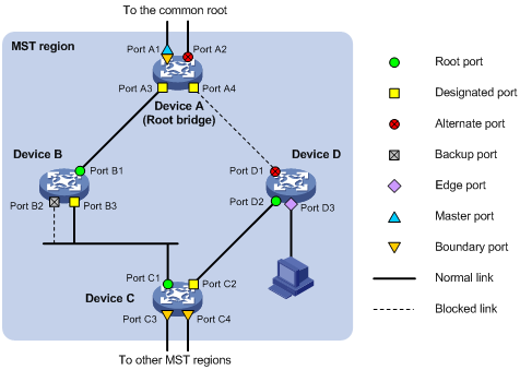

Designated bridge and designated port
Classification
Designated bridge
Designated port
For a device
Device directly connected to the local device and responsible for forwarding BPDUs to the local device.
Port through which the designated bridge forwards BPDUs to this device.
For a LAN
Device responsible for forwarding BPDUs to this LAN segment.
Port through which the designated bridge forwards BPDUs to this LAN segment.
As shown in Figure 3, Device B and Device C are directly connected to a LAN.
If Device A forwards BPDUs to Device B through port A1, the designated bridge and designated port are as follows:
·          The designated bridge for Device B is Device A.
·          The designated port for Device B is port A1 on Device A.
If Device B forwards BPDUs to the LAN, the designated bridge and designated port are as follows:
·          The designated bridge for the LAN is Device B.
·          The designated port for the LAN is port B2 on Device B.

Port roles
In addition to root port and designated port, RSTP also uses the following port roles:
·          Alternate port—Acts as the backup port for a root port. When the root port is blocked, the alternate port takes over.
·          Backup port—Acts as the backup port of a designated port. When the designated port is invalid, the backup port becomes the new designated port. A loop occurs when two ports of the same spanning tree device are connected, so the device blocks one of the ports. The blocked port is the backup port.
·          Edge port—Directly connects to a user host rather than a network device or network segment.

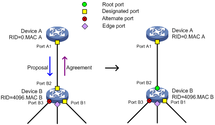

¡  A newly elected RSTP root port rapidly enters the forwarding state if the following requirements are met:
-      The old root port on the device has stopped forwarding data.
-      The upstream designated port has started forwarding data.
¡  A newly elected RSTP designated port rapidly enters the forwarding state if one of the following requirements is met:
-      The designated port is configured as an edge port which directly connects to a user terminal.
-      The designated port connects to a point-to-point link and receives a handshake response from the directly connected device.

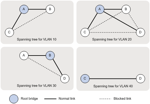

PVST
In an STP- or RSTP-enabled LAN, all bridges share one spanning tree. Traffic from all VLANs is forwarded along the spanning tree, and ports cannot be blocked on a per-VLAN basis to prune loops.
PVST allows every VLAN to have its own spanning tree, which increases usage of links and bandwidth. Because each VLAN runs RSTP independently, a spanning tree only serves its VLAN.

PVST implements per-VLAN spanning tree calculation by mapping each VLAN to an MSTI. In PVST, each VLAN runs RSTP independently to maintain its own spanning tree without affecting the spanning trees of other VLANs. In this way, loops in each VLAN are eliminated and traffic of different VLANs is load shared over links. PVST uses RSTP BPDUs in the default VLAN and PVST BPDUs in other VLANs for spanning tree calculation.

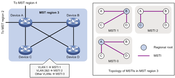

·          MSTP divides a switched network into multiple regions, each of which contains multiple spanning trees that are independent of one another.
·          MSTP supports mapping VLANs to spanning tree instances by means of a VLAN-to-instance mapping table. MSTP can reduce communication overheads and resource usage by mapping multiple VLANs to one instance.

Basic concepts in MSTP
Figure 9 shows a switched network that contains four MST regions, each MST region containing four MSTP devices. Figure 10 shows the networking topology of MST region 3.
Figure 9 Basic concepts in MSTP
Figure 10 Network diagram and topology of MST region 3
MST region
A multiple spanning tree region (MST region) consists of multiple devices in a switched network and the network segments among them. All these devices have the following characteristics:
·          A spanning tree protocol enabled
·          Same region name
·          Same VLAN-to-instance mapping configuration
·          Same MSTP revision level
·          Physically linked together
Multiple MST regions can exist in a switched network. You can assign multiple devices to the same MST region, as shown in Figure 9.
·          The switched network contains four MST regions, MST region 1 through MST region 4.
·          All devices in each MST region have the same MST region configuration.
MSTI
MSTP can generate multiple independent spanning trees in an MST region, and each spanning tree is mapped to the specific VLANs. Each spanning tree is referred to as a multiple spanning tree instance (MSTI).
In Figure 10, MST region 3 contains three MSTIs, MSTI 1, MSTI 2, and MSTI 0.
As an attribute of an MST region, the VLAN-to-instance mapping table describes the mapping relationships between VLANs and MSTIs.
In Figure 10, the VLAN-to-instance mapping table of MST region 3 is as follows:
·          VLAN 1 to MSTI 1.
·          VLAN 2 and VLAN 3 to MSTI 2.
·          Other VLANs to MSTI 0.
MSTP achieves load balancing by means of the VLAN-to-instance mapping table.
CST
The common spanning tree (CST) is a single spanning tree that connects all MST regions in a switched network. If you regard each MST region as a device, the CST is a spanning tree calculated by these devices through STP or RSTP.
The blue lines in Figure 9 represent the CST.
IST
An internal spanning tree (IST) is a spanning tree that runs in an MST region. It is also called MSTI 0, a special MSTI to which all VLANs are mapped by default.
In Figure 9, MSTI 0 is the IST in MST region 3.
CIST
The common and internal spanning tree (CIST) is a single spanning tree that connects all devices in a switched network. It consists of the ISTs in all MST regions and the CST.
In Figure 9, the ISTs (MSTI 0) in all MST regions plus the inter-region CST constitute the CIST of the entire network.
Regional root
The root bridge of the IST or an MSTI within an MST region is the regional root of the IST or MSTI. Based on the topology, different spanning trees in an MST region might have different regional roots, as shown in MST region 3 in Figure 10.
·          The regional root of MSTI 1 is Device B.
·          The regional root of MSTI 2 is Device C.
·          The regional root of MSTI 0 (also known as the IST) is Device A.

Port roles
A port can play different roles in different MSTIs. As shown in Figure 11, an MST region contains Device A, Device B, Device C, and Device D. Port A1 and port A2 of Device A connect to the common root bridge. Port B2 and Port B3 of Device B form a loop. Port C3 and Port C4 of Device C connect to other MST regions. Port D3 of Device D directly connects to a host.
Figure 11 Port roles
MSTP calculation involves the following port roles:
·          Root port—Forwards data for a non-root bridge to the root bridge. The root bridge does not have any root port.
·          Designated port—Forwards data to the downstream network segment or device.
·          Alternate port—Acts as the backup port for a root port or master port. When the root port or master port is blocked, the alternate port takes over.
·          Backup port—Acts as the backup port of a designated port. When the designated port is invalid, the backup port becomes the new designated port. A loop occurs when two ports of the same spanning tree device are connected, so the device blocks one of the ports. The blocked port acts as the backup.
·          Master port—Acts as a port on the shortest path from the local MST region to the common root bridge. The master port is not always located on the regional root. It is a root port on the IST or CIST and still a master port on the other MSTIs.
·          Boundary port—Connects an MST region to another MST region or to an STP/RSTP-running device. In MSTP calculation, a boundary port's role on an MSTI is consistent with its role on the CIST. However, that is not true with master ports. A master port on MSTIs is a root port on the CIST.

P/A transition
The P/A transition enables a designated port to rapidly transit to the forwarding state after a handshake with its peer. The P/A transition applies only to point-to-point links.
·          P/A transition for RSTP and PVST.
In RSTP or PVST, the ports on a new link or recovered link are designated ports in blocking state. When one of the designated ports transits to the discarding or learning state, it sets the proposal flag in its BPDU. Its peer bridge receives the BPDU and determines whether the receiving port is the root port. If it is the root port, the bridge blocks the other ports except edge ports. The bridge then replies an agreement BPDU to the designated port. The designated port immediately transits to the forwarding state upon receiving the agreement BPDU. If the designated port does not receive the agreement BPDU, it waits for twice the forward delay to transit to the forwarding state.
As shown in Figure 14, the P/A transition operates as follows:
a.    Device A sends a proposal BPDU to Device B through Port A1.
b.    Device B receives the proposal BPDU on Port B2. Port B2 is elected as the root port.
c.    Device B blocks its designated port Port B1 and alternate port Port B3 to eliminate loops.
d.    The root port Port B2 transits to the forwarding state and sends an agreement BPDU to Device A.
e.    The designated port Port A1 on Device A immediately transits to the forwarding state after receiving the agreement BPDU.
Figure 14 P/A transition for RSTP and PVST

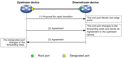

In MSTP, an upstream bridge sets both the proposal and agreement flags in its BPDU. If a downstream bridge receives the BPDU and its receiving port is elected as the root port, the bridge blocks all the other ports except edge ports. The downstream bridge then replies an agreement BPDU to the upstream bridge. The upstream port immediately transits to the forwarding state upon receiving the agreement BPDU. If the upstream port does not receive the agreement BPDU, it waits for twice the forward delay to transit to the forwarding state.
As shown in Figure 15, the P/A transition operates as follows:
a.    Device A sets the proposal and agreement flags in its BPDU and sends it to Device B through Port A1.
b.    Device B receives the BPDU. Port B1 of Device B is elected as the root port.
c.    Device B then blocks all its ports except the edge ports.
d.    The root port Port B1 of Device B transits to the forwarding state and sends an agreement BPDU to Device A.
e.    Port A1 of Device A immediately transits to the forwarding state upon receiving the agreement BPDU.
Figure 15 P/A transition for MSTP

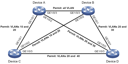

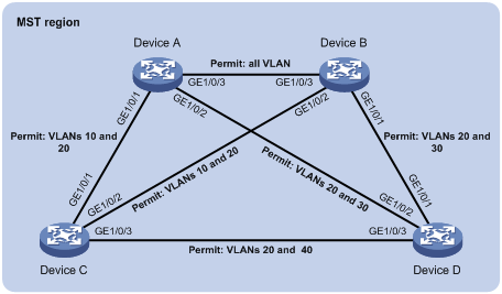

Digest Snooping configuration example
Network requirements
As shown in Figure 16, Device A and Device B connect to Device C, which is a third-party device. All these devices are in the same region.
Enable Digest Snooping on the ports of Device A and Device B that connect to Device C, so that the three devices can communicate with one another.
Figure 16 Network diagram
Configuration procedure
# Enable Digest Snooping on GigabitEthernet 1/0/1 of Device A and enable global Digest Snooping on Device A.

In RSTP and MSTP, the following types of messages are used for rapid state transition on designated ports:
·          Proposal—Sent by designated ports to request rapid transition
·          Agreement—Used to acknowledge rapid transition requests
Both RSTP and MSTP devices can perform rapid transition on a designated port only when the port receives an agreement packet from the downstream device. RSTP and MSTP devices have the following differences:
·          For MSTP, the root port of the downstream device sends an agreement packet only after it receives an agreement packet from the upstream device.
·          For RSTP, the downstream device sends an agreement packet whether or not an agreement packet from the upstream device is received.
Figure 17 Rapid state transition of an MSTP designated port
Figure 18 Rapid state transition of an RSTP designated port
If the upstream device is a third-party device, the rapid state transition implementation might be limited as follows:
·          The upstream device uses a rapid transition mechanism similar to that of RSTP.
·          The downstream device runs MSTP and does not operate in RSTP mode.
In this case, the following occurs:
1.        The root port on the downstream device receives no agreement from the upstream device.
2.        It sends no agreement to the upstream device.
As a result, the designated port of the upstream device can transit to the forwarding state only after a period twice the forward delay.
To enable the designated port of the upstream device to transit its state rapidly, enable No Agreement Check on the downstream device's port.

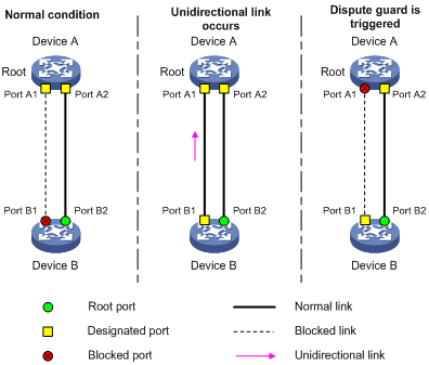

Disabling dispute guard
Dispute guard can be triggered by unidirectional link failures. If a designated port in the forwarding or learning state of a unidirectional link receives inferior BPDUs from the other end, a loop appears. Dispute guard blocks the designated port to prevent the loop.
As shown in Figure 21, in normal conditions, Device A is the root bridge, and Port B1 is blocked after spanning tree calculation. When the link between Port A1 and Port B1 becomes unidirectional (the link fails in the direction of Port A1 to Port B1), the following events occur:
1.        Port A1 can only receive BPDUs and cannot send BPDUs to Port B1.
2.        Port B1 does not receive BPDUs from Port A1 for a certain period of time.
3.        Device B determines itself as the root bridge.
4.        Port B1 sends its BPDUs to Port A1.
5.        Port A1 determines the received BPDUs are inferior to its own BPDUs. A dispute is detected.
6.        Dispute guard is triggered and blocks Port A1 to avoid a loop.
Figure 21 Dispute guard triggering scenario
Disabling dispute guard can avoid blocked links in VLAN networks. As shown in Figure 22, the spanning tree feature is disabled on Device B and enabled on Device A and device C. Device B transparently transmits BPDUs.
Device C cannot receive superior BPDUs of VLAN 1 from Device A because Port B1 of Device B is configured to deny packets of VLAN 1. Device C determines itself as the root bridge after a certain period of time. Then, Port C1 sends an inferior BPDU of VLAN 100 to Device A.
When Device A receives the inferior BPDU, dispute guard blocks Port A1, which causes traffic interruption. To ensure service continuity, you can disable dispute guard on Device A to prevent the link from being blocked.
Figure 22 Disabling dispute guard application scenario
You can disable dispute guard if the network does not have unidirectional link failures.

MSTP configuration example
As shown in Figure 23, all devices on the network are in the same MST region. Device A and Device B work at the distribution layer. Device C and Device D work at the access layer.
Configure MSTP so that frames of different VLANs are forwarded along different spanning trees.
·          VLAN 10 frames are forwarded along MSTI 1.
·          VLAN 30 frames are forwarded along MSTI 3.
·          VLAN 40 frames are forwarded along MSTI 4.
·          VLAN 20 frames are forwarded along MSTI 0.
VLAN 10 and VLAN 30 are terminated on the distribution layer devices, and VLAN 40 is terminated on the access layer devices. The root bridges of MSTI 1 and MSTI 3 are Device A and Device B, respectively, and the root bridge of MSTI 4 is Device C.
Figure 23 Network diagram

In this example, Device B has the lowest root bridge ID. As a result, Device B is elected as the root bridge in MSTI 0.
When the network is stable, you can use the display stp brief command to display brief spanning tree information on each device.

Based on the output, you can draw each MSTI mapped to each VLAN, as shown in Figure 24.
Figure 24 MSTIs mapped to different VLANs
PVST configuration example
As shown in Figure 25, Device A and Device B work at the distribution layer, and Device C and Device D work at the access layer.
Configure PVST to meet the following requirements:
·          Frames of a VLAN are forwarded along the spanning trees of the VLAN.
·          VLAN 10, VLAN 20, and VLAN 30 are terminated on the distribution layer devices, and VLAN 40 is terminated on the access layer devices.
·          The root bridge of VLAN 10 and VLAN 20 is Device A.
·          The root bridge of VLAN 30 is Device B.
·          The root bridge of VLAN 40 is Device C.
Figure 25 Network diagram

 10          GigabitEthernet1/0/2         DESI  FORWARDING    NONE
 10          GigabitEthernet1/0/3         ROOT  FORWARDING    NONE
 20          GigabitEthernet1/0/1         DESI  FORWARDING    NONE
 20          GigabitEthernet1/0/2         DESI  FORWARDING    NONE
 20          GigabitEthernet1/0/3         ROOT  FORWARDING    NONE
 30          GigabitEthernet1/0/1         DESI  FORWARDING    NONE
 30          GigabitEthernet1/0/3         DESI  FORWARDING    NONE
# Display brief spanning tree information on Device C.
[DeviceC] display stp brief
 VLAN ID     Port                         Role  STP State     Protection
 10          GigabitEthernet1/0/1         ROOT  FORWARDING    NONE
 10          GigabitEthernet1/0/2         ALTE  DISCARDING    NONE
 20          GigabitEthernet1/0/1         ROOT  FORWARDING    NONE
 20          GigabitEthernet1/0/2         ALTE  DISCARDING    NONE
 20          GigabitEthernet1/0/3         DESI  FORWARDING    NONE
 40          GigabitEthernet1/0/3         DESI  FORWARDING    NONE
# Display brief spanning tree information on Device D.
[DeviceD] display stp brief
 20          GigabitEthernet1/0/1         ALTE  DISCARDING    NONE
 20          GigabitEthernet1/0/2         ROOT  FORWARDING    NONE
 20          GigabitEthernet1/0/3         ALTE  DISCARDING    NONE
 30          GigabitEthernet1/0/1         ROOT  FORWARDING    NONE
 30          GigabitEthernet1/0/2         ALTE  DISCARDING    NONE
 40          GigabitEthernet1/0/3         ROOT  FORWARDING    NONE
Based on the output, you can draw a topology for each VLAN spanning tree, as shown in Figure 26.
Figure 26 VLAN spanning tree topologies

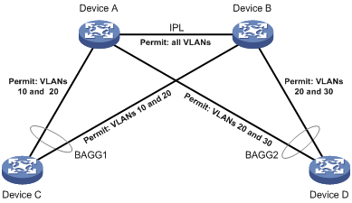

PVST on DR system configuration example
As shown in Figure 27, Device A and Device B work at the distribution layer, and Device C and Device D work at the access layer.
Configure DRNI on Device A and Device B. In the DR system, Device A is the primary DR device, and Device B is the secondary DR device.
Configure PVST on the devices to meet the following requirements:
·          VLAN 10, VLAN 20, and VLAN 30 are terminated on the distribution layer devices.
·          The root bridge of VLAN 10, VLAN 20, and VLAN 30 is the DR system formed by Device A and Device B.
·      As a best practice, do not connect ports on Device A and Device B that have the same port ID with each other, for example Layer 2 aggregate ports. Otherwise, when Device A and Device B communicate through the link, the spanning tree protocol determines that the device receives its own BPDUs. Loop guard will block the link, though spanning tree features are not affected.
·      You can view port IDs of interfaces on the device by using the display stp interface command.
·      The preceding restrictions do not apply to IPPs and their member ports.
Figure 27 Network diagram
1.        Configure VLANs and VLAN member ports. (Details not shown.)
¡  Create VLAN 10, VLAN 20, and VLAN 30 on both Device A and Device B.
¡  Create VLAN 10, and VLAN 20 on Device C.
¡  Create VLAN 20, and VLAN 30 on Device D.
¡  Configure the ports on these devices as trunk ports and assign them to related VLANs.
2.        Configure DRNI on Device A and Device B. (Details not shown.)
For more information about DRNI, see "Configuring DRNI."
3.        Configure Device A:
# Set the spanning tree mode to PVST.
<DeviceA> system-view
[DeviceA] stp mode pvst
# Configure the device as the root bridge of VLAN 10 and VLAN 20.
[DeviceA] stp vlan 10 20 root primary
# Enable the spanning tree feature globally and in VLAN 10, VLAN 20, and VLAN 30.
[DeviceA] stp global enable
[DeviceA] stp vlan 10 20 30 enable
4.        Configure Device B in the same way Device A is configured. (Details not shown.)
5.        Configure Device C:
<DeviceC> system-view
[DeviceC] stp mode pvst
# Enable the spanning tree feature globally and in VLAN 10, and VLAN 20.
[DeviceC] stp global enable
[DeviceC] stp vlan 10 20 enable
6.        Configure Device D:
<DeviceD> system-view
[DeviceD] stp mode pvst
# Enable the spanning tree feature globally and in VLAN 20, and VLAN 30.
[DeviceD] stp global enable
[DeviceD] stp vlan 20 30 enable
# Display brief spanning tree information of the DR system on the primary DR device, Device A.
[DeviceA] display stp brief
 10         Bridge-Aggregation1          DESI  FORWARDING    NONE
 20         Bridge-Aggregation1          DESI  FORWARDING    NONE
 20         Bridge-Aggregation2          DESI  FORWARDING    NONE
 30         Bridge-Aggregation2          DESI  FORWARDING    NONE
 10         Bridge-Aggregation1          ROOT  FORWARDING    NONE
 20         Bridge-Aggregation1          ROOT  FORWARDING    NONE
 20         Bridge-Aggregation2          ROOT  FORWARDING    NONE
 30         Bridge-Aggregation2          ROOT  FORWARDING    NONE
