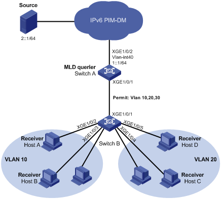

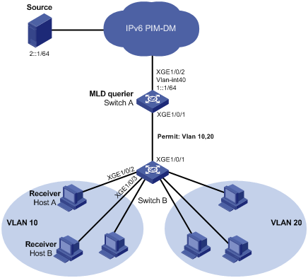

Example: Configuring sub-VLAN-based IPv6 multicast VLANs
As shown in Figure 1:
·     VLAN 10 and VLAN 20 are Department 1 and Department 2, respectively.
·     VLAN-interface 10 and VLAN-interface 20 on Layer 3 device Switch A are the gateways of VLAN 10 and VLAN 20, respectively.
·     MLDv1 runs in VLAN 10 on Switch A, and MLDv1 snooping runs in VLAN 10 on Layer 2 device Switch B.
·     Source sends IPv6 multicast data to IPv6 multicast group FF1E::101.
·     Host A and Host B in VLAN 10 join the group FF1E::101. They can receive the IPv6 multicast data that Source sends to the group.
Figure 1 Network diagram
Now, Host C and Host D in VLAN 20 also join the group to receive the IPv6 multicast data, as shown in Figure 2. To meet the requirement, you can enable MLDv1 for VLAN 20 on Switch A and MLDv1 snooping for VLAN 20 on Switch B. However, this method occupies a large amount of bandwidth and increases the burden on Switch A.
To avoid the problems, you can configure a sub-VLAN-based IPv6 multicast VLAN on Switch B.
Figure 2 Network diagram
Analysis
To meet the network requirements, you must perform the following tasks:
·     Create VLAN 30 on Switch A and Switch B, and assign Ten-GigabitEthernet 1/0/1 on them to VLAN 10 through VLAN 30 as tagged VLAN members.
·     Create VLAN-interface 30 on Switch A, and enable MLD on the interface.
·     Enable MLD snooping for VLAN 10 through VLAN 30 on Switch B.
·     Configure VLAN 30 on Switch B as an IPv6 multicast VLAN, and assign VLAN 10 and VLAN 20 to IPv6 multicast VLAN 30 as sub-VLANs.

Example: Configuring port-based IPv6 multicast VLANs
As shown in Figure 3:
Figure 3 Network diagram
Now, Host C and Host D in VLAN 20 also join the group to receive the IPv6 multicast data, as shown in Figure 4. To meet the requirement, you can enable MLDv1 for VLAN 20 on Switch A and MLDv1 snooping for VLAN 20 on Switch B. However, this method occupies a large amount of bandwidth and increases the burden on Switch A.
To avoid the problems, you can configure a port-based IPv6 multicast VLAN on Switch B.
Figure 4 Network diagram

# Configure the PVID of the Ten-GigabitEthernet 1/0/3 to be VLAN 10, and assign the port to VLAN 10 and VLAN 30 as an untagged VLAN member.
[SwitchB-Ten-GigabitEthernet1/0/3] port hybrid pvid vlan 10
[SwitchB-Ten-GigabitEthernet1/0/3] port hybrid vlan 10 30 untagged
[SwitchB-Ten-GigabitEthernet1/0/3] quit
# Configure Ten-GigabitEthernet 1/0/4 as a hybrid port.
[SwitchB] interface ten-gigabitethernet 1/0/4
[SwitchB-Ten-GigabitEthernet1/0/4] port link-type hybrid
# Configure the PVID of Ten-GigabitEthernet 1/0/4 to be VLAN 20, and assign the port to VLAN 20 and VLAN 30 as an untagged VLAN member.
[SwitchB-Ten-GigabitEthernet1/0/4] port hybrid pvid vlan 20
[SwitchB-Ten-GigabitEthernet1/0/4] port hybrid vlan 20 30 untagged
[SwitchB-Ten-GigabitEthernet1/0/4] quit
# Configure Ten-GigabitEthernet 1/0/5 as a hybrid port.
[SwitchB] interface ten-gigabitethernet 1/0/5
[SwitchB-Ten-GigabitEthernet1/0/5] port link-type hybrid
# Configure the PVID of Ten-GigabitEthernet 1/0/5 to be VLAN 20, and assign the port to VLAN 20 and VLAN 30 as an untagged VLAN member
[SwitchB-Ten-GigabitEthernet1/0/5] port hybrid pvid vlan 20
[SwitchB-Ten-GigabitEthernet1/0/5] port hybrid vlan 20 30 untagged
[SwitchB-Ten-GigabitEthernet1/0/5] quit
5.     Configure VLAN 30 as an IPv6 multicast VLAN, and assign Ten-GigabitEthernet 1/0/1 through Ten-GigabitEthernet 1/0/5 to IPv6 multicast VLAN 30.
[SwitchB] ipv6 multicast-vlan 30
[SwitchB-ipv6-mvlan-30] port ten-gigabitethernet 1/0/2 to ten-gigabitethernet 1/0/5
[SwitchB-ipv6-mvlan-30] quit
# Display information about IPv6 multicast VLANs on Switch B.
[SwitchB] display ipv6 multicast-vlan
Total 1 IPv6 multicast VLANs.
IPv6 multicast VLAN 30:
  Sub-VLAN list(0 in total):
  Port list(4 in total):
    XGE1/0/2
    XGE1/0/3
    XGE1/0/4
    XGE1/0/5
# Display information about IPv6 multicast groups in IPv6 multicast VLANs.
[SwitchB] display mld-snooping group
Total 1 entries.
VLAN 30: Total 1 entries.
  (::, FF1E::101)
    Host slots (0 in total):
    Host ports (4 in total):
      XGE1/0/2         (00:03:23)
      XGE1/0/3         (00:04:07)
      XGE1/0/4         (00:04:16)
      XGE1/0/5         (00:05:10)
The output shows that MLD snooping maintains the user ports in the multicast VLAN (VLAN 30). Switch B will forward the IPv6 multicast data of VLAN 10 through these user ports.
