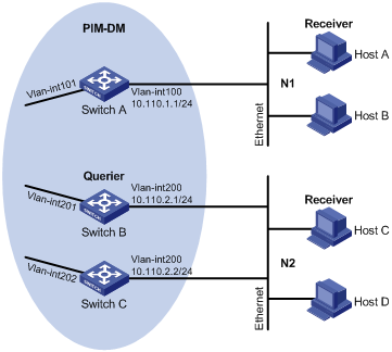

Example: Configuring basic IGMP features
As shown in Figure 1:
·     OSPF and PIM-DM run on the network.
·     VOD streams are sent in multicast. Hosts of different organizations form stub networks N1 and N2.
IGMPv2 runs between Switch A and N1, and between the other two switches and N2. Switch A acts as the IGMP querier in N1. Switch B acts as the IGMP querier in N2 because it has a lower IP address.
Configure basic IGMP features on the switches to meet the following requirements:
·     Hosts in N1 can join any multicast groups.
·     Hosts in N2 can join only multicast group 224.1.1.1.
Figure 1 Network diagram
Analysis
To limit the multicast groups that hosts can join, create an IPv4 basic ACL and specify the multicast groups that you want the hosts to join.
Software versions used
This configuration example was created and verified on S7500X-CMW710-R7536P05.

Procedures
1.     Assign an IP address and subnet mask to each interface, as shown in Figure 1. (Details not shown.)
2.     Configure OSPF on the switches in the PIM-DM domain. (Details not shown.)
3.     Configure Switch A:
# Enable IP multicast routing.
<SwitchA> system-view
[SwitchA] multicast routing
[SwitchA-mrib] quit
# Enable IGMP on the receiver-side interface VLAN-interface 100.
[SwitchA-Vlan-interface100] igmp enable
# Enable PIM-DM on VLAN-interface 101.
[SwitchA] interface vlan-interface 101
[SwitchA-Vlan-interface101] pim dm
[SwitchA-Vlan-interface101] quit
4.     Configure Switch B:
# Create ACL 2001 to permit IGMP reports for multicast group 224.1.1.1.
<SwitchB> system-view
[SwitchB] acl basic 2001
[SwitchB-acl-ipv4-basic-2001] rule permit source 224.1.1.1 0
[SwitchB-acl-ipv4-basic-2001] quit
[SwitchB] multicast routing
[SwitchB-mrib] quit
# Enable IGMP on the receiver-side interface VLAN-interface 200.
[SwitchB] interface vlan-interface 200
[SwitchB-Vlan-interface200] igmp enable
# Configure a multicast group policy that uses ACL 2001.
[SwitchB-Vlan-interface200] igmp group-policy 2001
[SwitchB-Vlan-interface200] quit
# Enable PIM-DM on VLAN-interface 201.
[SwitchB] interface vlan-interface 201
[SwitchB-Vlan-interface201] pim dm
[SwitchB-Vlan-interface201] quit
5.     Configure Switch C:
<SwitchC> system-view
[SwitchC] acl basic 2001
[SwitchC-acl-ipv4-basic-2001] rule permit source 224.1.1.1 0
[SwitchC-acl-ipv4-basic-2001] quit
[SwitchC] multicast routing
[SwitchC-mrib] quit
[SwitchC] interface vlan-interface 200
[SwitchC-Vlan-interface200] igmp enable
[SwitchC-Vlan-interface200] igmp group-policy 2001
[SwitchC-Vlan-interface200] quit
# Enable PIM-DM on VLAN-interface 202.
[SwitchC] interface vlan-interface 202
[SwitchC-Vlan-interface202] pim dm
[SwitchC-Vlan-interface202] quit
1.     Verify that hosts in N1 can join multicast groups 224.1.1.1 and 224.1.1.2:
# Send IGMP reports from Host A (10.110.1.10) to join multicast groups 224.1.1.1 and 224.1.1.2. (Details not shown.)
# Display information about IGMP groups that hosts have dynamically joined on Switch A.
[SwitchA] display igmp group
IGMP groups in total: 2.
 Vlan-interface100 (10.110.1.1):
  IGMP groups reported in total: 2
  Group address   Last reporter   Uptime      Expires
   224.1.1.1       10.110.1.10     00:02:04    00:01:15
   224.1.1.2       10.110.1.10     00:02:00    00:01:19
The output shows that Host A has joined multicast groups 224.1.1.1 and 224.1.1.2.
2.     Verify that hosts in N2 can join only multicast group 224.1.1.1:
# Send IGMP reports from Host C (10.110.2.10) to join multicast groups 224.1.1.1 and 224.1.1.2. (Details not shown.)
# Display information about IGMP groups that hosts have dynamically joined on Switch B.
[SwitchB] display igmp group
IGMP groups in total: 1
 Vlan-interface200(10.110.2.1):
  IGMP groups reported in total: 1
   224.1.1.1       10.110.2.10     04:36:03    00:01:23
# Display information about IGMP groups that hosts have dynamically joined on Switch C.
[SwitchC] display igmp group
 Vlan-interface200(10.110.2.2):
   224.1.1.1       10.110.2.10     04:21:03    00:01:13
The output shows that Switch B and Switch C each have IGMP information about only multicast group, 224.1.1.1. The multicast group policy has taken effect, and hosts in N2 can join only multicast group 224.1.1.1.

The output shows that Host A has statically joined multicast group 224.1.1.1 through VLAN-interface 100.
The output shows that Switch B and Switch C each have information only about multicast group 224.1.1.1. The multicast group policy has taken effect, and hosts in N2 can join only multicast group 224.1.1.1.

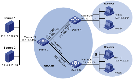

Example: Configuring IGMP SSM mappings
As shown in Figure 3:
·     The SSM group range for the PIM-SSM domain is 232.1.1.0/24.
·     Switch A and Switch B in the PIM-SSM domain run IGMPv3.
·     Host A in N1 and Host B in N2 run IGMPv2, and they do not support IGMPv3. The other hosts in N1 and N2 run IGMPv3.
Configure IGMP SSM mappings on Switch A and Switch B to meet the following requirements:
·     Hosts in N1 receive multicast data only from Source 1.
·     Hosts in N2 receive multicast data only from Source 2.
Figure 3 Network diagram

1.     Assign an IP address and subnet mask to each interface, as shown in Figure 3. (Details not shown.)
2.     Configure OSPF on the switches in the PIM-SSM domain. (Details not shown.)
3.     Enable IP multicast routing and enable PIM-SM:
# On Switch A, enable IP multicast routing, and enable PIM-SM on VLAN-interface 200.
[SwitchA-mrib] quit
[SwitchA] interface vlan-interface 200
[SwitchA-Vlan-interface200] pim sm
[SwitchA-Vlan-interface200] quit
# Configure Switch B in the same way Switch A is configured. (Details not shown.)
# On Router C, enable IP multicast routing, and enable PIM-SM on each interface.
[SwitchC-mrib] quit
[SwitchC] interface vlan-interface 100
[SwitchC-Vlan-interface100] pim sm
[SwitchC-Vlan-interface100] quit
[SwitchC-Vlan-interface200] pim sm
[SwitchC] interface vlan-interface 300
[SwitchC-Vlan-interface300] pim sm
[SwitchC-Vlan-interface300] quit
4.     On Switch C, configure VLAN-interface 200 as a C-BSR and a C-RP:
[SwitchC] pim
[SwitchC-pim] c-bsr 192.168.1.1
[SwitchC-pim] c-rp 192.168.1.1
[SwitchC-pim] quit
5.     Configure IGMPv3 on the receiver-side interfaces:
# On Switch A, enable IGMP, and specify IGMP version 3 on VLAN-interface 201.
[SwitchA] interface vlan-interface201
[SwitchA-Vlan-interface201] igmp enable
[SwitchA-Vlan-interface201] igmp version 3
[SwitchA-Vlan-interface201] quit
6.     Configure the SSM group range:
# On Switch A, configure the SSM group range as 232.1.1.0/24.
[SwitchA] acl basic 2000
[SwitchA-acl-ipv4-basic-2000] rule permit source 232.1.1.0 0.0.0.255
[SwitchA-acl-ipv4-basic-2000] quit
[SwitchA] pim
[SwitchA-pim] ssm-policy 2000
[SwitchA-pim] quit
# Configure Switch B and Switch C in the same way Switch A is configured. (Details not shown.)
7.     Configure IGMP SSM mappings:
# On Switch A, map Source 1 to the SSM group range 232.1.1.0/24 so that hosts in N1 can receive multicast data only from Source 1.
[SwitchA] igmp
[SwitchA-igmp] ssm-mapping 10.110.5.100 2000
[SwitchA-igmp] quit
# On Switch B, map Source 2 to the SSM group range 232.1.1.0/24 so that hosts in N2 can receive multicast data only from Source 2.
[SwitchB] igmp
[SwitchB-igmp] ssm-mapping 10.110.5.101 2000
[SwitchB-igmp] quit
# Send IGMPv2 reports from Host A and Host C to join multicast group 232.1.1.1. (Details not shown.)
# Send multicast data from Source 1 and Source 2 to multicast group 232.1.1.1. (Details not shown.)
# Display IGMP SSM mappings for multicast group 232.1.1.1 on Switch A.
[SwitchA] display igmp ssm-mapping 232.1.1.1
 Group: 232.1.1.1
 Source list:
        10.110.5.100
The output shows that the group 232.1.1.1 is mapped to Source 1 (10.110.5.100). Switch A will translate (0.0.0.0, 232.1.1.1) in IGMPv2 reports to (10.110.5.100, 232.1.1.1).
# Display the PIM routing table on Switch A.
[SwitchA] display pim routing-table
Total 0 (*, G) entry; 1 (S, G) entry
     Protocol: pim-ssm, Flag:
     UpTime: 00:13:25
     Upstream interface: Vlan-interface200
         Upstream neighbor: 192.168.1.1
         RPF prime neighbor: 192.168.1.1
     Downstream interface(s) information:
       Total number of downstreams: 1
         1: Vlan-interface201
                 Protocol: igmp, UpTime: 02:54:43, Expires: 00:02:47
The output shows that Switch A has the (10.110.5.100, 232.1.1.1) entry.
# Display IGMP SSM mappings for multicast group 232.1.1.1 on Switch B.
[SwitchB] display igmp ssm-mapping 232.1.1.1
 Group: 232.1.1.1
 Source list:
        10.110.5.101
The output shows that multicast group 232.1.1.1 is mapped to Source 2 (10.110.5.101). Switch B will translate (0.0.0.0, 232.1.1.1) in IGMPv2 reports to (10.110.5.101, 232.1.1.1).
# Display the PIM routing table on Switch B.
[SwitchB] display pim routing-table
     UpTime: 00:12:16
     Upstream interface: Vlan-interface300
         Upstream neighbor: 192.168.2.1
         RPF prime neighbor: 192.168.2.1
         1: Vlan-interface301
The output shows that Switch B has the (10.110.5.101, 232.1.1.1) entry.
