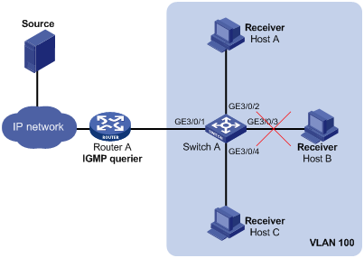

As shown in Figure 1, Router A runs IGMP and acts as the IGMP querier. Switch A does not run a Layer 2 multicast protocol.
Configure Switch A so that only Host A and Host C can receive multicast data addressed to the multicast group 224.1.1.1.
Figure 1 Network diagram

Multicast MAC address entries guide Layer 2 multicast forwarding. They can be dynamically created through Layer 2 multicast protocols or manually configured by binding multicast MAC addresses and ports.
In this example, Switch A does not run a Layer 2 multicast protocol. To control destination ports of Layer 2 multicast data, configure a static multicast MAC address entry on Switch A.

# On Switch A, create VLAN 100.
<SwitchA> system-view
[SwitchA] vlan 100
[SwitchA-vlan100] quit
# Configure GigabitEthernet 3/0/1 through GigabitEthernet 3/0/4 to operate in Layer 2 mode, and assign the ports to VLAN 100.
[SwitchA] interface range gigabitethernet 3/0/1 to gigabitethernet 3/0/4
[SwitchA-if-range] port link-mode bridge
[SwitchA-if-range] port access vlan 100
[SwitchA-if-range] quit
# Translate multicast IP address 224.1.1.1 to a multicast MAC address (0100-5e01-0101). (Details not shown.)
# Create a static entry for multicast MAC address 0100-5e01-0101 with GigabitEthernet 3/0/2 and GigabitEthernet 3/0/4 in VLAN 100 as outgoing ports.
[SwitchA] mac-address multicast 0100-5e01-0101 interface gigabitethernet 3/0/2 gigabitethernet 3/0/4 vlan 100
# Display static multicast MAC address entries in VLAN 100 on Switch A.
[SwitchA] display mac-address multicast vlan 100
MAC Address      VLAN ID    State            Port/NickName            Aging
0100-5e01-0101   100        Multicast        GE3/0/2                  N
                                             GE3/0/4
The output shows that GigabitEthernet 3/0/2 and GigabitEthernet 3/0/4 have become outgoing ports of the multicast MAC group 0100-5e01-0101.
