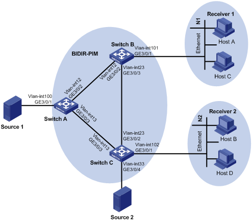

Example: Configuring BIDIR-PIM
As shown in Figure 1:
·     Switch A, Switch B, and Switch C run OSPF.
·     Source 1 and Source 2 send multicast data to multicast group 225.1.1.1.
·     Host A and Host B are member hosts of multicast group 225.1.1.1.
Configure BIDIR-PIM on the switches to implement multicast forwarding.
Figure 1 Network diagram

Analysis
To meet the network requirements, perform the following tasks:
·     To establish the bidirectional RPT, configure VLAN-interface 12 on Switch A as a C-RP.
·     To use the BSR mechanism to dynamically elect the RP, configure VLAN-interface 12 on Switch A as a C-BSR.
·     To avoid multicast forwarding interruption when the RP fails, specify the unused IP address 10.13.1.4/24 as the static RP. In this way, the link on the subnet 10.13.1.0/24 becomes the RPL. Switch A and Switch C on the link function as the RPs.

3.     Verify that VLAN-interface 12 on Switch A has been elected as the RP, and verify that the IP address of the static RP is 10.13.1.4 on each switch.
# Display RP information on Switch A.
[SwitchA] display pim rp-info
 BSR RP information:
   Scope: non-scoped
     Group/MaskLen: 224.0.0.0/4 [B]
       RP address               Priority  HoldTime  Uptime    Expires
       10.12.1.1 (local)        192       150       00:06:01  00:02:58
 Static RP information:
       RP address               ACL   Mode    Preferred
       10.13.1.4                ----  bidir   No
# Display RP information on Switch B.
[SwatchB] display pim rp-info
 BSR RP information:
   Scope: non-scoped
       10.12.1.1                192       150       00:06:33  00:02:26
# Display RP information on Switch C.
[SwitchC] display pim rp-info
 BSR RP information:
   Scope: non-scoped
       10.12.1.1                192       150       00:06:51  00:02:05
4.     Verify that the DFs have been elected for BIDIR-PIM on each switch.
# Display information about DFs for BIDIR-PIM on Switch A.
[SwitchA] display pim df-info
RP address: 10.12.1.1
 Interface           State   DF-Pref    DF-Metric  DF-Uptime DF-Address
 Vlan100             Win     0          0          00:01:09  10.10.1.1 (local)
 Vlan12              -       -          -          -         -
 Vlan13              Win     0          0          00:01:10  10.13.1.1 (local)
RP address: 10.13.1.4
 Vlan100             Win     0          0          00:00:07  10.10.1.1 (local)
 Vlan12              Win     0          0          00:00:07  10.12.1.1 (local)
 Vlan13              -       -          -          -         -
# Display information about DFs for BIDIR-PIM on Switch B.
[SwatchB] display pim df-info
 Vlan12              -       -          -          -         -
 Vlan23              Win     0          0          00:01:46  10.23.1.2 (local)
 Vlan101             Win     0          0          00:01:45  10.101.1.1 (local)
 Vlan12              Lose    0          0          00:00:44  10.12.1.1
 Vlan23              Lose    0          0          00:00:53  10.23.1.3
 Vlan101             Win     10         2          00:00:53  10.101.1.1 (local)
# Display information about DFs for BIDIR-PIM on Switch C.
[SwitchC] display pim df-info
 Vlan102             Win     10         2          00:02:07  10.102.1.1 (local)
 Vlan33              Win     10         2          00:02:06  10.33.1.3 (local)
 Vlan13              Lose    0          0          00:02:07  10.13.1.1
 Vlan23              Lose    0          0          00:02:07  10.23.1.2
 Vlan102             Win     0          0          00:01:24  10.102.1.1 (local)
 Vlan33              Win     0          0          00:01:23  10.33.1.3 (local)
 Vlan13              -       -          -          -         -
 Vlan23              Win     0          0          00:01:24  10.23.1.3 (local)
5.     Verify that DFs for multicast forwarding are correct on each switch.
# Display information about DFs for multicast forwarding on Switch A.
[SwitchA] display multicast forwarding df-info
Total 2 RPs, 2 matched
00001. RP address: 10.12.1.1
     Flags: 0x0
     Uptime: 00:02:42
     RPF interface: Vlan-interface12
     List of 2 DF interfaces:
       1: Vlan-interface100
       2: Vlan-interface13
00002. RP address: 10.13.1.4
     Flags: 0x0
     Uptime: 00:01:41
     RPF interface: Vlan-interface13
       2: Vlan-interface12
# Display information about DFs for multicast forwarding on Switch B.
[SwitchB] display multicast forwarding df-info
     Flags: 0x0
     Uptime: 00:03:18
       1: Vlan-interface23
       2: Vlan-interface101
     Flags: 0x0
     Uptime: 00:02:24
     RPF interface: Vlan-interface23
     List of 1 DF interfaces:
       1: Vlan-interface101
# Display information about DFs for multicast forwarding on Switch C.
[SwitchC] display multicast forwarding df-info
     Flags: 0x0
     Uptime: 00:03:38
       1: Vlan-interface102
       2: Vlan-interface33
     Flags: 0x0
     Uptime: 00:02:41
     List of 3 DF interfaces:
       1: Vlan-interface33
       2: Vlan-interface23
       3: Vlan-interface102
6.     Send IGMP reports from Host A and Host B to join multicast group 225.1.1.1, and send multicast data from Source 1 and Source 2 to the group. (Details not shown.)
7.     Verify that PIM forwarding entries have been correctly established on each switch.
# Display information about PIM routing entries on Switch A.
[SwitchA] display pim routing-table
 Total 1 (*, G) entry; 0 (S, G) entry
 (*, 225.1.1.1)
     RP: 10.12.1.1 (local)
     Protocol: pim-bidir, Flag: WC LOC ACT
     UpTime: 00:21:59
     Upstream interface: Vlan-interface12
         Upstream neighbor: NULL
         RPF prime neighbor: NULL
     Downstream interface(s) information:
     Total number of downstreams: 1
         1: Vlan-interface12
             Protocol: pim-bidir, UpTime: 00:21:59, Expires: -
         2: Vlan-interface13
             Protocol: pim-bidir, UpTime: 00:03:26, Expires: -
# Display information about PIM routing entries on Switch B.
[SwitchB] display pim routing-table
 (*, 225.1.1.1)
     RP: 10.12.1.1
     UpTime: 00:23:47
     Total number of downstreams: 3
         1: Vlan-interface12
             Protocol: pim-bidir, UpTime: 00:23:47, Expires: -
         2: Vlan-interface23
             Protocol: pim-bidir, UpTime: 00:21:56, Expires: -
         3: Vlan-interface101
             Protocol: igmp, UpTime: 00:23:47, Expires: -
# Display information about PIM routing entries on Switch C.
[SwitchC] display pim routing-table
 (*, 225.1.1.1)
     RP: 10.12.1.1
     Protocol: pim-bidir, Flag: WC ACT
     UpTime: 00:01:45
     Upstream interface: Vlan-interface23
         Upstream neighbor: 10.23.1.2
         RPF prime neighbor: 10.23.1.2
     Total number of downstreams: 2
             Protocol: igmp, UpTime: 00:01:05, Expires: -
         2: Vlan-interface23
             Protocol: pim-bidir, UpTime: 00:00:53, Expires: -
Configuration files
