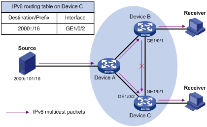

Figure 1 RPF check process
As shown in Figure 1, assume that IPv6 unicast routes are available on the network. IPv6 MBGP is not configured. IPv6 multicast packets travel along the SPT from the multicast source to the receivers. The IPv6 multicast forwarding table on Device C contains the (S, G) entry, with GigabitEthernet 1/0/2 as the RPF interface.
·     If an IPv6 multicast packet arrives at Device C on GigabitEthernet 1/0/2, the receiving interface is the incoming interface of the (S, G) entry. Device C forwards the packet out of all outgoing interfaces.
·     If an IPv6 multicast packet arrives at Device C on GigabitEthernet 1/0/1, the receiving interface is not the incoming interface of the (S, G) entry. Device C searches its IPv6 unicast routing table and finds that the outgoing interface to the source (the RPF interface) is GigabitEthernet 1/0/2. This means that the (S, G) entry is correct but the packet traveled along a wrong path. The packet fails the RPF check, and Device C discards the packet.

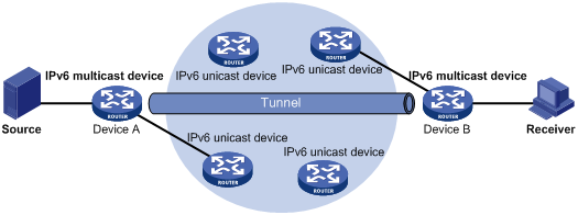

IPv6 multicast forwarding across IPv6 unicast subnets
IPv6 multicast forwarding over a GRE tunnel is not supported on LSU1TGS16SC0 LPUs.
Routers forward the IPv6 multicast data from an IPv6 multicast source hop by hop along the forwarding tree, but some routers might not support IPv6 multicast protocols in a network. When the IPv6 multicast data is forwarded to a router that does not support IPv6 multicast, the forwarding path is blocked. In this case, you can enable IPv6 multicast data forwarding across the IPv6 unicast subnets by establishing a tunnel between the routers at both ends of the IPv6 unicast subnets.
Figure 2 IPv6 multicast data transmission through a tunnel
As shown in Figure 2, a tunnel is established between the multicast routers Device A and Device B. Device A encapsulates the IPv6 multicast data in unicast IPv6 packets, and forwards them to Device B across the tunnel through unicast routers. Then, Device B strips off the unicast IPv6 header and continues to forward the IPv6 multicast data down toward the receivers.

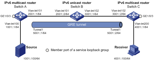

IPv6 multicast routing and forwarding configuration example
Network requirements
As shown in Figure 3:
·     IPv6 multicast routing and IPv6 PIM-DM are enabled on Switch A and Switch C.
·     Switch B does not support IPv6 multicast.
·     Switch A, Switch B, and Switch C run OSPFv3. The source-side interface VLAN-interface 100 on Switch A does not run OSPFv3.
Configure the switches so that the receiver host can receive the IPv6 multicast data from Source.
Figure 3 Network diagram
Configuration procedure
1.     Assign an IPv6 address and prefix length to each interface, as shown in Figure 3. (Details not shown.)
2.     Configure OSPFv3 on the switches. Do not run OSPFv3 on VLAN-interface 100 on Switch A. (Details not shown.)
3.     Configure a GRE tunnel:
# On Switch A, create service loopback group 1, and specify the unicast tunnel service for the group.
<SwitchA> system-view
[SwitchA] service-loopback group 1 type tunnel
# Assign GigabitEthernet 1/0/3 to service loopback group 1. (GigabitEthernet 1/0/3 does not belong to VLAN 100 or VLAN 101.)
[SwitchA] interface gigabitethernet 1/0/3
[SwitchA-GigabitEthernet1/0/3] port service-loopback group 1
[SwitchA-GigabitEthernet1/0/3] quit
# Create a GRE tunnel interface Tunnel 1, and specify the tunnel mode as GRE/IPv6.
[SwitchA] interface tunnel 1 mode gre ipv6
# Assign an IPv6 address to interface Tunnel 1, and specify its source and destination addresses.
[SwitchA-Tunnel1] ipv6 address 5001::1 64
[SwitchA-Tunnel1] source 2001::1
[SwitchA-Tunnel1] destination 3001::2
[SwitchA-Tunnel1] quit
# On Switch C, create service loopback group 1, and specify the unicast tunnel service for the group.
<SwitchC> system-view
[SwitchC] service-loopback group 1 type tunnel
# Assign GigabitEthernet 1/0/3 to service loopback group 1. (GigabitEthernet 1/0/3 does not belong to VLAN 200 or VLAN 102.)
[SwitchC] interface gigabitethernet 1/0/3
[SwitchC-GigabitEthernet1/0/3] port service-loopback group 1
[SwitchC-GigabitEthernet1/0/3] quit
[SwitchC] interface tunnel 1 mode gre ipv6
[SwitchC-Tunnel1] ipv6 address 5001::2 64
[SwitchC-Tunnel1] source 3001::2
[SwitchC-Tunnel1] destination 2001::1
[SwitchC-Tunnel1] quit
4.     Enable IPv6 multicast routing, IPv6 PIM-DM, and MLD:
# On Switch A, enable IPv6 multicast routing, and enable IPv6 PIM-DM on each interface.
[SwitchA] ipv6 multicast routing
[SwitchA-mrib6] quit
[SwitchA-Vlan-interface100] ipv6 pim dm
[SwitchA] interface vlan-interface 101
[SwitchA-Vlan-interface101] ipv6 pim dm
[SwitchA-Vlan-interface101] quit
[SwitchA-Tunnel1] ipv6 pim dm
# On Switch C, enable IPv6 multicast routing.
[SwitchC] ipv6 multicast routing
[SwitchC-mrib6] quit
# Enable MLD on the receiver-side interface (VLAN-interface 200).
[SwitchC] interface vlan-interface 200
[SwitchC-Vlan-interface200] mld enable
[SwitchC-Vlan-interface200] quit
# Enable IPv6 PIM-DM on VLAN-interface 102.
[SwitchC] interface vlan-interface 102
[SwitchC-Vlan-interface102] ipv6 pim dm
[SwitchC-Vlan-interface102] quit
[SwitchC-Tunnel1] ipv6 pim dm
5.     On Switch C, configure a static IPv6 route with the destination address 1001::1/64 and the outgoing interface Tunnel 1.
[SwitchC] ipv6 route-static 1001::1 64 tunnel 1
# Send an MLD report from Receiver to join IPv6 multicast group FF1E::101. (Details not shown.)
# Send IPv6 multicast data from Source to IPv6 multicast group FF1E::101. (Details not shown.)
# Display IPv6 PIM routing entries on Switch C.
[SwitchC] display ipv6 pim routing-table
 Total 1 (*, G) entry; 1 (S, G) entry
 (*, FF1E::101)
     Protocol: pim-dm, Flag: WC
     UpTime: 00:04:25
     Upstream interface: NULL
         Upstream neighbor: NULL
         RPF prime neighbor: NULL
     Downstream interface(s) information:
     Total number of downstreams: 1
         1: Vlan-interface200
             Protocol: mld, UpTime: 00:04:25, Expires: -
 (1001::100, FF1E::101)
     Protocol: pim-dm, Flag: ACT
     UpTime: 00:06:14
     Upstream interface: Tunnel1
         Upstream neighbor: FE80::A01:101:1
         RPF prime neighbor: FE80::A01:101:1
             Protocol: pim-dm, UpTime: 00:04:25, Expires: -
The output shows the following information:
·     Switch A is the RPF neighbor of Switch C.
·     IPv6 multicast data from Switch A is delivered over the GRE tunnel to Switch C.
