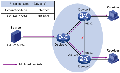

RPF check process
Figure 1 RPF check process
As shown in Figure 1, assume that unicast routes are available on the network, MBGP is not configured, and no static multicast routes have been configured on Device C. Multicast packets travel along the SPT from the multicast source to the receivers. The multicast forwarding table on Device C contains the (S, G) entry, with GigabitEthernet 1/0/2 as the incoming interface.
·     If a multicast packet arrives at Device C on GigabitEthernet 1/0/2, the receiving interface is the incoming interface of the (S, G) entry. Device C forwards the packet out of all outgoing interfaces.
·     If a multicast packet arrives at Device C on GigabitEthernet 1/0/1, the receiving interface is not the incoming interface of the (S, G) entry. Device C searches its unicast routing table and finds that the outgoing interface to the source (the RPF interface) is GigabitEthernet 1/0/2. In this case, the (S, G) entry is correct, but the packet traveled along a wrong path. The packet fails the RPF check, and Device C discards the packet.

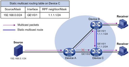

Changing an RPF route
Typically, the topology structure of a multicast network is the same as that of a unicast network, and multicast traffic follows the same transmission path as unicast traffic does. You can configure a static multicast route for a multicast source to change the RPF route. As a result, the router creates a transmission path for multicast traffic that is different from the transmission path for unicast traffic.
Figure 2 Changing an RPF route
As shown in Figure 2, when no static multicast route is configured, Device C's RPF neighbor on the path back to the source is Device A. The multicast data from the source travels through Device A to Device C. You can configure a static multicast route on Device C and specify Device B as Device C's RPF neighbor on the path back to the source. The multicast data from the source travels along the path: Device A to Device B and then to Device C.

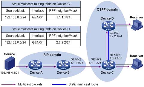

Creating an RPF route
When a unicast route is blocked, multicast forwarding might be stopped due to lack of an RPF route. You can configure a static multicast route to create an RPF route. In this way, a multicast routing entry is created to guide multicast forwarding.
Figure 3 Creating an RPF route
As shown in Figure 3, the RIP domain and the OSPF domain are unicast isolated from each other. For the receiver hosts in the OSPF domain to receive multicast packets from the multicast source in the RIP domain, you must configure Device C and Device D as follows:
·     On Device C, configure a static multicast route for the multicast source and specify Device B as the RPF neighbor.
·     On Device D, configure a static multicast route for the multicast source and specify Device C as the RPF neighbor.
A static multicast route is effective only on the multicast router on which it is configured, and will not be advertised throughout the network or redistributed to other routers.

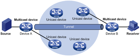

Multicast forwarding across unicast subnets
Multicast forwarding over a GRE tunnel is not supported on LSU1TGS16SC0 LPUs.
Routers forward the multicast data from a multicast source hop by hop along the forwarding tree, but some routers might not support multicast protocols in a network. When the multicast data is forwarded to a router that does not support IP multicast, the forwarding path is blocked. In this case, you can enable multicast forwarding across two unicast subnets by establishing a tunnel between the routers at the edges of the two unicast subnets.
Figure 4 Multicast data transmission through a tunnel
As shown in Figure 4, a tunnel is established between the multicast routers Device A and Device B. Device A encapsulates the multicast data in unicast IP packets, and forwards them to Device B across the tunnel through unicast routers. Then, Device B strips off the unicast IP header and continues to forward the multicast data to the receiver.
To use this tunnel only for multicast traffic, configure the tunnel as the outgoing interface only for multicast routes.

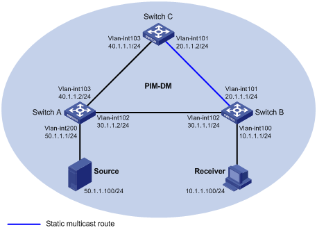

Network requirements
As shown in Figure 5:
·     PIM-DM runs on the network.
·     All switches on the network support multicast.
·     Switch A, Switch B and Switch C run OSPF.
·     Typically, the receiver host can receive the multicast data from Source through the path: Switch A to Switch B, which is the same as the unicast route.
Configure the switches so that the multicast data from Source travels to the receiver through the path: Switch A to Switch C to Switch B. This is different from the unicast route.
Figure 5 Network diagram
Configuration procedure
1.     Assign an IP address and subnet mask for each interface, as shown in Figure 5. (Details not shown.)
2.     Configure OSPF on the switches in the PIM-DM domain. (Details not shown.)
3.     Enable IP multicast routing, and enable IGMP and PIM-DM:
# On Switch B, enable IP multicast routing.
<SwitchB> system-view
[SwitchB] multicast routing
[SwitchB-mrib] quit
# Enable IGMP on the receiver-side interface VLAN-interface 100.
[SwitchB-Vlan-interface100] igmp enable
# Enable PIM-DM on other interfaces.
[SwitchB] interface vlan-interface 101
[SwitchB-Vlan-interface101] pim dm
[SwitchB-Vlan-interface101] quit
[SwitchB] interface vlan-interface 102
[SwitchB-Vlan-interface102] pim dm
[SwitchB-Vlan-interface102] quit
# On Switch A, enable IP multicast routing.
<SwitchA> system-view
[SwitchA] multicast routing
[SwitchA-mrib] quit
# Enable PIM-DM on each interface.
[SwitchA] interface vlan-interface 200
[SwitchA-Vlan-interface200] pim dm
[SwitchA-Vlan-interface200] quit
[SwitchA] interface vlan-interface 102
[SwitchA-Vlan-interface102] pim dm
[SwitchA-Vlan-interface102] quit
[SwitchA] interface vlan-interface 103
[SwitchA-Vlan-interface103] pim dm
[SwitchA-Vlan-interface103] quit
# Enable IP multicast routing and PIM-DM on Switch C in the same way Switch A is configured. (Details not shown.)
4.     Display RPF information for Source on Switch B.
[SwitchB] display multicast rpf-info 50.1.1.100
 RPF information about source 50.1.1.100:
     RPF interface: Vlan-interface102, RPF neighbor: 30.1.1.2
     Referenced route/mask: 50.1.1.0/24
     Referenced route type: igp
     Route selection rule: preference-preferred
     Load splitting rule: disable
The output shows that the current RPF route on Switch B is contributed by a unicast routing protocol and the RPF neighbor is Switch A.
5.     Configure a static multicast route on Switch B and specify Switch C as its RPF neighbor on the route to Source.
[SwitchB] ip rpf-route-static 50.1.1.100 24 20.1.1.2
# Display RPF information for Source on Switch B.
     RPF interface: Vlan-interface101, RPF neighbor: 20.1.1.2
     Referenced route type: multicast static
The output shows the following information:
·     The RPF route on Switch B is the configured static multicast route.
·     The RPF neighbor of Switch B is Switch C.

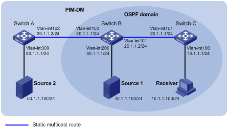

As shown in Figure 6:
·     All switches on the network support IP multicast.
·     Switch B and Switch C run OSPF, and have no unicast routes to Switch A.
·     Typically, the receiver host receives the multicast data from Source 1 in the OSPF domain.
Configure the switches so that the receiver host receives multicast data from Source 2, which is outside the OSPF domain.
Figure 6 Network diagram
1.     Assign an IP address and subnet mask for each interface, as shown in Figure 6. (Details not shown.)
2.     Configure OSPF on Switch B and Switch C. (Details not shown.)
# On Switch C, enable IP multicast routing.
<SwitchC> system-view
[SwitchC] multicast routing
[SwitchC-mrib] quit
[SwitchC] interface vlan-interface 100
[SwitchC-Vlan-interface100] igmp enable
[SwitchC-Vlan-interface100] quit
# Enable PIM-DM on VLAN-interface 101.
[SwitchC] interface vlan-interface 101
[SwitchC-Vlan-interface101] pim dm
[SwitchC-Vlan-interface101] quit
[SwitchA-mrib] quit
[SwitchA] interface vlan-interface 300
[SwitchA-Vlan-interface300] pim dm
[SwitchA-Vlan-interface300] quit
# Enable IP multicast routing and PIM-DM on Switch B in the same way Switch A is configured. (Details not shown.)
4.     Display RPF information for Source 2 on Switch B and Switch C.
[SwitchC] display multicast rpf-info 50.1.1.100
No output is displayed because no RPF routes to Source 2 exist on Switch B or Switch C.
5.     Configure a static multicast route:
# Configure a static multicast route on Switch B and specify Switch A as its RPF neighbor on the route to Source 2.
[SwitchB] ip rpf-route-static 50.1.1.100 24 30.1.1.2
# Configure a static multicast route on Switch C and specify Switch B as its RPF neighbor on the route to Source 2.
[SwitchC] ip rpf-route-static 10.1.1.100 24 20.1.1.2
# Display RPF information for Source 2 on Switch B.
# Display RPF information for Source 2 on Switch C.
The output shows that the RPF routes to Source 2 exist on Switch B and Switch C. The routes are the configured static routes.
