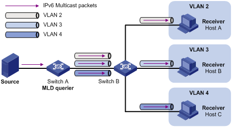

As shown in Figure 1, Host A, Host B, and Host C are in different VLANs and the same IPv6 multicast group. When Switch A (Layer 3 device) receives IPv6 multicast data for that group, it forwards three copies of the data to Switch B (Layer 2 device). This occupies a large amount of bandwidth and increases the burden on the Layer 3 device.
Figure 1 Multicast transmission without the IPv6 multicast VLAN feature
After an IPv6 multicast VLAN is configured on Switch B, Switch A sends one copy of the IPv6 multicast data to the IPv6 multicast VLAN on Switch B. This saves network bandwidth and lessens the burden on the Layer 3 device.

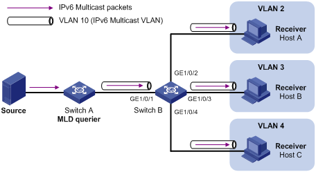

Sub-VLAN-based IPv6 multicast VLAN
As shown in Figure 2:
·     Host A, Host B, and Host C are in VLAN 2 through VLAN 4, respectively.
·     On Switch B, VLAN 10 is an IPv6 multicast VLAN. VLAN 2 through VLAN 4 are sub-VLANs of VLAN 10.
·     MLD snooping is enabled for the multicast VLAN and its sub-VLANs.
Figure 2 Sub-VLAN-based multicast VLAN
MLD snooping manages router ports in the IPv6 multicast VLAN and member ports in each sub-VLAN. When Switch A receives IPv6 multicast data from the IPv6 multicast source, it sends only one copy of the IPv6 multicast data to the IPv6 multicast VLAN on Switch B. Then, Switch B sends a separate copy to each sub-VLAN of the IPv6 multicast VLAN.

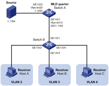

As shown in Figure 4:
·     Layer 3 device Switch A runs MLD and acts as the MLD querier. Layer 2 device Switch B runs MLDv1 snooping.
·     The IPv6 multicast source sends IPv6 multicast data to IPv6 multicast group FF1E::101. Receivers Host A, Host B, and Host C belong to VLAN 2, VLAN 3, and VLAN 4, respectively.
Configure a sub-VLAN-based IPv6 multicast VLAN on Switch B to meet the following requirements:
·     Switch A sends the IPv6 multicast data to Switch B through the IPv6 multicast VLAN.
·     Switch B forwards the IPv6 multicast data to the receivers in different user VLANs.
Figure 4 Network diagram

Port-based IPv6 multicast VLAN configuration example
Network requirements
As shown in Figure 5:
·     Layer 3 device Switch A runs MLDv1 and acts as the MLD querier. Layer 2 device Switch B runs MLDv1 snooping.
Configure a port-based IPv6 multicast VLAN on Switch B to meet the following requirements:
·     Switch A sends IPv6 multicast data to Switch B through the IPv6 multicast VLAN.
Figure 5 Network diagram
