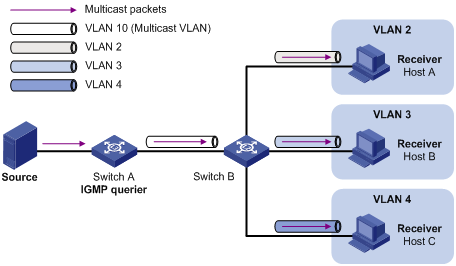

As shown in Figure 1, Host A, Host B, and Host C are in three different VLANs and the same multicast group. When Switch A (Layer 3 device) receives multicast data for that group, it sends three copies of the multicast data to Switch B (Layer 2 device). This occupies a large amount of bandwidth and increases the burden on the Layer 3 device.
Figure 1 Multicast transmission without the multicast VLAN feature
After a multicast VLAN is configured on Switch B, Switch A sends only one copy of the multicast data to the multicast VLAN on Switch B. This method saves network bandwidth and lessens the burden on the Layer 3 device.

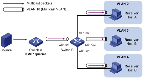

Sub-VLAN-based multicast VLAN
As shown in Figure 2:
·     Host A, Host B, and Host C are in VLAN 2 through VLAN 4, respectively.
·     On Switch B, VLAN 10 is a multicast VLAN. VLAN 2 through VLAN 4 are sub-VLANs of VLAN 10.
·     IGMP snooping is enabled for the multicast VLAN and its sub-VLANs.
Figure 2 Sub-VLAN-based multicast VLAN
IGMP snooping manages router ports in the multicast VLAN and member ports in each sub-VLAN. When Switch A receives multicast data from the multicast source, it sends only one copy of the multicast data to the multicast VLAN on Switch B. Then, Switch B sends a separate copy to each sub-VLAN in the multicast VLAN.

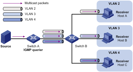

Port-based multicast VLAN
As shown in Figure 3:
·     On Switch B, VLAN 10 is a multicast VLAN. All the user ports are hybrid ports and are assigned to VLAN 10.
·     IGMP snooping is enabled for the multicast VLAN and VLAN 2 through VLAN 4.
Figure 3 Port-based multicast VLAN
IGMP snooping manages the router ports and member ports in the multicast VLAN. When Switch A receives multicast data from the multicast source, it sends only one copy of the multicast data to the multicast VLAN on Switch B. Switch B sends a separate copy to each user port in the multicast VLAN.

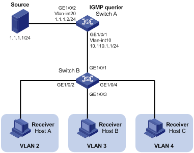

Network requirements
As shown in Figure 4:
·     Layer 3 device Switch A runs IGMPv2 and acts as the IGMP querier. Layer 2 device Switch B runs IGMPv2 snooping.
·     The multicast source sends multicast data to multicast group 224.1.1.1. Receivers Host A, Host B, and Host C belong to VLAN 2, VLAN 3, and VLAN 4, respectively.
Configure a sub-VLAN-based multicast VLAN on Switch B to meet the following requirements:
·     Switch A sends the multicast data to Switch B through the multicast VLAN.
·     Switch B forwards the multicast data to the receivers in different user VLANs.
Figure 4 Network diagram

Port-based multicast VLAN configuration example
As shown in Figure 5:
Configure a port-based multicast VLAN on Switch B to meet the following requirements:
·     Switch A sends multicast data to Switch B through the multicast VLAN.
Figure 5 Network diagram
Configuration procedure

# Display information about multicast VLANs on Switch B.
[SwitchB] display multicast-vlan
Total 1 multicast VLANs.
Multicast VLAN 10:
  Sub-VLAN list(0 in total):
  Port list(0 in total):
    GE1/0/2
    GE1/0/3
    GE1/0/4
# Display dynamic IGMP snooping forwarding entries on Switch B.
[SwitchB] display igmp-snooping group
Total 1 entries.
VLAN 10: Total 1 entries.
  (0.0.0.0, 224.1.1.1)
    Host slots (0 in total):
    Host ports (3 in total):
      GE1/0/2        (00:03:23)
      GE1/0/3        (00:04:07)
      GE1/0/4        (00:04:16)
The output shows that IGMP snooping maintains the user ports in the multicast VLAN (VLAN 10). Switch B will forward the multicast data of VLAN 10 through these user ports.
