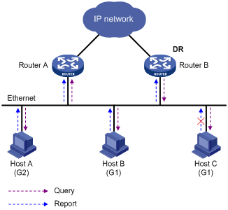

IGMPv1 manages multicast group memberships based on the query and response mechanism.
All routers that run IGMP on the same subnet can get IGMP membership report messages (called reports) from hosts. However, only one router can act as the IGMP querier to send IGMP query messages (called queries). The querier election mechanism determines which router acts as the IGMP querier on the subnet.
In IGMPv1, the DR elected by the multicast routing protocol (such as PIM) acts as the IGMP querier. For more information about DR, see "Configuring PIM."
Figure 1 IGMP queries and reports
As shown in Figure 1, Host B and Host C are interested in the multicast data addressed to the multicast group G1. Host A is interested in the multicast data addressed to G2. The following process describes how the hosts join the multicast groups and how the IGMP querier (Router B in Figure 1) maintains the multicast group memberships:
1.     The hosts send unsolicited IGMP reports to the multicast groups they want to join without having to wait for the IGMP queries.
2.     The IGMP querier periodically multicasts IGMP queries (with the destination address of 224.0.0.1) to all hosts and routers on the local subnet.
3.     After receiving a query message, the host whose report delay timer expires first sends an IGMP report to multicast group G1 to announce its membership for G1. In this example, Host B sends the report message. After receiving the report from Host B, Host C suppresses its own report for G1.
Because IGMP routers already know that G1 has a minimum of one member, other members do not need to report their memberships. This mechanism, known as the host IGMP report suppression, helps reduce traffic on the local subnet.
4.     At the same time, Host A sends a report to the multicast group G2 after receiving a query.
5.     Through the query and response process, the IGMP routers (Router A and Router B) determine that the local subnet has members of G1 and G2. The multicast routing protocol (PIM, for example) on the routers generates (*, G1) and (*, G2) multicast forwarding entries, where asterisk (*) represents any multicast source. These entries are the basis for subsequent multicast forwarding.
6.     When the multicast data addressed to G1 or G2 reaches an IGMP router, the router looks up the multicast forwarding table. Based on the (*, G1) or (*, G2) entries, the router forwards the multicast data to the local subnet. Then, the receivers on the subnet can receive the data.

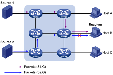

As shown in Figure 2, the network has two multicast sources: Source 1 (S1) and Source 2 (S2). Both of these sources can send multicast data to the multicast group G. Host B wants to receive the multicast data addressed to G from Source 1 but not from Source 2.
Figure 2 Flow paths of source-and-group-specific multicast traffic
In IGMPv1 or IGMPv2, Host B cannot select multicast sources when it joins the multicast group G. The multicast streams from both Source 1 and Source 2 flow to Host B whether or not it needs them.
In IGMPv3, Host B can explicitly express that it needs to receive multicast data destined to the multicast group G from Source 1 but not from Source 2.

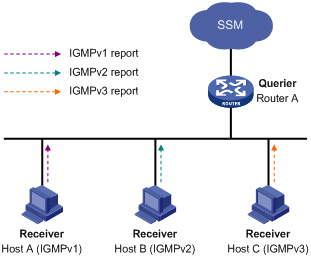

Figure 3 IGMP SSM mapping
As shown in Figure 3, on an SSM network, Host A, Host B, and Host C run IGMPv1, IGMPv2, and IGMPv3, respectively. To provide the SSM service for Host A and Host B, you must configure the IGMP SSM mapping feature on Router A.
After IGMP SSM mappings are configured, Router A checks the multicast group address G in the received IGMPv1 or IGMPv2 report, and performs the following operations:
·     If G is not in the SSM group range, Router A provides the ASM service.
·     If G is in the SSM group range but does not match any IGMP SSM mapping, Router A drops the report.
·     If G is in the SSM group range and matches IGMP SSM mappings, Router A translates (*, G) in the report into (G, INCLUDE, (S1, S2...)) to provide SSM services.
The IGMP SSM mapping feature does not process IGMPv3 reports.

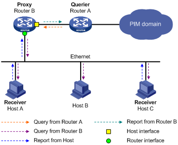

IGMP proxying
As shown in Figure 4, in a simple tree-shaped topology, it is not necessary to run multicast routing protocols, such as PIM, on edge devices. Instead, you can configure IGMP proxying on these devices. With IGMP proxying configured, the edge device acts as an IGMP proxy:
·     For the upstream IGMP querier, the IGMP proxy device acts as a host.
·     For the downstream receiver hosts, the IGMP proxy device acts as an IGMP querier.
Figure 4 IGMP proxying
The following types of interfaces are defined in IGMP proxying:
·     Host interface—An interface that is in the direction toward the root of the multicast forwarding tree. A host interface acts as a receiver host that is running IGMP. IGMP proxying must be enabled on this interface. This interface is also called the "proxy interface."
·     Router interface—An interface that is in the direction toward the leaf of the multicast forwarding tree. A router interface acts as a router that is running IGMP. IGMP must be configured on this interface.
An IGMP proxy device maintains a group membership database, which stores the group memberships on all the router interfaces. The host interfaces and router interfaces perform actions based on this membership database.
·     The host interfaces respond to queries according to the membership database or send join/leave messages when the database changes.
·     The router interfaces participate in the querier election, send queries, and maintain memberships based on received IGMP reports.

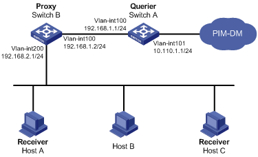

Enabling IGMP proxying
When you enable IGMP proxying, follow these restrictions and guidelines:
·     You must enable IGMP proxying on the receiver-side interfaces.
·     On an interface enabled with IGMP proxying, only the igmp version command takes effect and other IGMP commands do not take effect.
·     If you enable both IGMP proxying and a multicast routing protocol (such as PIM or MSDP) on the same device, the multicast routing protocol does not take effect.
In IGMPv1, the DR is elected by PIM and acts as the IGMP querier. Because PIM does not take effect on a proxy device, a router interface running IGMPv1 cannot be elected as the DR. To ensure that the downstream receiver hosts on the router interface can receive multicast data, you must enable multicast forwarding on the interface. For more information, see "Enabling multicast forwarding on a non-querier interface."
To enable IGMP proxying:
Step
Remarks
N/A
2.     Enable IP multicast routing and enter MRIB view.
multicast routing [ vpn-instance vpn-instance-name ]
By default, IP multicast routing is disabled.
3.     Return to system view.
N/A
4.     Enter interface view.
N/A
5.     Enable IGMP proxying.
igmp proxying enable
By default, IGMP proxying is disabled.

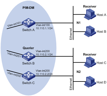

Basic IGMP features configuration examples
Network requirements
As shown in Figure 5:
·     OSPF and PIM-DM run on the network.
·     VOD streams are sent to receiver hosts in multicast. Receiver hosts of different organizations form stub networks N1 and N2. Host A and Host C are receiver hosts in N1 and N2, respectively.
·     IGMPv2 runs between Switch A and N1, and between the other two switches and N2. Switch A acts as the IGMP querier in N1. Switch B acts as the IGMP querier in N2 because it has a lower IP address.
Configure the routers to meet the following requirements:
·     The hosts in N1 can join only multicast group 224.1.1.1.
·     The hosts in N2 can join any multicast groups.
Figure 5 Network diagram
Configuration procedure
1.     Assign an IP address and subnet mask to each interface, as shown in Figure 5. (Details not shown.)
2.     Configure OSPF on the switches in the PIM-DM domain. (Details not shown.)
3.     Enable IP multicast routing, IGMP, and PIM-DM:
# On Switch A, enable IP multicast routing.
<SwitchA> system-view
[SwitchA] multicast routing
[SwitchA-mrib] quit
# Enable IGMP on VLAN-interface 100.
[SwitchA-Vlan-interface100] igmp enable
# Enable PIM-DM on VLAN-interface 101.
[SwitchA] interface vlan-interface 101
[SwitchA-Vlan-interface101] pim dm
[SwitchA-Vlan-interface101] quit
# On Switch B, enable IP multicast routing.
<SwitchB> system-view
[SwitchB] multicast routing
[SwitchB-mrib] quit
# Enable IGMP on VLAN-interface 200.
[SwitchB] interface vlan-interface 200
[SwitchB-Vlan-interface200] igmp enable
[SwitchB-Vlan-interface200] quit
# Enable PIM-DM on VLAN-interface 201.
[SwitchB] interface vlan-interface 201
[SwitchB-Vlan-interface201] pim dm
[SwitchB-Vlan-interface201] quit
# On Switch C, enable IP multicast routing.
<SwitchC> system-view
[SwitchC] multicast routing
[SwitchC-mrib] quit
[SwitchC] interface vlan-interface 200
[SwitchC-Vlan-interface200] igmp enable
[SwitchC-Vlan-interface200] quit
# Enable PIM-DM on VLAN-interface 202.
[SwitchC] interface vlan-interface 202
[SwitchC-Vlan-interface202] pim dm
[SwitchC-Vlan-interface202] quit
4.     Configure a multicast group policy on Switch A so that hosts connected to VLAN-interface 100 can join only multicast group 224.1.1.1.
[SwitchA] acl basic 2001
[SwitchA-acl-ipv4-basic-2001] rule permit source 224.1.1.1 0
[SwitchA-acl-ipv4-basic-2001] quit
[SwitchA-Vlan-interface100] igmp group-policy 2001
# Display IGMP information for VLAN-interface 200 on Switch B.
[SwitchB] display igmp interface vlan-interface 200
 Vlan-interface200(10.110.2.1):
   IGMP is enabled.
   IGMP version: 2
   Query interval for IGMP: 125s
   Other querier present time for IGMP: 255s
   Maximum query response time for IGMP: 10s
   Querier for IGMP: 10.110.2.1 (This router)
  IGMP groups reported in total: 1

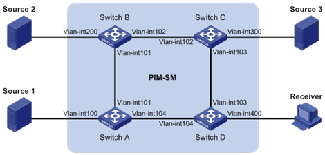

IGMP SSM mapping configuration example
As shown in Figure 6:
·     OSPF runs on the network.
·     The PIM-SM domain uses both the ASM model and SSM model for multicast delivery. VLAN-interface 104 on Switch D acts as the C-BSR and C-RP. The SSM group range is 232.1.1.0/24.
·     IGMPv3 runs on VLAN-interface 400 of Switch D. The receiver host runs IGMPv2, and does not support IGMPv3. The receiver host cannot specify multicast sources in its membership reports.
·     Source 1, Source 2, and Source 3 send multicast packets to multicast groups in the SSM group range 232.1.1.0/24.
Configure the IGMP SSM mapping feature on Switch D so that the receiver host can receive multicast data only from Source 1 and Source 3.
Figure 6 Network diagram
Device
Interface
IP address
Device
Interface
IP address
Source 1
133.133.1.1/24
Source 3
133.133.3.1/24
Source 2
133.133.2.1/24
Receiver
133.133.4.1/24
Switch A
Vlan-int100
133.133.1.2/24
Switch C
Vlan-int300
133.133.3.2/24
Switch A
Vlan-int101
192.168.1.1/24
Switch C
Vlan-int103
192.168.3.1/24
Switch A
Vlan-int104
192.168.4.2/24
Switch C
Vlan-int102
192.168.2.2/24
Switch B
Vlan-int200
133.133.2.2/24
Switch D
Vlan-int400
133.133.4.2/24
Switch B
Vlan-int101
192.168.1.2/24
Switch D
Vlan-int103
192.168.3.2/24
Switch B
Vlan-int102
192.168.2.1/24
Switch D
Vlan-int104
192.168.4.1/24
1.     Assign an IP address and subnet mask to each interface, as shown in Figure 6. (Details not shown.)
2.     Configure OSPF on the switches in the PIM-SM domain. (Details not shown.)
3.     Enable IP multicast routing, PIM-SM, and IGMP:
# On Switch D, enable IP multicast routing.
<SwitchD> system-view
[SwitchD] multicast routing
[SwitchD-mrib] quit
# Enable IGMPv3 on the receiver-side interface (VLAN-interface 400).
[SwitchD] interface vlan-interface 400
[SwitchD-Vlan-interface400] igmp enable
[SwitchD-Vlan-interface400] igmp version 3
[SwitchD-Vlan-interface400] quit
# Enable PIM-SM on the other interfaces.
[SwitchD] interface vlan-interface 103
[SwitchD-Vlan-interface103] pim sm
[SwitchD-Vlan-interface103] quit
[SwitchD] interface vlan-interface 104
[SwitchD-Vlan-interface104] pim sm
[SwitchD-Vlan-interface104] quit
[SwitchA-mrib] quit
# Enable PIM-SM on each interface.
[SwitchA-Vlan-interface100] pim sm
[SwitchA-Vlan-interface101] pim sm
[SwitchA] interface vlan-interface 104
[SwitchA-Vlan-interface104] pim sm
[SwitchA-Vlan-interface104] quit
# Configure Switch B and Switch C in the same way Switch A is configured. (Details not shown.)
4.     On Switch D, configure VLAN-interface 104 as a C-BSR and a C-RP.
[SwitchD] pim
[SwitchD-pim] c-bsr 192.168.4.1
[SwitchD-pim] c-rp 192.168.4.1
[SwitchD-pim] quit
5.     Configure the SSM group range:
# On Switch D, specify 232.1.1.0/24 as the SSM group range.
[SwitchD] acl basic 2000
[SwitchD-acl-ipv4-basic-2000] rule permit source 232.1.1.0 0.0.0.255
[SwitchD-acl-ipv4-basic-2000] quit
[SwitchD] pim
[SwitchD-pim] ssm-policy 2000
[SwitchD-pim] quit
# Configure the SSM group range on Switch A, Switch B, and Switch C in the same way Switch D is configured. (Details not shown.)
6.     Configure IGMP SSM mappings on Switch D.
[SwitchD] igmp
[SwitchD-igmp] ssm-mapping 133.133.1.1 2000
[SwitchD-igmp] ssm-mapping 133.133.3.1 2000
[SwitchD-igmp] quit
# Display IGMP SSM mappings for multicast group 232.1.1.1 on Switch D.
[SwitchD] display igmp ssm-mapping 232.1.1.1
 Group: 232.1.1.1
 Source list:
        133.133.1.1
        133.133.3.1
# On Switch D, display information about IGMP multicast groups that hosts have dynamically joined.
[SwitchD] display igmp group
IGMP groups in total: 1
 Vlan-interface400(133.133.4.2):
   Group address   Last reporter   Uptime      Expires
   232.1.1.1       133.133.4.1     00:02:04    off
# Display PIM routing entries on Switch D.
[SwitchD] display pim routing-table
 Total 0 (*, G) entry; 2 (S, G) entry
 (133.133.1.1, 232.1.1.1)
     RP: 192.168.4.1
     Protocol: pim-ssm, Flag:
     UpTime: 00:13:25
     Upstream interface: Vlan-interface104
         Upstream neighbor: 192.168.4.2
         RPF prime neighbor: 192.168.4.2
     Downstream interface(s) information:
     Total number of downstreams: 1
         1: Vlan-interface400
             Protocol: igmp, UpTime: 00:13:25, Expires: -
 (133.133.3.1, 232.1.1.1)
     RP: 192.168.4.1
     UpTime: 00:13:25
     Upstream interface: Vlan-interface103
         Upstream neighbor: 192.168.3.1
         RPF prime neighbor: 192.168.3.1
IGMP proxying configuration example
As shown in Figure 7:
·     PIM-DM runs on the core network.
·     Host A and Host C on the stub network receive VOD information sent to multicast group 224.1.1.1.
Configure the IGMP proxying feature on Switch B so that Switch B can maintain group memberships and forward multicast traffic without running PIM-DM.
Figure 7 Network diagram
1.     Assign an IP address and subnet mask to each interface, as shown in Figure 7. (Details not shown.)
2.     Enable IP multicast routing, PIM-DM, IGMP, and IGMP proxying:
[SwitchA-mrib] quit
[SwitchB-mrib] quit
# Enable IGMP proxying on VLAN-interface 100.
[SwitchB-Vlan-interface100] igmp proxy enable
# Display multicast group membership information maintained by the IGMP proxy on Switch B.
[SwitchB] display igmp proxy group
IGMP proxy group records in total: 1
 Vlan-interface100(192.168.1.2):
   Group address      Member state      Expires
   224.1.1.1          Delay             00:00:02
