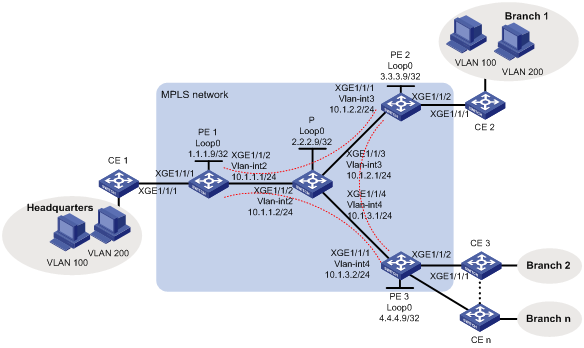

Example: Configuring full-mesh LDP VPLS
Network requirements
As shown in Figure 1, the MPLS network provides L2VPN services for a company. The company has a headquarters and two branches, and it will not add sites in the future.
Configure full-mesh VPLS using LDP signaling to allow communication among the three sites at Layer 2.
Figure 1 Network diagram
Requirements analysis
To meet the network requirements, you must perform the following tasks:
·     To implement LDP VPLS over the MPLS backbone, you must perform the following tasks:
¡     Establish LDP LSPs on the MPLS backbone as public tunnels to deliver the private data over the MPLS network.
¡     Configure an LDP PW between any two PEs to forward data among the branches.
¡     Configure service instances and match criteria on the CE-facing interfaces of PEs to identify packets to be transported by VPLS.
·     To implement VLAN isolation among the sites, create VSIs user_a and user_b. Bind VSI user_a to the service instance that matches packets of VLAN 100, and bind VSI user_b to the service instance that matches packets of VLAN 200.
Software version used
This configuration example was created and verified on S7500EXS-CMW710-R7178.
Configuration procedures

5.     Allow CE access to PEs:
# On CE 1, configure the interface connected to the PE to permit tagged packets from the customer VLANs.
<CE1> system-view
[CE1] vlan 100
[CE1-vlan100] quit
[CE1] vlan 200
[CE1-vlan200] quit
[CE1] interface ten-gigabitethernet 1/1/1
[CE1-Ten-GigabitEthernet1/1/1] port link-type trunk
[CE1-Ten-GigabitEthernet1/1/1] port trunk permit vlan 100 200
# Configure other CEs in the same way that CE 1 is configured. (Details not shown.)

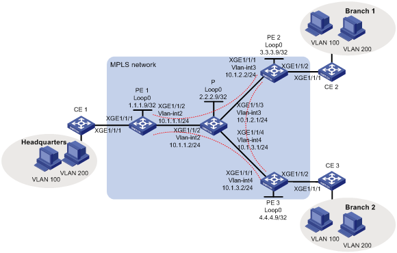

Example: Configuring full-mesh LDP VPLS using BGP auto-discovery
As shown in Figure 2, the MPLS network provides L2VPN services for a company. The company has a headquarters and a large number of branches, and it will not add sites in the future.
Configure full-mesh VPLS using BGP auto-discovery and LDP signaling to allow communication among all the sites at Layer 2.
Figure 2 Network diagram
·     To implement LDP VPLS using BGP auto-discovery over the MPLS backbone, you must perform the following tasks:
¡     Configure a BGP auto-discovery LDP PW between any two PEs to forward data among the branches.
1.     Configure an IGP on the MPLS backbone to ensure IP connectivity within the backbone:

3.     Configure VSIs and BGP auto-discovery LDP PWs:
# On PE 1, establish IBGP connections to PE 2 and PE 3.
[PE1] bgp 100
[PE1-bgp] peer 3.3.3.9 as-number 100
[PE1-bgp] peer 3.3.3.9 connect-interface loopback 0
[PE1-bgp] peer 4.4.4.9 as-number 100
[PE1-bgp] peer 4.4.4.9 connect-interface loopback 0
# On PE 1, enable BGP to exchange L2VPN information with the peers.
[PE1-bgp] address-family l2vpn
[PE1-bgp-l2vpn] peer 3.3.3.9 enable
[PE1-bgp-l2vpn] peer 4.4.4.9 enable
[PE1-bgp-l2vpn] quit
[PE1-bgp] quit
# On PE 1, enable MPLS L2VPN globally.
[PE1] l2vpn enable
# On PE 1, create VSI user_a and enable the VSI to automatically discover neighbors through BGP.
[PE1] vsi user_a
[PE1-vsi-user_a] auto-discovery bgp
# On PE 1, configure an RD and route targets for the VSI.
[PE1-vsi-user_a-auto] route-distinguisher 100:1
[PE1-vsi-user_a-auto] vpn-target 111:1
# On PE 1, use LDP to establish a PW to a remote PE discovered by BGP.
[PE1-vsi-user_a-auto] signaling-protocol ldp
# On PE 1, configure the VPLS ID as 100:100 for the VSI.
[PE1-vsi-user_a-auto-ldp] vpls-id 100:100
[PE1-vsi-user_a-auto-ldp] quit
[PE1-vsi-user_a-auto] quit
[PE1-vsi-user_a] quit
# On PE 1, create VSI user_b and enable the VSI to automatically discover neighbors through BGP.
[PE1] vsi user_b
[PE1-vsi-user_b] auto-discovery bgp
[PE1-vsi-user_b-auto] route-distinguisher 200:1
[PE1-vsi-user_b-auto] vpn-target 222:1
[PE1-vsi-user_b-auto] signaling-protocol ldp
# On PE 1, configure the VPLS ID as 200:200 for the VSI.
[PE1-vsi-user_b-auto-ldp] vpls-id 200:200
[PE1-vsi-user_b-auto-ldp] quit
[PE1-vsi-user_b-auto] quit
[PE1-vsi-user_b] quit
# On PE 2, establish IBGP connections to PE 1 and PE 3.
[PE2] bgp 100
[PE2-bgp] peer 1.1.1.9 as-number 100
[PE2-bgp] peer 1.1.1.9 connect-interface loopback 0
[PE2-bgp] peer 4.4.4.9 as-number 100
[PE2-bgp] peer 4.4.4.9 connect-interface loopback 0
# On PE 2, enable BGP to exchange L2VPN information with the peers.
[PE2-bgp] address-family l2vpn
[PE2-bgp-l2vpn] peer 1.1.1.9 enable
[PE2-bgp-l2vpn] peer 4.4.4.9 enable
[PE2-bgp-l2vpn] quit
[PE2-bgp] quit
# On PE 2, enable MPLS L2VPN globally.
[PE2] l2vpn enable
# On PE 2, create VSI user_a and enable the VSI to automatically discover neighbors through BGP.
[PE2] vsi user_a
[PE2-vsi-user_a] auto-discovery bgp
# On PE 2, configure an RD and route targets for the VSI.
[PE2-vsi-user_a-auto] route-distinguisher 100:1
[PE2-vsi-user_a-auto] vpn-target 111:1
# On PE 2, use LDP to establish a PW to a remote PE discovered by BGP.
[PE2-vsi-user_a-auto] signaling-protocol ldp
# On PE 2, configure the VPLS ID as 100:100 for the VSI.
[PE2-vsi-user_a-auto-ldp] vpls-id 100:100
[PE2-vsi-user_a-auto-ldp] quit
[PE2-vsi-user_a-auto] quit
[PE2-vsi-user_a] quit
# On PE 2, create VSI user_b and enable the VSI to automatically discover neighbors through BGP.
[PE2] vsi user_b
[PE2-vsi-user_b] auto-discovery bgp
[PE2-vsi-user_b-auto] route-distinguisher 200:1
[PE2-vsi-user_b-auto] vpn-target 222:1
[PE2-vsi-user_b-auto] signaling-protocol ldp
# On PE 2, configure the VPLS ID as 200:200 for the VSI.
[PE2-vsi-user_b-auto-ldp] vpls-id 200:200
[PE2-vsi-user_b-auto-ldp] quit
[PE2-vsi-user_b-auto] quit
[PE2-vsi-user_b] quit
# On PE 3, establish IBGP connections to PE 1 and PE 2.
[PE3] bgp 100
[PE3-bgp] peer 1.1.1.9 as-number 100
[PE3-bgp] peer 1.1.1.9 connect-interface loopback 0
[PE3-bgp] peer 3.3.3.9 as-number 100
[PE3-bgp] peer 3.3.3.9 connect-interface loopback 0
# On PE 3, enable BGP to exchange L2VPN information with the peers.
[PE3-bgp] address-family l2vpn
[PE3-bgp-l2vpn] peer 1.1.1.9 enable
[PE3-bgp-l2vpn] peer 3.3.3.9 enable
[PE3-bgp-l2vpn] quit
[PE3-bgp] quit
# On PE 3, enable MPLS L2VPN globally.
[PE3] l2vpn enable
# On PE 3, create VSI user_a and enable the VSI to automatically discover neighbors through BGP.
[PE3] vsi user_a
[PE3-vsi-user_a] auto-discovery bgp
# On PE 3, configure an RD and route targets for the VSI.
[PE3-vsi-user_a-auto] route-distinguisher 100:1
[PE3-vsi-user_a-auto] vpn-target 111:1
# On PE 3, use LDP to establish a PW to a remote PE discovered by BGP.
[PE3-vsi-user_a-auto] signaling-protocol ldp
# On PE 3, configure the VPLS ID as 100:100 for the VSI.
[PE3-vsi-user_a-auto-ldp] vpls-id 100:100
[PE3-vsi-user_a-auto-ldp] quit
[PE3-vsi-user_a-auto] quit
[PE3-vsi-user_a] quit
# On PE 3, create VSI user_b and enable the VSI to automatically discover neighbors through BGP.
[PE3] vsi user_b
[PE3-vsi-user_b] auto-discovery bgp
[PE3-vsi-user_b-auto] route-distinguisher 200:1
[PE3-vsi-user_b-auto] vpn-target 222:1
[PE3-vsi-user_b-auto] signaling-protocol ldp
# On PE 3, configure the VPLS ID as 200:200 for the VSI.
[PE3-vsi-user_b-auto-ldp] vpls-id 200:200
[PE3-vsi-user_b-auto-ldp] quit
[PE3-vsi-user_b-auto] quit
[PE3-vsi-user_b] quit
4.     Configure service instances for different VLANs and bind the service instances to VSIs:
# On PE 1, create service instance 100 on Ten-GigabitEthernet 1/1/1 to match packets of VLAN 100, and bind the service instance to VSI user_a.
[PE1] interface ten-gigabitethernet 1/1/1
[PE1-Ten-GigabitEthernet1/1/1] service-instance 100
[PE1-Ten-GigabitEthernet1/1/1-srv100] encapsulation s-vid 100
[PE1-Ten-GigabitEthernet1/1/1-srv100] xconnect vsi user_a
[PE1-Ten-GigabitEthernet1/1/1-srv100] quit
# On PE 1, create service instance 200 on Ten-GigabitEthernet 1/1/1 to match packets of VLAN 200, and bind the service instance to VSI user_b.
[PE1-Ten-GigabitEthernet1/1/1] service-instance 200
[PE1-Ten-GigabitEthernet1/1/1-srv200] encapsulation s-vid 200
[PE1-Ten-GigabitEthernet1/1/1-srv200] xconnect vsi user_b
[PE1-Ten-GigabitEthernet1/1/1-srv200] quit
[PE1-Ten-GigabitEthernet1/1/1] quit
# On PE 2, create service instance 100 on Ten-GigabitEthernet 1/1/2 to match packets of VLAN 100, and bind the service instance to VSI user_a.
[PE2] interface ten-gigabitethernet 1/1/2
[PE2-Ten-GigabitEthernet1/1/2] service-instance 100
[PE2-Ten-GigabitEthernet1/1/2-srv100] encapsulation s-vid 100
[PE2-Ten-GigabitEthernet1/1/2-srv100] xconnect vsi user_a
[PE2-Ten-GigabitEthernet1/1/2-srv100] quit
# On PE 2, create service instance 200 on Ten-GigabitEthernet 1/1/2 to match packets of VLAN 200, and bind the service instance to VSI user_b.
[PE2-Ten-GigabitEthernet1/1/2] service-instance 200
[PE2-Ten-GigabitEthernet1/1/2-srv200] encapsulation s-vid 200
[PE2-Ten-GigabitEthernet1/1/2-srv200] xconnect vsi user_b
[PE2-Ten-GigabitEthernet1/1/2-srv200] quit
[PE2-Ten-GigabitEthernet1/1/2] quit
# On PE 3, create service instance 100 on Ten-GigabitEthernet 1/1/2 to match packets of VLAN 100, and bind the service instance to VSI user_a.
[PE3] interface ten-gigabitethernet 1/1/2
[PE3-Ten-GigabitEthernet1/1/2] service-instance 100
[PE3-Ten-GigabitEthernet1/1/2-srv100] encapsulation s-vid 100
[PE3-Ten-GigabitEthernet1/1/2-srv100] xconnect vsi user_a
[PE3-Ten-GigabitEthernet1/1/2-srv100] quit
# On PE 3, create service instance 200 on Ten-GigabitEthernet 1/1/2 to match packets of VLAN 200, and bind the service instance to VSI user_b.
[PE3-Ten-GigabitEthernet1/1/2] service-instance 200
[PE3-Ten-GigabitEthernet1/1/2-srv200] encapsulation s-vid 200
[PE3-Ten-GigabitEthernet1/1/2-srv200] xconnect vsi user_b
[PE3-Ten-GigabitEthernet1/1/2-srv200] quit
[PE3-Ten-GigabitEthernet1/1/2] quit
# On PE 3, configure other CE-facing interfaces in the same way that Ten-GigabitEthernet 1/1/2 is configured. (Details not shown.)
<CE1> system-view
[CE1] vlan 100
[CE1-vlan100] quit
[CE1] vlan 200
[CE1-vlan200] quit
# Verify that LDP LSPs have been established on each switch in the MPLS network. This example uses PE 1.
[PE1] display mpls ldp lsp
Status Flags: * - stale, L - liberal
Statistics:
  FECs: 4      Ingress LSPs: 3     Transit LSPs: 3     Egress LSPs: 1
FEC                In/Out Label    Nexthop         OutInterface
1.1.1.9/32         3/-
                   -/1148(L)
                   -/1151(L)
                   -/1151(L)
2.2.2.9/32         -/3             10.1.1.2        Vlan2
                   1151/3          10.1.1.2        Vlan2
                   -/1150(L)
                   -/1150(L)
3.3.3.9/32         -/1146          10.1.1.2        Vlan2
                   1149/1146       10.1.1.2        Vlan2
                   -/1149(L)
                   -/3(L)
4.4.4.9/32         -/1147          10.1.1.2        Vlan2
                   1150/1147       10.1.1.2        Vlan2
                   -/3(L)
                   -/1149(L)
# Verify that LDP PWs in up state have been established on each PE. This example uses PE 1.
[PE1] display l2vpn pw
Flags: M - main, B - backup, H - hub link, S - spoke link, N - no split horizon
Total number of PWs: 4
4 up, 0 blocked, 0 down, 0 defect, 0 idle, 0 duplicate
VSI Name: user_a
Peer            PW ID/Rmt Site    In/Out Label    Proto   Flag  Link ID  State
3.3.3.9         -                 131195/131195   LDP     M     64       Up
4.4.4.9         -                 131194/1145     LDP     M     65       Up
VSI Name: user_b
4.4.4.9         -                 131193/1143     LDP     M     64       Up
3.3.3.9         -                 131192/131192   LDP     M     65       Up
# Verify that hosts in the same VLAN but different sites can ping each other. (Details not shown.)

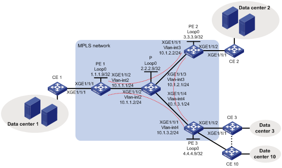

Example: Configuring full-mesh BGP VPLS
As shown in Figure 3, the MPLS network provides L2VPN services for a company. The company has 10 data centers and will add 15 data centers in the future.
Configure full-mesh VPLS using BGP signaling to allow communication among the data centers at Layer 2.
Figure 3 Network diagram
·     To implement BGP VPLS over the MPLS backbone, you must perform the following tasks:
¡     Configure a BGP PW between any two PEs to forward data among the data centers.
·     For future expansion of the customer network, set the maximum number of sites in the VPN to 25.
# On PE 1, configure an IP address for Loopback 0.
<PE1> system-view
[PE1] interface loopback 0
[PE1-LoopBack0] ip address 1.1.1.9 32
[PE1-LoopBack0] quit
# On PE 1, create VLAN 2 and assign Ten-GigabitEthernet 1/1/2 to the VLAN.
[PE1] vlan 2
[PE1-vlan2] port ten-gigabitethernet 1/1/2
[PE1-vlan2] quit
# On PE 1, configure VLAN-interface 2.
[PE1] interface vlan-interface 2
[PE1-Vlan-interface2] ip address 10.1.1.1 24
[PE1-Vlan-interface2] quit
# On PE 1, configure OSPF.
[PE1] ospf
[PE1-ospf-1] area 0
[PE1-ospf-1-area-0.0.0.0] network 10.1.1.0 0.0.0.255
[PE1-ospf-1-area-0.0.0.0] network 1.1.1.9 0.0.0.0
[PE1-ospf-1-area-0.0.0.0] quit
[PE1-ospf-1] quit
# On PE 2, configure an IP address for Loopback 0.
<PE2> system-view
[PE2] interface loopback 0
[PE2-LoopBack0] ip address 3.3.3.9 32
[PE2-LoopBack0] quit
# On PE 2, create VLAN 3 and assign Ten-GigabitEthernet 1/1/1 to the VLAN.
[PE2] vlan 3
[PE2-vlan3] port ten-gigabitethernet 1/1/1
[PE2-vlan3] quit
# On PE 2, configure VLAN-interface 3.
[PE2] interface vlan-interface 3
[PE2-Vlan-interface3] ip address 10.1.2.2 24
[PE2-Vlan-interface3] quit
# On PE 2, configure OSPF.
[PE2] ospf
[PE2-ospf-1] area 0
[PE2-ospf-1-area-0.0.0.0] network 10.1.2.0 0.0.0.255
[PE2-ospf-1-area-0.0.0.0] network 3.3.3.9 0.0.0.0
[PE2-ospf-1-area-0.0.0.0] quit
[PE2-ospf-1] quit
# On PE 3, configure an IP address for Loopback 0.
<PE3> system-view
[PE3] interface loopback 0
[PE3-LoopBack0] ip address 4.4.4.9 32
[PE3-LoopBack0] quit
# On PE 3, create VLAN 4 and assign Ten-GigabitEthernet 1/1/1 to the VLAN.
[PE3] vlan 4
[PE3-vlan4] port ten-gigabitethernet 1/1/1
[PE3-vlan4] quit
# On PE 3, configure VLAN-interface 4.
[PE3] interface vlan-interface 4
[PE3-Vlan-interface4] ip address 10.1.3.2 24
[PE3-Vlan-interface4] quit
# On PE 3, configure OSPF.
[PE3] ospf
[PE3-ospf-1] area 0
[PE3-ospf-1-area-0.0.0.0] network 10.1.3.0 0.0.0.255
[PE3-ospf-1-area-0.0.0.0] network 4.4.4.9 0.0.0.0
[PE3-ospf-1-area-0.0.0.0] quit
[PE3-ospf-1] quit
# On P, configure an IP address for Loopback 0.
<P> system-view
[P] interface loopback 0
[P-LoopBack0] ip address 2.2.2.9 32
[P-LoopBack0] quit
# On P, create VLAN 2 and assign Ten-GigabitEthernet 1/1/2 to the VLAN.
[P] vlan 2
[P-vlan2] port ten-gigabitethernet 1/1/2
[P-vlan2] quit
# On P, configure VLAN-interface 2.
[P] interface vlan-interface 2
[P-Vlan-interface2] ip address 10.1.1.2 24
[P-Vlan-interface2] quit
# On P, create VLAN 3 and assign Ten-GigabitEthernet 1/1/3 to the VLAN.
[P] vlan 3
[P-vlan3] port ten-gigabitethernet 1/1/3
[P-vlan3] quit
# On P, configure VLAN-interface 3.
[P] interface vlan-interface 3
[P-Vlan-interface3] ip address 10.1.2.1 24
[P-Vlan-interface3] quit
# On P, create VLAN 4 and assign Ten-GigabitEthernet 1/1/4 to the VLAN.
[P] vlan 4
[P-vlan4] port ten-gigabitethernet 1/1/4
[P-vlan4] quit
# On P, configure VLAN-interface 4.
[P] interface vlan-interface 4
[P-Vlan-interface4] ip address 10.1.3.1 24
[P-Vlan-interface4] quit
# On P, configure OSPF.
[P] ospf
[P-ospf-1] area 0
[P-ospf-1-area-0.0.0.0] network 10.1.1.0 0.0.0.255
[P-ospf-1-area-0.0.0.0] network 10.1.2.0 0.0.0.255
[P-ospf-1-area-0.0.0.0] network 10.1.3.0 0.0.0.255
[P-ospf-1-area-0.0.0.0] network 2.2.2.9 0.0.0.0
[P-ospf-1-area-0.0.0.0] quit
[P-ospf-1] quit
2.     Configure basic MPLS and MPLS LDP on the MPLS backbone to establish LDP LSPs:
# On PE 1, configure an LSR ID.
[PE1] mpls lsr-id 1.1.1.9
# On PE 1, enable LDP globally.
[PE1] mpls ldp
[PE1-ldp] quit
# On PE 1, enable MPLS and LDP on VLAN-interface 2.
[PE1-Vlan-interface2] mpls enable
[PE1-Vlan-interface2] mpls ldp enable
# On PE 2, configure an LSR ID.
[PE2] mpls lsr-id 3.3.3.9
# On PE 2, enable LDP globally.
[PE2] mpls ldp
[PE2-ldp] quit
# On PE 2, enable MPLS and LDP on VLAN-interface 3.
[PE2-Vlan-interface3] mpls enable
[PE2-Vlan-interface3] mpls ldp enable
# On PE 3, configure an LSR ID.
[PE3] mpls lsr-id 4.4.4.9
# On PE 3, enable LDP globally.
[PE3] mpls ldp
[PE3-ldp] quit
# On PE 3, enable MPLS and LDP on VLAN-interface 4.
[PE3-Vlan-interface4] mpls enable
[PE3-Vlan-interface4] mpls ldp enable
# On P, configure an LSR ID.
[P] mpls lsr-id 2.2.2.9
# On P, enable LDP globally.
[P] mpls ldp
[P-ldp] quit
# On P, enable MPLS and LDP on VLAN-interface 2.
[P-Vlan-interface2] mpls enable
[P-Vlan-interface2] mpls ldp enable
# On P, enable MPLS and LDP on VLAN-interface 3.
[P-Vlan-interface3] mpls enable
[P-Vlan-interface3] mpls ldp enable
# On P, enable MPLS and LDP on VLAN-interface 4.
[P-Vlan-interface4] mpls enable
[P-Vlan-interface4] mpls ldp enable
3.     Configure VSIs and BGP PWs:
[PE1] bgp 100
[PE1-bgp] quit
[PE1] l2vpn enable
[PE1] vsi user_a
# On PE 1, use BGP to establish a PW to a remote PE discovered by BGP.
[PE1-vsi-user_a-auto] signaling-protocol bgp
# On PE 1, set the site number in the VSI to 1 and the maximum number of sites in the VSI to 25.
[PE1-vsi-user_a-auto-bgp] site 1 range 25
[PE1-vsi-user_a-auto-bgp] quit
[PE1] vsi user_b
[PE1-vsi-user_b-auto] signaling-protocol bgp
[PE1-vsi-user_b-auto-bgp] site 1 range 25
[PE1-vsi-user_b-auto-bgp] quit
[PE2] bgp 100
[PE2-bgp] quit
[PE2] l2vpn enable
[PE2] vsi user_a
# On PE 2, use BGP to establish a PW to a remote PE discovered by BGP.
[PE2-vsi-user_a-auto] signaling-protocol bgp
# On PE 2, set the site number in the VSI to 2 and the maximum number of sites in the VSI to 25.
[PE2-vsi-user_a-auto-bgp] site 2 range 25
[PE2-vsi-user_a-auto-bgp] quit
[PE2] vsi user_b
[PE2-vsi-user_b-auto] signaling-protocol bgp
[PE2-vsi-user_b-auto-bgp] site 2 range 25
[PE2-vsi-user_b-auto-bgp] quit
[PE3] bgp 100
[PE3-bgp] quit
[PE3] l2vpn enable
[PE3] vsi user_a
# On PE 3, use BGP to establish a PW to a remote PE discovered by BGP.
[PE3-vsi-user_a-auto] signaling-protocol bgp
# On PE 3, set the site number in the VSI to 3 and the maximum number of sites in the VSI to 25.
[PE3-vsi-user_a-auto-bgp] site 3 range 25
[PE3-vsi-user_a-auto-bgp] quit
[PE3] vsi user_b
[PE3-vsi-user_b-auto] signaling-protocol bgp
[PE3-vsi-user_b-auto-bgp] site 3 range 25
[PE3-vsi-user_b-auto-bgp] quit

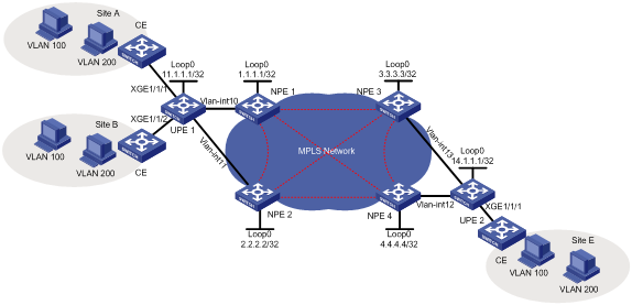

Example: Configuring H-VPLS with LSP access
As shown in Figure 4, a customer's branches are connected to the MPLS backbone through UPEs that support MPLS L2VPN.
Configure H-VPLS to allow communication among the branches at Layer 2.
·     Connect the UPEs to the NPEs through LSPs.
·     Configure UPE dual homing to achieve redundancy.
Figure 4 Network diagram
Device
Interface
IP address
Device
Interface
IP address
UPE 1
Loop0
11.1.1.1/32
UPE 2
Loop0
14.1.1.1/32
Vlan-int10
11.1.2.1/24
Vlan-int12
20.1.1.1/24
Vlan-int11
11.1.3.1/24
Vlan-int13
20.1.2.1/24
NPE 1
Loop0
1.1.1.1/32
NPE 3
Loop0
3.3.3.3/32
Vlan-int10
11.1.2.2/24
Vlan-int13
20.1.2.2/24
NPE 2
Loop0
2.2.2.2/32
NPE 4
Loop0
4.4.4.4/32
Vlan-int11
11.1.3.2/24
Vlan-int12
20.1.1.2/24
·     To negotiate inner labels, perform the following tasks:
¡     Configure each UPE and all the NPEs connected to the UPE as LDP peers.
¡     Configure any two NPEs as LDP peers.
·     To achieve NPE redundancy, configure the NPEs that are connected to each UPE as primary and backup peers.
·     To identify packets to be transported by VPLS, configure service instances and match criteria on the CE-facing interfaces of UPEs.
Configuring basic settings
# Create interfaces on UPEs and NPEs and configure IP addresses for the interfaces as shown in Figure 4. (Details not shown.)
# Configure an IGP on the MPLS backbone to ensure that the interfaces of NPEs and UPEs are reachable to each other. (Details not shown.)
# Configure basic MPLS and MPLS LDP on the MPLS backbone to establish LDP LSPs. (Details not shown.)
# Configure the ports of CEs connecting the UPEs as trunk ports that permit tagged packets from VLAN 100 and VLAN 200. (Details not shown.)
Configuring UPE 1
# Configure basic MPLS.
<UPE1> system-view
[UPE1] mpls lsr-id 11.1.1.1
[UPE1] mpls ldp
[UPE1-ldp] quit
# Configure basic MPLS on the interface connected to NPE 1.
[UPE1] interface vlan-interface 10
[UPE1-Vlan-interface10] mpls enable
[UPE1-Vlan-interface10] mpls ldp enable
[UPE1-Vlan-interface10] quit
# Configure basic MPLS on the interface connected to NPE 2.
[UPE1] interface vlan-interface 11
[UPE1-Vlan-interface11] mpls enable
[UPE1-Vlan-interface11] mpls ldp enable
[UPE1-Vlan-interface11] quit
# Enable MPLS L2VPN.
[UPE1] l2vpn enable
# Create VSI user_a and configure the VSI to use LDP as the PW signaling protocol.
[UPE1] vsi user_a
[UPE1-vsi-user_a] pwsignaling ldp
# Specify the switchover wait time as 120 seconds. When the primary PW recovers, the device waits for 120 seconds before it switches traffic from the backup PW to the primary PW.
[UPE1-vsi-user_a-ldp] revertive wtr 120
# Establish the primary PW (the PW to NPE 1) and the backup PW (the PW to NPE 2).
[UPE1-vsi-user_a-ldp] peer 1.1.1.1 pw-id 500
[UPE1-vsi-user_a-ldp-1.1.1.1-500] backup-peer 2.2.2.2 pw-id 500
[UPE1-vsi-user_a-ldp-1.1.1.1-500-backup] quit
[UPE1-vsi-user_a-ldp-1.1.1.1-500] quit
[UPE1-vsi-user_a-ldp] quit
[UPE1-vsi-user_a] quit
# Create VSI user_b and configure the VSI to use LDP as the PW signaling protocol.
[UPE1] vsi user_b
[UPE1-vsi-user_b] pwsignaling ldp
[UPE1-vsi-user_b-ldp] revertive wtr 120
[UPE1-vsi-user_b-ldp] peer 1.1.1.1 pw-id 600
[UPE1-vsi-user_b-ldp-1.1.1.1-600] backup-peer 2.2.2.2 pw-id 600
[UPE1-vsi-user_b-ldp-1.1.1.1-600-backup] quit
[UPE1-vsi-user_b-ldp-1.1.1.1-600] quit
[UPE1-vsi-user_b-ldp] quit
[UPE1-vsi-user_b] quit
# Create service instance 1000 on Ten-GigabitEthernet 1/1/1 (the interface connected to Site A) to match packets from VLAN 100, and bind the service instance to VSI user_a.
[UPE1] interface ten-gigabitethernet 1/1/1
[UPE1-Ten-GigabitEthernet1/1/1] service-instance 1000
[UPE1-Ten-GigabitEthernet1/1/1-srv1000] encapsulation s-vid 100
[UPE1-Ten-GigabitEthernet1/1/1-srv1000] xconnect vsi user_a
[UPE1-Ten-GigabitEthernet1/1/1-srv1000] quit
# Create service instance 2000 on Ten-GigabitEthernet 1/1/1 to match packets from VLAN 200, and bind the service instance to VSI user_b.
[UPE1-Ten-GigabitEthernet1/1/1] service-instance 2000
[UPE1-Ten-GigabitEthernet1/1/1-srv2000] encapsulation s-vid 200
[UPE1-Ten-GigabitEthernet1/1/1-srv2000] xconnect vsi user_b
[UPE1-Ten-GigabitEthernet1/1/1-srv2000] quit
# Create service instance 1000 on Ten-GigabitEthernet 1/1/2 (the interface connected to Site B) to match packets from VLAN 100, and bind the service instance to VSI user_a.
[UPE1] interface ten-gigabitethernet 1/1/2
[UPE1-Ten-GigabitEthernet1/1/2] service-instance 1000
[UPE1-Ten-GigabitEthernet1/1/2-srv1000] encapsulation s-vid 100
[UPE1-Ten-GigabitEthernet1/1/2-srv1000] xconnect vsi user_a
[UPE1-Ten-GigabitEthernet1/1/2-srv1000] quit
# Create service instance 2000 on Ten-GigabitEthernet 1/1/2 to match packets from VLAN 200, and bind the service instance to VSI user_b.
[UPE1-Ten-GigabitEthernet1/1/2] service-instance 2000
[UPE1-Ten-GigabitEthernet1/1/2-srv2000] encapsulation s-vid 200
[UPE1-Ten-GigabitEthernet1/1/2-srv2000] xconnect vsi user_b
[UPE1-Ten-GigabitEthernet1/1/2-srv2000] quit
Configuring NPE 1
# Configure basic MPLS on the interface connected to UPE 1.
<NPE1> system-view
[NPE1] interface vlan-interface 10
[NPE1-Vlan-interface10] mpls enable
[NPE1-Vlan-interface10] mpls ldp enable
[NPE1-Vlan-interface10] quit
[NPE1] l2vpn enable
[NPE1] vsi user_a
[NPE1-vsi-user_a] pwsignaling ldp
# Establish a PW to UPE 1.
[NPE1-vsi-user_a-ldp] peer 11.1.1.1 pw-id 500 no-split-horizon
[NPE1-vsi-user_a-ldp-11.1.1.1-500] quit
# Establish a PW to NPE 2.
[NPE1-vsi-user_a-ldp] peer 2.2.2.2 pw-id 500
[NPE1-vsi-user_a-ldp-2.2.2.2-500] quit
# Establish a PW to NPE 3.
[NPE1-vsi-user_a-ldp] peer 3.3.3.3 pw-id 500
[NPE1-vsi-user_a-ldp-3.3.3.3-500] quit
# Establish a PW to NPE 4.
[NPE1-vsi-user_a-ldp] peer 4.4.4.4 pw-id 500
[NPE1-vsi-user_a-ldp-4.4.4.4-500] quit
[NPE1-vsi-user_a-ldp] quit
[NPE1-vsi-user_a] quit
[NPE1] vsi user_b
[NPE1-vsi-user_b] pwsignaling ldp
[NPE1-vsi-user_b-ldp] peer 11.1.1.1 pw-id 600 no-split-horizon
[NPE1-vsi-user_b-ldp-11.1.1.1-500] quit
[NPE1-vsi-user_b-ldp] peer 2.2.2.2 pw-id 600
[NPE1-vsi-user_b-ldp-2.2.2.2-600] quit
[NPE1-vsi-user_b-ldp] peer 3.3.3.3 pw-id 600
[NPE1-vsi-user_b-ldp-3.3.3.3-600] quit
[NPE1-vsi-user_b-ldp] peer 4.4.4.4 pw-id 600
[NPE1-vsi-user_b-ldp-4.4.4.4-600] quit
[NPE1-vsi-user_b-ldp] quit
[NPE1-vsi-user_b] quit
Configuring NPE 2
# Configure NPE 2 in the same way that NPE 1 is configured. (Details not shown.)
Configuring UPE 2
<UPE2> system-view
[UPE2] mpls lsr-id 14.1.1.1
[UPE2] mpls ldp
[UPE2-ldp] quit
# Configure basic MPLS on the interface connected to NPE 3.
[UPE2] interface vlan-interface 13
[UPE2-Vlan-interface13] mpls enable
[UPE2-Vlan-interface13] mpls ldp enable
[UPE2-Vlan-interface13] quit
# Configure basic MPLS on the interface connected to NPE 4.
[UPE2] interface vlan-interface 12
[UPE2-Vlan-interface12] mpls enable
[UPE2-Vlan-interface12] mpls ldp enable
[UPE2-Vlan-interface12] quit
[UPE2] l2vpn enable
[UPE2] vsi user_a
[UPE2-vsi-user_a] pwsignaling ldp
[UPE2-vsi-user_a-ldp] revertive wtr 120
# Establish the primary PW (the PW to NPE 3) and the backup PW (the PW to NPE 4).
[UPE2-vsi-user_a-ldp] peer 3.3.3.3 pw-id 500
[UPE2-vsi-user_a-ldp-3.3.3.3-500] backup-peer 4.4.4.4 pw-id 500
[UPE2-vsi-user_a-ldp-3.3.3.3-500-backup] quit
[UPE2-vsi-user_a-ldp-3.3.3.3-500] quit
[UPE2-vsi-user_a-ldp] quit
[UPE2-vsi-user_a] quit
[UPE2] vsi user_b
[UPE2-vsi-user_b] pwsignaling ldp
[UPE2-vsi-user_b-ldp] revertive wtr 120
[UPE2-vsi-user_b-ldp] peer 3.3.3.3 pw-id 600
[UPE2-vsi-user_b-ldp-3.3.3.3-600] backup-peer 4.4.4.4 pw-id 600
[UPE2-vsi-user_b-ldp-3.3.3.3-600-backup] quit
[UPE2-vsi-user_b-ldp-3.3.3.3-600] quit
[UPE2-vsi-user_b-ldp] quit
[UPE2-vsi-user_b] quit
# Create service instance 1000 on Ten-GigabitEthernet 1/1/1 (the interface connected to Site E) to match packets from VLAN 100, and bind the service instance to VSI user_a.
[UPE2] interface ten-gigabitethernet 1/1/1
[UPE2-Ten-GigabitEthernet1/1/1] service-instance 1000
[UPE2-Ten-GigabitEthernet1/1/1-srv1000] encapsulation s-vid 100
[UPE2-Ten-GigabitEthernet1/1/1-srv1000] xconnect vsi user_a
[UPE2-Ten-GigabitEthernet1/1/1-srv1000] quit
[UPE2-Ten-GigabitEthernet1/1/1] service-instance 2000
[UPE2-Ten-GigabitEthernet1/1/1-srv2000] encapsulation s-vid 200
[UPE2-Ten-GigabitEthernet1/1/1-srv2000] xconnect vsi user_b
[UPE2-Ten-GigabitEthernet1/1/1-srv2000] quit
Configuring NPE 3
# Configure basic MPLS on the interface connected to UPE 2.
[NPE3] interface vlan-interface 13
[NPE3-Vlan-interface13] mpls enable
[NPE3-Vlan-interface13] mpls ldp enable
[NPE3-Vlan-interface13] quit
[NPE3] l2vpn enable
[NPE3] vsi user_a
[NPE3-vsi-user_a] pwsignaling ldp
# Establish a PW to UPE 2.
[NPE3-vsi-user_a-ldp] peer 14.1.1.1 pw-id 500 no-split-horizon
[NPE3-vsi-user_a-ldp-14.1.1.1-500] quit
# Establish a PW to NPE 1.
[NPE3-vsi-user_a-ldp] peer 1.1.1.1 pw-id 500
[NPE3-vsi-user_a-ldp-1.1.1.1-500] quit
[NPE3-vsi-user_a-ldp] peer 2.2.2.2 pw-id 500
[NPE3-vsi-user_a-ldp-2.2.2.2-500] quit
[NPE3-vsi-user_a-ldp] peer 4.4.4.4 pw-id 500
[NPE3-vsi-user_a-ldp-4.4.4.4-500] quit
[NPE3-vsi-user_a-ldp] quit
[NPE3-vsi-user_a] quit
[NPE3] vsi user_b
[NPE3-vsi-user_b] pwsignaling ldp
[NPE3-vsi-user_b-ldp] peer 14.1.1.1 pw-id 600 no-split-horizon
[NPE3-vsi-user_b-ldp-14.1.1.1-600] quit
[NPE3-vsi-user_b-ldp] peer 1.1.1.1 pw-id 600
[NPE3-vsi-user_b-ldp-1.1.1.1-600] quit
[NPE3-vsi-user_b-ldp] peer 2.2.2.2 pw-id 600
[NPE3-vsi-user_b-ldp-2.2.2.2-600] quit
[NPE3-vsi-user_b-ldp] peer 4.4.4.4 pw-id 600
[NPE3-vsi-user_b-ldp-4.4.4.4-600] quit
[NPE3-vsi-user_b-ldp] quit
[NPE3-vsi-user_b] quit
Configuring NPE 4
# Configure NPE 4 in the same way that NPE 3 is configured. (Details not shown.)
# Verify that LDP PWs in up state have been established on each UPE. This example uses UPE 1.
[UPE1] display l2vpn pw
Total number of PWs: 4,
VSI Name: user_a
1.1.1.1         500               131199/131199   LDP     M     256      Up
2.2.2.2         500               131198/131199   LDP     B     257      Blocked
VSI Name: user_b
1.1.1.1         600               131195/131195   LDP     M     256      Up
2.2.2.2         600               131194/131195   LDP     B     257      Blocked
# Verify that LDP PWs in up state have been established on each NPE. This example uses NPE 1.
[NPE1] display l2vpn pw
VSI Name: user_a
2.2.2.2         500               131199/131199   LDP     M     256      Up
3.3.3.3         500               131198/131198   LDP     M     257      Up
4.4.4.4         500               131197/131197   LDP     M     258      Up
11.1.1.1        500               131196/131196   LDP     MN    259      Up
VSI Name: user_b
2.2.2.2         600               131195/131195   LDP     M     256      Up
3.3.3.3         600               131194/131194   LDP     M     257      Up
4.4.4.4         600               131193/131193   LDP     M     258      Up
11.1.1.1        600               131192/131192   LDP     MN    259      Up
Configuration files
The following lists only the H-VPLS-related configuration files. CE configuration and PE routing configuration are not shown.
·     UPE 1:
vlan 10 to 11
mpls ldp
 l2vpn enable
vsi user_a
 pwsignaling ldp
  revertive wtr 120
vsi user_b
 pwsignaling ldp
  revertive wtr 120
interface LoopBack0
 ip address 11.1.1.1 255.255.255.255
interface Vlan-interface10
 ip address 11.1.2.1 255.255.255.0
 mpls enable
 mpls ldp enable
interface Vlan-interface11
 ip address 11.1.3.1 255.255.255.0
 mpls enable
 mpls ldp enable
interface Ten-GigabitEthernet1/1/1
 port link-mode bridge
  xconnect vsi user_a
  xconnect vsi user_b
interface Ten-GigabitEthernet1/1/2
  xconnect vsi user_a
  xconnect vsi user_b
·     NPE 1:
 mpls lsr-id 1.1.1.1
vlan 10
mpls ldp
 l2vpn enable
vsi user_a
 pwsignaling ldp
vsi user_b
 pwsignaling ldp
interface LoopBack0
 ip address 1.1.1.1 255.255.255.255
 ip address 11.1.2.2 255.255.255.0
 mpls enable
 mpls ldp enable
·     NPE 2:
 mpls lsr-id 2.2.2.2
vlan 11
mpls ldp
 l2vpn enable
vsi user_a
 pwsignaling ldp
vsi user_b
 pwsignaling ldp
interface LoopBack0
 ip address 2.2.2.2 255.255.255.255
 ip address 11.1.3.2 255.255.255.0
 mpls enable
 mpls ldp enable
·     UPE 2:
vlan 12 to 13
mpls ldp
 l2vpn enable
vsi user_a
 pwsignaling ldp
  revertive wtr 120
vsi user_b
 pwsignaling ldp
  revertive wtr 120
interface LoopBack0
 ip address 14.1.1.1 255.255.255.255
interface Vlan-interface12
 ip address 20.1.1.1 255.255.255.0
 mpls enable
 mpls ldp enable
interface Vlan-interface13
 ip address 20.1.2.1 255.255.255.0
 mpls enable
 mpls ldp enable
  xconnect vsi user_a
  xconnect vsi user_b
·     NPE 3:
 mpls lsr-id 3.3.3.3
vlan 13
mpls ldp
 l2vpn enable
vsi user_a
 pwsignaling ldp
vsi user_b
 pwsignaling ldp
interface LoopBack0
 ip address 3.3.3.3 255.255.255.255
 ip address 20.1.2.2 255.255.255.0
 mpls enable
 mpls ldp enable
·     NPE 4:
 mpls lsr-id 4.4.4.4
vlan 12
mpls ldp
 l2vpn enable
vsi user_a
 pwsignaling ldp
vsi user_b
 pwsignaling ldp

Example: Configuring H-VPLS with QinQ access
As shown in Figure 5, a customer's branches are connected to the MPLS backbone through UPEs that do not support MPLS L2VPN.
·     Connect the UPEs to the NPEs through QinQ tunnels.
Figure 5 Network diagram
·     For NPEs to identify user traffic, enable QinQ and add an outer tag (the provider VLAN tag) to upstream packets on the downlink port of each UPE.
·     Use STP to prevent loops and implement link redundancy.
·     To forward packets from a UPE through the bound PW, configure service instances to match the outer provider tag of packets on the downlink port of each NPE.
·     To negotiate inner labels, configure any two NPEs as LDP peers.
·     To retain the VLAN information for each site, you can configure both the AC access mode and the PW type as VLAN. By default, the AC access mode and the PW type are VLAN.
# Configure an IGP on the MPLS backbone to ensure that the interfaces of NPEs are reachable to each other. (Details not shown.)
