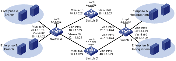

As shown in Figure 1, use RSVP-TE to establish two MPLS TE tunnels between Switch A and Switch D. The MPLS TE tunnel for Enterprise A requires a bandwidth of 20000 kbps. The MPLS TE tunnel for Enterprise B requires a bandwidth of 30000 kbps.
The maximum bandwidth of the link that each tunnel traverses is 50000 kbps and the maximum reservable bandwidth is 40000 kbps.
Figure 1 Network diagram

1.     Configure IP addresses for interfaces:
# Configure IP addresses and masks for interfaces on Switch A, including the loopback interface, as shown in Figure 1.
<SwitchA> system-view
[SwitchA] vlan 10
[SwitchA-vlan10] port ten-gigabitethernet 1/1/1
[SwitchA-vlan10] quit
[SwitchA-Vlan-interface10] ip address 10.1.1.1 24
[SwitchA] vlan 30
[SwitchA-vlan30] port ten-gigabitethernet 1/1/2
[SwitchA-vlan30] quit
[SwitchA] interface vlan-interface 30
[SwitchA-Vlan-interface30] ip address 30.1.1.1 24
[SwitchA-Vlan-interface30] quit
[SwitchA] vlan 70
[SwitchA-vlan70] port ten-gigabitethernet 1/1/3
[SwitchA-vlan70] quit
[SwitchA] interface vlan-interface 70
[SwitchA-Vlan-interface70] ip address 70.1.1.1 24
[SwitchA] vlan 80
[SwitchA-vlan80] port ten-gigabitethernet 1/1/4
[SwitchA-vlan80] quit
[SwitchA] interface vlan-interface 80
[SwitchA-Vlan-interface80] ip address 80.1.1.1 24
[SwitchA] interface loopback 0
[SwitchA-LoopBack0] ip address 1.1.1.1 32
[SwitchA-LoopBack0] quit
# Configure other devices in the same way that Switch A is configured. (Details not shown.)

6.     Configure MPLS TE tunnels on Switch A:
# Configure MPLS TE tunnel interface Tunnel 1 to forward traffic of Enterprise A.
[SwitchA] interface tunnel 1 mode mpls-te
[SwitchA-Tunnel1] ip address 7.1.1.1 255.255.255.0
# Specify the tunnel destination address as the LSR ID of Switch D, use RSVP-TE to establish the tunnel, and assign 20000 kbps bandwidth to the tunnel.
[SwitchA-Tunnel1] destination 4.4.4.4

7.     Configure static routing on Switch A to direct traffic to the MPLS TE tunnels:
# Configure a static route to direct traffic destined for 50.1.1.0/24 to MPLS TE tunnel interface Tunnel 1.
[SwitchA] ip route-static 50.1.1.0 24 tunnel 1 preference 1
# Configure a static route to direct traffic destined for 60.1.1.0/24 to MPLS TE tunnel interface Tunnel 2.
[SwitchA] ip route-static 60.1.1.0 24 tunnel 2 preference 1
# Execute the display interface tunnel command on Switch A. The output shows that the two tunnel interfaces are up.
[SwitchA] display interface tunnel

# Execute the display mpls te tunnel-interface command on Switch A to display detailed information about the MPLS TE tunnels.
[SwitchA] display mpls te tunnel-interface

# Execute the display ip routing-table command on Switch A. The output shows two static route entries with output interfaces of Tunnel 1 and Tunnel 2.
[SwitchA] display ip routing-table

# Execute the display rsvp lsp verbose command on Switch A to verify the following information:
·     Tunnel 1 uses path Switch A—Switch B—Switch D, and has a bandwidth of 20000 kbps.
·     Tunnel 2 uses path Switch A—Switch C—Switch D, and has a bandwidth of 30000 kbps.
[SwitchA] display rsvp lsp verbose

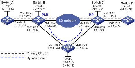

Example: Configuring MPLS TE FRR
Network requirements
As shown in Figure 2, on the primary CRLSP Switch ASwitch B—Switch C—Switch D, configure MPLS TE FRR to protect the link Switch B—Switch C. When the link between Switch B and Switch C fails, MPLS TE can immediately switch traffic to the bypass tunnel Switch B—Switch E—Switch C.
The primary CRLSP and the bypass tunnel each require a bandwidth of 30000 kbps. The maximum bandwidth of the link that each tunnel traverses is 50000 kbps and the maximum reservable bandwidth is 40000 kbps.
Figure 2 Network diagram
Requirements analysis
To implement MPLS TE FRR, you must perform the following tasks:
·     Enable MPLS, MPLS TE, and RSVP-TE on each switch for primary and bypass tunnel establishment.
·     Configure explicit paths for the primary CRLSP and the bypass tunnel as required.
·     Configure BFD for RSVP-TE on Switch B and Switch C for quick detection of the link failure.
BFD can immediately detect the failure of the protected link and notify RSVP-TE of the failure.
·     Configure MPLS TE FRR on the ingress node of the primary CRLSP to ensure that traffic can be immediately switched to the bypass tunnel when BFD detects the failure of the protected link.
Software version used
This configuration example was created and verified on S7500EXS-CMW710-R7178.
When you configure MPLS TE FRR, follow these restrictions and guidelines:
·     Before configuration, disable the spanning tree feature globally or map each VLAN to an MSTI.
·     Only MPLS TE tunnels established through RSVP-TE support FRR.
·      Do not configure both FRR and RSVP authentication on the same interface.
·     Use bypass tunnels to protect only critical interfaces or links when bandwidth is insufficient. Bypass tunnels are pre-established and require extra bandwidth.
·      Make sure the bandwidth assigned to the bypass tunnel is no less than the total bandwidth needed by all primary CRLSPs to be protected by the bypass tunnel. Otherwise, some primary CRLSPs might not be protected by the bypass tunnel.
·      A bypass tunnel typically does not forward data when the primary CRLSP operates correctly. For a bypass tunnel to also forward data during tunnel protection, you must assign enough bandwidth to the bypass tunnel.
·      A bypass tunnel cannot be used for services such as VPN.
·     You cannot configure FRR for a bypass tunnel. A bypass tunnel cannot act as a primary CRLSP.
·     Make sure the protected node or interface is not on the bypass tunnel.

6.     Configure an MPLS TE tunnel on Switch A (the ingress node of the primary CRLSP):
# Configure an explicit path named pri-path for the primary CRLSP.
[SwitchA] explicit-path pri-path
[SwitchA-explicit-path-pri-path] nexthop 2.1.1.2
[SwitchA-explicit-path-pri-path] nexthop 3.1.1.3
[SwitchA-explicit-path-pri-path] nexthop 4.1.1.4
[SwitchA-explicit-path-pri-path] nexthop 4.4.4.4
[SwitchA-explicit-path-pri-path] quit
# Configure MPLS TE tunnel interface Tunnel 4 for the primary CRLSP.
[SwitchA] interface tunnel4 mode mpls-te
[SwitchA-Tunnel4] ip address 10.1.1.1 255.255.255.0
# Specify the tunnel destination address as the LSR ID of Switch D, configure MPLS TE to use RSVP-TE to establish the tunnel, and assign 30000 kbps bandwidth to the tunnel.
[SwitchA-Tunnel4] destination 4.4.4.4
[SwitchA-Tunnel4] mpls te signaling rsvp-te
[SwitchA-Tunnel4] mpls te bandwidth 30000
# Specify the explicit path to be used as pri-path.
[SwitchA-Tunnel4] mpls te path preference 1 explicit-path pri-path
# Enable FRR for the MPLS TE tunnel.
[SwitchA-Tunnel4] mpls te fast-reroute
[SwitchA-Tunnel4] quit
# Execute the display interface tunnel command on Switch A. The output shows that tunnel interface Tunnel 4 is up.
Tunnel4
Current state: UP
Line protocol state: UP
Description: Tunnel4 Interface
Bandwidth: 64kbps
Maximum Transmit Unit: 64000
Internet Address is 10.1.1.1/24 Primary
Tunnel source unknown, destination 4.4.4.4
Tunnel TTL 255
Tunnel protocol/transport CR_LSP
Last clearing of counters: Never
Last 300 seconds input rate: 0 bytes/sec, 0 bits/sec, 0 packets/sec
Last 300 seconds output rate: 0 bytes/sec, 0 bits/sec, 0 packets/sec
Input: 0 packets, 0 bytes, 0 drops
Output: 0 packets, 0 bytes, 0 drops
# Execute the display mpls te tunnel-interface command on Switch A to display detailed information about the MPLS TE tunnel.
Tunnel Name            : Tunnel 4
Tunnel State           : Up (Main CRLSP up, Shared-resource CRLSP down)
Tunnel Attributes      :
  LSP ID               : 37325           Tunnel ID            : 4
  Admin State          : Normal
  Ingress LSR ID       : 1.1.1.1         Egress LSR ID        : 4.4.4.4
  Signaling            : RSVP-TE         Static CRLSP Name    : -
  Resv Style           : SE
  Tunnel mode          : -
  Reverse-LSP name     : -
  Reverse-LSP LSR ID   : -               Reverse-LSP Tunnel ID: -
  Class Type           : CT0             Tunnel Bandwidth     : 30000 kbps
  Reserved Bandwidth   : 30000 kbps
  Setup Priority       : 7               Holding Priority     : 7
  Affinity Attr/Mask   : 0/0
  Explicit Path        : pri-path
  Backup Explicit Path : -
  Metric Type          : TE
  Record Route         : Enabled         Record Label         : Enabled
  FRR Flag             : Enabled         Bandwidth Protection : Disabled
  Backup Bandwidth Flag: Disabled        Backup Bandwidth Type: -
  Backup Bandwidth     : -
  Bypass Tunnel        : No              Auto Created         : No
  Route Pinning        : Disabled
  Retry Limit          : 3               Retry Interval       : 2 sec
  Reoptimization       : Disabled        Reoptimization Freq  : -
  Backup Type          : None            Backup LSP ID        : -
  Auto Bandwidth       : Disabled        Auto Bandwidth Freq  : -
  Min Bandwidth        : -               Max Bandwidth        : -
  Collected Bandwidth  : -
7.     Configure a bypass tunnel on Switch B (the PLR):
# Configure an explicit path named by-path for the bypass tunnel.
[SwitchB] explicit-path by-path
[SwitchB-explicit-path-by-path] nexthop 3.2.1.5
[SwitchB-explicit-path-by-path] nexthop 3.3.1.3
[SwitchB-explicit-path-by-path] nexthop 3.3.3.3
[SwitchB-explicit-path-by-path] quit
# Configure MPLS TE tunnel interface Tunnel 5 for the bypass tunnel.
[SwitchB] interface tunnel 5 mode mpls-te
[SwitchB-Tunnel5] ip address 11.1.1.1 255.255.255.0
# Specify the tunnel destination address as the LSR ID of Switch C and configure MPLS TE to use RSVP-TE to establish the tunnel.
[SwitchB-Tunnel5] destination 3.3.3.3
[SwitchB-Tunnel5] mpls te signaling rsvp-te
# Set the bandwidth that the bypass tunnel can protect to 30000 kbps.
[SwitchB-Tunnel5] mpls te backup bandwidth 30000
# Specify the explicit path to be used as by-path.
[SwitchB-Tunnel5] mpls te path preference 1 explicit-path by-path
[SwitchB-Tunnel5] quit
# Bind the bypass tunnel to the protected interface.
[SwitchB] interface vlan-interface 3
[SwitchB-Vlan-interface3] mpls te fast-reroute bypass-tunnel tunnel 5
[SwitchB-Vlan-interface3] quit
# Execute the display interface tunnel command on Switch B. The output shows that tunnel interface Tunnel 5 is up.
[SwitchB] display interface tunnel
Tunnel5
Current state: UP
Line protocol state: DOWN
Description: Tunnel5 Interface
Bandwidth: 64kbps
Internet Address is 11.1.1.1/24 Primary
Tunnel source unknown, destination 3.3.3.3
Tunnel TTL 255
8.     Configure a static route on Switch A to direct traffic destined for 4.1.1.0/24 to MPLS TE tunnel interface Tunnel 4.
[SwitchA] ip route-static 4.1.1.0 24 tunnel 4 preference 1
# Execute the display mpls lsp command on each switch. The output shows the LSP entries. Switch B has two CRLSPs. The bypass tunnel backs up the primary CRLSP.
[SwitchA] display mpls lsp
FEC                         Proto    In/Out Label    Interface/Out NHLFE
1.1.1.1/4/37325             RSVP     -/1150          Vlan2
2.1.1.2                     Local    -/-             Vlan2
Tunnel4                     Local    -/-             NHLFE1026
[SwitchB] display mpls lsp
1.1.1.1/4/37325             RSVP     1150/1147       Vlan3
Backup                               1150/1147       Tun5
2.2.2.2/5/18928             RSVP     -/1149          Vlan5
3.1.1.3                     Local    -/-             Vlan3
3.2.1.5                     Local    -/-             Vlan5
Tunnel5                     Local    -/-             NHLFE1027
[SwitchC] display mpls lsp
1.1.1.1/4/37325             RSVP     1147/3          Vlan4
2.2.2.2/5/18928             RSVP     3/-             -
4.1.1.4                     Local    -/-             Vlan4
# Shut down the protected interface VLAN-interface 3 on the PLR (Switch B).
[SwitchB-Vlan-interface3] shutdown
# Execute the display interface tunnel 4 command on Switch A to display information about the primary CRLSP. The output shows that the tunnel interface is still up.
[SwitchA] display interface tunnel 4
Tunnel4
Current state: UP
Bandwidth: 64kbps
Tunnel TTL 255
# Execute the display mpls te tunnel-interface command on Switch A to display detailed information about the tunnel interface.
Tunnel State           : Up (Main CRLSP up, Shared-resource CRLSP being set up)
Tunnel Attributes      :
  Resv Style           : SE
  Tunnel mode          : -
  Metric Type          : TE
# Execute the display mpls lsp command on Switch B. The output shows that the bypass tunnel is in use.
1.1.1.1/4/37325             RSVP     1150/1147       Tun5
# On the PLR, configure the interval for selecting an optimal bypass tunnel as 5 seconds.
[SwitchB] mpls te
[SwitchB-te] fast-reroute timer 5
[SwitchB-te] quit
# On the PLR, bring up the protected interface VLAN-interface 3.
[SwitchB-Vlan-interface3] undo shutdown
# Execute the display interface tunnel 4 command on Switch A to display information about the primary CRLSP. The output shows that the tunnel interface is in up state.
Tunnel4
Current state: UP
Bandwidth: 64kbps
Tunnel TTL 255
# Wait for about 5 seconds, execute the display mpls lsp verbose command on Switch B. The output shows that Tunnel 5 is bound to interface VLAN-interface 3 but is not in use.
[SwitchB] display mpls lsp verbose
Destination  : 4.4.4.4
FEC          : 1.1.1.1/4/53319
Protocol     : RSVP
LSR Type     : Transit
Service      : -
In-Label     : 1150
Path ID      : 0x540000003.1
State        : Active
Out-Label    : 1150
Nexthop      : 3.1.1.3
Out-Interface: Vlan3
BkLabel      : 1150
BkInterface  : Tun5
Destination  : 3.3.3.3
FEC          : 2.2.2.2/5/16429
Protocol     : RSVP
LSR Type     : Ingress
Service      : -
NHLFE ID     : 1025
State        : Active
Out-Label    : 1151
Nexthop      : 3.2.1.5
Out-Interface: Vlan5
Destination  : 3.1.1.3
FEC          : 3.1.1.3
Protocol     : Local
LSR Type     : Ingress
Service      : -
NHLFE ID     : 1027
State        : Active
Nexthop      : 3.1.1.3
Destination  : 3.2.1.5
FEC          : 3.2.1.5
Protocol     : Local
LSR Type     : Ingress
Service      : -
NHLFE ID     : 1024

Configuration files
·     Switch A:
ospf 1
 area 0.0.0.0
  network 1.1.1.1 0.0.0.0
  network 2.1.1.0 0.0.0.255
  mpls te enable
 mpls lsr-id 1.1.1.1
vlan 2
mpls te
 nexthop index 1 2.1.1.2 include strict
 nexthop index 101 3.1.1.3 include strict
 nexthop index 201 4.1.1.4 include strict
 nexthop index 301 4.4.4.4 include strict
rsvp
interface LoopBack0
 ip address 1.1.1.1 255.255.255.255
interface Vlan-interface2
 ip address 2.1.1.1 255.255.255.0
 mpls enable
 mpls te enable
 mpls te max-link-bandwidth 50000
 mpls te max-reservable-bandwidth 40000
 rsvp enable
interface Ten-GigabitEthernet1/1/1
 port link-mode bridge
 port access vlan 2
interface Tunnel4 mode mpls-te
 mpls te bandwidth ct0 30000
 destination 4.4.4.4
ip route-static 4.1.1.0 24 Tunnel4 preference 1
·     Switch B:
ospf 1
 area 0.0.0.0
  network 2.2.2.2 0.0.0.0
  network 3.1.1.0 0.0.0.255
  network 3.2.1.0 0.0.0.255
  mpls te enable
 mpls lsr-id 2.2.2.2
vlan 2 to 3
vlan 5
mpls te
 nexthop index 1 3.2.1.5 include strict
 nexthop index 101 3.3.1.3 include strict
 nexthop index 201 3.3.3.3 include strict
rsvp
interface LoopBack0
 ip address 2.2.2.2 255.255.255.255
 ip address 2.1.1.2 255.255.255.0
 mpls enable
 mpls te enable
 rsvp enable
interface Vlan-interface3
 ip address 3.1.1.2 255.255.255.0
 mpls enable
 mpls te enable
 mpls te fast-reroute bypass-tunnel Tunnel5
 rsvp enable
 rsvp bfd enable
interface Vlan-interface5
 ip address 3.2.1.2 255.255.255.0
 mpls enable
 mpls te enable
 rsvp enable
 port access vlan 2
interface Ten-GigabitEthernet1/1/2
 port access vlan 3
interface Ten-GigabitEthernet1/1/3
 port access vlan 5
interface Tunnel5 mode mpls-te
 mpls te backup bandwidth ct0 30000
 destination 3.3.3.3
·     Switch C:
ospf 1
 area 0.0.0.0
  network 3.3.1.0 0.0.0.255
  network 3.3.3.3 0.0.0.0
  network 4.1.1.0 0.0.0.255
  mpls te enable
 mpls lsr-id 3.3.3.3
vlan 3 to 4
vlan 6
mpls te
rsvp
interface LoopBack0
 ip address 3.3.3.3 255.255.255.255
 ip address 3.1.1.3 255.255.255.0
 mpls enable
 mpls te enable
 rsvp enable
 rsvp bfd enable
interface Vlan-interface4
 ip address 4.1.1.3 255.255.255.0
 mpls enable
 mpls te enable
 rsvp enable
interface Vlan-interface6
 ip address 3.3.1.3 255.255.255.0
 mpls enable
 mpls te enable
 rsvp enable
 port access vlan 4
 port access vlan 3
 port access vlan 6
·     Switch D:
ospf 1
 area 0.0.0.0
  network 4.4.4.4 0.0.0.0
  mpls te enable
 mpls lsr-id 4.4.4.4
vlan 4
mpls te
rsvp
interface LoopBack0
 ip address 4.4.4.4 255.255.255.255
 ip address 4.1.1.4 255.255.255.0
 mpls enable
 mpls te enable
 rsvp enable
 port access vlan 4
·     Switch E:
ospf 1
 area 0.0.0.0
  network 5.5.5.5 0.0.0.0
  mpls te enable
 mpls lsr-id 5.5.5.5
vlan 5 to 6
mpls te
rsvp
interface LoopBack0
 ip address 5.5.5.5 255.255.255.255
 ip address 3.2.1.5 255.255.255.0
 mpls enable
 mpls te enable
 rsvp enable
 ip address 3.3.1.5 255.255.255.0
 mpls enable
 mpls te enable
 rsvp enable
 port access vlan 5
 port access vlan 6
