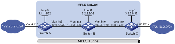

Example: Configuring static LSPs
Network requirements
As shown in Figure 1, establish static LSPs between Switch A and Switch C to allow communication between subnets 172.20.2.0/24 and 172.16.2.0/24 over the MPLS network.
Figure 1 Network diagram
Requirements analysis
To meet the network requirements, you must perform the following tasks:
·     LSPs are unidirectional. To ensure that data can be bidirectionally forwarded, configure an LSP for each direction of the data forwarding path, and specify the ingress, transit, and egress nodes for each LSP.
·     To direct traffic to an LSP for MPLS forwarding, make sure the ingress node has a route to the FEC destination of the LSP. This example uses a static route. Route configuration is not needed on the transit and egress nodes.

1.     Configure IP addresses and masks for interfaces, including the loopback interfaces, as shown in Figure 1. (Details not shown.)
2.     Configure a static route to the destination address of each LSP:
# Configure a static route to the FEC destination of the LSP from Switch A to Switch C.
<SwitchA> system-view
[SwitchA] ip route-static 172.16.2.1 24 10.0.3.2
# Configure a static route to the FEC destination of the LSP from Switch C to Switch A.
<SwitchC> system-view
[SwitchC] ip route-static 172.20.2.1 24 10.0.6.1
# Verify that the static route has been created on the ingress nodes, for example, on Switch A.

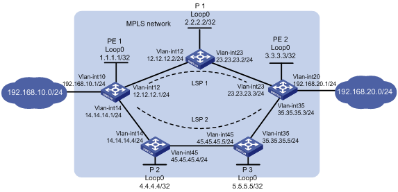

Example: Configuring LDP LSPs
As shown in Figure 2, two paths are available for PE 1 and PE 2 to communicate with each other.
·     Configure LDP to establish LSPs between PE 1 and PE 2 to allow communication between subnets 192.168.10.0/24 and 192.168.20.0/24 over the MPLS network.
¡     Use LSP 1 as the primary path.
¡     Use LSP 2 as the backup path, which takes over LSP 1 when LSP 1 fails.
·     Configure LDP to establish LSPs only for destinations 1.1.1.1/32, 2.2.2.2/32, 3.3.3.3/32, 4.4.4.4/32, 5.5.5.5/32, 192.168.10.0/24, and 192.168.20.0/24.
Figure 2 Network diagram
·     To establish LDP LSPs, configure a routing protocol to ensure IP connectivity among the devices. This example uses OSPF.
·     To use LSP 1 as the primary path and LSP 2 as the backup, configure the routes for LSP 1 and LSP 2 as the primary and backup routes, respectively. This example uses OSPF. The OSPF cost of the route for LSP 1 is smaller than that for LSP 2. Therefore, LSP 1 is used when it is available.
·     To control LSP establishment, configure LSP generation policies on each LSR.

[P3-ospf-1] quit
# Configure PE 2.
[PE2] ospf
[PE2-ospf-1] area 0
[PE2-ospf-1-area-0.0.0.0] network 3.3.3.3 0.0.0.0
[PE2-ospf-1-area-0.0.0.0] network 23.23.23.0 0.0.0.255
[PE2-ospf-1-area-0.0.0.0] network 35.35.35.0 0.0.0.255
[PE2-ospf-1-area-0.0.0.0] network 192.168.20.0 0.0.0.255
[PE2-ospf-1-area-0.0.0.0] quit
[PE2-ospf-1] quit
# On each switch, for example, on PE 1, verify that the switches have learned the routes to each other.
[PE1] display ospf routing
OSPF Process 1 with Router ID 1.1.1.1
                   Routing Table
 Routing for network
 Destination        Cost     Type    NextHop         AdvRouter       Area
 45.45.45.0/24      2        Transit 14.14.14.4      5.5.5.5         0.0.0.0
 35.35.35.0/24      3        Transit 14.14.14.4      5.5.5.5         0.0.0.0
 35.35.35.0/24      3        Transit 12.12.12.2      5.5.5.5         0.0.0.0
 192.168.10.0/24    1        Stub    192.168.10.1    1.1.1.1         0.0.0.0
 5.5.5.5/32         2        Stub    14.14.14.4      5.5.5.5         0.0.0.0
 14.14.14.0/24      1        Transit 14.14.14.1      4.4.4.4         0.0.0.0
 23.23.23.0/24      2        Transit 12.12.12.2      3.3.3.3         0.0.0.0
 4.4.4.4/32         1        Stub    14.14.14.4      4.4.4.4         0.0.0.0
 3.3.3.3/32         2        Stub    12.12.12.2      3.3.3.3         0.0.0.0
 12.12.12.0/24      1        Transit 12.12.12.1      2.2.2.2         0.0.0.0
 2.2.2.2/32         1        Stub    12.12.12.2      2.2.2.2         0.0.0.0
 1.1.1.1/32         0        Stub    1.1.1.1         1.1.1.1         0.0.0.0
 192.168.20.0/24    3        Stub    12.12.12.2      3.3.3.3         0.0.0.0
# On each switch, for example, on PE 1, verify that OSPF neighbor relationships in Full state have been established between PE 1, P devices, and PE 2.
[PE1] display ospf peer verbose
                  Neighbors
 Area 0.0.0.0 interface 14.14.14.1(Vlan-interface14)'s neighbors
 Router ID: 4.4.4.4          Address: 14.14.14.4       GR state: Normal
   State: Full  Mode: Nbr is master  Priority: 1
   DR: 14.14.14.4  BDR: 14.14.14.1  MTU: 0
   Options is 0x42 (-|O|-|-|-|-|E|-)
   Dead timer due in 40  sec
   Neighbor is up for 00:03:30
   Authentication Sequence: [ 0 ]
   Neighbor state change count: 6
   BFD status: Disabled
                  Neighbors
 Area 0.0.0.0 interface 12.12.12.1(Vlan-interface12)'s neighbors
 Router ID: 2.2.2.2          Address: 12.12.12.2       GR state: Normal
   DR: 12.12.12.2  BDR: 12.12.12.1  MTU: 0
   Dead timer due in 36  sec
   Neighbor is up for 00:03:24
 Last Neighbor Down Event:
 Router ID: 4.4.4.4
 Local Address: 14.14.14.1
 Remote Address: 14.14.14.4
 Time: May 14 09:07:19 2014
 Reason: Reset ospf command was performed
3.     Configure basic MPLS and MPLS LDP:
# Configure PE 1.
[PE1] mpls lsr-id 1.1.1.1
[PE1] mpls ldp
[PE1-ldp] quit
[PE1] interface vlan-interface 12
[PE1-Vlan-interface12] mpls enable
[PE1-Vlan-interface12] mpls ldp enable
[PE1-Vlan-interface12] quit
[PE1] interface vlan-interface 14
[PE1-Vlan-interface14] mpls enable
[PE1-Vlan-interface14] mpls ldp enable
[PE1-Vlan-interface14] quit
# Configure P 1.
[P1] mpls lsr-id 2.2.2.2
[P1] mpls ldp
[P1-ldp] quit
[P1] interface vlan-interface 12
[P1-Vlan-interface12] mpls enable
[P1-Vlan-interface12] mpls ldp enable
[P1-Vlan-interface12] quit
[P1] interface vlan-interface 23
[P1-Vlan-interface23] mpls enable
[P1-Vlan-interface23] mpls ldp enable
[P1-Vlan-interface23] quit
# Configure P 2.
[P2] mpls lsr-id 4.4.4.4
[P2] mpls ldp
[P2-ldp] quit
[P2] interface vlan-interface 14
[P2-Vlan-interface14] mpls enable
[P2-Vlan-interface14] mpls ldp enable
[P2-Vlan-interface14] quit
[P2] interface vlan-interface 45
[P2-Vlan-interface45] mpls enable
[P2-Vlan-interface45] mpls ldp enable
[P2-Vlan-interface45] quit
# Configure P 3.
[P3] mpls lsr-id 5.5.5.5
[P3] mpls ldp
[P3-ldp] quit
[P3] interface vlan-interface 45
[P3-Vlan-interface45] mpls enable
[P3-Vlan-interface45] mpls ldp enable
[P3-Vlan-interface45] quit
[P3] interface vlan-interface 35
[P3-Vlan-interface35] mpls enable
[P3-Vlan-interface35] mpls ldp enable
[P3-Vlan-interface35] quit
# Configure PE 2.
[PE2] mpls lsr-id 3.3.3.3
[PE2] mpls ldp
[PE2-ldp] quit
[PE2] interface vlan-interface 23
[PE2-Vlan-interface23] mpls enable
[PE2-Vlan-interface23] mpls ldp enable
[PE2-Vlan-interface23] quit
[PE2] interface vlan-interface 35
[PE2-Vlan-interface35] mpls enable
[PE2-Vlan-interface35] mpls ldp enable
[PE2-Vlan-interface35] quit
# On each switch, for example, on PE 1, verify that LDP sessions in Operational state have been established between PE 1, P devices, and PE 2.
[PE1 display mpls ldp peer
Total number of peers: 2
Peer LDP ID             State         Role     GR   MD5  KA Sent/Rcvd
2.2.2.2:0               Operational   Passive  Off  Off  55/55
4.4.4.4:0               Operational   Passive  Off  Off  6/6
4.     Configure LSP generation policies:
# On PE 1, create IP prefix list PE1, and configure LDP to use only the routes permitted by the prefix list to establish LSPs.
[PE1] ip prefix-list PE1 index 10 permit 1.1.1.1 32
[PE1] ip prefix-list PE1 index 20 permit 2.2.2.2 32
[PE1] ip prefix-list PE1 index 30 permit 3.3.3.3 32
[PE1] ip prefix-list PE1 index 40 permit 4.4.4.4 32
[PE1] ip prefix-list PE1 index 50 permit 5.5.5.5 32
[PE1] ip prefix-list PE1 index 60 permit 192.168.10.0 24
[PE1] ip prefix-list PE1 index 70 permit 192.168.20.0 24
[PE1] mpls ldp
[PE1-ldp] lsp-trigger prefix-list PE1
[PE1-ldp] quit
# On P 1, create IP prefix list P1, and configure LDP to use only the routes permitted by the prefix list to establish LSPs.
[P1] ip prefix-list P1 index 10 permit 1.1.1.1 32
[P1] ip prefix-list P1 index 20 permit 2.2.2.2 32
[P1] ip prefix-list P1 index 30 permit 3.3.3.3 32
[P1] ip prefix-list P1 index 40 permit 4.4.4.4 32
[P1] ip prefix-list P1 index 50 permit 5.5.5.5 32
[P1] ip prefix-list P1 index 60 permit 192.168.10.0 24
[P1] ip prefix-list P1 index 70 permit 192.168.20.0 24
[P1] mpls ldp
[P1-ldp] lsp-trigger prefix-list P1
[P1-ldp] quit
# On P 2, create IP prefix list P2, and configure LDP to use only the routes permitted by the prefix list to establish LSPs.
[P2] ip prefix-list P2 index 10 permit 1.1.1.1 32
[P2] ip prefix-list P2 index 20 permit 2.2.2.2 32
[P2] ip prefix-list P2 index 30 permit 3.3.3.3 32
[P2] ip prefix-list P2 index 40 permit 4.4.4.4 32
[P2] ip prefix-list P2 index 50 permit 5.5.5.5 32
[P2] ip prefix-list P2 index 60 permit 192.168.10.0 24
[P2] ip prefix-list P2 index 70 permit 192.168.20.0 24
[P2] mpls ldp
[P2-ldp] lsp-trigger prefix-list P2
[P2-ldp] quit
# On P 3, create IP prefix list P3, and configure LDP to use only the routes permitted by the prefix list to establish LSPs.
[P3] ip prefix-list P3 index 10 permit 1.1.1.1 32
[P3] ip prefix-list P3 index 20 permit 2.2.2.2 32
[P3] ip prefix-list P3 index 30 permit 3.3.3.3 32
[P3] ip prefix-list P3 index 40 permit 4.4.4.4 32
[P3] ip prefix-list P3 index 50 permit 5.5.5.5 32
[P3] ip prefix-list P3 index 60 permit 192.168.10.0 24
[P3] ip prefix-list P3 index 70 permit 192.168.20.0 24
[P3] mpls ldp
[P3-ldp] lsp-trigger prefix-list P3
[P3-ldp] quit
# On PE 2, create IP prefix list PE2, and configure LDP to use only the routes permitted by the prefix list to establish LSPs.
[PE2] ip prefix-list PE2 index 10 permit 1.1.1.1 32
[PE2] ip prefix-list PE2 index 20 permit 2.2.2.2 32
[PE2] ip prefix-list PE2 index 30 permit 3.3.3.3 32
[PE2] ip prefix-list PE2 index 40 permit 4.4.4.4 32
[PE2] ip prefix-list PE2 index 50 permit 5.5.5.5 32
[PE2] ip prefix-list PE2 index 60 permit 192.168.10.0 24
[PE2] ip prefix-list PE2 index 70 permit 192.168.20.0 24
[PE2] mpls ldp
[PE2-ldp] lsp-trigger prefix-list PE2
[PE2-ldp] quit
# Display LDP LSP information on PE 1. The output shows that the next hop is P 1 for the LSP associated with FEC 192.168.20.0/24.
[PE1] display mpls ldp lsp
Status Flags: * - stale, L - liberal
Statistics:
  FECs: 7      Ingress LSPs: 5     Transit LSPs: 5     Egress LSPs: 2
FEC                In/Out Label    Nexthop         OutInterface
1.1.1.1/32         3/-
                   -/1151(L)
                   -/1151(L)
2.2.2.2/32         -/3             12.12.12.2      Vlan12
                   1151/3          12.12.12.2      Vlan12
                   -/1150(L)
3.3.3.3/32         -/1150          12.12.12.2      Vlan12
                   1150/1150       12.12.12.2      Vlan12
                   -/1148(L)
4.4.4.4/32         -/1149(L)
                   -/3             14.14.14.4      Vlan14
                   1149/3          14.14.14.4      Vlan14
5.5.5.5/32         -/1148(L)
                   -/1149          14.14.14.4      Vlan14
                   1148/1149       14.14.14.4      Vlan14
192.168.10.0/24    1147/-
192.168.20.0/24    -/1147          12.12.12.2      Vlan12
                   1146/1147       12.12.12.2      Vlan12
                   -/1147(L)
# Power down P 1 and execute the display mpls ldp lsp command on PE 1. The output shows that the next hop becomes P 2 for the LSP associated with FEC 192.168.20.0/24.
Statistics:
1.1.1.1/32         3/-
                   -/1150(L)
2.2.2.2/32         -/1149          14.14.14.4      Vlan14
                   1150/1149       14.14.14.4      Vlan14
3.3.3.3/32         -/1148          14.14.14.4      Vlan14
                   1147/1148       14.14.14.4      Vlan14
4.4.4.4/32         -/3             14.14.14.4      Vlan14
5.5.5.5/32         -/1151          14.14.14.4      Vlan14
                   1148/1151       14.14.14.4      Vlan14
192.168.10.0/24    1151/-
                   -/1146(L)
192.168.20.0/24    -/1147          14.14.14.4      Vlan14
                   1146/1147       14.14.14.4      Vlan14
# Use the following command on PE 1 to verify its connectivity to PE 2.
[PE1] ping mpls -a 192.168.10.1 ipv4 192.168.20.0 24
MPLS ping FEC 192.168.20.0/24 with 100 bytes of data:
100 bytes from 23.23.23.3: Sequence=1 time=2 ms
100 bytes from 23.23.23.3: Sequence=2 time=2 ms
100 bytes from 23.23.23.3: Sequence=3 time=2 ms
100 bytes from 23.23.23.3: Sequence=4 time=2 ms
100 bytes from 23.23.23.3: Sequence=5 time=2 ms
--- Ping statistics for FEC 192.168.20.0/24 ---
5 packets transmitted, 5 packets received, 0.0% packet loss
Round-trip min/avg/max = 2/2/2 ms

·     PE 2:
ospf 1
 area 0.0.0.0
 mpls lsr-id 3.3.3.3
vlan 20
vlan 23
vlan 35
mpls ldp
interface LoopBack0
 ip address 3.3.3.3 255.255.255.255
interface Vlan-interface20
 ip address 192.168.20.1 255.255.255.0
interface Vlan-interface23
 ip address 23.23.23.3 255.255.255.0
 mpls enable
 mpls ldp enable
interface Vlan-interface35
 ip address 5.35.35.3 255.255.255.0
mpls enable
 mpls ldp enable
