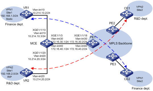

As shown in Figure 1, an enterprise has two MPLS L3VPNs. VPN 1 for the finance department uses static routes, and VPN 2 for the R&D department uses RIP routes. Site 1 of VPN 1 and Site 1 of VPN 2 are connected to the MPLS backbone through the same CE device (MCE). Site 2 of VPN 1 and Site 2 of VPN 2 are connected to the MPLS backbone through separate CEs (CE 1 and CE 2).
Configure the MCE to allow communication between the local and remote sites of the same VPN and isolate access between sites of different VPNs.
Configure the MCE and PE 1 to use OSPF to exchange VPN routes.
Figure 1 Network diagram

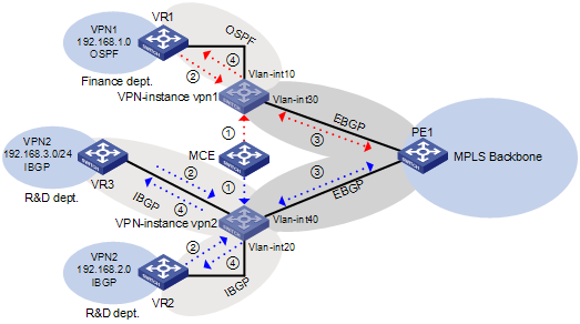

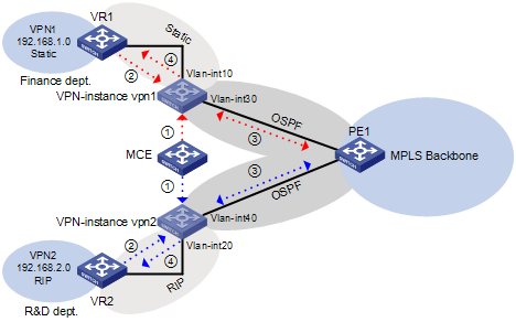

Requirements analysis
To meet the network requirements, you must perform the following tasks:
1.     Create VPN instances on the MCE and PE 1, and bind each VPN instance to the interfaces that need to forward data for that VPN instance.
2.     Redistribute the VPN routes to the routing table of the corresponding VPN instance.
3.     Advertise the VPN routes to PE 1 through OSPF, and receive remote VPN routes from PE 1.
4.     Redistribute the remote VPN routes to the local VPN sites.

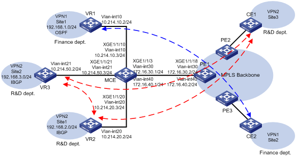

Figure 2 Network diagram

[PE1-ospf-20-area-0.0.0.0] quit
[PE1-ospf-20] quit
# Verify that PE 1 has learned the static route of VPN 1 through OSPF.
[PE1] display ip routing-table vpn-instance vpn1
Destinations : 14        Routes : 14
Destination/Mask   Proto   Pre Cost        NextHop         Interface
0.0.0.0/32         Direct  0   0           127.0.0.1       InLoop0
100.100.11.1/32    Direct  0   0           127.0.0.1       InLoop0
127.0.0.0/8        Direct  0   0           127.0.0.1       InLoop0
127.0.0.0/32       Direct  0   0           127.0.0.1       InLoop0
127.0.0.1/32       Direct  0   0           127.0.0.1       InLoop0
127.255.255.255/32 Direct  0   0           127.0.0.1       InLoop0
172.16.30.0/24     Direct  0   0           172.16.30.2     Vlan30
172.16.30.0/32     Direct  0   0           172.16.30.2     Vlan30
172.16.30.2/32     Direct  0   0           127.0.0.1       InLoop0
172.16.30.255/32   Direct  0   0           172.16.30.2     Vlan30
192.168.1.0/24     O_ASE2  150 1           172.16.30.1     Vlan30
224.0.0.0/4        Direct  0   0           0.0.0.0         NULL0
224.0.0.0/24       Direct  0   0           0.0.0.0         NULL0
255.255.255.255/32 Direct  0   0           127.0.0.1       InLoop0
# Verify that PE 1 has learned the RIP route of VPN 2 through OSPF.
<PE1> display ip routing-table vpn-instance vpn2
100.100.21.1/32    Direct  0   0           127.0.0.1       InLoop0
172.16.40.0/24     Direct  0   0           172.16.40.2     Vlan40
172.16.40.0/32     Direct  0   0           172.16.40.2     Vlan40
172.16.40.2/32     Direct  0   0           127.0.0.1       InLoop0
172.16.40.255/32   Direct  0   0           172.16.40.2     Vlan40
192.168.2.0/24     O_ASE2  150 1           172.16.40.1     Vlan40

Example: Configuring the MCE to advertise VPN routes to the PE by using BGP
Network requirements
As shown in Figure 3, an enterprise has two MPLS L3VPNs. VPN 1 for the finance department uses OSPF, and VPN 2 for the R&D department uses IBGP. Site 1 of VPN 1, Site 2 of VPN 2, and Site 1 of VPN 2 are connected to the MPLS backbone through the same CE device (MCE). Site 3 of VPN 2 and Site 2 of VPN 1 are connected to the MPLS backbone through separate CEs (CE 1 and CE 2).
Configure the MCE and PE 1 to use BGP to exchange VPN routes.
Figure 3 Network diagram
IBGP requires a fully meshed network or a router reflector. In this example, you must configure the MCE as the IBGP route reflector.
3.     Advertise the VPN routes to PE 1 through EBGP, and receive remote VPN routes from PE 1.
Figure 4 Network diagram

               s - suppressed, S - stale, i - internal, e - external
               Origin: i - IGP, e - EGP, ? - incomplete
 Route distinguisher: 20:1(vpn2)
 Total number of routes: 6
     Network            NextHop         MED        LocPrf     PrefVal Path/Ogn
* >  10.214.20.0/24     10.214.20.3     0                     32768   i
*  i                    10.214.20.2     0          100        0       i
* >  10.214.50.0/24     10.214.50.3     0                     32768   i
*  i                    10.214.50.2     0          100        0       i
* >i 192.168.2.0        10.214.20.2     0          100        0       i
* >i 192.168.3.0        10.214.50.2     0          100        0       i
The output shows that the MCE has learned BGP routes to the sites of VPN 2.
3.     Configure routing between the MCE and PE 1:
# On the MCE, create the BGP-VPN instance vpn1, and specify 172.16.30.2 (PE 1) as the EBGP peer in AS 200.
[MCE] bgp 100
[MCE-bgp] ip vpn-instance vpn1
[MCE-bgp-vpn1] peer 172.16.30.2 as-number 200
# Redistribute OSPF routes for BGP-VPN instance vpn1, and advertise network 172.16.30.0/24.
[MCE-bgp-vpn1] address-family ipv4
[MCE-bgp-ipv4-vpn1] import-route ospf
[MCE-bgp-ipv4-vpn1] peer 172.16.30.2 enable
[MCE-bgp-ipv4-vpn1] network 172.16.30.0 24
[MCE-bgp-ipv4-vpn1] quit
[MCE-bgp-vpn1] quit
# On PE 1, enter the view of the BGP-VPN instance vpn1, specify 172.16.30.1 (the MCE) as the EBGP peer in AS 100, and advertise network 172.16.30.0/24.
[PE1] bgp 200
[PE1-bgp] ip vpn-instance vpn1
[PE1-bgp-vpn1] peer 172.16.30.1 as-number 100
[PE1-bgp-vpn1] address-family ipv4
[PE1-bgp-ipv4-vpn1] peer 172.16.30.1 enable
[PE1-bgp-ipv4-vpn1] network 172.16.30.0 24
[PE1-bgp-ipv4-vpn1] quit
[PE1-bgp-vpn1] quit
# On the MCE, enter the view of the BGP-VPN instance vpn2, specify 172.16.40.2 (PE 1) as the EBGP peer in AS 200, and advertise network 172.16.40.0/24.
[MCE-bgp] ip vpn-instance vpn2
[MCE-bgp-vpn2] peer 172.16.40.2 as-number 200
[MCE-bgp-vpn2] address-family ipv4
[MCE-bgp-ipv4-vpn2] peer 172.16.40.2 enable
[MCE-bgp-ipv4-vpn2] network 172.16.40.0 24
[MCE-bgp-ipv4-vpn2] quit
[MCE-bgp-vpn2] quit
[MCE-bgp] quit
# On PE 1, enter the view of the BGP-VPN instance vpn2, specify 172.16.40.1 (the MCE) as the EBGP peer in AS 100, and advertise network 172.16.40.0/24.
[PE1-bgp] ip vpn-instance vpn2
[PE1-bgp-vpn2] peer 172.16.40.1 as-number 100
[PE1-bgp-vpn2] address-family ipv4
[PE1-bgp-ipv4-vpn2] peer 172.16.40.1 enable
[PE1-bgp-ipv4-vpn2] network 172.16.40.0 24
[PE1-bgp-ipv4-vpn2] quit
[PE1-bgp-vpn2] quit
[PE1-bgp] quit
