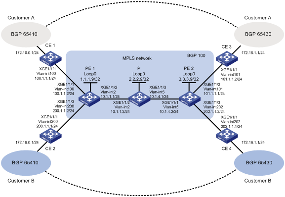

Network requirements
As shown in Figure 1, configure MPLS L3VPN to allow communication between different sites of a customer and to isolate different customers.
Figure 1 Network diagram
Requirements analysis
To generate inner labels, and deliver VPN routing information to the remote PE, configure MP-BGP peers between PEs.
To generate outer labels to tunnel the VPN packets over the MPLS backbone, configure a routing protocol and MPLS LDP on the MPLS backbone.
To identify routing information for different customers on PEs, perform the following tasks on each PE:
·     Create a VPN instance for each customer.
·     Configure an RD and route targets for each VPN instance.
·     Redistribute internal routes of each site to the corresponding VPN instance.

1.     Configure OSPF on the MPLS backbone to ensure IP connectivity within the backbone:

3.     Configure VPN instances on PEs to allow CE access:

# Configure IP addresses for interfaces on the CEs, as shown in Figure 1. (Details not shown.)

4.     Establish EBGP peer relationships between PEs and CEs, and redistribute VPN routes into BGP:
# On PE 1, create BGP process 100.
[PE1] bgp 100
# On PE 1, specify CE 1 as a peer and redistribute direct routes of PE 1 into the BGP routing table of VPN instance customerA.
[PE1-bgp] ip vpn-instance customerA
[PE1-bgp-customerA] peer 100.1.1.1 as-number 65410
[PE1-bgp-customerA] address-family ipv4 unicast
[PE1-bgp-ipv4-customerA] peer 100.1.1.1 enable
[PE1-bgp-ipv4-customerA] import-route direct
[PE1-bgp-ipv4-customerA] quit
[PE1-bgp-customerA] quit
# On PE 1, specify CE 2 as a peer and redistribute direct routes of PE 1 into the BGP routing table of VPN instance customerB.
[PE1-bgp] ip vpn-instance customerB
[PE1-bgp-customerB] peer 200.1.1.1 as-number 65410
[PE1-bgp-customerB] address-family ipv4 unicast
[PE1-bgp-ipv4-customerB] peer 200.1.1.1 enable
[PE1-bgp-ipv4-customerB] import-route direct
[PE1-bgp-ipv4-customerB] quit
[PE1-bgp-customerB] quit
[PE1-bgp] quit
# On PE 2, create BGP process 100.
[PE2] bgp 100
# On PE 2, specify CE 3 as a peer and redistribute direct routes of PE 2 into the BGP routing table of VPN instance customerA.
[PE2-bgp] ip vpn-instance customerA
[PE2-bgp-customerA] peer 101.1.1.2 as-number 65430
[PE2-bgp-customerA] address-family ipv4 unicast
[PE2-bgp-ipv4-customerA] peer 101.1.1.2 enable
[PE2-bgp-ipv4-customerA] import-route direct
[PE2-bgp-ipv4-customerA] quit
[PE2-bgp-customerA] quit
# On PE 2, specify CE 4 as a peer and redistribute direct routes of PE 2 into the BGP routing table of VPN instance customerB.
[PE2-bgp] ip vpn-instance customerB
[PE2-bgp-customerB] peer 202.1.1.1 as-number 65430
[PE2-bgp-customerB] address-family ipv4 unicast
[PE2-bgp-ipv4-customerB] peer 202.1.1.1 enable
[PE2-bgp-ipv4-customerB] import-route direct
[PE2-bgp-ipv4-customerB] quit
[PE2-bgp-customerB] quit
[PE2-bgp] quit
# On CE 1, create BGP process 65410, specify 100.1.1.2 as the peer, and specify the peer's AS number as 100.
<CE1> system-view
[CE1] bgp 65410
[CE1-bgp] peer 100.1.1.2 as-number 100
# On CE 1, enable BGP to exchange IPv4 unicast routing information with peer 100.1.1.2.
[CE1-bgp] address-family ipv4 unicast
[CE1-bgp-ipv4] peer 100.1.1.2 enable
# On CE 1, redistribute the direct route for the site into EBGP.
[CE1-bgp-ipv4] import-route direct
[CE1-bgp-ipv4] quit
[CE1-bgp] quit
# On CE 2, create BGP process 65410, specify 200.1.1.2 as the peer, and specify the peer's AS number as 100.
<CE2> system-view
[CE2] bgp 65410
[CE2-bgp] peer 200.1.1.2 as-number 100
# On CE 2, enable BGP to exchange IPv4 unicast routing information with peer 200.1.1.2.
[CE2-bgp] address-family ipv4 unicast
[CE2-bgp-ipv4] peer 200.1.1.2 enable
# On CE 2, redistribute the direct route for the site into EBGP.
[CE2-bgp-ipv4] import-route direct
[CE2-bgp-ipv4] quit
[CE2-bgp] quit
# On CE 3, create BGP process 65430, specify 101.1.1.1 as the peer, and specify the peer's AS number as 100.
<CE3> system-view
[CE3] bgp 65430
[CE3-bgp] peer 101.1.1.1 as-number 100
# On CE 3, enable BGP to exchange IPv4 unicast routing information with peer 101.1.1.1.
[CE3-bgp] address-family ipv4 unicast
[CE3-bgp-ipv4] peer 101.1.1.1 enable
# On CE 3, redistribute the direct route for the site into EBGP.
[CE3-bgp-ipv4] import-route direct
[CE3-bgp-ipv4] quit
[CE3-bgp] quit
# On CE 4, create BGP process 65430, specify 202.1.1.2 as the peer, and specify the peer's AS number as 100.
<CE4> system-view
[CE4] bgp 65430
[CE4-bgp] peer 202.1.1.2 as-number 100
# On CE 4, enable BGP to exchange IPv4 unicast routing information with peer 202.1.1.2.
[CE4-bgp] address-family ipv4 unicast
[CE4-bgp-ipv4] peer 202.1.1.2 enable
# On CE 4, redistribute the direct route for the site into EBGP.
[CE4-bgp-ipv4] import-route direct
[CE4-bgp-ipv4] quit
[CE4-bgp] quit
# Verify that a BGP peer relationship in Established state has been established between a PE and a CE.
[PE1] display bgp peer ipv4 vpn-instance customerA
 BGP local router ID: 1.1.1.9
 Local AS number: 100
 Total number of peers: 1                  Peers in established state: 1
  * - Dynamically created peer
  Peer                    AS  MsgRcvd  MsgSent OutQ PrefRcv Up/Down  State
  100.1.1.1             65410        4        4    0       2 13:35:25 Established
5.     Create an MP-IBGP peer relationship between PEs:
# On PE 1, configure 3.3.3.9 as the BGP peer and specify Loopback 0 as the source interface for sending routing updates to the peer.
[PE1] bgp 100
[PE1-bgp] peer 3.3.3.9 as-number 100
[PE1-bgp] peer 3.3.3.9 connect-interface loopback 0
# On PE 1, enable the peer 3.3.3.9 for the BGP-VPNv4 address family.
[PE1-bgp] address-family vpnv4
[PE1-bgp-vpnv4] peer 3.3.3.9 enable
[PE1-bgp-vpnv4] quit
[PE1-bgp] quit
# On PE 2, configure 1.1.1.9 as the BGP peer and specify Loopback 0 as the source interface for sending routing updates to the peer.
[PE2] bgp 100
[PE2-bgp] peer 1.1.1.9 as-number 100
[PE2-bgp] peer 1.1.1.9 connect-interface loopback 0
# On PE 2, enable the peer 1.1.1.9 for the BGP-VPNv4 address family.
[PE2-bgp] address-family vpnv4
[PE2-bgp-vpnv4] peer 1.1.1.9 enable
[PE2-bgp-vpnv4] quit
[PE2-bgp] quit
# Verify that a BGP peer relationship in Established state has been established between the PEs.
[PE1] display bgp peer vpnv4
  3.3.3.9                100        8        8    0       0 00:00:08 Established
# Execute the display ip routing-table vpn-instance command on the PEs.
[PE1] display ip routing-table vpn-instance customerA
Destinations : 13        Routes : 13
0.0.0.0/32          Direct 0    0            127.0.0.1       InLoop0
100.1.1.0/24        Direct 0    0            100.1.1.2       Vlan100
100.1.1.0/32        Direct 0    0            100.1.1.2       Vlan100
100.1.1.2/32        Direct 0    0            127.0.0.1       InLoop0
100.1.1.255/32      Direct 0    0            100.1.1.2       Vlan100
101.1.1.0/24        BGP    255  0            3.3.3.9         Vlan2
127.0.0.0/8         Direct 0    0            127.0.0.1       InLoop0
127.0.0.0/32        Direct 0    0            127.0.0.1       InLoop0
127.0.0.1/32        Direct 0    0            127.0.0.1       InLoop0
127.255.255.255/32  Direct 0    0            127.0.0.1       InLoop0
224.0.0.0/4         Direct 0    0            0.0.0.0         NULL0
224.0.0.0/24        Direct 0    0            0.0.0.0         NULL0
255.255.255.255/32  Direct 0    0            127.0.0.1       InLoop0
The output shows that PE 1 has a route to the remote CE of Customer A. Output on PE 2 is similar.
