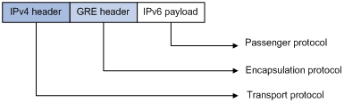

For example, to transfer an IPv6 packet over an IPv4 network through a GRE tunnel, the system encapsulates the IPv6 packet in the format shown in Figure 2. The passenger protocol is IPv6, the encapsulation protocol is GRE, and the transport protocol is IPv4.
Figure 2 Format of a GRE-encapsulated packet
The switch supports GRE over IPv4 tunnels. In GRE over IPv4 tunnel mode, the transport protocol is IPv4, and the passenger protocol is any network layer protocol.

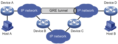

Figure 3 X protocol networks interconnected through a GRE tunnel
The following uses the network shown in Figure 3 to describe how an X protocol packet traverses the IP network through a GRE tunnel.
Encapsulation process
1.     After receiving an X protocol packet through the interface connected to Group 1, Device A submits it to the X protocol for processing.
2.     The X protocol checks the destination address field in the packet header to determine how to route the packet.
3.     If the packet must be tunneled to reach its destination, Device A sends it to the tunnel interface.
4.     Upon receipt of the packet, the tunnel interface encapsulates it in a GRE packet. Then, the system encapsulates the packet in an IP packet and forwards the IP packet based on its destination address and the routing table.

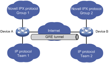

Multi-protocol communications through a single-protocol backbone
Figure 4 Multi-protocol communications through a single-protocol backbone
In the example shown in Figure 4, Group 1 and Group 2 are local networks running Novell IPX, and Team 1 and Team 2 are local networks running IP. Through the GRE tunnel between Device A and Device B, Group 1 can communicate with Group 2 and Team 1 can communicate with Team 2. They will not interfere with each other.

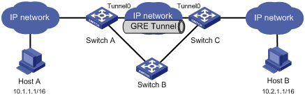

Scope enlargement of a hop-limited protocol such as RIP
Figure 5 Network scope enlargement
When the hop count between two terminals exceeds 15, the terminals cannot communicate with each other. Using GRE, you can hide some hops so as to enlarge the scope of the network.

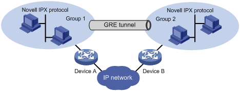

VPN creation by connecting discontinuous subnets
Figure 6 Connect discontinuous subnets with a tunnel to form a VPN
In the example as shown in Figure 6, Group 1 and Group 2 running Novell IPX are deployed in different cities. They can constitute a trans-WAN virtual private network (VPN) through the tunnel.

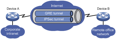

GRE-IPsec tunnel application
Figure 7 GRE-IPsec tunnel application
GRE can work with IPsec, allowing data packets like routing protocol, voice, and video packets to be encapsulated by GRE and then encrypted by IPsec to improve security of data transmission in a tunnel.

Troubleshooting GRE
The key to configuring GRE is to keep the configurations consistent. This section analyzes one type of fault for illustration, with the scenario shown in Figure 10.
Figure 10 Network diagram
Symptom
The interfaces at both ends of the tunnel are configured correctly and can ping each other, but Host A and Host B cannot ping each other.
Solution
·     On Switch A and Switch C, execute the display ip routing-table command in any view. On Switch A, observe whether there is a route from Switch A through Tunnel 0 to 10.2.0.0/16. On Switch C, observe whether there is a route from Switch C through Tunnel 0 to 10.1.0.0/16.
·     If an expected static route is missing, use the ip route-static command in system view to configure. For example, configure a static route on Switch A as follows:
[SwitchA] ip route-static 10.2.0.0 255.255.0.0 tunnel 0
