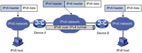

IPv6 over IPv4 tunneling adds an IPv4 header to IPv6 data packets so that IPv6 packets can pass an IPv4 network through a tunnel to realize interworking between isolated IPv6 networks, as shown in Figure 1. The IPv6 over IPv4 tunnel can be established between two hosts, a host and a device, or two devices. The tunnel destination node can forward IPv6 packets if it is not the destination of the IPv6 packets.
The devices at both ends of an IPv6 over IPv4 tunnel must support the IPv4/IPv6 dual stack.
Figure 1 IPv6 over IPv4 tunnel
The IPv6 over IPv4 tunnel processes packets in the following way:
1.     A host in the IPv6 network sends an IPv6 packet to Device A at the tunnel source.
2.     After determining from the routing table that the packet must be forwarded through the tunnel, Device A encapsulates the IPv6 packet with an IPv4 header and forwards it through the physical interface of the tunnel.
3.     The encapsulated packet goes through the tunnel to reach Device B at the tunnel destination. Device B checks that it is the destination address of the encapsulated packet and de-encapsulates the packet.
4.     Device B forwards the packet according to the destination address in the de-encapsulated IPv6 packet. If the destination address is the device itself, Device B forwards the IPv6 packet to the upper-layer protocol for processing.

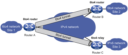

A 6to4 tunnel is only used to connect 6to4 networks, whose IP prefix must be 2002::/16. However, IPv6 network addresses with the prefix such as 2001::/16 can also be used in IPv6 networks. To connect a 6to4 network to an IPv6 network, a 6to4 router must be used as a gateway to forward packets to the IPv6 network. Such a router is called 6to4 relay router.
As shown in Figure 2, a static route must be configured on the border router in the 6to4 network and the next-hop address must be the 6to4 address of the 6to4 relay router. All packets destined for the IPv6 network are forwarded to the 6to4 relay router, and then to the IPv6 network. This provides interworking between the 6to4 network (with the address prefix starting with 2002) and the IPv6 network.
Figure 2 Principle of 6to4 tunnel and 6to4 relay

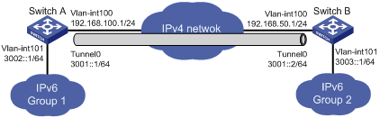

Network requirements
As shown in Figure 4, configure an IPv6 manual tunnel between Switch A and Switch B to make the two IPv6 networks reachable to each other. If the IPv4 addresses cannot be extracted from the IPv6 packets, you must manually configure an IPv6 tunnel.
Figure 4 Network diagram
Configuration procedure
Make sure Switch A and Switch B have corresponding VLAN interfaces created and can reach each other.
·     Configure Switch A:
# Enable IPv6.
<SwitchA> system-view
[SwitchA] ipv6
# Configure an IPv4 address for VLAN-interface 100.
[SwitchA-Vlan-interface100] ip address 192.168.100.1 255.255.255.0
# Configure an IPv6 address for VLAN-interface 101.
[SwitchA] interface vlan-interface 101
[SwitchA-Vlan-interface101] ipv6 address 3002::1 64
[SwitchA-Vlan-interface101] quit
# Configure a manual IPv6 tunnel.
[SwitchA] interface tunnel 0
[SwitchA-Tunnel0] ipv6 address 3001::1/64
[SwitchA-Tunnel0] source vlan-interface 100
[SwitchA-Tunnel0] destination 192.168.50.1
[SwitchA-Tunnel0] tunnel-protocol ipv6-ipv4
[SwitchA-Tunnel0] quit
# Configure a static route to IPv6 Group 2 through tunnel 0 on Switch A.
[SwitchA] ipv6 route-static 3003:: 64 tunnel 0
·     Configure Switch B:
# Enable IPv6.
<SwitchB> system-view
[SwitchB] ipv6
[SwitchB-Vlan-interface100] ip address 192.168.50.1 255.255.255.0
[SwitchB] interface vlan-interface 101
[SwitchB-Vlan-interface101] ipv6 address 3003::1 64
[SwitchB-Vlan-interface101] quit
# Configure an IPv6 manual tunnel.
[SwitchB] interface tunnel 0
[SwitchB-Tunnel0] ipv6 address 3001::2/64
[SwitchB-Tunnel0] source vlan-interface 100
[SwitchB-Tunnel0] destination 192.168.100.1
[SwitchB-Tunnel0] tunnel-protocol ipv6-ipv4
[SwitchB-Tunnel0] quit
# Configure a static route to IPv6 Group 1 through tunnel 0 on Switch B.
[SwitchB] ipv6 route-static 3002:: 64 tunnel 0
# Display the status of the tunnel interfaces on Switch A and Switch B.
[SwitchA] display ipv6 interface tunnel 0
Tunnel0 current state :UP
Line protocol current state :UP
IPv6 is enabled, link-local address is FE80::C0A8:6401
  Global unicast address(es):
    3001::1, subnet is 3001::/64
  Joined group address(es):
    FF02::1:FF00:0
    FF02::1:FF00:1
    FF02::1:FFA8:6401
    FF02::2
    FF02::1
  MTU is 1480 bytes
  ND reachable time is 30000 milliseconds
  ND retransmit interval is 1000 milliseconds

Configuration example
IMPORTANT:
By default, Ethernet, VLAN, and aggregate interfaces are down. To configure such an interface, bring the interface up by executing the undo shutdown command.

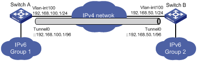

As shown in Figure 5, two IPv6 networks are connected to an IPv4 network through dual-stack switches Switch A and Switch B. Configure an automatic IPv4-compatible IPv6 tunnel between Switch A and Switch B to make the two IPv6 networks reachable to each other.
Figure 5 Network diagram
Make sure Switch A and Switch B have the corresponding VLAN interfaces created and can reach each other.
    ::192.168.100.1, subnet is ::/96
    FF02::1:FFA8:6401
    FF02::1:FF00:0
    FF02::2
    FF02::1
  MTU is 1480 bytes
  Hosts use stateless autoconfig for addresses
IPv6 Packet statistics:
  InReceives:                    65
[SwitchB] display ipv6 interface tunnel 0
IPv6 is enabled, link-local address is FE80::C0A8:3201
    ::192.168.50.1, subnet is ::/96
    FF02::1:FFA8:3201
    FF02::1:FF00:0
    FF02::2
    FF02::1
  MTU is 1480 bytes
  InReceives:                    65
# Verify that Switch A can ping the IPv4-compatible IPv6 address at the peer end.
[SwitchA] ping ipv6 ::192.168.50.1
  PING ::192.168.50.1 : 56  data bytes, press CTRL_C to break
    Reply from ::192.168.50.1
    bytes=56 Sequence=1 hop limit=64  time = 1 ms
    bytes=56 Sequence=2 hop limit=64  time = 1 ms
    bytes=56 Sequence=3 hop limit=64  time = 1 ms
    bytes=56 Sequence=4 hop limit=64  time = 1 ms
    bytes=56 Sequence=5 hop limit=64  time = 1 ms
  --- ::192.168.50.1 ping statistics ---
    5 packet(s) transmitted
    5 packet(s) received
    0.00% packet loss
    round-trip min/avg/max = 1/1/1 ms

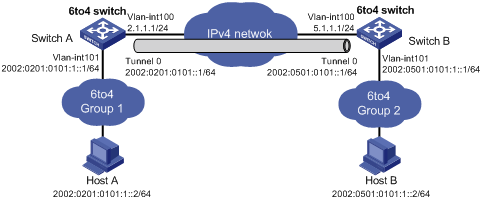

6to4 tunnel configuration example
IMPORTANT:
As shown in Figure 6, configure a 6to4 tunnel to make Host A and Host B reachable to each other.
Figure 6 Network diagram
Requirements analysis
To enable communication between 6to4 networks, you must configure 6to4 addresses for 6to4 switches and hosts in the 6to4 networks.
·     The IPv4 address of VLAN-interface 100 on Switch A is 2.1.1.1/24, and the corresponding 6to4 prefix is 2002:0201:0101::/48 after it is translated to an IPv6 address. Assign interface tunnel 0 to subnet 2002:0201:0101::/64 and VLAN-interface 101 to subnet 2002:0201:0101:1::/64.
·     The IPv4 address of VLAN-interface 100 on Switch B is 5.1.1.1/24, and the corresponding 6to4 prefix is 2002:0501:0101::/48 after it is translated to an IPv6 address. Assign interface tunnel 0 to subnet 2002:0501:0101::/64 and VLAN-interface 101 to subnet 2002:0501:0101:1::/64.

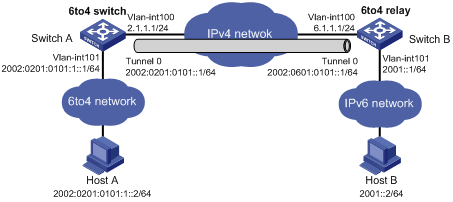

6to4 relay tunnel configuration example
IMPORTANT:
As shown in Figure 7, Switch A is a 6to4 switch, and 6to4 addresses are used on its IPv6 network. Switch B acts as a 6to4 relay switch and is connected to the IPv6 network (2001::/16). Configure a 6to4 tunnel between Switch A and Switch B to make Host A and Host B reachable to each other.
Figure 7 Network diagram
Configuration on a 6to4 relay switch is similar to that on a 6to4 switch. However, to enable communication between the 6to4 network and the IPv6 network, you must configure a route to the IPv6 network on the 6to4 switch.

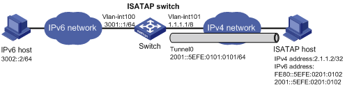

IMPORTANT:
As shown in Figure 8, configure an ISATAP tunnel between the switch and the ISATAP host so the ISATAP host in the IPv4 network can access the IPv6 network.
Figure 8 Network diagram
Make sure the corresponding VLAN interfaces have been created on the switch.
Make sure VLAN-interface 101 on the ISATAP switch and the ISATAP host can reach each other.
·     Configure the switch:
# Enable IPv6.
<Switch> system-view
[Switch] ipv6
# Configure addresses for interfaces.
[Switch-Vlan-interface100] ipv6 address 3001::1/64
[Switch] interface vlan-interface 101
[Switch-Vlan-interface101] ip address 1.1.1.1 255.0.0.0
[Switch-Vlan-interface101] quit
# Configure an ISATAP tunnel.
[Switch] interface tunnel 0
[Switch-Tunnel0] ipv6 address 2001::5efe:0101:0101 64
[Switch-Tunnel0] source vlan-interface 101
[Switch-Tunnel0] tunnel-protocol ipv6-ipv4 isatap
# Disable the RA suppression so that hosts can acquire information such as the address prefix from the RA message released by the ISATAP switch.
[Switch-Tunnel0] undo ipv6 nd ra halt
[Switch-Tunnel0] quit
# Configure a static route to the ISATAP host.
[Switch] ipv6 route-static 2001:: 16 tunnel 0
·     Configure the ISATAP host:
Configurations on the ISATAP host vary by operating system. The following example is performed on Windows XP:
# Install IPv6.
C:\>ipv6 install
# On a host running Windows XP, the ISATAP interface is typically interface 2. Configure the IPv4 address of the ISATAP switch on the interface to complete the configuration on the host. Before doing that, display the ISATAP interface information.
C:\>ipv6 if 2
Interface 2: Automatic Tunneling Pseudo-Interface
  Guid {48FCE3FC-EC30-E50E-F1A7-71172AEEE3AE}
  does not use Neighbor Discovery
  does not use Router Discovery
  routing preference 1
  EUI-64 embedded IPv4 address: 0.0.0.0
  router link-layer address: 0.0.0.0
    preferred link-local fe80::5efe:2.1.1.2, life infinite
  link MTU 1280 (true link MTU 65515)
  current hop limit 128
  reachable time 42500ms (base 30000ms)
  retransmission interval 1000ms
  DAD transmits 0
  default site prefix length 48
# A link-local address (fe80::5efe:2.1.1.2) in the ISATAP format was automatically generated for the ISATAP interface. Configure the IPv4 address of the ISATAP switch on the ISATAP interface.
C:\>ipv6 rlu 2 1.1.1.1
# Display information about the ISATAP interface.
C:\>ipv6 if 2
  uses Router Discovery
  EUI-64 embedded IPv4 address: 2.1.1.2
  router link-layer address: 1.1.1.1
    preferred global 2001::5efe:2.1.1.2, life 29d23h59m46s/6d23h59m46s (public)
  link MTU 1500 (true link MTU 65515)
  current hop limit 255
  DAD transmits 0
# Comparison shows that the host acquires the address prefix 2001::/64 and automatically generates the address 2001::5efe:2.1.1.2. Meanwhile, "uses Router Discovery" is displayed, indicating that the router discovery function is enabled on the host. Ping the IPv6 address of the tunnel interface of the switch. If the address is successfully pinged, an ISATAP tunnel is established.
C:\>ping 2001::5efe:1.1.1.1
Pinging 2001::5efe:1.1.1.1 with 32 bytes of data:
Reply from 2001::5efe:1.1.1.1: time=1ms
Reply from 2001::5efe:2.1.1.1: time=1ms
Ping statistics for 2001::5efe:1.1.1.1:
# Verify that the ISATAP host can access the host on the IPv6 network.
