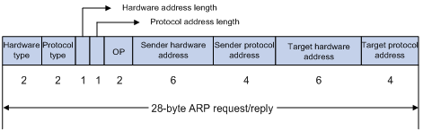

ARP message format
ARP messages are classified into ARP requests and ARP replies. Figure 1 shows the format of the ARP request/reply. Numbers in the figure refer to field lengths.
Figure 1 ARP message format
An ARP message contains the following fields:
·     Hardware typeThe hardware address type. The value 1 represents Ethernet.
·     Protocol typeThe type of the protocol address to be mapped. The hexadecimal value 0x0800 represents IP.
·     Hardware address length and protocol address lengthLength, in bytes, of a hardware address and a protocol address. For an Ethernet address, the value of the hardware address length field is 6. For an IPv4 address, the value of the protocol address length field is 4.
·     OPOperation code. The type of ARP message. The value 1 represents an ARP request and 2 represents an ARP reply.
·     Sender hardware addressHardware address of the switch sending the message.
·     Sender protocol addressProtocol address of the switch sending the message.
·     Target hardware addressHardware address of the switch the message is being sent to.
·     Target protocol addressProtocol address of the switch the message is being sent to.

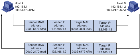

ARP address resolution process
If Host A and Host B are on the same subnet and Host A sends a packet to Host B:
1.     Host A looks in its ARP table to see whether there is an ARP entry for Host B. If yes, Host A uses the MAC address in the entry to encapsulate the IP packet into a data link layer frame and sends the frame to Host B.
2.     If Host A finds no entry for Host B, Host A buffers the packet and broadcasts an ARP request using the following information:
¡     Sender IP address and sender MAC address—Host A's IP address and MAC address
¡     Target IP address—Host B's IP address
¡     Target MAC addressAn all-zero MAC address
Because the ARP request is broadcast, all hosts on this subnet can receive the request, but only the requested host (Host B) will process the request.
3.     Host B compares its own IP address with the target IP address in the ARP request. If they are the same, Host B:
a.     Adds the sender IP address and sender MAC address to its ARP table.
b.     Encapsulates its MAC address into an ARP reply.
c.     Unicasts the reply to Host A.
4.     After receiving the ARP reply, Host A:
a.     Adds the MAC address of Host B to its ARP table.
b.     Encapsulates the MAC address into the packet and sends it to Host B.

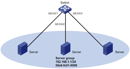

Network requirements
As shown in Figure 3, hosts are connected to Switch, which is connected to Router through interface GigabitEthernet 3/0/1 belonging to VLAN 10. The IP address of Router is 192.168.1.1/24. The MAC address of Router is 00e0-fc01-0000.
To enhance communication security for Router and Switch, static ARP entries are configured on Switch.
Figure 3 Network diagram
Configuration procedure
# Create VLAN 10.
<Switch> system-view
[Switch] vlan 10
[Switch-vlan10] quit
# Add interface GigabitEthernet 3/0/1 to VLAN 10.
[Switch] interface GigabitEthernet 3/0/1
[Switch- GigabitEthernet3/0/1] port access vlan 10
[Switch- GigabitEthernet3/0/1] quit
# Create interface VLAN-interface 10 and configure its IP address.
[Switch] interface vlan-interface 10
[Switch-vlan-interface10] ip address 192.168.1.2 24
[Switch-vlan-interface10] quit
# Configure a static ARP entry that has IP address 192.168.1.1, MAC address 00e0-fc01-0000, and output interface GigabitEthernet 3/0/1 in VLAN 10.

Multiport ARP entry configuration example
As shown in Figure 4, the switch connects to the server group (with three servers) through interfaces GigabitEthernet 3/0/1, GigabitEthernet 3/0/2, and GigabitEthernet 3/0/3 in VLAN 10. The server group shares the IP address 192.168.1.1/24 and MAC address 00e0-fc01-0000.
Configure a multiport ARP entry to send IP packets with destination IP address 192.168.1.1 to the three servers.
Figure 4 Network diagram
# Create VLAN 10.
[Switch] vlan 10
# Add interfaces GigabitEthernet 3/0/1, GigabitEthernet 3/0/2, and GigabitEthernet 3/0/3 to VLAN 10.
[Switch-GigabitEthernet3/0/1] port access vlan 10
[Switch-GigabitEthernet3/0/1] quit
[Switch] interface GigabitEthernet 3/0/2
[Switch-GigabitEthernet3/0/2] port access vlan 10
[Switch-GigabitEthernet3/0/2] quit
[Switch] interface GigabitEthernet 3/0/3
[Switch-GigabitEthernet3/0/3] port access vlan 10
[Switch-GigabitEthernet3/0/3] quit
# Create interface VLAN-interface 10 and specify its IP address.
# Configure a multiport unicast MAC address entry that has MAC address 00e0-fc01-0000, and output ports GigabitEthernet 3/0/1, GigabitEthernet 3/0/2, and GigabitEthernet 3/0/3 in VLAN 10.
[Switch] mac-address multiport 00e0-fc01-0000 interface GigabitEthernet 3/0/1 to GigabitEthernet 3/0/3 vlan 10
# Configure a short static ARP entry with IP address 192.168.1.1 and MAC address 00e0-fc01-0000.
[Switch] arp static 192.168.1.1 00e0-fc01-0000
# Display ARP information.
[Switch] display arp
                Type: S-Static    D-Dynamic    A-Authorized    M-Multiport
IP Address       MAC Address     VLAN ID  Interface              Aging Type
192.168.1.1      00e0-fc01-0000  N/A      N/A                    N/A   M

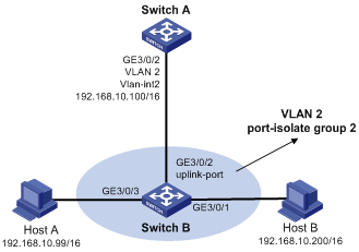

Local proxy ARP configuration example in case of port isolation
As shown in Figure 8, Host A and Host B belong to the same VLAN, and are connected to GigabitEthernet 3/0/3 and GigabitEthernet 3/0/1 of Switch B respectively. Switch B is connected to Switch A through GigabitEthernet 3/0/2. On Switch B, Layer 2 and Layer 3 port isolation are configured on GigabitEthernet 3/0/3 and GigabitEthernet 3/0/1. Enable proxy ARP on Switch A to allow communication between Host A and Host B.
Figure 8 Network diagram
Configuration considerations
In this configuration example, suppose all traffic between the hosts is blocked, so you need to configure local proxy ARP on VLAN-interface 2 of Switch A to enable communication between Host A and Host B. If the two ports (GigabitEthernet 3/0/3 and GigabitEthernet 3/0/1) on Switch B are isolated only at Layer 2, you can enable communication between the two hosts by configuring local proxy ARP directly on VLAN-interface 2 of Switch B.
1.     Configure Switch B:
# Add GigabitEthernet 3/0/3, GigabitEthernet 3/0/1, and GigabitEthernet 3/0/2 to VLAN 2. Host A and Host B are isolated and unable to exchange Layer 2 packets.
<SwitchB> system-view
[SwitchB] port-isolate group 2
[SwitchB] vlan 2
[SwitchB-vlan2] port gigabitethernet 3/0/3
[SwitchB-vlan2] port gigabitethernet 3/0/1
[SwitchB-vlan2] port gigabitethernet 3/0/2
[SwitchB-vlan2] quit
[SwitchB] interface gigabitethernet 3/0/3
[SwitchB-GigabitEthernet3/0/3] port-isolate enable group 2
[SwitchB-GigabitEthernet3/0/3] interface gigabitethernet 3/0/1
[SwitchB-GigabitEthernet3/0/1] port-isolate enable group 2
[SwitchB-GigabitEthernet3/0/1] interface gigabitethernet 3/0/2
[SwitchB-GigabitEthernet3/0/2] port-isolate uplink-port group 2
2.     Configure Switch A:
# Create VLAN 2, and add GigabitEthernet 3/0/2 to VLAN 2.
<SwitchA> system-view
[SwitchA] vlan 2
[SwitchA-vlan2] port gigabitethernet 3/0/2
[SwitchA-vlan2] quit
[SwitchA-Vlan-interface2] ip address 192.168.10.100 255.255.0.0
The ping operation from Host A to Host B is unsuccessful because they are isolated at Layer 2.
# Configure local proxy ARP to let Host A and Host B communicate at Layer 3.
[SwitchA-Vlan-interface2] local-proxy-arp enable
The ping operation from Host A to Host B is successful after the configuration.

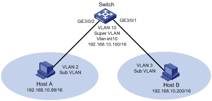

Local proxy ARP configuration example in super VLAN
As shown in Figure 9, a super VLAN, VLAN 10, is created, with the interface IP address being 192.168.10.100/16. Sub VLANs (VLAN 2 and VLAN 3) are created. GigabitEthernet 3/0/2 belongs to VLAN 2 and GigabitEthernet 3/0/1 belongs to VLAN 3.
As Host A and Host B belong to different sub VLANs, they are isolated at Layer 2. Configure local proxy ARP on the switch to implement Layer 3 communication between Host A and Host B.
Figure 9 Network diagram
# Create the super VLAN and the sub VLANs. Add GigabitEthernet 3/0/2 to VLAN 2 and GigabitEthernet 3/0/1 to VLAN 3. Configure the IP address 192.168.10.100/16 for the interface of VLAN 10.
[Switch] vlan 2
[Switch-vlan2] port gigabitethernet 3/0/2
[Switch-vlan2] quit
[Switch] vlan 3
[Switch-vlan3] port gigabitethernet 3/0/1
[Switch-vlan3] quit
[Switch] vlan 10
[Switch-vlan10] supervlan
[Switch-vlan10] subvlan 2 3
[Switch-vlan10] interface vlan-interface 10
[Switch-Vlan-interface10] ip address 192.168.10.100 255.255.0.0
# Configure local proxy ARP to implement Layer 3 communication between sub VLANs.
[Switch-Vlan-interface10] local-proxy-arp enable
