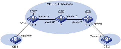

LDP PW configuration example (flexible mode)

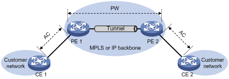

Remote connection model
As shown in Figure 1, this model connects two CEs through a PW on an MPLS or IP backbone.
Figure 1 Remote connection model

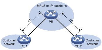

Local connection model
As shown in Figure 2, this model connects two CEs to the same PE so the CEs can communicate through the PE. The switch does not support the local connection model.
Figure 2 Local connection model

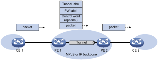

· Port mode—A Layer 3 Ethernet interface is bound to a PW. Packets received from the Layer 3 Ethernet interface are forwarded through the bound PW. The default data encapsulation type for port mode is Ethernet.
Figure 3 Packet encapsulation in port mode
By default, Ethernet, VLAN, and aggregate interfaces are shut down. You must use the undo shutdown command to bring them up. This example assumes that all these interfaces are already up.
Network requirements
Create an LDP PW between PE 1 and PE 2, and use flexible mode to match specific packets from each AC so CE 1 and CE 2 can communicate within VLAN 10 without consuming VLAN resources on PEs.
Figure 4 Network diagram
Device |
Interface |
IP address |
Device |
Interface |
IP address |
CE 1 |
Vlan-int10 |
100.1.1.1/24 |
P |
Loop0 |
192.4.4.4/32 |
PE 1 |
Loop0 |
192.2.2.2/32 |
Vlan-int23 |
23.1.1.2/24 |
Vlan-int23 |
23.1.1.1/24 |
Vlan-int26 |
26.2.2.2/24 |
CE 2 |
Vlan-int10 |
100.1.1.2/24 |
PE 2 |
Loop0 |
192.3.3.3/32 |
Vlan-int26 |
26.2.2.1/24 |
Configuration procedure
