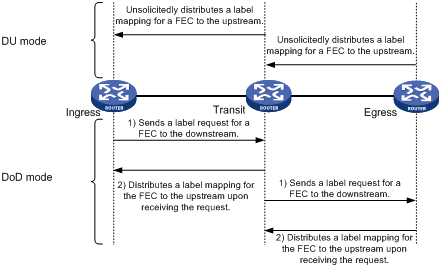

Label advertisement modes
Figure 2 Label advertisement modes

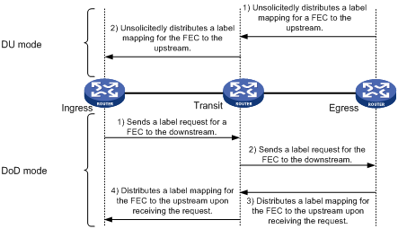

LDP advertises label-FEC mappings in one of the following ways:
·     Downstream Unsolicited (DU) modeDistributes FEC-label mappings to the upstream LSR, without waiting for label requests. The device supports only the DU mode.
·     Downstream on Demand (DoD) modeSends a label request for an FEC to the downstream LSR. After receiving the label request, the downstream LSR distributes the FEC-label mapping for that FEC to the upstream LSR.
A pair of upstream and downstream LSRs must use the same label advertisement mode. Otherwise, the LSP cannot be established.

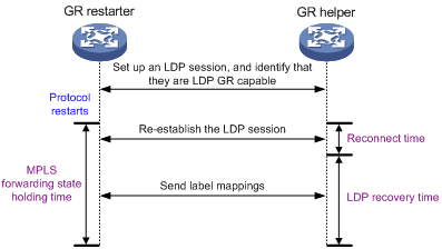

LDP GR
LDP GR overview
LDP Graceful Restart (GR) enables an LSR to retain MPLS forwarding entries during an LDP restart, ensuring continuous MPLS forwarding.
Figure 4 LDP GR
As shown in Figure 4, GR defines the following roles:
·     GR restarterAn LSR that performs GR. It must be GR-capable.
·     GR helperA neighbor LSR that helps the GR restarter to complete GR.
The device can act as a GR restarter or a GR helper.
Figure 5 LDP GR operation
As shown in Figure 5, LDP GR works in the following steps:
1.     LSRs establish an LDP session. The L flag of the Fault Tolerance TLV in their Initialization messages is set to 1 to indicate that they support LDP GR.
2.     When LDP restarts, the GR restarter starts the MPLS Forwarding State Holding timer, and marks the MPLS forwarding entries as stale. When the GR helper detects that the LDP session to the GR restarter goes down, it marks the FEC-label mappings learned from the session as stale and starts the Reconnect timer received from the GR restarter.
3.     After LDP completes restart, the GR restarter re-establishes an LDP session to the GR helper.
¡     If the LDP session is not set up before the Reconnect timer expires, the GR helper deletes the stale FEC-label mappings and the corresponding MPLS forwarding entries.
¡     If the LDP session is successfully set up before the Reconnect timer expires, the GR restarter sends the remaining time of the MPLS Forwarding State Holding timer to the GR helper.
The remaining time is sent as the LDP Recovery time.
4.     After the LDP session is re-established, the GR helper starts the LDP Recovery timer.
5.     The GR restarter and the GR helper exchange label mappings and update their MPLS forwarding tables.
The GR restarter compares each received label mapping against stale MPLS forwarding entries. If a match is found, the restarter deletes the stale mark for the matching entry. Otherwise, it adds a new entry for the label mapping.
The GR helper compares each received label mapping against stale FEC-label mappings. If a match is found, the helper deletes the stale mark for the matching mapping. Otherwise, it adds the received FEC-label mapping and a new MPLS forwarding entry for the mapping.
6.     When the MPLS Forwarding State Holding timer expires, the GR restarter deletes all stale MPLS forwarding entries.
7.     When the LDP Recovery timer expires, the GR helper deletes all stale FEC-label mappings.

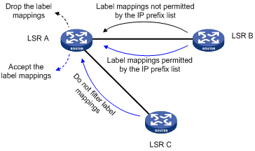

Configuring a label acceptance policy
A label acceptance policy uses an IP prefix list to control the label mappings received from a peer.
As shown in Figure 7, LSR A uses an IP prefix list to filter label mappings from LSR B, and it does not filter label mappings from LSR C.
Figure 7 Label acceptance control diagram
A label advertisement policy on an LSR and a label acceptance policy on its upstream LSR can achieve the same purpose. H3C recommends that you use the label advertisement policy to reduce network load.
You must create an IP prefix list before you configure a label acceptance policy. For information about IP prefix list configuration, see Layer 3—IP Routing Configuration Guide.
To configure a label acceptance policy:
Step
Remarks
N/A
2.     Enter LDP view or enter LDP-VPN instance view.
·     Enter LDP view:
mpls ldp
·     Enter LDP-VPN instance view:
a.     mpls ldp
b.     vpn-instance vpn-instance-name
N/A
3.     Configure a label acceptance policy.
accept-label peer peer-lsr-id prefix-list prefix-list-name
By default, LDP accepts all label mappings.

Configuring LDP GR
Before you configure LDP GR, enable LDP on the GR restarter and GR helpers.
To configure LDP GR:
Step
Remarks
N/A
2.     Enter LDP view.
mpls ldp
N/A
3.     Enable LDP GR.
graceful-restart
By default, LDP GR is disabled.
4.     Set the Reconnect timer for LDP GR.
graceful-restart timer reconnect reconnect-time
By default, the Reconnect time is 120 seconds.
5.     Set the MPLS Forwarding State Holding timer for LDP GR.
graceful-restart timer forwarding-hold hold-time
By default, the MPLS Forwarding State Holding time is 180 seconds.

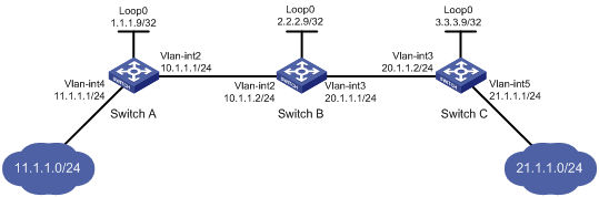

LDP LSP configuration example
Network requirements
Switch A, Switch B, and Switch C all support MPLS.
Configure LDP to establish LSPs between Switch A and Switch C, so subnets 11.1.1.0/24 and 21.1.1.0/24 can reach each other over MPLS.
Configure LDP to establish LSPs only for destinations 1.1.1.9/32, 2.2.2.9/32, 3.3.3.9/32, 11.1.1.0/24, and 21.1.1.0/24 on Switch A, Switch B, and Switch C.
Figure 8 Network diagram
Requirements analysis
·     To ensure that the LSRs establish LSPs automatically, enable LDP on each LSR.
·     To establish LDP LSPs, configure a routing protocol to ensure IP connectivity between the LSRs. This example uses OSPF.
·     To control the number of LSPs, configure an LSP generation policy on each LSR.
Configuration procedure
1.     Configure IP addresses and masks for interfaces, including the loopback interfaces, as shown in Figure 8. (Details not shown.)
2.     Configure OSPF on each switch to ensure IP connectivity between them:
# Configure Switch A.
<SwitchA> system-view
[SwitchA] ospf
[SwitchA-ospf-1] area 0
[SwitchA-ospf-1-area-0.0.0.0] network 1.1.1.9 0.0.0.0
[SwitchA-ospf-1-area-0.0.0.0] network 10.1.1.0 0.0.0.255
[SwitchA-ospf-1-area-0.0.0.0] network 11.1.1.0 0.0.0.255
[SwitchA-ospf-1-area-0.0.0.0] quit
[SwitchA-ospf-1] quit
# Configure Switch B.
<SwitchB> system-view
[SwitchB] ospf
[SwitchB-ospf-1] area 0
[SwitchB-ospf-1-area-0.0.0.0] network 2.2.2.9 0.0.0.0
[SwitchB-ospf-1-area-0.0.0.0] network 10.1.1.0 0.0.0.255
[SwitchB-ospf-1-area-0.0.0.0] network 20.1.1.0 0.0.0.255
[SwitchB-ospf-1-area-0.0.0.0] quit
[SwitchB-ospf-1] quit
# Configure Switch C.
<SwitchC> system-view
[SwitchC] ospf
[SwitchC-ospf-1] area 0
[SwitchC-ospf-1-area-0.0.0.0] network 3.3.3.9 0.0.0.0
[SwitchC-ospf-1-area-0.0.0.0] network 20.1.1.0 0.0.0.255
[SwitchC-ospf-1-area-0.0.0.0] network 21.1.1.0 0.0.0.255
[SwitchC-ospf-1-area-0.0.0.0] quit
[SwitchC-ospf-1] quit
# Verify that the switches have learned the routes to each other. This example uses Switch A.
[SwitchA] display ip routing-table
Destinations : 21        Routes : 21
0.0.0.0/32          Direct 0    0            127.0.0.1       InLoop0
1.1.1.9/32          Direct 0    0            127.0.0.1       InLoop0
2.2.2.9/32          OSPF   10   1            10.1.1.2        Vlan2
3.3.3.9/32          OSPF   10   2            10.1.1.2        Vlan2
10.1.1.0/24         Direct 0    0            10.1.1.1        Vlan2
10.1.1.0/32         Direct 0    0            10.1.1.1        Vlan2
10.1.1.1/32         Direct 0    0            127.0.0.1       InLoop0
10.1.1.255/32       Direct 0    0            10.1.1.1        Vlan2
11.1.1.0/24         Direct 0    0            11.1.1.1        Vlan4
11.1.1.0/32         Direct 0    0            11.1.1.1        Vlan4
11.1.1.1/32         Direct 0    0            127.0.0.1       InLoop0
11.1.1.255/32       Direct 0    0            11.1.1.1        Vlan4
20.1.1.0/24         OSPF   10   2            10.1.1.2        Vlan2
21.1.1.0/24         OSPF   10   3            10.1.1.2        Vlan2
127.0.0.0/8         Direct 0    0            127.0.0.1       InLoop0
127.0.0.0/32        Direct 0    0            127.0.0.1       InLoop0
127.0.0.1/32        Direct 0    0            127.0.0.1       InLoop0
127.255.255.255/32  Direct 0    0            127.0.0.1       InLoop0
224.0.0.0/4         Direct 0    0            0.0.0.0         NULL0
224.0.0.0/24        Direct 0    0            0.0.0.0         NULL0
255.255.255.255/32  Direct 0    0            127.0.0.1       InLoop0
3.     Enable MPLS and LDP:
[SwitchA] mpls lsr-id 1.1.1.9
[SwitchA] mpls ldp
[SwitchA-ldp] quit
[SwitchA-Vlan-interface2] mpls enable
[SwitchA-Vlan-interface2] mpls ldp enable
[SwitchB] mpls lsr-id 2.2.2.9
[SwitchB] mpls ldp
[SwitchB-ldp] quit
[SwitchB-Vlan-interface2] mpls enable
[SwitchB-Vlan-interface2] mpls ldp enable
[SwitchB-Vlan-interface2] quit
[SwitchB] interface vlan-interface 3

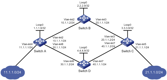

Label acceptance control configuration example
Two links, Switch A—Switch B—Switch C and Switch A—Switch D—Switch C, exist between subnets 11.1.1.0/24 and 21.1.1.0/24.
Configure LDP to establish LSPs only for routes to subnets 11.1.1.0/24 and 21.1.1.0/24.
Configure LDP to establish LSPs only on the link Switch A—Switch B—Switch C to forward traffic between subnets 11.1.1.0/24 and 21.1.1.0/24.
Figure 9 Network diagram
·     To ensure that LDP establishes LSPs only for the routes 11.1.1.0/24 and 21.1.1.0/24, configure LSP generation policies on each LSR.
·     To ensure that LDP establishes LSPs only over the link Switch A—Switch B—Switch C, configure label acceptance policies as follows:
¡     Switch A accepts only the label mapping for FEC 21.1.1.0/24 received from Switch B. Switch A denies the label mapping for FEC 21.1.1.0/24 received from Switch D.
¡     Switch C accepts only the label mapping for FEC 11.1.1.0/24 received from Switch B. Switch C denies the label mapping for FEC 11.1.1.0/24 received from Switch D.

Label advertisement control configuration example
Figure 10 Network diagram
·     To ensure that LDP establishes LSPs only over the link Switch A—Switch B—Switch C, configure label advertisement policies as follows:
¡     Switch A advertises only the label mapping for FEC 11.1.1.0/24 to Switch B.
¡     Switch C advertises only the label mapping for FEC 21.1.1.0/24 to Switch B.
¡     Switch D does not advertise label mapping for FEC 21.1.1.0/24 to Switch A. Switch D does not advertise label mapping for FEC 11.1.1.0/24 to Switch C.

[SwitchA-Vlan-interface6] mpls enable
[SwitchA-Vlan-interface6] mpls ldp enable
[SwitchA-Vlan-interface6] quit
[SwitchB] mpls ldp
[SwitchB-ldp] quit
[SwitchB-Vlan-interface3] mpls enable
[SwitchB-Vlan-interface3] mpls ldp enable
[SwitchB-Vlan-interface3] quit
[SwitchC] mpls lsr-id 3.3.3.9
[SwitchC] mpls ldp
[SwitchC-ldp] quit
[SwitchC] interface vlan-interface 3
[SwitchC-Vlan-interface3] mpls enable
[SwitchC-Vlan-interface3] mpls ldp enable
[SwitchC-Vlan-interface3] quit
[SwitchC] interface vlan-interface 7
[SwitchC-Vlan-interface7] mpls enable
[SwitchC-Vlan-interface7] mpls ldp enable
[SwitchC-Vlan-interface7] quit
# Configure Switch D.
<SwitchD> system-view
[SwitchD] mpls lsr-id 4.4.4.9
[SwitchD] mpls ldp
[SwitchD-ldp] quit
[SwitchD] interface vlan-interface 6
[SwitchD-Vlan-interface6] mpls enable
[SwitchD-Vlan-interface6] mpls ldp enable
[SwitchD-Vlan-interface6] quit
[SwitchD] interface vlan-interface 7
[SwitchD-Vlan-interface7] mpls enable
[SwitchD-Vlan-interface7] mpls ldp enable
[SwitchD-Vlan-interface7] quit
4.     Configure LSP generation policies:
# On Switch A, create IP prefix list switcha, and configure LDP to use only the routes permitted by the prefix list to establish LSPs.
[SwitchA] ip prefix-list switcha index 10 permit 11.1.1.0 24
[SwitchA] ip prefix-list switcha index 20 permit 21.1.1.0 24
[SwitchA] mpls ldp
[SwitchA-ldp] lsp-trigger prefix-list switcha
[SwitchA-ldp] quit
# On Switch B, create IP prefix list switchb, and configure LDP to use only the routes permitted by the prefix list to establish LSPs.
[SwitchB] ip prefix-list switchb index 10 permit 11.1.1.0 24
[SwitchB] ip prefix-list switchb index 20 permit 21.1.1.0 24
[SwitchB] mpls ldp
[SwitchB-ldp] lsp-trigger prefix-list switchb
[SwitchB-ldp] quit
# On Switch C, create IP prefix list switchc, and configure LDP to use only the routes permitted by the prefix list to establish LSPs.
[SwitchC] ip prefix-list switchc index 10 permit 11.1.1.0 24
[SwitchC] ip prefix-list switchc index 20 permit 21.1.1.0 24
[SwitchC] mpls ldp
[SwitchC-ldp] lsp-trigger prefix-list switchc
[SwitchC-ldp] quit
# On Switch D, create IP prefix list switchd, and configure LDP to use only the routes permitted by the prefix list to establish LSPs.
[SwitchD] ip prefix-list switchd index 10 permit 11.1.1.0 24
[SwitchD] ip prefix-list switchd index 20 permit 21.1.1.0 24
[SwitchD] mpls ldp
[SwitchD-ldp] lsp-trigger prefix-list switchd
[SwitchD-ldp] quit
5.     Configure label advertisement policies:
# On Switch A, create an IP prefix list prefix-to-b that permits subnet 11.1.1.0/24. Switch A uses this list to filter FEC-label mappings advertised to Switch B.
[SwitchA] ip prefix-list prefix-to-b index 10 permit 11.1.1.0 24
# On Switch A, create an IP prefix list peer-b that permits 2.2.2.9/32. Switch A uses this list to filter peers.
[SwitchA] ip prefix-list peer-b index 10 permit 2.2.2.9 32
# On Switch A, configure a label advertisement policy to advertise only the label mapping for FEC 11.1.1.0/24 to Switch B.
[SwitchA] mpls ldp
[SwitchA-ldp] advertise-label prefix-list prefix-to-b peer peer-b
[SwitchA-ldp] quit
# On Switch C, create an IP prefix list prefix-to-b that permits subnet 21.1.1.0/24. Switch C uses this list to filter FEC-label mappings advertised to Switch B.
[SwitchC] ip prefix-list prefix-to-b index 10 permit 21.1.1.0 24
# On Switch C, create an IP prefix list peer-b that permits 2.2.2.9/32. Switch C uses this list to filter peers.
[SwitchC] ip prefix-list peer-b index 10 permit 2.2.2.9 32
# On Switch C, configure a label advertisement policy to advertise only the label mapping for FEC 21.1.1.0/24 to Switch B.
[SwitchC] mpls ldp
[SwitchC-ldp] advertise-label prefix-list prefix-to-b peer peer-b
[SwitchC-ldp] quit
# On Switch D, create an IP prefix list prefix-to-a that denies subnet 21.1.1.0/24. Switch D uses this list to filter FEC-label mappings to be advertised to Switch A.
[SwitchD] ip prefix-list prefix-to-a index 10 deny 21.1.1.0 24
[SwitchD] ip prefix-list prefix-to-a index 20 permit 0.0.0.0 0 less-equal 32
# On Switch D, create an IP prefix list peer-a that permits 1.1.1.9/32. Switch D uses this list to filter peers.
[SwitchD] ip prefix-list peer-a index 10 permit 1.1.1.9 32
# On Switch D, create an IP prefix list prefix-to-c that denies subnet 11.1.1.0/24. Switch D uses this list to filter FEC-label mappings to be advertised to Switch C.
[SwitchD] ip prefix-list prefix-to-c index 10 deny 11.1.1.0 24
[SwitchD] ip prefix-list prefix-to-c index 20 permit 0.0.0.0 0 less-equal 32
# On Switch D, create an IP prefix list peer-c that permits subnet 3.3.3.9/32. Switch D uses this list to filter peers.
[SwitchD] ip prefix-list peer-c index 10 permit 3.3.3.9 32
# On Switch D, configure a label advertisement policy, so Switch D does not advertise label mappings for FEC 21.1.1.0/24 to Switch A, and does not advertise label mappings for FEC 11.1.1.0/24 to Switch C.
[SwitchD] mpls ldp
[SwitchD-ldp] advertise-label prefix-list prefix-to-a peer peer-a
[SwitchD-ldp] advertise-label prefix-list prefix-to-c peer peer-c
[SwitchD-ldp] quit
# Display LDP LSP information on each switch.
[SwitchA] display mpls ldp lsp
Status Flags: * - stale, L - liberal
Statistics:
  FECs: 2      Ingress LSPs: 1     Transit LSPs: 1     Egress LSPs: 1
FEC                In/Out Label    Nexthop         OutInterface
11.1.1.0/24        1277/-
                   -/1151(L)
                   -/1277(L)
21.1.1.0/24        -/1276          10.1.1.2        Vlan-int2
                   1276/1276       10.1.1.2        Vlan-int2
[SwitchB] display mpls ldp lsp
Statistics:
  FECs: 2      Ingress LSPs: 2     Transit LSPs: 2     Egress LSPs: 0
11.1.1.0/24        -/1277          10.1.1.1        Vlan-int2
                   1277/1277       10.1.1.1        Vlan-int2
21.1.1.0/24        -/1149          20.1.1.2        Vlan-int3
                   1276/1149       20.1.1.2        Vlan-int3
[SwitchC] display mpls ldp lsp
Statistics:
11.1.1.0/24        -/1277          20.1.1.1        Vlan-int3
                   1148/1277       20.1.1.1        Vlan-int3
21.1.1.0/24        1149/-
                   -/1276(L)
                   -/1150(L)
[SwitchD] display mpls ldp lsp
Statistics:
  FECs: 2      Ingress LSPs: 0     Transit LSPs: 0     Egress LSPs: 2
11.1.1.0/24        1151/-
                   -/1277(L)
21.1.1.0/24        1150/-
Status Flags: * - stale, L - liberal, B - backup
Statistics:
11.1.1.0/24        1277/-
                   -/1151(L)
                   -/1277(L)
21.1.1.0/24        -/1276              10.1.1.2        Vlan2
                   1276/1276           10.1.1.2        Vlan2
Statistics:
11.1.1.0/24        -/1277              10.1.1.1        Vlan2
                   1277/1277           10.1.1.1        Vlan2
21.1.1.0/24        -/1149              20.1.1.2        Vlan3
                   1276/1149           20.1.1.2        Vlan3
Statistics:
21.1.1.0/24        1149/-
                   -/1276(L)
                   -/1150(L)
Statistics:
11.1.1.0/24        1151/-
                   -/1277(L)
21.1.1.0/24        1150/-
The output shows that Switch A and Switch C has received FEC-label mappings only from Switch B. Switch B has received FEC-label mappings from both Switch A and Switch C. Switch D does not receive FEC-label mappings from Switch A or Switch C. LDP has established an LSP only over the link Switch A—Switch B—Switch C.
# Test the connectivity of the LDP LSP from Switch A to Switch C.
[SwitchA] ping mpls -a 11.1.1.1 ipv4 21.1.1.0 24
MPLS Ping FEC: 21.1.1.0/24 : 100 data bytes
100 bytes from 20.1.1.2: Sequence=1 time=1 ms
100 bytes from 20.1.1.2: Sequence=2 time=1 ms
100 bytes from 20.1.1.2: Sequence=3 time=8 ms
100 bytes from 20.1.1.2: Sequence=4 time=2 ms
100 bytes from 20.1.1.2: Sequence=5 time=1 ms
--- FEC: 21.1.1.0/24 ping statistics ---
5 packets transmitted, 5 packets received, 0.0% packet loss
round-trip min/avg/max = 1/2/8 ms
# Test the connectivity of the LDP LSP from Switch C to Switch A.
[SwitchC] ping mpls -a 21.1.1.1 ipv4 11.1.1.0 24
MPLS Ping FEC: 11.1.1.0/24 : 100 data bytes
100 bytes from 10.1.1.1: Sequence=1 time=1 ms
100 bytes from 10.1.1.1: Sequence=2 time=1 ms
100 bytes from 10.1.1.1: Sequence=3 time=1 ms
100 bytes from 10.1.1.1: Sequence=4 time=1 ms
100 bytes from 10.1.1.1: Sequence=5 time=1 ms
--- FEC: 11.1.1.0/24 ping statistics ---
round-trip min/avg/max = 1/1/1 ms
