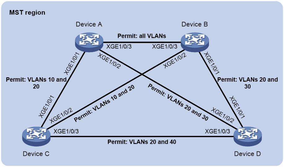

Ignoring the specified VLANs
Traffic of a VLAN on a complex network might be blocked by the spanning tree, as shown in Figure 16.
·     Port A1 on Device A allows the traffic of VLAN 1 to pass through.
·     Port A2 on Device A allows the traffic of VLAN 2 to pass through.
·     Port B1 on Device B allows the traffic of VLAN 1 to pass through.
·     Port B2 on Device B allows the traffic of VLAN 2 to pass through.
·     Device A and Device B run a spanning tree protocol. Device A is the root bridge, and Port A1 and Port A2 are designated ports. On Device B, Port B1 is the root port, and Port B2 is the blocked port. Traffic of VLAN 2 is blocked.
Figure 16 VLAN connectivity blocked by MSTP
Ignoring a VLAN can make ports of the VLAN forward frames correctly rather than comply with the spanning tree calculation result.

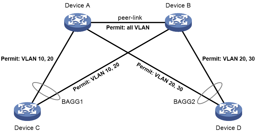

As shown in Figure 19, an IRF fabric connects to two user networks through double links.
·     Device A and Device B form the IRF fabric.
·     The spanning tree feature is disabled on Device A and Device B and enabled on all devices in user network 1 and user network 2.
·     The IRF fabric transparently transmits BPDUs for both user networks and is not involved in the calculation of spanning trees.
When the network topology changes, it takes time for the IRF fabric to update its MAC address table and ARP table. During this period, traffic in the network might be interrupted.
Figure 19 TC Snooping application scenario
image14.emf
To avoid traffic interruption, you can enable TC Snooping on the IRF fabric. After receiving a TC-BPDU through a port, the IRF fabric updates MAC address table and ARP table entries associated with the port's VLAN. In this way, TC Snooping prevents topology change from interrupting traffic forwarding in the network. For more information about the MAC address table and the ARP table, see "Configuring the MAC address table" and Layer 3—IP Services Configuration Guide.

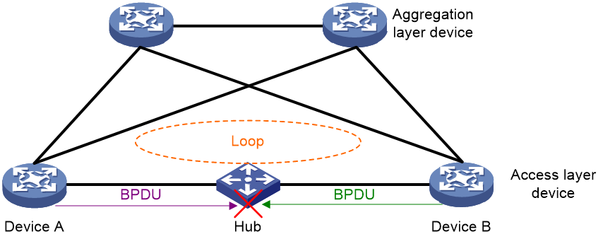

The initial state of a loop guard-enabled port is discarding in every MSTI. When the port receives BPDUs, it transits its state. Otherwise, it stays in the discarding state to prevent temporary loops.
Do not enable loop guard on a port that connects user terminals. Otherwise, the port stays in the discarding state in all MSTIs because it cannot receive BPDUs.
On a port, the loop guard feature is mutually exclusive with the root guard feature or the edge port setting.
A loop guard-enabled interface can receive BPDUs and transit from the discarding state to the forwarding state after two forward delays if one of the following events occurs:

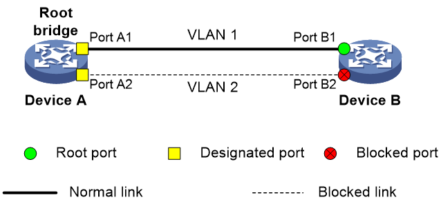

As shown in Figure 20, in normal conditions, the spanning tree calculation result is as follows:
·     Device A is the root bridge, and Port A1 is a designated port.
·     Port B1 is blocked.
When the link between Port A1 and Port B1 fails in the direction of Port A1 to Port B1 and becomes unidirectional, the following events occur:
1.     Port A1 can only receive BPDUs and cannot send BPDUs to Port B1.
2.     Port B1 does not receive BPDUs from Port A1 for a certain period of time.
3.     Device B determines itself as the root bridge.
4.     Port B1 sends its BPDUs to Port A1.
5.     Port A1 determines the received BPDUs are inferior to its own BPDUs. A dispute is detected.
6.     Dispute guard is triggered and blocks Port A1 to prevent a loop.

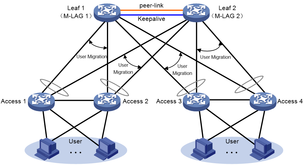

As shown in Figure 23, two devices at the leaf tier form an M-LAG system. The M-LAG system is connected to two loops (Access 1 — Access 2 — M-LAG and Access 3 — Access 4 — M-LAG), and STP runs on all devices. By default, any topology change by a device causes TC-BPDUs to be sent to both loops and create excessive TC-BPDUs in the network, which impacts system stability. If the topology changes, the interfaces for the user onboarding service on the leaf devices might change. In this case, users must be re-authenticated on other interfaces of the leaf devices to come online. During the re-authentication process, service traffic might be lost.
Figure 23 Network diagram

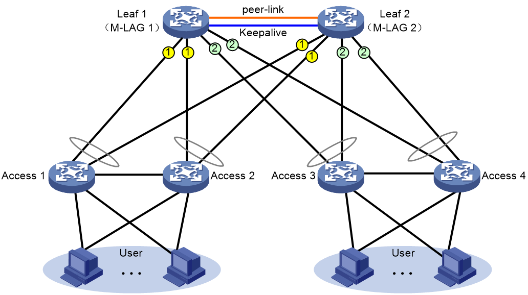

To address this issue, you can configure topology change (TC) groups. A TC group is a logical combination of multiple interfaces on a device, and supports a maximum of two interfaces. As shown in Figure 24, the two M-LAG interfaces connecting to Access 1 and Access 2 are added to TC group 1, and the two M-LAG interfaces connecting to Access 3 and Access 4 are added to TC group 2 on the leaf devices.
Figure 24 Network diagram
After TC groups are configured, the network can achieve the following functions:
·     When an M-LAG interface in a TC group receives a TC-BPDU, it forwards it only to the other M-LAG interface in the same TC group. This mechanism reduces the number of TC-BPDUs in the entire network, isolating the TC-BPDUs of the Access 1—Access 2—M-LAG loop and those of the Access 3—Access 4—M-LAG loop. When leaf devices are connected to many loops, this mechanism reduces the impact of exchanging TC-BPDU packets among loops.
·     When the network topology changes, static users, MAC authentication users, and 802.1X users in the same TC group can migrate between the two M-LAG interfaces in the TC group without authentication, enabling users to quickly come online again. For more information about the configuration procedures, migration conditions, and migration rules for authentication-free migration, see port security configuration in Security Configuration Guide.

As shown in Figure 25, Device A and Device B are connected via a HUB, which creates a loop in the network. Since BPDUs are point-to-point frames, once they are transmitted from a device and received by the next node, their transmission is terminated. The HUB acts as a blackhole for BPDUs. BPDUs cannot be transmitted between Device A and Device B through the HUB, and Device A and Device B cannot eliminate the loop through correct spanning tree topology calculation. Therefore, a method to detect BPDU blackholes is crucial for devices to block links to blackholes when detecting them, effectively eliminating potential loop risks.
Figure 25 Network diagram
Spanning tree blackhole detection feature can detect the presence of BPDU blackholes in the port links. Its working mechanism is as follows.

As shown in Figure 26, all devices on the network are in the same MST region. Device A and Device B work at the distribution layer. Device C and Device D work at the access layer.
Configure MSTP so that frames of different VLANs are forwarded along different spanning trees.
·     VLAN 10 frames are forwarded along MSTI 1.
·     VLAN 30 frames are forwarded along MSTI 3.
·     VLAN 40 frames are forwarded along MSTI 4.
·     VLAN 20 frames are forwarded along MSTI 0.
VLAN 10 and VLAN 30 are terminated on the distribution layer devices, and VLAN 40 is terminated on the access layer devices. The root bridges of MSTI 1 and MSTI 3 are Device A and Device B, respectively, and the root bridge of MSTI 4 is Device C.
Figure 26 Network diagram
1.     Configure VLANs and VLAN member ports. (Details not shown.)
¡     Create VLAN 10, VLAN 20, and VLAN 30 on both Device A and Device B.
¡     Create VLAN 10, VLAN 20, and VLAN 40 on Device C.
¡     Create VLAN 20, VLAN 30, and VLAN 40 on Device D.
¡     Configure the ports on these devices as trunk ports and assign them to related VLANs.

In this example, Device B has the lowest root bridge ID. As a result, Device B is elected as the root bridge in MSTI 0.
When the network is stable, you can use the display stp brief command to display brief spanning tree information on each device.
# Display brief spanning tree information on Device A.
[DeviceA] display stp brief
 MST ID      Port                         Role  STP State     Protection
 0           Ten-GigabitEthernet1/0/1     ALTE  DISCARDING    NONE
 0           Ten-GigabitEthernet1/0/2     DESI  FORWARDING    NONE
 0           Ten-GigabitEthernet1/0/3     ROOT  FORWARDING    NONE
 1           Ten-GigabitEthernet1/0/1     DESI  FORWARDING    NONE
 1           Ten-GigabitEthernet1/0/3     DESI  FORWARDING    NONE
 3           Ten-GigabitEthernet1/0/2     DESI  FORWARDING    NONE
 3           Ten-GigabitEthernet1/0/3     ROOT  FORWARDING    NONE
# Display brief spanning tree information on Device B.
[DeviceB] display stp brief
 0           Ten-GigabitEthernet1/0/1     DESI  FORWARDING    NONE
 0           Ten-GigabitEthernet1/0/3     DESI  FORWARDING    NONE
 1           Ten-GigabitEthernet1/0/2     DESI  FORWARDING    NONE
 1           Ten-GigabitEthernet1/0/3     ROOT  FORWARDING    NONE
 3           Ten-GigabitEthernet1/0/1     DESI  FORWARDING    NONE
 3           Ten-GigabitEthernet1/0/3     DESI  FORWARDING    NONE
# Display brief spanning tree information on Device C.
[DeviceC] display stp brief
 0           Ten-GigabitEthernet1/0/2     ROOT  FORWARDING    NONE
 1           Ten-GigabitEthernet1/0/1     ROOT  FORWARDING    NONE
 1           Ten-GigabitEthernet1/0/2     ALTE  DISCARDING    NONE
 4           Ten-GigabitEthernet1/0/3     DESI  FORWARDING    NONE
# Display brief spanning tree information on Device D.
[DeviceD] display stp brief
 0           Ten-GigabitEthernet1/0/1     ROOT  FORWARDING    NONE
 0           Ten-GigabitEthernet1/0/2     ALTE  DISCARDING    NONE
 0           Ten-GigabitEthernet1/0/3     ALTE  DISCARDING    NONE
 3           Ten-GigabitEthernet1/0/1     ROOT  FORWARDING    NONE
 3           Ten-GigabitEthernet1/0/2     ALTE  DISCARDING    NONE
 4           Ten-GigabitEthernet1/0/3     ROOT  FORWARDING    NONE
Based on the output, you can draw each MSTI mapped to each VLAN, as shown in Figure 27.

Example: Configuring PVST
As shown in Figure 28, Device A and Device B work at the distribution layer, and Device C and Device D work at the access layer.
Configure PVST to meet the following requirements:
·     Frames of a VLAN are forwarded along the spanning trees of the VLAN.
·     VLAN 10, VLAN 20, and VLAN 30 are terminated on the distribution layer devices, and VLAN 40 is terminated on the access layer devices.
·     The root bridge of VLAN 10 and VLAN 20 is Device A.
·     The root bridge of VLAN 30 is Device B.
·     The root bridge of VLAN 40 is Device C.
Figure 28 Network diagram
2.     Configure Device A:
# Set the spanning tree mode to PVST.
<DeviceA> system-view
[DeviceA] stp mode pvst
# Configure the device as the root bridge of VLAN 10 and VLAN 20.
[DeviceA] stp vlan 10 20 root primary
# Enable the spanning tree feature globally and in VLAN 10, VLAN 20, and VLAN 30.
[DeviceA] stp global enable
[DeviceA] stp vlan 10 20 30 enable
3.     Configure Device B:
<DeviceB> system-view
[DeviceB] stp mode pvst
# Configure the device as the root bridge of VLAN 30.
[DeviceB] stp vlan 30 root primary
[DeviceB] stp global enable
[DeviceB] stp vlan 10 20 30 enable
4.     Configure Device C:
<DeviceC> system-view
[DeviceC] stp mode pvst
# Configure the device as the root bridge of VLAN 40.
[DeviceC] stp vlan 40 root primary
# Enable the spanning tree feature globally and in VLAN 10, VLAN 20, and VLAN 40.
[DeviceC] stp global enable
[DeviceC] stp vlan 10 20 40 enable
5.     Configure Device D:
<DeviceD> system-view
[DeviceD] stp mode pvst
# Enable the spanning tree feature globally and in VLAN 20, VLAN 30, and VLAN 40.
[DeviceD] stp global enable
[DeviceD] stp vlan 20 30 40 enable
 VLAN ID     Port                         Role  STP State     Protection
 10          Ten-GigabitEthernet1/0/1     DESI  FORWARDING    NONE
 10          Ten-GigabitEthernet1/0/3     DESI  FORWARDING    NONE
 20          Ten-GigabitEthernet1/0/1     DESI  FORWARDING    NONE
 20          Ten-GigabitEthernet1/0/2     DESI  FORWARDING    NONE
 20          Ten-GigabitEthernet1/0/3     DESI  FORWARDING    NONE
 30          Ten-GigabitEthernet1/0/2     DESI  FORWARDING    NONE
 30          Ten-GigabitEthernet1/0/3     ROOT  FORWARDING    NONE
 10          Ten-GigabitEthernet1/0/2     DESI  FORWARDING    NONE
 10          Ten-GigabitEthernet1/0/3     ROOT  FORWARDING    NONE
 20          Ten-GigabitEthernet1/0/3     ROOT  FORWARDING    NONE
 30          Ten-GigabitEthernet1/0/1     DESI  FORWARDING    NONE
 30          Ten-GigabitEthernet1/0/3     DESI  FORWARDING    NONE
 10          Ten-GigabitEthernet1/0/1     ROOT  FORWARDING    NONE
 10          Ten-GigabitEthernet1/0/2     ALTE  DISCARDING    NONE
 20          Ten-GigabitEthernet1/0/1     ROOT  FORWARDING    NONE
 20          Ten-GigabitEthernet1/0/2     ALTE  DISCARDING    NONE
 40          Ten-GigabitEthernet1/0/3     DESI  FORWARDING    NONE
 20          Ten-GigabitEthernet1/0/1     ALTE  DISCARDING    NONE
 20          Ten-GigabitEthernet1/0/2     ROOT  FORWARDING    NONE
 20          Ten-GigabitEthernet1/0/3     ALTE  DISCARDING    NONE
 30          Ten-GigabitEthernet1/0/1     ROOT  FORWARDING    NONE
 30          Ten-GigabitEthernet1/0/2     ALTE  DISCARDING    NONE
 40          Ten-GigabitEthernet1/0/3     ROOT  FORWARDING    NONE
Based on the output, you can draw a topology for each VLAN spanning tree, as shown in Figure 29.

Example: Configuring M-LAG with PVST
As shown in Figure 30, Device A and Device B work at the distribution layer, and Device C and Device D work at the access layer.
Configure M-LAG on Device A and Device B. In the M-LAG system, Device A is the primary M-LAG device, and Device B is the secondary M-LAG device.
Configure PVST on the devices to meet the following requirements:
·     VLAN 10, VLAN 20, and VLAN 30 are terminated on the distribution layer devices.
·     The root bridge of VLAN 10, VLAN 20, and VLAN 30 is the M-LAG system formed by Device A and Device B.
·     As a best practice, do not connect ports on Device A and Device B that have the same port ID with each other, for example Layer 2 aggregate ports. Otherwise, when Device A and Device B communicate through the link, the spanning tree protocol determines that the device receives its own BPDUs. Loop guard will block the link, though spanning tree features are not affected.
·     You can view port IDs of interfaces on the device by using the display stp interface command.
·     The preceding restrictions do not apply to peer-link interfaces and their member ports.
Figure 30 Network diagram
¡     Create VLAN 10, and VLAN 20 on Device C.
¡     Create VLAN 20, and VLAN 30 on Device D.
2.     Configure M-LAG on Device A and Device B. (Details not shown.)
For more information about M-LAG, see "Configuring M-LAG."
3.     Configure Device A:
4.     Configure Device B in the same way Device A is configured. (Details not shown.)
5.     Configure Device C:
# Enable the spanning tree feature globally and in VLAN 10, and VLAN 20.
[DeviceC] stp vlan 10 20 enable
6.     Configure Device D:
# Enable the spanning tree feature globally and in VLAN 20, and VLAN 30.
[DeviceD] stp vlan 20 30 enable
# Display brief spanning tree information of the M-LAG system on the primary M-LAG device, Device A.
 10         Bridge-Aggregation1 (M-LAG)     DESI  FORWARDING    NONE
 20         Bridge-Aggregation1 (M-LAG)     DESI  FORWARDING    NONE
 20         Bridge-Aggregation2 (M-LAG)     DESI  FORWARDING    NONE
 30         Bridge-Aggregation2 (M-LAG)     DESI  FORWARDING    NONE
 10         Bridge-Aggregation1          ROOT  FORWARDING    NONE
 20         Bridge-Aggregation1          ROOT  FORWARDING    NONE
 20         Bridge-Aggregation2          ROOT  FORWARDING    NONE
 30         Bridge-Aggregation2          ROOT  FORWARDING    NONE
