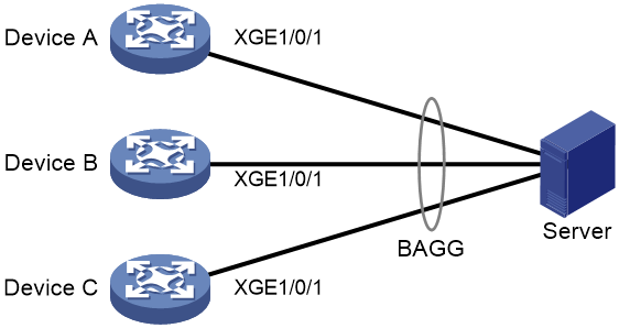

Example: Aggregating server-side links by using S-MLAG
As shown in Figure 2, configure S-MLAG as follows:
·     Connect Ten-GigabitEthernet 1/0/1 interfaces on Device A, Device B, and Device C to the server, and configure S-MLAG to aggregate the links to the server.
·     Configure the server-facing aggregate interfaces on Device A, Device B, and Device C as edge aggregate interfaces for the aggregation member ports to forward traffic correctly before link aggregation is set up on the server.
Figure 2 Network diagram
Analysis
To create a multichassis aggregate link on Device A, Device B, and Device C, perform the following tasks:
·     Create server-facing Layer 2 dynamic aggregate interfaces.
·     Assign the aggregate interfaces to an S-MLAG group.

Configuring Device A
# Set the LACP system MAC address to 0001-0001-0001.
<DeviceA> system-view
[DeviceA] lacp system-mac 1-1-1
# Set the LACP system priority to 123.
[DeviceA] lacp system-priority 123
# Set the LACP system number to 1.
[DeviceA] lacp system-number 1
# Create Layer 2 aggregate interface Bridge-Aggregation 1, and set the link aggregation mode to dynamic.
[DeviceA] interface bridge-aggregation 1
[DeviceA-Bridge-Aggregation1] link-aggregation mode dynamic
# Configure Bridge-Aggregation 1 as an edge aggregate interface.
[DeviceA-Bridge-Aggregation1] lacp edge-port
# Assign Bridge-Aggregation 1 to S-MLAG group 100.
[DeviceA-Bridge-Aggregation1] port s-mlag group 100
[DeviceA-Bridge-Aggregation1] quit
# Assign Ten-GigabitEthernet 1/0/1 to aggregation group 1.
[DeviceA] interface ten-gigabitethernet 1/0/1
[DeviceA-Ten-GigabitEthernet1/0/1] port link-aggregation group 1
[DeviceA-Ten-GigabitEthernet1/0/1] quit
Configuring Device B
<DeviceB> system-view
[DeviceB] lacp system-mac 1-1-1
[DeviceB] lacp system-priority 123
# Set the LACP system number to 2.
[DeviceB] lacp system-number 2
# Create Layer 2 aggregate interface Bridge-Aggregation 2, and set the link aggregation mode to dynamic.
[DeviceB] interface bridge-aggregation 2
[DeviceC-Bridge-Aggregation2] link-aggregation mode dynamic
# Configure Bridge-Aggregation 2 as an edge aggregate interface.
[DeviceB-Bridge-Aggregation2] lacp edge-port
# Assign Bridge-Aggregation 2 to S-MLAG group 100.
[DeviceB-Bridge-Aggregation2] port s-mlag group 100
# Assign Ten-GigabitEthernet 1/0/1 to aggregation group 2.
[DeviceB] interface ten-gigabitethernet 1/0/1
[DeviceB-Ten-GigabitEthernet1/0/1] port link-aggregation group 2
[DeviceB-Ten-GigabitEthernet1/0/1] quit
Configuring Device C
<DeviceC> system-view
[DeviceC] lacp system-mac 1-1-1
[DeviceC] lacp system-priority 123
# Set the LACP system number to 3.
[DeviceC] lacp system-number 3
# Create Layer 2 aggregate interface Bridge-Aggregation 3, and set the link aggregation mode to dynamic.
[DeviceC] interface bridge-aggregation 3
[DeviceC-Bridge-Aggregation3] link-aggregation mode dynamic
# Configure Bridge-Aggregation 3 as an edge aggregate interface.
[DeviceC-Bridge-Aggregation3] lacp edge-port
# Assign Bridge-Aggregation 3 to S-MLAG group 100.
[DeviceC-Bridge-Aggregation3] port s-mlag group 100
# Assign Ten-GigabitEthernet 1/0/1 to aggregation group 3.
[DeviceC] interface ten-gigabitethernet 1/0/1
[DeviceC-Ten-GigabitEthernet1/0/1] port link-aggregation group 3
[DeviceC-Ten-GigabitEthernet1/0/1] quit
# Before you configure dynamic link aggregation on the server, verify that the aggregation member ports are in individual state on Device A, Device B, and Device C to forward traffic independently.
[DeviceA] display link-aggregation verbose
Loadsharing Type: Shar -- Loadsharing, NonS -- Non-Loadsharing
Port Status: S -- Selected, U -- Unselected, I -- Individual
Port: A -- Auto port, M -- Management port, R -- Reference port
Flags:  A -- LACP_Activity, B -- LACP_Timeout, C -- Aggregation,
        G -- Defaulted, H -- Expired
Aggregate Interface: Bridge-Aggregation1
Creation Mode: Manual
Aggregation Mode: Dynamic
Management VLANs: None
System ID: 0x7b, 0001-0001-0001
Local:
  Port                Status   Priority Index    Oper-Key               Flag
  XGE1/0/1            I        32768    16385    50100                  {AG}
Remote:
  Actor               Priority Index    Oper-Key SystemID               Flag
  XGE1/0/1            32768    0        0        0x8000, 0000-0000-0000 {DEF}
[DeviceB] display link-aggregation verbose
Aggregate Interface: Bridge-Aggregation2
Local:
  XGE1/0/1            I        32768    32769    50100                  {AG}
Remote:
[DeviceC] display link-aggregation verbose
Aggregate Interface: Bridge-Aggregation3
Local:
  XGE1/0/1            I        32768    49153    50100                  {AG}
Remote:
# After you configure dynamic link aggregation on the server, verify that the aggregation member ports are selected on Device A, Device B, and Device C, which indicates that the multichassis link aggregation has been set up.
Local:
  XGE1/0/1(R)         S        32768    16385    50100                  {ACDEF}
Remote:
  XGE1/0/1            32768    1        1        0x8000, 5022-e533-0400 {ACDEF}
Local:
  XGE1/0/1(R)         S        32768    32769    50100                  {ACDEF}
Remote:
  XGE1/0/1            32768    2        1        0x8000, 5022-e533-0400 {ACDEF}
Local:
  XGE1/0/1(R)         S        32768    49153    50100                  {ACDEF}
Remote:
  XGE1/0/1            32768    3        1        0x8000, 5022-e533-0400 {ACDEF}
Configuration files
·     Device A:
 lacp system-mac 0001-0001-0001
interface Bridge-Aggregation1
 lacp edge-port
interface Ten-GigabitEthernet1/0/1
 port link-mode bridge
·     Device B:
interface Bridge-Aggregation2
 lacp edge-port
·     Device C:
interface Bridge-Aggregation3
 lacp edge-port
