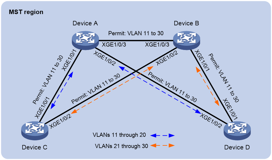

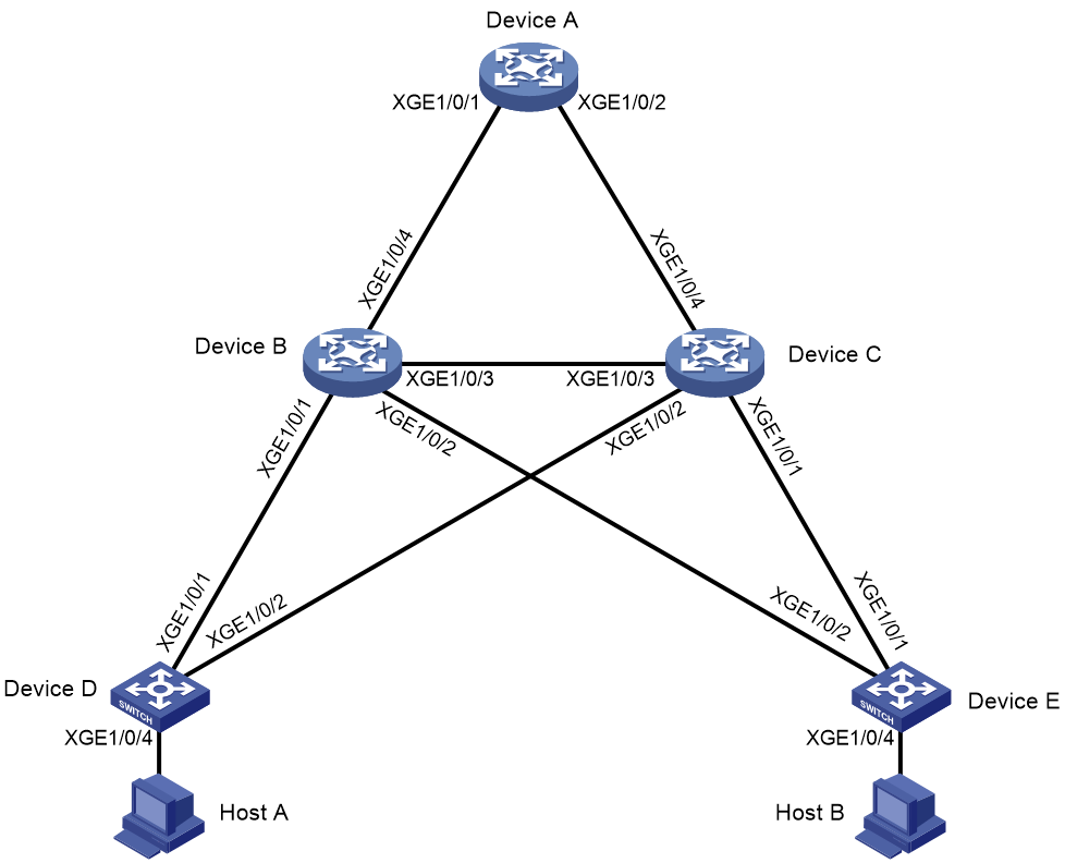

As shown in Figure 1, Device A and Device B operate at the core layer, and Device C and Device D operate at the distribution layer. The ports on the devices have the same path cost, and they all permit VLANs 11 through 30.
Configure MSTP to meet the following requirements:
·     Device A, Device B, Device C, and Device D belong to the same MST region.
·     MSTIs are used to share the traffic of VLANs 11 through 20 and of VLANs 21 through 30.
Figure 1 Network diagram

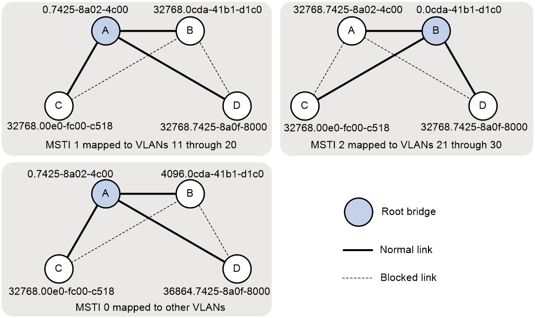

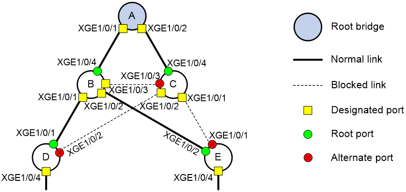

To use redundant links to share the traffic of different VLANs (as shown in Figure 2), perform the following tasks:
·     Configure Device A as the root bridge of MSTI 1.
·     Configure Device B as the root bridge of MIST 2.
·     Assign priorities to Device A, Device B, Device C, and Device D in MSTI 0 in descending order for Device A to be the regional root bridge.
Figure 2 MSTIs mapped to different VLANs

Procedures
Configuring Device A
# Create VLANs 11 through 30.
<DeviceA> system-view
[DeviceA] vlan 11 to 30
# Configure Ten-GigabitEthernet 1/0/1, Ten-GigabitEthernet 1/0/2, and Ten-GigabitEthernet 1/0/3 to trunk VLANs 11 through 30.
[DeviceA] interface range ten-gigabitethernet 1/0/1 to ten-gigabitethernet 1/0/3
[DeviceA-if-range] port link-type trunk
[DeviceA-if-range] port trunk permit vlan 11 to 30
[DeviceA-if-range] quit
# Configure the MST region name as test.
[DeviceA] stp region-configuration
[DeviceA-mst-region] region-name test
# Map VLANs 11 through 20 to MSTI 1, and map VLANs 21 through 30 to MSTI 2.
[DeviceA-mst-region] instance 1 vlan 11 to 20
[DeviceA-mst-region] instance 2 vlan 21 to 30
# Activate the MST region configuration.
[DeviceA-mst-region] active region-configuration
[DeviceA-mst-region] quit
# Configure Device A as the root bridge of MSTI 0 and MSTI 1.
[DeviceA] stp instance 0 to 1 root primary
# Enable the spanning tree feature globally.
[DeviceA] stp global enable
Configuring Device B
<DeviceB> system-view
[DeviceB] vlan 11 to 30
[DeviceB] interface range ten-gigabitethernet 1/0/1 to ten-gigabitethernet 1/0/3
[DeviceB-if-range] port link-type trunk
[DeviceB-if-range] port trunk permit vlan 11 to 30
[DeviceB-if-range] quit
[DeviceB] stp region-configuration
[DeviceB-mst-region] region-name test
[DeviceB-mst-region] instance 1 vlan 11 to 20
[DeviceB-mst-region] instance 2 vlan 21 to 30
[DeviceB-mst-region] active region-configuration
[DeviceB-mst-region] quit
# Configure Device B as the root bridge of MSTI 2 and a secondary root bridge of MSTI 0.
[DeviceB] stp instance 2 root primary
[DeviceB] stp instance 0 root secondary
[DeviceB] stp global enable
Configuring Device C
<DeviceC> system-view
[DeviceC] vlan 11 to 30
# Configure Ten-GigabitEthernet 1/0/1 and Ten-GigabitEthernet 1/0/2 to trunk VLANs 11 through 30.
[DeviceC] interface range ten-gigabitethernet 1/0/1 to ten-gigabitethernet 1/0/2
[DeviceC-if-range] port link-type trunk
[DeviceC-if-range] port trunk permit vlan 11 to 30
[DeviceC-if-range] quit
[DeviceC] stp region-configuration
[DeviceC-mst-region] region-name test
# Map VLANs 11 through 20 through MSTI 1, and map VLANs 21 through 30 to MSTI 2.
[DeviceC-mst-region] instance 1 vlan 11 to 20
[DeviceC-mst-region] instance 2 vlan 21 to 30
[DeviceC-mst-region] active region-configuration
[DeviceC-mst-region] quit
[DeviceC] stp global enable
Configuring Device D
<DeviceD> system-view
[DeviceD] vlan 11 to 30
[DeviceD] interface range ten-gigabitethernet 1/0/1 to ten-gigabitethernet 1/0/2
[DeviceD-if-range] port link-type trunk
[DeviceD-if-range] port trunk permit vlan 11 to 30
[DeviceD-if-range] quit
[DeviceD] stp region-configuration
[DeviceD-mst-region] region-name test
[DeviceD-mst-region] instance 1 vlan 11 to 20
[DeviceD-mst-region] instance 2 vlan 21 to 30
[DeviceD-mst-region] active region-configuration
[DeviceD-mst-region] quit
# Set the device priority to 36864 in MSTI 0, which is lower than the default priority 32768 of Device C.
[DeviceD] stp instance 0 priority 36864
[DeviceD] stp global enable

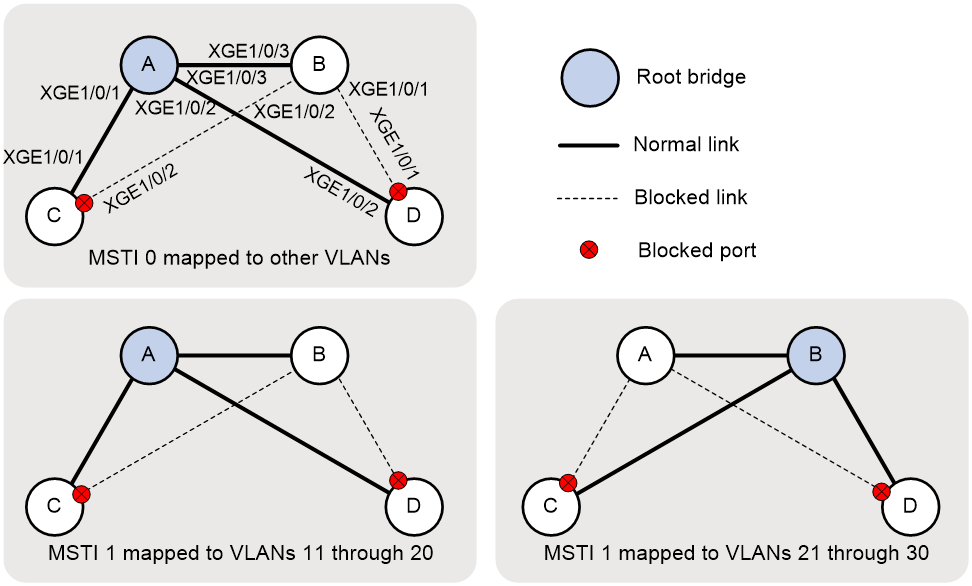

1.     Verify that Layer 2 loops have been eliminated in each MSTI:
Use the display stp brief command to display brief spanning tree information on each device.
# Display brief spanning tree information on Device A.
[DeviceA] display stp brief
 MST ID   Port                                    Role  STP State   Protection
 0        Ten-GigabitEthernet1/0/1                DESI  FORWARDING  NONE
 0        Ten-GigabitEthernet1/0/2                DESI  FORWARDING  NONE
 0        Ten-GigabitEthernet1/0/3                DESI  FORWARDING  NONE
 1        Ten-GigabitEthernet1/0/1                DESI  FORWARDING  NONE
 1        Ten-GigabitEthernet1/0/2                DESI  FORWARDING  NONE
 1        Ten-GigabitEthernet1/0/3                DESI  FORWARDING  NONE
 2        Ten-GigabitEthernet1/0/1                ALTE  DISCARDING  NONE
 2        Ten-GigabitEthernet1/0/2                DESI  FORWARDING  NONE
 2        Ten-GigabitEthernet1/0/3                ROOT  FORWARDING  NONE
# Display brief spanning tree information on Device B.
[DeviceB] display stp brief
 0        Ten-GigabitEthernet1/0/3                ROOT  FORWARDING  NONE
 1        Ten-GigabitEthernet1/0/2                ALTE  DISCARDING  NONE
 1        Ten-GigabitEthernet1/0/3                ROOT  FORWARDING  NONE
 2        Ten-GigabitEthernet1/0/1                DESI  FORWARDING  NONE
 2        Ten-GigabitEthernet1/0/3                DESI  FORWARDING  NONE
# Display brief spanning tree information on Device C.
[DeviceC] display stp brief
 0        Ten-GigabitEthernet1/0/1               ROOT  FORWARDING  NONE
 0        Ten-GigabitEthernet1/0/2               ALTE  DISCARDING  NONE
 1        Ten-GigabitEthernet1/0/1               ROOT  FORWARDING  NONE
 2        Ten-GigabitEthernet1/0/2               ROOT  FORWARDING  NONE
# Display brief spanning tree information on Device D.
[DeviceD] display stp brief
 0        Ten-GigabitEthernet1/0/1                ALTE  DISCARDING  NONE
 0        Ten-GigabitEthernet1/0/2                ROOT  FORWARDING  NONE
 1        Ten-GigabitEthernet1/0/1                ALTE  DISCARDING  NONE
 1        Ten-GigabitEthernet1/0/2                ROOT  FORWARDING  NONE
 2        Ten-GigabitEthernet1/0/1                ROOT  FORWARDING  NONE
 2        Ten-GigabitEthernet1/0/2                ALTE  DISCARDING  NONE

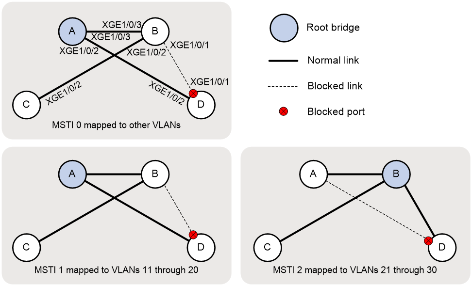

Based on the output, the topology for each MSTI is shown in Figure 3.
Figure 3 MSTI topologies
2.     Verify that the network can accommodate topology changes:
# Shut down Ten-GigabitEthernet 1/0/1 on Device C. (Details not shown.)
# Display brief spanning tree information on all devices.
Based on the output, the topology for each MSTI is shown in Figure 4.
Figure 4 MSTI topologies

Example: Configuring PVST
As shown in Figure 5, Device A and Device B operate at the distribution layer, and Device C and Device D operate at the access layer. The ports on the devices have the same path cost.
Configure PVST to meet the following requirements:
·     Redundant links are used for load sharing.
·     Packets of each VLAN are forwarded along its spanning tree.

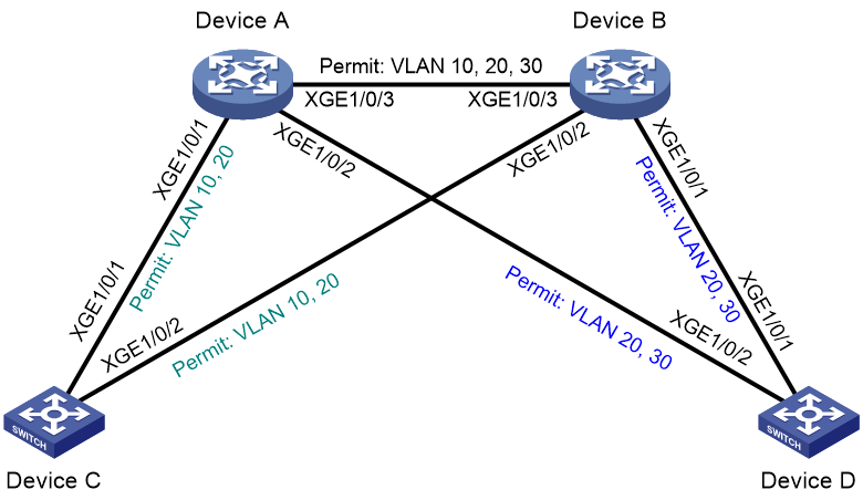

Figure 5 Network diagram
Analysis
For traffic of different VLANs to be shared along the spanning trees in Figure 6, perform the following tasks:
·     Configure Device A as the root bridge of the spanning trees for VLAN 10 and VLAN 30.
·     Configure Device B as the root bridge of the spanning tree for VLAN 20.
Figure 6 VLAN spanning tree topologies

Example: Configuring RSTP
As shown in Figure 8, Device A operates at the core layer, Device B and Device C operate at the distribution layer, and Device D and Device E operate at the access layer. The ports on the devices have the same path cost.
Configure RSTP as follows:
·     Configure Device A as the root bridge, and enable root guard to retain its root bridge role when configuration errors or malicious attacks occur.
·     Configure Device C as a backup of Device B. When Device B fails, traffic is forwarded through Device C.
·     Configure Ten-GigabitEthernet 1/0/4 on Device D and Ten-GigabitEthernet 1/0/4 on Device E as edge ports, and enable BPDU guard on the ports.
Figure 8 Network diagram

1.     Verify that Layer 2 loops have been eliminated in the network:
# Display the brief spanning tree information on Device A.
# Display the brief spanning tree information on Device B.
 0        Ten-GigabitEthernet1/0/4                ROOT  FORWARDING  NONE
# Display the brief spanning tree information on Device C.
 0        Ten-GigabitEthernet1/0/3                ALTE  DISCARDING  NONE
# Display the brief spanning tree information on Device D.
 0        Ten-GigabitEthernet1/0/4                DESI  FORWARDING  BPDU
# Display the brief spanning tree information on Device E.
[DeviceE] display stp brief

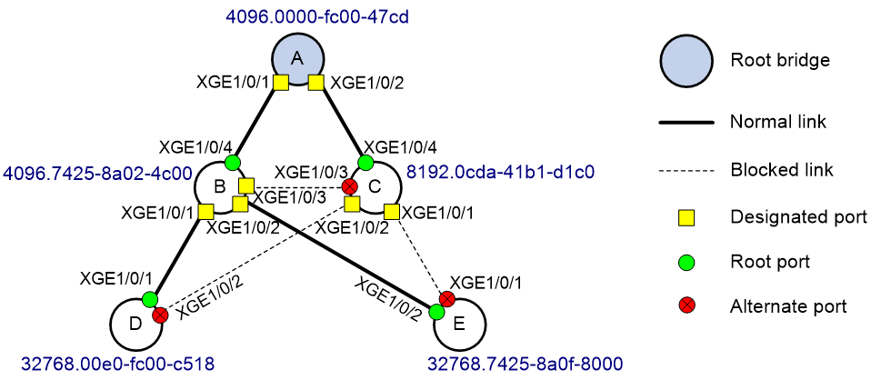

Based on the output, the topology for the network is shown in Figure 10.

2.     Verify that root guard can retain Device A's root bridge role:
