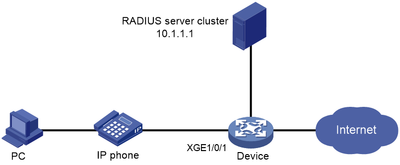

Example: Configuring port-based VLANs
As shown in Figure 1:
·     Host A and Host C belong to Department A. VLAN 100 is assigned to Department A.
·     Host B and Host D belong to Department B. VLAN 200 is assigned to Department B.
Configure port-based VLANs so that hosts only in the same department can communicate with each other.

Procedures
1.     Configure Device A:
# Create VLAN 100, and assign Ten-GigabitEthernet 1/0/1 to VLAN 100.
[DeviceA] vlan 100
[DeviceA-vlan100] port ten-gigabitethernet 1/0/1
[DeviceA-vlan100] quit
# Create VLAN 200, and assign Ten-GigabitEthernet 1/0/2 to VLAN 200.
[DeviceA] vlan 200
[DeviceA-vlan200] port ten-gigabitethernet 1/0/2
[DeviceA-vlan200] quit
# Configure Ten-GigabitEthernet 1/0/3 as a trunk port, and assign it to VLANs 100 and 200.
[DeviceA] interface ten-gigabitethernet 1/0/3
[DeviceA-Ten-GigabitEthernet1/0/3] port link-type trunk
[DeviceA-Ten-GigabitEthernet1/0/3] port trunk permit vlan 100 200
2.     Configure Device B in the same way Device A is configured. (Details not shown.)
3.     Configure hosts:
a.     Configure Host A and Host C to be on the same IP subnet. For example, 192.168.100.0/24.
b.     Configure Host B and Host D to be on the same IP subnet. For example, 192.168.200.0/24.
# Verify that Host A and Host C can ping each other, but they both fail to ping Host B or Host D. (Details not shown.)
# Verify that Host B and Host D can ping each other, but they both fail to ping Host A or Host C. (Details not shown.)
# Display information about VLANs 100 and 200 on Device A.
[DeviceA-Ten-GigabitEthernet1/0/3] display vlan 100
 VLAN ID: 100
 VLAN type: Static
 Route interface: Not configured
 Description: VLAN 0100
 Tagged ports:
 Untagged ports:
    Ten-GigabitEthernet1/0/1
[DeviceA-Ten-GigabitEthernet1/0/3] display vlan 200
 VLAN ID: 200
 VLAN type: Static
 Description: VLAN 0200
 Tagged ports:
 Untagged ports:
    Ten-GigabitEthernet1/0/2
The output shows that:
·     Ten-GigabitEthernet 1/0/3 and Ten-GigabitEthernet 1/0/1 permit packets from 100 to pass through.
·     Ten-GigabitEthernet 1/0/3 and Ten-GigabitEthernet 1/0/2 permit packets from 200 to pass through.

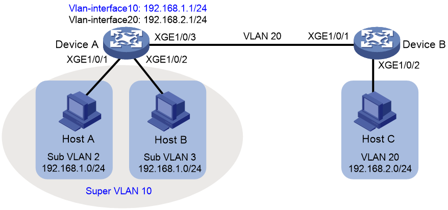

Example: Configuring the super VLAN
As shown in Figure 2:
·     Users in VLAN 2 access the network through Ten-GigabitEthernet 1/0/1 of Device A.
·     Users in VLAN 3 access the network through Ten-GigabitEthernet 1/0/2 of Device A.
·     Ten-GigabitEthernet 1/0/3 of Device A and Ten-GigabitEthernet 1/0/1 of Device B are in VLAN 20.
·     Users in VLAN 20 use the gateway address 192.168.2.1 and IP addresses on the IP network segment 192.168.2.0/24.
Configure a super VLAN to meet the following requirements:
·     Users in VLAN 2 and VLAN 3 use the gateway address 192.168.1.1 and IP addresses on the IP network segment 192.168.1.0/24.
·     Users in VLAN 2, VLAN 3, and VLAN 20 are isolated at Layer 2 but interoperable at Layer 3.
Figure 2 Network diagram
Hardware
Software version
S12500G-AF switch series
Release 7639P01 and later
S10500X switch series
S10500 switch series
S7500E-X switch series
S7500E switch series
S7500X switch series
A super VLAN does not have physical ports. A VLAN that has physical ports cannot be configured as a super VLAN.
Procedures
Configuring Device A
# Create VLAN 10 and configure it as a super VLAN.
<DeviceA> system-view
[DeviceA] vlan 10
[DeviceA-vlan10] supervlan
[DeviceA-vlan10] quit
# Create VLAN 2, and assign Ten-GigabitEthernet 1/0/1 to VLAN 2.
[DeviceA] vlan 2
[DeviceA-vlan2] port ten-gigabitethernet 1/0/1
[DeviceA-vlan2] quit
# Create VLAN 3, and assign Ten-GigabitEthernet 1/0/2 to VLAN 3.
[DeviceA] vlan 3
[DeviceA-vlan3] port ten-gigabitethernet 1/0/2
[DeviceA-vlan3] quit
# Associate super VLAN 10 with VLANs 2 and 3.
[DeviceA] vlan 10
[DeviceA-vlan10] subvlan 2 3
# Create VLAN-interface 10, and assign IP address 192.168.1.1 to it.
[DeviceA] interface vlan-interface 10
[DeviceA-Vlan-interface10] ip address 192.168.1.1 24
# Enable local proxy ARP on VLAN-interface 10.
[DeviceA-Vlan-interface10] local-proxy-arp enable
[DeviceA-Vlan-interface10] quit
# Create VLAN 20.
[DeviceA] vlan 20
[DeviceA-vlan20] quit
# Configure Ten-GigabitEthernet 1/0/3 as a trunk port, and remove the port from VLAN 1.
[DeviceA-Ten-GigabitEthernet1/0/3] undo port trunk permit vlan 1
# Assign Ten-GigabitEthernet 1/0/3 to VLAN 20.
[DeviceA-Ten-GigabitEthernet1/0/3] port trunk permit vlan 20
[DeviceA-Ten-GigabitEthernet1/0/3] quit
# Create VLAN-interface 20, and assign IP address 192.168.2.1 to it.
[DeviceA] interface Vlan-interface 20
[DeviceA-Vlan-interface20] ip address 192.168.2.1 24
[DeviceA-Vlan-interface20] quit
Configuring Device B
# Create VLAN 20.
[DeviceB] vlan 20
[DeviceB-vlan20] quit
# Configure Ten-GigabitEthernet 1/0/1 as a trunk port, and remove the port from VLAN 1.
[DeviceB] interface ten-gigabitethernet 1/0/1
[DeviceB-Ten-GigabitEthernet1/0/1] port link-type trunk
[DeviceB-Ten-GigabitEthernet1/0/1] undo port trunk permit vlan 1
# Assign Ten-GigabitEthernet 1/0/1 to VLAN 20.
[DeviceB-Ten-GigabitEthernet1/0/1] port trunk permit vlan 20
[DeviceB-Ten-GigabitEthernet1/0/1] quit
# Assign Ten-GigabitEthernet 1/0/2 to VLAN 20.
[DeviceB] vlan 20
[DeviceB-vlan20] port ten-gigabitethernet 1/0/2
# Verify the super VLAN configuration.
[DeviceA] display supervlan
 Super VLAN ID: 10
 Sub-VLAN ID: 2-3
 VLAN ID: 10
 VLAN type: Static
 It is a super VLAN.
 Route interface: Configured
 IPv4 address: 192.168.1.1
 IPv4 subnet mask: 255.255.255.0
 Description: VLAN 0010
 Tagged ports: none
 Untagged ports: none
 VLAN ID: 2
 VLAN type: Static
 It is a sub-VLAN.
 Description: VLAN 0002
 Tagged ports: none
 Untagged ports:
 VLAN ID: 3
 VLAN type: Static
 It is a sub-VLAN.
 Description: VLAN 0003
 Tagged ports: none
 Untagged ports:
# Verify that Host A and Host B can ping each other. In the ARP table of Host A, the IP address of Host B corresponds to the MAC address of VLAN-interface 10. In the ARP table of Host B, the IP address of Host A corresponds to the MAC address of VLAN-interface 10. (Details not shown.)
# Verify that Host A and Host C can ping each other. In the ARP table of Host A, no entry about Host C exists. In the ARP table of Host C, no entry about Host A exists. (Details not shown.)
# Verify that Host B and Host C can ping each other. In the ARP table of Host B, no entry about Host C exists. In the ARP table of Host C, no entry about Host B exists. (Details not shown.)

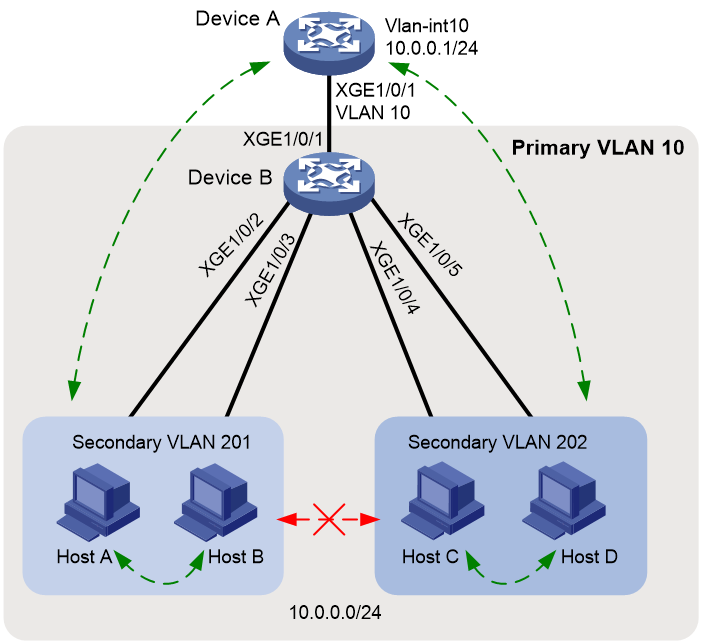

Example: Configuring the private VLAN
As shown in Figure 3:
·     The aggregation-layer device Device A assigns VLAN 10 to Device B. Hosts access the network through VLAN-interface 10.
·     Users connected to Device B are on the same subnet 10.0.0.0/24.
·     Host A and Host B are in the Marketing department. Host C and Host D are in the Finance department.
Configure the private VLAN feature to meet the following requirements:
·     Device A is only aware of the primary VLAN 10.
·     Hosts in the same secondary VLAN are interoperable at Layer 2.
·     Hosts in different secondary VLANs are isolated at Layer 2.
Figure 3 Network diagram
Requirements analysis
The private VLAN configuration is required only on Device B.
Hardware
Software version
The system default VLAN (VLAN 1) does not support the private VLAN configuration.
Procedures
# Create VLAN 10 and configure it as a primary VLAN.
<DeviceB> system-view
[DeviceB] vlan 10
[DeviceB-vlan10] private-vlan primary
[DeviceB-vlan10] quit
# Create VLANs 201 and 202.
[DeviceB] vlan 201 to 202
# Associate primary VLAN 10 with secondary VLANs 201 and 202.
[DeviceB] vlan 10
[DeviceB-vlan10] private-vlan secondary 201 to 202
# Configure the uplink port Ten-GigabitEthernet 1/0/1 as a promiscuous port of VLAN 10.
[DeviceB-Ten-GigabitEthernet1/0/1] port private-vlan 10 promiscuous
# Assign the downlink ports Ten-GigabitEthernet 1/0/2 and Ten-GigabitEthernet 1/0/3 to VLAN 201 as host ports.
[DeviceB] interface range ten-gigabitethernet 1/0/2 to ten-gigabitethernet 1/0/3
[DeviceB-if-range] port access vlan 201
[DeviceB-if-range] port private-vlan host
[DeviceB-if-range] quit
# Assign the downlink ports Ten-GigabitEthernet 1/0/4 and Ten-GigabitEthernet 1/0/5 to VLAN 202 as host ports.
[DeviceB] interface range ten-gigabitethernet 1/0/4 to ten-gigabitethernet 1/0/5
[DeviceB-if-range] port access vlan 202

# Display the private VLAN configuration on Device B.
[DeviceB] display private-vlan
 Primary VLAN ID: 10
 Secondary VLAN ID: 201-202
 VLAN ID: 10
 VLAN type: Static
 Private VLAN type: Primary
 Tagged ports:   None
 Untagged ports:
    Ten-GigabitEthernet1/0/1          Ten-GigabitEthernet1/0/2
    Ten-GigabitEthernet1/0/3          Ten-GigabitEthernet1/0/4
    Ten-GigabitEthernet1/0/5
 VLAN ID: 201
 VLAN type: Static
 Private VLAN type: Secondary
 Description: VLAN 0201
 Tagged ports:   None
 Untagged ports:
 VLAN ID: 202
 VLAN type: Static
 Description: VLAN 0202
 Tagged ports:   None
 Untagged ports:
    Ten-GigabitEthernet1/0/1          Ten-GigabitEthernet1/0/4
·     The promiscuous port Ten-GigabitEthernet1/0/1 is an untagged member of primary VLAN 10 and secondary VLANs 201 and 202.
·     The host ports Ten-GigabitEthernet 1/0/2 and Ten-GigabitEthernet 1/0/3 are untagged members of secondary VLANs 201.
·     The host ports Ten-GigabitEthernet 1/0/4 and Ten-GigabitEthernet 1/0/5 are untagged members of secondary VLANs 202.
# Verify that Hosts in the same secondary VLAN can ping each other, but they fail to ping hosts in the other secondary VLAN. (Details not shown.)

Example: Configuring the voice VLAN
As shown in Figure 4, the device connects to an IP phone through Ten-GigabitEthernet1/0/1, and the IP phone sends tagged voice traffic. The device authenticates the IP phone through the RADIUS server. If the IP phone passes authentication, the IP phone is allowed to access the device. Configure voice VLAN 2 on the device. Configure LLDP to enable the IP phone to automatically come online after passing 802.1X authentication.
Configure voice VLAN to meet the following requirements:
·     The IP phone automatically comes online after passing 802.1X authentication on Ten-GigabitEthernet 1/0/1.
·     The IP phone can automatically come online and send voice traffic without manually configured voice VLAN MAC addresses on the device.
Figure 4 Network diagram
