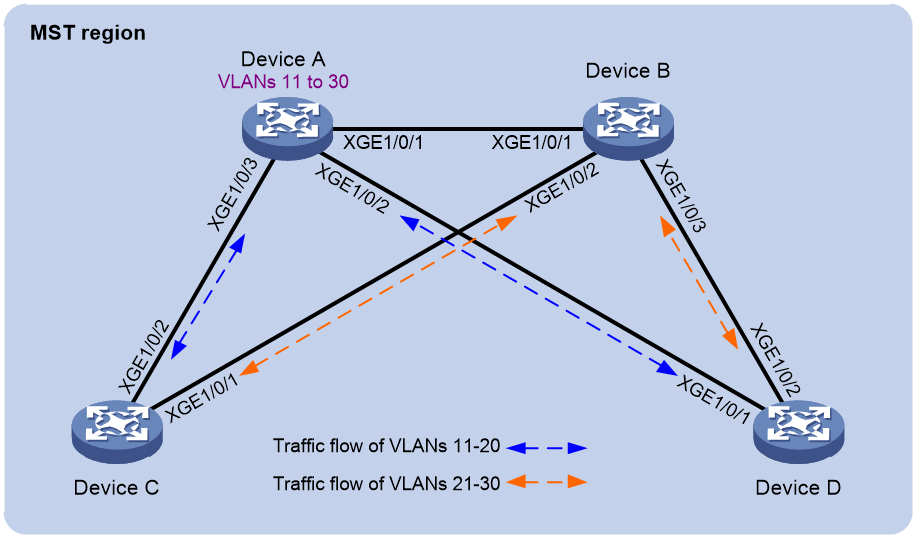

As shown in Figure 1:
·     Device A and Device B are core layer devices. Device C and Device D are aggregation layer devices.
·     Ports on all devices allow packets from VLANs 11 through 30 to pass through.
·     MSTP implements load balancing and link backup for traffic of VLANs 11 through 30 between the core layer devices and the aggregation layer devices.
Configure MVRP on all devices to synchronize and update VLAN information. When the network is stable, set the registration mode to fixed on Ten-GigabitEthernet 1/0/1 of Device B to maintain dynamic VLAN information.
Figure 1 Network diagram

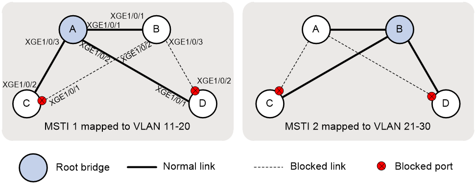

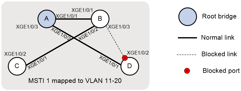

Verifying MSTI topologies
# Display brief spanning tree information on Device A.
[DeviceA] display stp brief
 MST ID   Port                                Role  STP State   Protection
 1        Ten-GigabitEthernet1/0/1            DESI  FORWARDING  NONE
 1        Ten-GigabitEthernet1/0/2            DESI  FORWARDING  NONE
 1        Ten-GigabitEthernet1/0/3            DESI  FORWARDING  NONE
 2        Ten-GigabitEthernet1/0/1            ROOT  FORWARDING  NONE
 2        Ten-GigabitEthernet1/0/2            DESI  FORWARDING  NONE
 2        Ten-GigabitEthernet1/0/3            DESI  FORWARDING  NONE
# Display brief spanning tree information on Device B.
[DeviceB] display stp brief
 1        Ten-GigabitEthernet1/0/1            ROOT  FORWARDING  NONE
 2        Ten-GigabitEthernet1/0/1            DESI  FORWARDING  NONE
# Display brief spanning tree information on Device C.
[DeviceC] display stp brief
 1        Ten-GigabitEthernet1/0/1            ALTE  DISCARDING  NONE
 1        Ten-GigabitEthernet1/0/2            ROOT  FORWARDING  NONE
 2        Ten-GigabitEthernet1/0/2            ALTE  DISCARDING  NONE
# Display brief spanning tree information on Device D.
[DeviceD] display stp brief
 1        Ten-GigabitEthernet1/0/2            ALTE  DISCARDING  NONE
 2        Ten-GigabitEthernet1/0/1            ALTE  DISCARDING  NONE
 2        Ten-GigabitEthernet1/0/2            ROOT  FORWARDING  NONE
Based on the output, you can get MSTI topologies, as shown in Figure 2.

Verifying local VLAN information on all devices
# Display local VLAN information on Device A.
[DeviceA] display mvrp running-status
 -------[MVRP Global Info] -------
 Global Status     : Enabled
 Compliance-GVRP   : False
 ----[Ten-GigabitEthernet1/0/1] ----
 Config  Status                 : Enabled
 Running Status                 : Enabled
 Join Timer                     : 20 (centiseconds)
 Leave Timer                    : 60 (centiseconds)
 Periodic Timer                 : 100 (centiseconds)
 LeaveAll Timer                 : 1000 (centiseconds)
 Registration Type              : Normal
 Registered VLANs :
  1(default), 11, 21
 Declared VLANs :
  1(default), 11-30
 Propagated VLANs :
  1(default), 11, 21
 ----[Ten-GigabitEthernet1/0/2] ----
 Registered VLANs :
  1(default), 11
 Declared VLANs :
  1(default), 11-30
 Propagated VLANs :
  1(default), 11
 ----[Ten-GigabitEthernet1/0/3] ----
 Registered VLANs :
  1(default), 11
 Declared VLANs :
  1(default), 11-30
 Propagated VLANs :
  1(default), 11
The output shows that all ports of Device A have declared VLANs 11 through 30.
 0        Ten-GigabitEthernet1/0/1            ROOT  FORWARDING  NONE
 0        Ten-GigabitEthernet1/0/2            ALTE  DISCARDING  NONE
Based on the output, you can get the topology of MSTI 1, as shown in Figure 3.
Figure 3 Topology of MSTI 1
# Display dynamic VLANs on Device C.
[DeviceC] display vlan dynamic
 Dynamic VLANs: 18
 The dynamic VLANs include:
 12-20, 22-30
# Display VLAN information on Ten-GigabitEthernet 1/0/2 of Device C.
[DeviceC] display interface ten-gigabitethernet 1/0/2
Port link-type: Trunk
 VLAN Passing:   1(default vlan), 11, 21
 VLAN permitted: 1(default vlan), 11-30
 Trunk port encapsulation: IEEE 802.1q
The output shows that:
·     VLANs 1, 11, and 21 can pass through Ten-GigabitEthernet 1/0/2.
·     Ten-GigabitEthernet 1/0/2 failed to learn dynamic VLANs.
