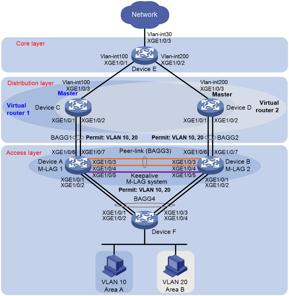

As shown in Figure 1:
·     Configure Device A and Device B as an M-LAG system to establish one multichassis aggregate link with Device F and one with Device C and Device D.
·     Set up a keepalive link between Ten-GigabitEthernet 1/0/5 of Device A and Ten-GigabitEthernet 1/0/5 of Device B, and exclude the interfaces from the shutdown action by M-LAG MAD.
·     Configure two VRRP groups on Device C and Device D to provide gateway services for VLAN 10 and VLAN 20.
¡     Configure VRRP group 1 to provide gateway services for hosts in VLAN 10 (Area A). Add Device C and Device D to the group as the master and backup devices, respectively.
¡     Configure VRRP group 2 to provide gateway services for hosts in VLAN 20 (Area B). Add Device D and Device C to the group as the master and backup devices, respectively.
·     Configure OSPF on Device C, Device D, and Device E for the hosts to communicate with external networks at Layer 3.
Figure 1 Network diagram
Device
Interface
IP address
Device
Interface
IP address
Device A
XGE 1/0/5
1.1.1.1/24
Device B
XGE 1/0/5
1.1.1.2/24
Device C
VLAN-interface 100
100.1.1.1/24
Device D
VLAN-interface 100
200.1.1.1/24
VLAN-interface 10
10.1.1.1/24
VLAN-interface 10
10.1.1.2/24
VLAN-interface 20
20.1.1.1/24
VLAN-interface 20
20.1.1.2/24
Virtual IP 1
10.1.1.100/24
Virtual IP 1
10.1.1.100/24
Virtual IP 2
20.1.1.100/24
Virtual IP 2
20.1.1.100/24
Device E
VLAN-interface 100
100.1.1.2/24
VLAN-interface 200
200.1.1.2/24
VLAN-interface 30
30.1.1.1/24
Analysis
For the secondary M-LAG device to monitor the state of the primary device, establish a Layer 3 keepalive link between the M-LAG member devices.
To balance traffic between two VRRP gateway devices, you can assign them to two VRRP groups with different priorities. In this example, Device C is assigned a higher priority than Device D in VRRP group 1 so Device C can become the master in this group. Device D is assigned a higher priority than Device C in VRRP group 2 so Device D can become the master in this group.

[DeviceB] interface ten-gigabitethernet 1/0/1
[DeviceB-Ten-GigabitEthernet1/0/1] port link-aggregation group 4
[DeviceB-Ten-GigabitEthernet1/0/1] quit
[DeviceB] interface ten-gigabitethernet 1/0/2
[DeviceB-Ten-GigabitEthernet1/0/2] port link-aggregation group 4
[DeviceB-Ten-GigabitEthernet1/0/2] quit
# Set the link type of Bridge-Aggregation 4 to trunk and assign it to VLAN 10 and VLAN 20.
[DeviceB] interface bridge-aggregation 4
[DeviceB-Bridge-Aggregation4] port link-type trunk
Configuring Ten-GigabitEthernet1/0/1 done.
Configuring Ten-GigabitEthernet1/0/2 done.
[DeviceB-Bridge-Aggregation4] port trunk permit vlan 10 20
[DeviceB-Bridge-Aggregation4] quit
Configuring Device C
# Create VLAN 10, VLAN 20, and VLAN 100.
<DeviceC> system-view
[DeviceC] vlan 10
[DeviceC-vlan10] quit
[DeviceC] vlan 20
[DeviceC-vlan20] quit
[DeviceC] vlan 100
# Assign Ten-GigabitEthernet 1/0/3 to VLAN 100.
[DeviceC] vlan 100
[DeviceC-vlan100] port ten-gigabitethernet 1/0/3
[DeviceC-vlan100] quit
# Create Layer 2 dynamic aggregate interface Bridge-Aggregation 1.
[DeviceC] interface bridge-aggregation 1
[DeviceC-Bridge-Aggregation1] link-aggregation mode dynamic
[DeviceC-Bridge-Aggregation1] quit
# Assign Ten-GigabitEthernet 1/0/1 and Ten-GigabitEthernet1/0/2 to aggregation group 1.
[DeviceC] interface range ten-gigabitethernet 1/0/1 to ten-gigabitethernet 1/0/2
[DeviceC-if-range] port link-aggregation group 1
[DeviceC-if-range] quit
# Set the link type of Bridge-Aggregation 1 to trunk and assign it to VLAN 10 and VLAN 20.
[DeviceC-Bridge-Aggregation1] port link-type trunk
[DeviceC-Bridge-Aggregation1] port trunk permit vlan 10 20
# Create uplink interface VLAN-interface 100 and assign it an IP address.
[DeviceC] interface vlan-interface 100
[DeviceC-Vlan-interface100] ip address 100.1.1.1 24
[DeviceC-Vlan-interface100] quit
# Create VLAN-interface 10 and VLAN-interface 20 and assign an IP address to each of them.
[DeviceC-vlan-interface10] ip address 10.1.1.1 24
[DeviceC-vlan-interface10] quit
[DeviceC] interface vlan-interface 20
[DeviceC-vlan-interface20] ip address 20.1.1.1 24
[DeviceC-vlan-interface20] quit
# Create VRRP group 1 on VLAN-interface 10 and set its virtual IP address to 10.1.1.100.
[DeviceC-Vlan-interface10] vrrp vrid 1 virtual-ip 10.1.1.100
# Set the priority of Device C to 200 for it to become the master in VRRP group 1.
[DeviceC-Vlan-interface10] vrrp vrid 1 priority 200
[DeviceC-Vlan-interface10] quit
# Create VRRP group 2 on VLAN-interface 20 and set its virtual IP address to 20.1.1.100.
[DeviceC-Vlan-interface20] vrrp vrid 2 virtual-ip 20.1.1.100
# Configure Device C to operate in preemptive mode in VRRP group 1. Set the preemption delay to 500 centiseconds to avoid frequent status switchover.
[DeviceC-Vlan-interface10] vrrp vrid 1 preempt-mode delay 500
# Create track entry 1 to monitor the upstream link status of Ten-GigabitEthernet 1/0/3.
[DeviceC] track 1 interface ten-gigabitethernet 1/0/3
# Configure Device C in VRRP group 1 to monitor track entry 1, and decrease its priority by 150 when the track entry transits to Negative.
[DeviceC-Vlan-interface10] vrrp vrid 1 track 1 priority reduced 150
# Configure OSPF.
[DeviceC] ospf
[DeviceC-ospf-1] area 0
[DeviceC-ospf-1-area-0.0.0.0] network 10.1.1.0 0.0.0.255
[DeviceC-ospf-1-area-0.0.0.0] network 20.1.1.0 0.0.0.255
[DeviceC-ospf-1-area-0.0.0.0] network 100.1.1.0 0.0.0.255
[DeviceC-ospf-1-area-0.0.0.0] quit
[DeviceC-ospf-1] quit
Configuring Device D
# Create VLAN 10, VLAN 20, and VLAN 200.
<DeviceD> system-view
[DeviceD] vlan 10
[DeviceD-vlan10] quit
[DeviceD] vlan 20
[DeviceD-vlan20] quit
[DeviceD] vlan 200
# Assign Ten-GigabitEthernet 1/0/3 to VLAN 200.
[DeviceD] vlan 200
[DeviceD-vlan200] port ten-gigabitethernet 1/0/3
[DeviceD-vlan200] quit
# Create Layer 2 dynamic aggregate interface Bridge-Aggregation 2.
[DeviceD] interface bridge-aggregation 2
[DeviceD-Bridge-Aggregation2] link-aggregation mode dynamic
[DeviceD-Bridge-Aggregation2] quit
# Assign Ten-GigabitEthernet 1/0/1 and Ten-GigabitEthernet 1/0/2 to aggregation group 2.
[DeviceD] interface range ten-gigabitethernet 1/0/1 to ten-gigabitethernet 1/0/2
[DeviceD-if-range] port link-aggregation group 2
[DeviceD-if-range] quit
# Set the link type of Bridge-Aggregation 2 to trunk and assign it to VLAN 10 and VLAN 20.
[DeviceD-Bridge-Aggregation2] port link-type trunk
[DeviceD-Bridge-Aggregation2] port trunk permit vlan 10 20
# Create uplink interface VLAN-interface 200 and assign it an IP address.
[DeviceD] interface vlan-interface 200
[DeviceD-Vlan-interface200] ip address 200.1.1.1 24
[DeviceD-Vlan-interface200] quit
[DeviceD] interface vlan-interface 10
[DeviceD-vlan-interface10] ip address 10.1.1.2 24
[DeviceD-vlan-interface10] quit
[DeviceD-vlan-interface20] ip address 20.1.1.2 24
[DeviceD-vlan-interface20] quit
[DeviceD-Vlan-interface10] vrrp vrid 1 virtual-ip 10.1.1.100
[DeviceD-Vlan-interface20] vrrp vrid 2 virtual-ip 20.1.1.100
# Set the priority of Device D to 200 for it to become the master in VRRP group 2.
[DeviceD-Vlan-interface20] vrrp vrid 2 priority 200
# Configure Device D to operate in preemptive mode in VRRP group 2. Set the preemption delay to 500 centiseconds to avoid frequent status switchover.
[DeviceD-Vlan-interface20] vrrp vrid 2 preempt-mode delay 500
[DeviceD-Vlan-interface20] quit
# Create track entry 2 to monitor the upstream link status of Ten-GigabitEthernet 1/0/3.
[DeviceD] track 2 interface ten-gigabitethernet 1/0/3
# Configure Device D in VRRP group 2 to monitor track entry 2, and decrease its priority by 150 when the track entry transits to Negative.
[DeviceD-Vlan-interface20] vrrp vrid 2 track 2 priority reduced 150
# Configure OSPF.
[DeviceD] ospf
[DeviceD-ospf-1] area 0
[DeviceD-ospf-1-area-0.0.0.0] network 10.1.1.0 0.0.0.255
[DeviceD-ospf-1-area-0.0.0.0] network 20.1.1.0 0.0.0.255
[DeviceD-ospf-1-area-0.0.0.0] network 200.1.1.0 0.0.0.255
[DeviceD-ospf-1-area-0.0.0.0] quit
[DeviceD-ospf-1] quit
Configuring Device E
# Create VLAN 100 and assign Ten-GigabitEthernet 1/0/1 to the VLAN.
<DeviceE> system-view
[DeviceE] vlan 100
[DeviceE-vlan100] port ten-gigabitethernet 1/0/1
[DeviceE-vlan100] quit
# Create VLAN-interface 100 and assign it an IP address.
[DeviceE] interface vlan-interface 100
[DeviceE-vlan-interface100] ip address 100.1.1.2 24
[DeviceE-vlan-interface100] quit
# Create VLAN 200 and assign Ten-GigabitEthernet 1/0/2 to the VLAN.
[DeviceE] vlan 200
[DeviceE-vlan200] port ten-gigabitethernet 1/0/2
[DeviceE-vlan200] quit
# Create VLAN-interface 200 and assign it an IP address.
[DeviceE] interface vlan-interface 200
[DeviceE-vlan-interface200] ip address 200.1.1.2 24
[DeviceE-vlan-interface200] quit
# Create VLAN 30 and assign Ten-GigabitEthernet 1/0/3 to the VLAN.
[DeviceE] vlan 30
[DeviceE-vlan30] port ten-gigabitethernet 1/0/3
[DeviceE-vlan30] quit
# Create VLAN-interface 30 and assign it an IP address.
[DeviceE] interface vlan-interface 30
[DeviceE-vlan-interface30] ip address 30.1.1.1 24
[DeviceE-vlan-interface30] quit
# Configure OSPF.
[DeviceD] ospf
[DeviceD-ospf-1-area-0.0.0.0] network 100.1.1.0 0.0.0.255
[DeviceD-ospf-1-area-0.0.0.0] network 30.1.1.0 0.0.0.255
Configuring Device F
# Create VLAN 10 and VLAN 20.
[DeviceF] vlan 10
[DeviceF-vlan10] quit
[DeviceF] vlan 20
[DeviceF-vlan20] quit
# Create Layer 2 dynamic aggregate interface Bridge-Aggregation 4.
[DeviceF] interface bridge-aggregation 4
[DeviceF-Bridge-Aggregation4] link-aggregation mode dynamic
[DeviceF-Bridge-Aggregation4] quit
# Assign Ten-GigabitEthernet 1/0/1 through Ten-GigabitEthernet 1/0/4 to aggregation group 4.
[DeviceF] interface range ten-gigabitethernet 1/0/1 to ten-gigabitethernet 1/0/4
[DeviceF-if-range] port link-aggregation group 4
[DeviceF-if-range] quit
[DeviceF-Bridge-Aggregation4] port link-type trunk
Configuring Ten-GigabitEthernet1/0/3 done.
Configuring Ten-GigabitEthernet1/0/4 done.
[DeviceF-Bridge-Aggregation4] port trunk permit vlan 10 20
# Verify that Device A and Device B have formed an M-LAG system.
[DeviceA] display m-lag summary
Flags: A -- Aggregate interface down, B -- No peer M-LAG interface configured
       C -- Configuration consistency check failed
Peer-link interface: BAGG3
Peer-link interface state (cause): UP
Keepalive link state (cause): UP
                     M-LAG interface information
M-LAG IF    M-LAG group  Local state (cause)  Peer state  Remaining down time(s)
BAGG4       4            UP                   UP          -
[DeviceA] display m-lag verbose
Flags: A -- Home_Gateway, B -- Neighbor_Gateway, C -- Other_Gateway,
       D -- PeerLink_Activity, E -- DRCP_Timeout, F -- Gateway_Sync,
       G -- Port_Sync, H -- Expired
Peer-link interface/Peer-link interface ID: BAGG3/1
State: UP
Cause: -
Local DRCP flags/Peer DRCP flags: ABDFG/ABDFG
Local Selected ports (index): XGE1/0/3 (2), XGE1/0/4 (5)
Peer Selected ports indexes: 2, 5
M-LAG interface/M-LAG group ID: BAGG4/4
Local M-LAG interface state: UP
Peer M-LAG interface state: UP
M-LAG group state: UP
Local M-LAG interface down cause: -
Remaining M-LAG DOWN time: -
Local M-LAG interface LACP MAC: Config=0001-0001-0001, Effective=0001-0001-0001
Peer M-LAG interface LACP MAC: Config=0001-0001-0001, Effective=0001-0001-0001
Local M-LAG interface LACP priority: Config=200, Effective=200
Peer M-LAG interface LACP priority: Config=200, Effective=200
Local Selected ports (index): XGE1/0/1 (16385), XGE1/0/2 (16388)
Peer Selected ports indexes: 32769, 32772
# Verify that all member ports of aggregation group 4 are in Selected state on Device F, which indicates a successful link aggregation between the M-LAG system and Device F.
[DeviceF] display link-aggregation verbose
Loadsharing Type: Shar -- Loadsharing, NonS -- Non-Loadsharing
Port Status: S -- Selected, U -- Unselected, I -- Individual
Port: A -- Auto port, M -- Management port, R -- Reference port
Flags:  A -- LACP_Activity, B -- LACP_Timeout, C -- Aggregation,
        G -- Defaulted, H -- Expired
Aggregate Interface: Bridge-Aggregation4
Creation Mode: Manual
Aggregation Mode: Dynamic
Management VLANs: None
System ID: 0x8000, 1eba-3c46-0300
Local:
  Port                Status   Priority Index    Oper-Key               Flag
  XGE1/0/1            S        32768    1        1                      {ACDEF}
  XGE1/0/2            S        32768    2        1                      {ACDEF}
  XGE1/0/3            S        32768    3        1                      {ACDEF}
  XGE1/0/4            S        32768    4        1                      {ACDEF}
Remote:
  Actor               Priority Index    Oper-Key SystemID               Flag
  XGE1/0/1(R)         32768    16385    40004    0x7b  , 0001-0001-0001 {ACDEF}
  XGE1/0/2            32768    16388    40004    0x7b  , 0001-0001-0001 {ACDEF}
  XGE1/0/3            32768    32769    40004    0x7b  , 0001-0001-0001 {ACDEF}
  XGE1/0/4            32768    32772    40004    0x7b  , 0001-0001-0001 {ACDEF}
# Verify that Device C is the master in VRRP group 1 and Device D is the master in VRRP group 2.
[DeviceC] display vrrp
IPv4 Virtual Router Information:
 Running mode : Standard
 Total number of virtual routers : 2
 Interface          VRID  State        Running Adver   Auth     Virtual
                                       Pri     Timer   Type        IP
 Vlan10             1     Master       200     100     None     10.1.1.100
 Vlan20             2     Backup       100     100     None     20.1.1.100
[DeviceD] display vrrp
                                       Pri     Timer   Type        IP
 Vlan10             1     Backup       100     100     None     10.1.1.100
 Vlan20             2     Master       200     100     None     20.1.1.100
# Verify that Device E has established OSPF neighbor relationships with Device C and Device D.
[DeviceE] display ospf peer
         OSPF Process 1 with Router ID 200.1.1.2
               Neighbor Brief Information
 Area: 0.0.0.0
 Router ID       Address         Pri Dead-Time  State             Interface
 100.1.1.1       100.1.1.1       1   35         Full/BM-LAG          Vlan100
 200.1.1.1       200.1.1.1       1   33         Full/BM-LAG          Vlan200
# Verify that the host in Area A can ping VLAN-interface 30 (30.1.1.1) on Device E.
C:\Documents and Settings\Administrator>ping 30.1.1.1
Pinging 30.1.1.1 with 32 bytes of data:
Reply from 30.1.1.1: bytes=32 time=1ms TTL=126
Ping statistics for 30.1.1.1:
Configuration files
·     Device A:
vlan 10
vlan 20
interface Bridge-Aggregation1
 port trunk permit vlan 1 10 20
interface Bridge-Aggregation3
 port trunk permit vlan all
 port m-lag peer-link 1
interface Bridge-Aggregation4
 port m-lag group 4
interface Ten-GigabitEthernet1/0/5
 port link-mode route
 ip address 1.1.1.1 255.255.255.0
interface Ten-GigabitEthernet1/0/1
 port link-mode bridge
interface Ten-GigabitEthernet1/0/2
interface Ten-GigabitEthernet1/0/3
 port link-aggregation group 3
interface Ten-GigabitEthernet1/0/4
interface Ten-GigabitEthernet1/0/6
interface Ten-GigabitEthernet1/0/7
 m-lag system-mac 0001-0001-0001
 m-lag system-number 1
 m-lag system-priority 123
 m-lag keepalive ip destination 1.1.1.2 source 1.1.1.1
 m-lag mad exclude interface Ten-GigabitEthernet1/0/5
·     Device B:
vlan 10
vlan 20
interface Bridge-Aggregation2
 port m-lag group 4
 ip address 1.1.1.2 255.255.255.0
 m-lag system-number 2
 m-lag keepalive ip destination 1.1.1.1 source 1.1.1.2
·     Device C:
ospf 1
 area 0.0.0.0
vlan 10
vlan 20
vlan 100
interface Vlan-interface10
interface Vlan-interface20
 ip address 20.1.1.1 255.255.255.0
interface Vlan-interface100
 ip address 100.1.1.1 255.255.255.0
 port access vlan 100
 track 1 interface Ten-GigabitEthernet1/0/3
·     Device D:
ospf 1
 area 0.0.0.0
vlan 10
vlan 20
vlan 200
 ip address 10.1.1.2 255.255.255.0
 ip address 20.1.1.2 255.255.255.0
interface Vlan-interface200
 ip address 200.1.1.1 255.255.255.0
 port access vlan 200
 track 2 interface Ten-GigabitEthernet1/0/3
·     Device E:
ospf 1
 area 0.0.0.0
vlan 30
vlan 100
vlan 200
interface Vlan-interface30
 ip address 30.1.1.1 255.255.255.0
 ip address 100.1.1.2 255.255.255.0
 ip address 200.1.1.2 255.255.255.0
 port access vlan 30
·     Device F:
vlan 10
vlan 20

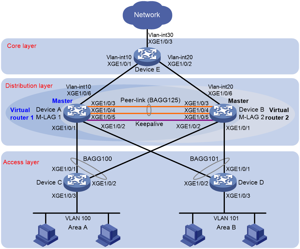

Example: Configuring M-LAG at the distribution Layer
As shown in Figure 2:
·     Configure Device A and Device B as an M-LAG system to establish one multichassis aggregate link with Device C and Device D.
·     Configure two VRRP groups on Device A and Device B to provide gateway services for VLAN 100 and VLAN 101.
¡     Configure VRRP group 1 to provide gateway services for hosts in VLAN 100 (Area A). Add Device A and Device B to the group as the master and backup devices, respectively.
¡     Configure VRRP group 2 to provide gateway services for hosts in VLAN 101 (Area B). Add Device B and Device A to the group as the master and backup devices, respectively.
·     Configure OSPF on Device A, Device B, and Device E for the hosts to communicate with external networks at Layer 3.
Figure 2 Network diagram
Device
Interface
IP address
Device
Interface
IP address
Device A
XGE 1/0/5
1.1.1.1/24
Device B
XGE 1/0/5
1.1.1.2/24
VLAN-interface 100
100.1.1.1/24
VLAN-interface 100
100.1.1.2/24
VLAN-interface 101
101.1.1.1/24
VLAN-interface 101
101.1.1.2/24
VLAN-interface 10
10.1.1.1/24
VLAN-interface 20
20.1.1.1/24
Virtual IP 1
100.1.1.100/24
Virtual IP 1
100.1.1.100/24
Virtual IP 2
101.1.1.100/24
Virtual IP 2
101.1.1.100/24
Device E
VLAN-interface 10
10.1.1.2/24
VLAN-interface 20
20.1.1.2/24
VLAN-interface 30
30.1.1.1/24
Analysis
For Device A to be the master in VRRP group 1, assign it a higher priority than Device B. For Device B to be the master in VRRP group 2, assign it a higher priority than Device A.

Procedures
Configuring Device A
# Configure M-LAG system settings.
<DeviceA> system-view
[DeviceA] m-lag system-mac 1-1-1
Changing the system MAC might flap the intra-portal link and cause M-LAG system setup failure. Continue? [Y/N]:y
[DeviceA] m-lag system-number 1
Changing the system number might flap the intra-portal link and cause M-LAG system setup failure. Continue? [Y/N]:y
[DeviceA] m-lag system-priority 123
Changing the system priority might flap the intra-portal link and cause M-LAG system setup failure. Continue? [Y/N]:y
# Configure M-LAG keepalive packet parameters.
[DeviceA] m-lag keepalive ip destination 1.1.1.2 source 1.1.1.1
# Configure Ten-GigabitEthernet 1/0/5 as a routed (Layer 3) interface and assign the interface an IP address. The IP address will be used as the source IP address of keepalive packets.
[DeviceA] interface ten-gigabitethernet 1/0/5
[DeviceA-Ten-GigabitEthernet1/0/5] port link-mode route
[DeviceA-Ten-GigabitEthernet1/0/5] ip address 1.1.1.1 24
[DeviceA-Ten-GigabitEthernet1/0/5] quit
# Exclude the interface used for M-LAG keepalive detection (Ten-GigabitEthernet 1/0/5) from the shutdown action by M-LAG MAD.
[DeviceA] m-lag mad exclude interface ten-gigabitethernet 1/0/5
# Create Layer 2 dynamic aggregate interface Bridge-Aggregation 125.
[DeviceA] interface bridge-aggregation 125
[DeviceA-Bridge-Aggregation125] link-aggregation mode dynamic
[DeviceA-Bridge-Aggregation125] quit
# Assign Ten-GigabitEthernet 1/0/3 and Ten-GigabitEthernet 1/0/4 to aggregation group 125.
[DeviceA] interface ten-gigabitethernet 1/0/3
[DeviceA-Ten-GigabitEthernet1/0/3] port link-aggregation group 125
[DeviceA-Ten-GigabitEthernet1/0/3] quit
[DeviceA] interface ten-gigabitethernet 1/0/4
[DeviceA-Ten-GigabitEthernet1/0/4] port link-aggregation group 125
[DeviceA-Ten-GigabitEthernet1/0/4] quit
# Specify Bridge-Aggregation 125 as the peer-link interface.
[DeviceA-Bridge-Aggregation125] port m-lag peer-link 1
# Create Layer 2 dynamic aggregate interface Bridge-Aggregation 100 and assign it to M-LAG group 1.
[DeviceA] interface bridge-aggregation 100
[DeviceA-Bridge-Aggregation100] link-aggregation mode dynamic
[DeviceA-Bridge-Aggregation100] port m-lag group 1
[DeviceA-Bridge-Aggregation100] quit
# Assign Ten-GigabitEthernet 1/0/1 to aggregation group 100.
[DeviceA] interface ten-gigabitethernet 1/0/1
[DeviceA-Ten-GigabitEthernet1/0/1] port link-aggregation group 100
[DeviceA-Ten-GigabitEthernet1/0/1] quit
# Create Layer 2 dynamic aggregate interface Bridge-Aggregation 101 and assign it to M-LAG group 2.
[DeviceA] interface bridge-aggregation 101
[DeviceA-Bridge-Aggregation101] link-aggregation mode dynamic
[DeviceA-Bridge-Aggregation101] port m-lag group 2
[DeviceA-Bridge-Aggregation101] quit
# Assign Ten-GigabitEthernet 1/0/2 to aggregation group 101.
[DeviceA] interface ten-gigabitethernet 1/0/2
[DeviceA-Ten-GigabitEthernet1/0/2] port link-aggregation group 101
[DeviceA-Ten-GigabitEthernet1/0/2] quit
# Create VLAN 10, VLAN 100, and VLAN 101.
[DeviceA] vlan 10
[DeviceA-vlan10] quit
[DeviceA] vlan 100
[DeviceA-vlan100] quit
[DeviceA] vlan 101
[DeviceA-vlan101] quit
# Assign Ten-GigabitEthernet 1/0/6 to VLAN 10.
[DeviceA] vlan 10
[DeviceA-vlan10] port ten-gigabitethernet 1/0/6
# Set the link type of Bridge-Aggregation 100 to trunk and assign it to VLAN 100.
[DeviceA-Bridge-Aggregation100] port link-type trunk
[DeviceA-Bridge-Aggregation100] port trunk permit vlan 100
# Set the link type of Bridge-Aggregation 101 to trunk and assign it to VLAN 101.
[DeviceA-Bridge-Aggregation101] port link-type trunk
[DeviceA-Bridge-Aggregation101] port trunk permit vlan 101
# Create VLAN-interface 10, VLAN-interface 100, and VLAN-interface 101 and assign an IP address to each of them.
[DeviceA] interface vlan-interface 10
[DeviceA-vlan-interface10] ip address 10.1.1.1 24
[DeviceA-vlan-interface10] quit
[DeviceA] interface vlan-interface 100
[DeviceA-vlan-interface100] ip address 100.1.1.1 24
[DeviceA-vlan-interface100] quit
[DeviceA] interface vlan-interface 101
[DeviceA-vlan-interface101] ip address 101.1.1.1 24
[DeviceA-vlan-interface101] quit
# Configure OSPF.
[DeviceA] ospf
[DeviceA-ospf-1] area 0
[DeviceA-ospf-1-area-0.0.0.0] network 10.1.1.0 0.0.0.255
[DeviceA-ospf-1-area-0.0.0.0] network 100.1.1.0 0.0.0.255
[DeviceA-ospf-1-area-0.0.0.0] network 101.1.1.0 0.0.0.255
[DeviceA-ospf-1-area-0.0.0.0] quit
[DeviceA-ospf-1] quit
# Create VRRP group 1 on VLAN-interface 100 and set its virtual IP address to 100.1.1.100.
[DeviceA-Vlan-interface100] vrrp vrid 1 virtual-ip 100.1.1.100
# Set the priority of Device A to 200 for it to become the master in VRRP group 1.
[DeviceA-Vlan-interface100] vrrp vrid 1 priority 200
[DeviceA-Vlan-interface100] quit
# Create VRRP group 2 on VLAN-interface 101 and set its virtual IP address to 101.1.1.100.
[DeviceA-Vlan-interface101] vrrp vrid 2 virtual-ip 101.1.1.100
[DeviceA-Vlan-interface101] quit
# Configure Device A to operate in preemptive mode in VRRP group 1. Set the preemption delay to 500 centiseconds to avoid frequent status switchover.
[DeviceA-Vlan-interface100] vrrp vrid 1 preempt-mode delay 500
# Create track entry 1 to monitor the upstream link status of Ten-GigabitEthernet 1/0/6.
[DeviceA] track 1 interface ten-gigabitethernet 1/0/6
# Configure Device A in VRRP group 1 to monitor track entry 1, and decrease its priority by 150 when the track entry transits to Negative.
[DeviceA-Vlan-interface100] vrrp vrid 1 track 1 priority reduced 150
Configuring Device B
<DeviceB> system-view
[DeviceB] m-lag system-mac 1-1-1
[DeviceB] m-lag system-number 2
[DeviceB] m-lag system-priority 123
[DeviceB] m-lag keepalive ip destination 1.1.1.1 source 1.1.1.2
[DeviceB] interface ten-gigabitethernet 1/0/5
[DeviceB-Ten-GigabitEthernet1/0/5] port link-mode route
[DeviceB-Ten-GigabitEthernet1/0/5] ip address 1.1.1.2 24
[DeviceB-Ten-GigabitEthernet1/0/5] quit
[DeviceB] m-lag mad exclude interface ten-gigabitethernet 1/0/5
[DeviceB] interface bridge-aggregation 125
[DeviceB-Bridge-Aggregation125] link-aggregation mode dynamic
[DeviceB-Bridge-Aggregation125] quit
[DeviceB] interface ten-gigabitethernet 1/0/3
[DeviceB-Ten-GigabitEthernet1/0/3] port link-aggregation group 125
[DeviceB-Ten-GigabitEthernet1/0/3] quit
[DeviceB] interface ten-gigabitethernet 1/0/4
[DeviceB-Ten-GigabitEthernet1/0/4] port link-aggregation group 125
[DeviceB-Ten-GigabitEthernet1/0/4] quit
[DeviceB-Bridge-Aggregation125] port m-lag peer-link 1
[DeviceB] interface bridge-aggregation 100
[DeviceB-Bridge-Aggregation100] link-aggregation mode dynamic
[DeviceB-Bridge-Aggregation100] port m-lag group 1
[DeviceB-Bridge-Aggregation100] quit
# Assign Ten-GigabitEthernet 1/0/2 to aggregation group 100.
[DeviceB-Ten-GigabitEthernet1/0/2] port link-aggregation group 100
[DeviceB] interface bridge-aggregation 101
[DeviceB-Bridge-Aggregation101] link-aggregation mode dynamic
[DeviceB-Bridge-Aggregation101] port m-lag group 2
[DeviceB-Bridge-Aggregation101] quit
# Assign Ten-GigabitEthernet 1/0/1 to aggregation group 101.
[DeviceB-Ten-GigabitEthernet1/0/1] port link-aggregation group 101
# Create VLAN 20, VLAN 100, and VLAN 101.
[DeviceB] vlan 20
[DeviceB-vlan20] quit
[DeviceB] vlan 100
[DeviceB-vlan100] quit
[DeviceB] vlan 101
[DeviceB-vlan101] quit
# Assign Ten-GigabitEthernet 1/0/6 to VLAN 20.
[DeviceB] vlan 20
[DeviceB-vlan20] port ten-gigabitethernet 1/0/6
[DeviceB-Bridge-Aggregation100] port link-type trunk
[DeviceB-Bridge-Aggregation100] port trunk permit vlan 100
[DeviceB-Bridge-Aggregation101] port link-type trunk
[DeviceB-Bridge-Aggregation101] port trunk permit vlan 101
# Create VLAN-interface 20, VLAN-interface 100, and VLAN-interface 101 and assign an IP address to each of them.
[DeviceB] interface vlan-interface 20
[DeviceB-vlan-interface20] ip address 20.1.1.1 24
[DeviceB-vlan-interface20] quit
[DeviceB] interface vlan-interface 100
[DeviceB-vlan-interface100] ip address 100.1.1.2 24
[DeviceB-vlan-interface100] quit
[DeviceB] interface vlan-interface 101
[DeviceB-vlan-interface101] ip address 101.1.1.2 24
[DeviceB-vlan-interface101] quit
# Configure OSPF.
[DeviceB] ospf
[DeviceB-ospf-1] area 0
[DeviceB-ospf-1-area-0.0.0.0] network 20.1.1.0 0.0.0.255
[DeviceB-ospf-1-area-0.0.0.0] network 100.1.1.0 0.0.0.255
[DeviceB-ospf-1-area-0.0.0.0] network 101.1.1.0 0.0.0.255
[DeviceB-ospf-1-area-0.0.0.0] quit
[DeviceB-ospf-1] quit
[DeviceB-Vlan-interface100] vrrp vrid 1 virtual-ip 100.1.1.100
[DeviceB-Vlan-interface100] quit
[DeviceB-Vlan-interface101] vrrp vrid 2 virtual-ip 101.1.1.100
# Set the priority of Device B to 200 for it to become the master in VRRP group 2.
[DeviceB-Vlan-interface101] vrrp vrid 2 priority 200
# Configure Device B to operate in preemptive mode in VRRP group 2. Set the preemption delay to 500 centiseconds to avoid frequent status switchover.
[DeviceB-Vlan-interface101] vrrp vrid 2 preempt-mode delay 500
[DeviceB-Vlan-interface101] quit
# Create track entry 2 to monitor the upstream link status of Ten-GigabitEthernet 1/0/6.
[DeviceB] track 2 interface ten-gigabitethernet 1/0/6
# Configure Device B in VRRP group 2 to monitor track entry 2, and decrease its priority by 150 when the track entry transits to Negative.
[DeviceB-Vlan-interface101] vrrp vrid 2 track 2 priority reduced 150
# Create VLAN 100.
[DeviceC] vlan 100
[DeviceC] interface ten-gigabitethernet 1/0/3
[DeviceC-Ten-GigabitEthernet1/0/3] port access vlan 100
[DeviceC-Ten-GigabitEthernet1/0/3] quit
# Create Layer 2 dynamic aggregate interface Bridge-Aggregation 100.
[DeviceC] interface bridge-aggregation 100
[DeviceC-Bridge-Aggregation100] link-aggregation mode dynamic
[DeviceC-Bridge-Aggregation100] quit
# Assign Ten-GigabitEthernet 1/0/1 and Ten-GigabitEthernet 1/0/2 to aggregation group 100.
[DeviceC-if-range] port link-aggregation group 100
[DeviceC-Bridge-Aggregation100] port link-type trunk
[DeviceC-Bridge-Aggregation100] port trunk permit vlan 100
# Create VLAN 101.
[DeviceD] vlan 101
[DeviceD-vlan101] quit
# Assign Ten-GigabitEthernet 1/0/3 to VLAN 101.
[DeviceD] interface ten-gigabitethernet 1/0/3
[DeviceD-Ten-GigabitEthernet1/0/3] port access vlan 101
[DeviceD-Ten-GigabitEthernet1/0/3] quit
# Create Layer 2 dynamic aggregate interface Bridge-Aggregation 101.
[DeviceD] interface bridge-aggregation 101
[DeviceD-Bridge-Aggregation101] link-aggregation mode dynamic
[DeviceD-Bridge-Aggregation101] quit
# Assign Ten-GigabitEthernet 1/0/1 and Ten-GigabitEthernet 1/0/2 to aggregation group 101.
[DeviceD-if-range] port link-aggregation group 101
[DeviceD-Bridge-Aggregation101] port link-type trunk
[DeviceD-Bridge-Aggregation101] port trunk permit vlan 101
# Create VLAN 10 and assign Ten-GigabitEthernet 1/0/1 to the VLAN.
[DeviceE] vlan 10
[DeviceE-vlan10] port ten-gigabitethernet 1/0/1
[DeviceE-vlan10] quit
# Create VLAN-interface 10 and assign it an IP address.
[DeviceE-vlan-interface10] ip address 10.1.1.2 24
[DeviceE-vlan-interface10] quit
# Create VLAN 20 and assign Ten-GigabitEthernet 1/0/2 to the VLAN.
[DeviceE] vlan 20
[DeviceE-vlan20] port ten-gigabitethernet 1/0/2
[DeviceE-vlan20] quit
# Create VLAN-interface 20 and assign it an IP address.
[DeviceE-vlan-interface20] ip address 20.1.1.2 24
[DeviceE-vlan-interface20] quit
[DeviceE] vlan 30
# Configure OSPF.
[DeviceE] ospf
[DeviceE-ospf-1] area 0
[DeviceE-ospf-1-area-0.0.0.0] network 10.1.1.0 0.0.0.255
[DeviceE-ospf-1-area-0.0.0.0] network 20.1.1.0 0.0.0.255
[DeviceE-ospf-1-area-0.0.0.0] network 30.1.1.0 0.0.0.255
[DeviceE-ospf-1-area-0.0.0.0] quit
[DeviceE-ospf-1] quit
Peer-link interface: BAGG125
BAGG100     1            UP                   UP          -
BAGG101     2            UP                   UP          -
Peer-link interface/Peer-link interface ID: BAGG125/1
State: UP
Cause: -
Local Selected ports (index): XGE1/0/3 (1), XGE1/0/4 (4)
Peer Selected ports indexes: 1, 4
M-LAG interface/M-LAG group ID: BAGG100/1
Local M-LAG interface LACP priority: Config=32768, Effective=123
Peer M-LAG interface LACP priority: Config=32768, Effective=123
M-LAG interface/M-LAG group ID: BAGG101/2
Local Selected ports (index): XGE1/0/2 (16387)
Peer Selected ports indexes: 32772
# Verify that all member ports of aggregation group 100 are in Selected state on Device C, which indicates a successful link aggregation between the M-LAG system and Device C.
[DeviceC] display link-aggregation verbose
Aggregate Interface: Bridge-Aggregation100
System ID: 0x8000, 8e33-8e4a-0300
Local:
Remote:
  XGE1/0/1(R)         32768    16386    40001    0x7b  , 0001-0001-0001 {ACDEF}
  XGE1/0/2            32768    32770    40001    0x7b  , 0001-0001-0001 {ACDEF}
# Verify that all member ports of aggregation group 101 are in Selected state on Device D, which indicates a successful link aggregation between the M-LAG system and Device D.
[DeviceD] display link-aggregation verbose
Aggregate Interface: Bridge-Aggregation101
System ID: 0x8000, 8e33-9400-0400
Local:
Remote:
  XGE1/0/1(R)         32768    16387    40002    0x7b  , 0001-0001-0001 {ACDEF}
  XGE1/0/2            32768    32771    40002    0x7b  , 0001-0001-0001 {ACDEF}
# Verify that Device A is the master in VRRP group 1 and Device B is the master in VRRP group 2.
[DeviceA] display vrrp
                                       Pri     Timer   Type        IP
 Vlan100            1     Master       200     100     None     100.1.1.100
 Vlan101            2     Backup       100     100     None     101.1.1.100
[DeviceB] display vrrp
                                       Pri     Timer   Type        IP
 Vlan100            1     Backup       100     100     None     100.1.1.100
 Vlan101            2     Master       200     100     None     101.1.1.100
# Verify that Device E has established OSPF neighbor relationships with Device A and Device B.
         OSPF Process 1 with Router ID 30.1.1.1
 Area: 0.0.0.0
 101.1.1.1       10.1.1.1        1   34         Full/DR           Vlan10
 101.1.1.2       20.1.1.1        1   36         Full/DR           Vlan20
# Verify that a host in Area A can ping the host at 101.1.1.4 in Area B.
C:\Documents and Settings\Administrator>ping 101.1.1.4
Pinging 101.1.1.4 with 32 bytes of data:
Reply from 101.1.1.4: bytes=32 time=1ms TTL=126
Ping statistics for 101.1.1.4:
# Verify that a host in Area A can ping VLAN-interface 30 (30.1.1.1) on Device E.
Configuration files
·     Device A:
ospf 1
 area 0.0.0.0
vlan 10
vlan 100 to 101
interface Bridge-Aggregation100
 port trunk permit vlan 1 100
 port m-lag group 1
interface Bridge-Aggregation101
 port trunk permit vlan 1 101
 port m-lag group 2
interface Bridge-Aggregation125
interface Vlan-interface101
 ip address 101.1.1.1 255.255.255.0
 port access vlan 10
 track 1 interface Ten-GigabitEthernet1/0/6
·     Device B:
ospf 1
 area 0.0.0.0
vlan 20
vlan 100 to 101
 port m-lag group 1
 port m-lag group 2
 ip address 101.1.1.2 255.255.255.0
 port access vlan 20
 track 2 interface Ten-GigabitEthernet1/0/6
·     Device C:
vlan 100
·     Device D:
vlan 101
·     Device E:
ospf 1
 area 0.0.0.0
vlan 10
vlan 20
vlan 30
 port access vlan 10
 port access vlan 20
 port access vlan 30
