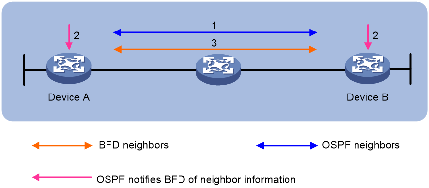

Figure 1 describes the operation of BFD for OSPF.
1.     OSPF discovers neighbors by sending Hello packets and establishes neighbor relationships.
2.     After establishing neighbor relationships, OSPF notifies BFD of the neighbor information, including destination and source addresses.
3.     BFD uses the information to establish BFD sessions.
Figure 1 BFD session establishment

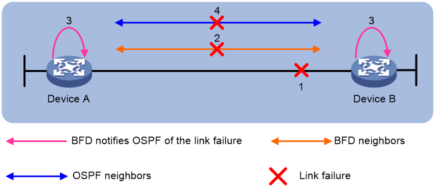

Figure 2 describes the BFD fault detection process.
1.     BFD detects a link failure and tears down the session.
2.     BFD notifies the neighbor unreachability to OSPF.
3.     OSPF terminates the neighbor relationship on the link.
Figure 2 BFD fault detection

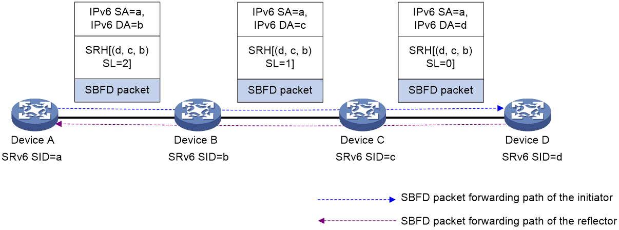

Configuring SBFD
About SBFD
Seamless BFD (SBFD) is a unidirectional failure detection mechanism that simplifies the BFD state machine and shortens the session negotiation time to provide shorter detection time than BFD. A SBFD session has only UP and DOWN states. SBFD is used in scenarios where only one end of a link requires failure detection.
An SBFD session involves the following roles:

Configuring the initiator for SRv6 TE policy detection
SBFD can detect the connectivity of an SRv6 TE policy and provides millisecond-level fault detection and fast fault switchover. In an SRv6 TE policy, the candidate path with the greatest preference value acts as the primary path and that with the second greatest preference value acts as the backup path. SBFD detects both primary and backup paths and all SID lists of each path. If all the SID lists for the primary path are faulty, SBFD triggers a primary-to-back path switchover.
As shown in Figure 5, configure an SRv6 TE policy on Device A and use SBFD to detect the SRv6 TE policy. The detection process is as follows:
1.     The source node (Device A, the initiator) sends SBFD control packets that encapsulate the SID lists of the primary and backup candidate paths of the SRv6 TE policy.
2.     After the destination node (Device D, the reflector) receives an SBFD control packet, it checks whether the remote discriminator carried the packet is the same as the local discriminator. If they are the same, the reflector sends the response SBFD control packet to the initiator according to the IPv6 routing table. If they are different, the reflector drops the SBFD control packet.
3.     If the source node receives the response SBFD control packet before the detection time expires, it considers the corresponding SID list (forwarding path) of the SRv6 TE policy available. Otherwise, the device considers the SID list faulty. If all the SID lists for the primary path are faulty, SBFD triggers a primary-to-back path switchover.
Figure 5 SRv6 TE policy association with SBFD
By default, when SBFD detects the connectivity of an SRv6 TE policy, the SBFD response packets are forwarded through IP paths. If an intermediate device fails and discards the response packets, the SBFD session will go down and SBFD will mistakenly consider the SID list as failed.
To solve the issue, configure a local BSID and reverse BSID in the SID list. This ensures that SBFD response packets are forwarded according to the specified SID list of SRv6 TE policy as follows:
1.     Configure a reverse BSID in SID list view on the source node and a local BSID in SID list view on the destination node. The reverse BSID and local BSID use the same value.
2.     When the source node sends an SBFD packet, it encapsulates the Aux Path TLV (auxiliary path TLV) for the SBFD packet. The TLV contains the reverse BSID.
3.     Upon receiving the SBFD packet, the destination node checks the reverse BSID. If it is the same as the local BSID, it encapsulates the SBFD response packet with an SRH header and forwards it along the SID list to which the local BSID belongs.
You can enable SBFD for all SRv6 TE policies globally in SRv6 TE view or for a specific SRv6 TE policy in SRv6 TE policy view. The policy-specific configuration takes precedence over the global configuration. An SRv6 TE policy uses the global configuration only when it has no policy-specific configuration.
When informing SBFD to establish an SBFD session, the SRv6 TE policy sends the source and destination IP addresses of the packet to SBFD. The source IP address is specified by the sbfd source-ipv6 command. To configure SRv6 TE policy detection, make sure the remote device has a route to the IPv6 address specified by the sbfd source-ipv6 command.
In the current software version, you can enable SRv6 TE policy detection through BFD echo packets or SBFD. If you configure both detection methods for the same SRv6 TE policy, SBFD takes effect.
For more information about the commands configured in SRv6 view, see SRv6 TE policy commands in Segment Routing Command Reference.

5.     Specify the Encap mode for the SBFD packets used for SRv6 forwarding paths connectivity detection.
bfd srv6-encapsulation-mode encap
By default, the device uses the Insert mode to encapsulate the BFD or SBFD packets for SRv6 forwarding paths connectivity detection.
