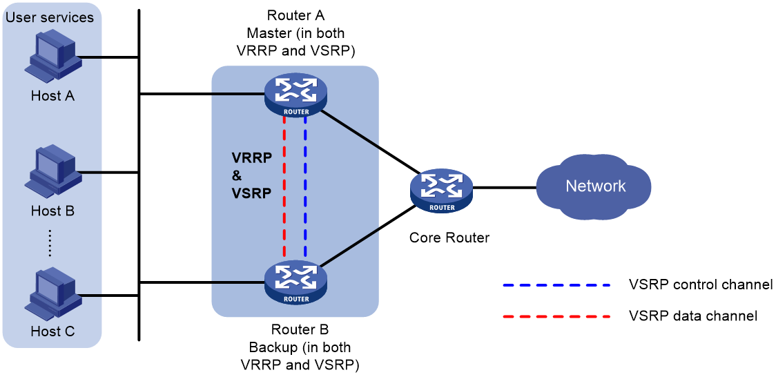

VRRP collaboration
As shown in Figure 1, VSRP determines the roles of the peer devices in the VSRP group in consistent with their roles in the VRRP group. The master forwards traffic and backs up the services to the backup device either at a regular interval or when traffic reaches the specified threshold. When the master in the VSRP group fails, the backup takes over to ensure service continuity. For more information about VRRP, see "Configuring VRRP."
Figure 1 VSRP-VRRP collaboration

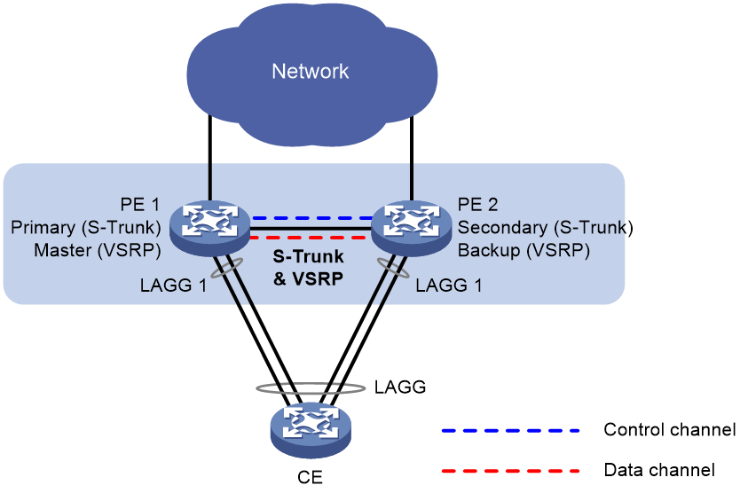

S-Trunk collaboration
To use S-Trunk together with VSRP, you must configure the same smart trunk on the peers in a VSRP group. As shown in Figure 2, VSRP determines the roles of the peer devices in the VSRP group based on their roles in the S-Trunk system. The VSRP master is the primary S-Trunk member device, and the VSRP backup is the secondary S-Trunk member device. The master forwards traffic and backs up the services to the backup device. When the master in the VSRP group fails, the backup takes over to ensure service continuity. For more information about S-Trunk, see "Configuring S-Trunk."
Figure 2 VSRP-S-Trunk collaboration

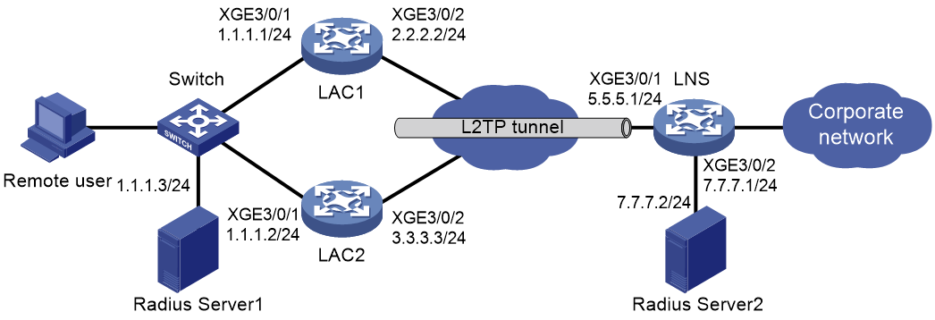

You can use VSRP to back up L2TP tunnels and sessions from a master LAC to a backup LAC by associating a LAC-mode L2TP group with a VSRP instance.
When the master LAC fails, the backup takes over the L2TP services to ensure service continuity.

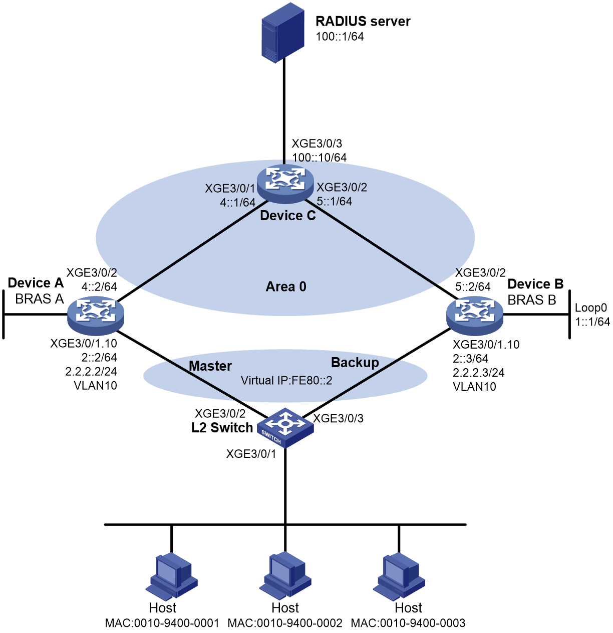

VSRP configuration examples

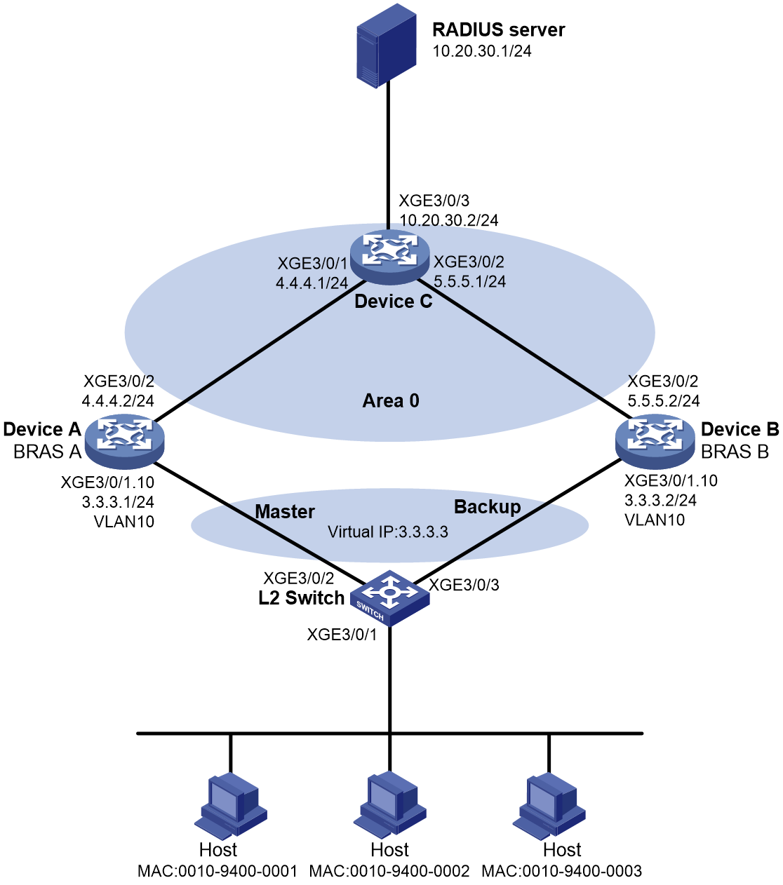

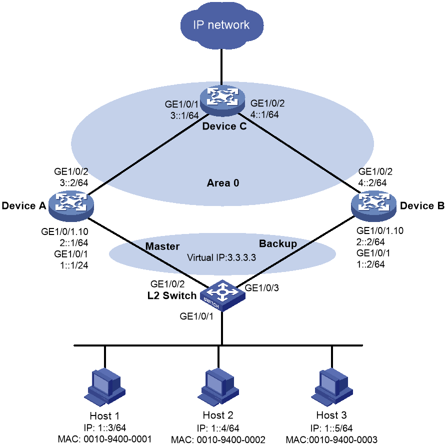

Example: Configuring VSRP for IPoE (IPv4 address pool)
The hosts use IPoE to access the BRAS devices (Device A and Device B). The two BRAS devices are in a VSRP group. IPv4 address pool 1 is enabled on the BRAS devices. The hosts obtain IP addresses through DHCP from the master. Perform the following tasks:

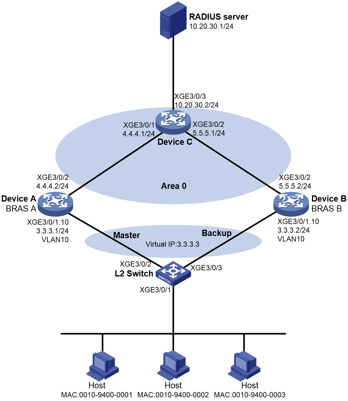

·     Enable IPoE and enable the DHCPv4 user on Ten-GigabitEthernet 3/0/1 of both Device A and Device B.
·     Create VRRP group 1 on Ten-GigabitEthernet 3/0/1.10, and configure the subinterface to terminate VLAN-tagged packets whose outermost VLAN ID is 10.
·     Enable OSPF on Device A and Device B to ensure that they can learn and advertise routes on their uplinks.
·     Enable VSRP for IPoE to back up IPoE sessions in real time.
·     Use the RADIUS server for authentication, authorization, and accounting of IPoE users.
Figure 3 Network diagram
1.     Assign IP addresses to interfaces, as shown in Figure 3. (Details not shown.)
2.     Configure the RADIUS server (this example uses a FreeRADIUS server that runs on Linux):
# Add the NAS IP address and shared key configuration to the clients.conf configuration file. (The NAS IP addresses for the two clients are 4.4.4.2 and 5.5.5.2, respectively, and the shared key is radius.)
client 4.4.4.2/32 {
ipaddr = 4.4.4.2
netmask=32
secret=radius
client 5.5.5.2/32 {
ipaddr = 5.5.5.2
netmask=32
secret=radius
# Add the IPoE user configuration to the users file. (The MAC addresses of the three IPoE users are 0010-9400-0001, 0010-9400-0002, and 0010-9400-0003. The password is radius, and the name of the authorized address pool is 1.)
001094000001  Cleartext-Password :="radius"
              Framed-Pool = 1
001094000002  Cleartext-Password :="radius"
              Framed-Pool = 1
001094000003  Cleartext-Password :="radius"
              Framed-Pool = 1
3.     Configure Device A:
¡     Configure a RADIUS scheme:
# Create a RADIUS scheme named rs1 and enter RADIUS scheme view.
<DeviceA> system-view
[DeviceA] radius scheme rs1
# Specify the primary authentication server and primary accounting server.
[DeviceA-radius-rs1] primary authentication 10.20.30.1
[DeviceA-radius-rs1] primary accounting 10.20.30.1
# Set the shared key for secure RADIUS authentication and accounting communication.
[DeviceA-radius-rs1] key authentication simple radius
[DeviceA-radius-rs1] key accounting simple radius
# Configure Device A to remove the domain name in the username sent to the RADIUS servers for RADIUS scheme rs1.
[DeviceA-radius-rs1] user-name-format without-domain
# Specify the source IP address as 3.3.3.3 (the gateway address for the hosts) for outgoing RADIUS packets.
[DeviceA-radius-rs1] nas-ip 3.3.3.3
[DeviceA-radius-rs1] quit
# Enable the session-control feature.
[DeviceA] radius session-control enable
¡     Configure an authentication domain:
# Create ISP domain dm1 and enter ISP domain view.
[DeviceA] domain name dm1
# Configure the domain to use RADIUS scheme rs1 for authentication, authorization, and accounting for IPoE users.
[DeviceA-isp-dm1] authentication ipoe radius-scheme rs1
[DeviceA-isp-dm1] authorization ipoe radius-scheme rs1
[DeviceA-isp-dm1] accounting ipoe radius-scheme rs1
[DeviceA-isp-dm1] quit
¡     Configure the DHCP server:
# Enable DHCP, and configure an IPv4 address pool.
[DeviceA] dhcp enable
[DeviceA] dhcp server request-ip-address check
[DeviceA] ip pool 1
[DeviceA-ip-pool-1] network 3.3.3.0 mask 255.255.255.0 export-route
[DeviceA-ip-pool-1] gateway-list 3.3.3.3 export-route
[DeviceA-ip-pool-1] vsrp-instance vs1
[DeviceA-ip-pool-1] forbidden-ip 3.3.3.1 3.3.3.2 3.3.3.3
[DeviceA-ip-pool-1] quit
¡     Configure a VRRP group:
# Enter the view of interface Ten-GigabitEthernet 3/0/1.10.
[DeviceA] interface ten-gigabitethernet 3/0/1.10
# Create VRRP group 1 and set its virtual IP address to 3.3.3.3.
[DeviceA–Ten-GigabitEthernet3/0/1.10] vrrp vrid 1 virtual-ip 3.3.3.3
# Configure Ten-GigabitEthernet3/0/1.10 to terminate VLAN 10.
[DeviceA-Ten-GigabitEthernet3/0/1.10] vlan-type dot1q vid 10
# Set the priority of Device A to 250 in VRRP group 1. Device A is assigned a higher priority than Device B in VRRP group 1, so Device A can become the master.
[DeviceA-Ten-GigabitEthernet3/0/1.10] vrrp vrid 1 priority 250
# Configure Device A to operate in preemptive mode, and set the preemption delay to 90000 centiseconds (15 minutes). When the original master recovers, it has 15 minutes to synchronize data from the new master before switch-back to ensure stability and data consistency of the VRRP group.
[DeviceA–Ten-GigabitEthernet3/0/1.10] vrrp vrid 1 preempt-mode delay 90000
[DeviceA–Ten-GigabitEthernet3/0/1.10] quit
# Create track entry 1 to monitor the link status of uplink interface Ten-GigabitEthernet 3/0/2. When the uplink fails, the track entry transits to Negative state.
[DeviceA] track 1 interface ten-gigabitethernet 3/0/2
# Associate VRRP group 1 with track entry 1, and decrease the device priority by 200 when the state of track entry 1 changes to Negative.
[DeviceA-Ten-GigabitEthernet3/0/1.10] vrrp vrid 1 track 1 priority reduced 200
[DeviceA-Ten-GigabitEthernet3/0/1.10] quit
¡     Configure VSRP instance vs1:
# Create VSRP group pr1 and enter VSRP peer view.
[DeviceA] vsrp peer pr1
# Specify the local IP address as 4.4.4.2 and the peer IP address as 5.5.5.2 for VSRP to establish VSRP channels. The default TCP port number for the control channel is used.
[DeviceA-vsrp-peer-pr1] peer 5.5.5.2 local 4.4.4.2
[DeviceA-vsrp-peer-pr1] quit
# Create VSRP instance vs1 and enter its view.
[DeviceA] vsrp instance vs1
# Associate VSRP instance vs1 with VSRP group pr1 and set its backup ID to 1.
[DeviceA-vsrp-instance-vs1] backup id 1 peer pr1
# Bind VSRP instance vs1 to VRRP group 1 on Ten-GigabitEthernet 3/0/1.10.
[DeviceA-vsrp-instance-vs1] bind vrrp vrid 1 interface ten-gigabitethernet 3/0/1.10
# Specify the logical NAS IP address as 3.3.3.3.
[DeviceA-vsrp-instance-vs1] nas ip 3.3.3.3
# Specify the logical interface as Ten-GigabitEthernet3/0/2.
[DeviceA-vsrp-instance-vs1] nas port ten-gigabitethernet 3/0/2
[DeviceA-vsrp-instance-vs1] quit
¡     Configure IPoE authentication:
# Enable IPoE and specify Layer 2 access mode.
[DeviceA–Ten-GigabitEthernet3/0/1] ip subscriber l2-connected enable
# Configure ISP domain dm1 for DHCPv4 users.
[DeviceA–Ten-GigabitEthernet3/0/1] ip subscriber dhcp domain dm1
# Set the password to radius in plain text for the dynamic IPoE users.
[DeviceA–Ten-GigabitEthernet3/0/1] ip subscriber password plaintext radius
# Associate the interface with VSRP instance vs1.
[DeviceA–Ten-GigabitEthernet3/0/1] bras vsrp-instance vs1
[DeviceA–Ten-GigabitEthernet3/0/1] dhcp vsrp-instance vs1
[DeviceA–Ten-GigabitEthernet3/0/1] quit
# Specify TCP port 1025 for VSRP to establish data channels for IPoE session backup.
[DeviceA] bras vsrp-port 1025
¡     Configure OSPF:
# Enable OSPF process 1 and set its router ID to 4.4.4.2 (the IP address of Ten-GigabitEthernet 3/0/2).
[DeviceA] ospf 1 router-id 4.4.4.2
# Configure OSPF to redistribute the user network route filtered by routing policy 1. Device A then advertises the user network route destined for the subnet where the hosts reside to Device C. In this way, Device C can select the route to a host based on the state of Device A and Device B in the VSRP instance.
[DeviceA-ospf-1] import-route unr inherit-cost route-policy 1
[DeviceA-ospf-1] quit
# Configure routing policy 1 to permit routes destined for network 3.3.3.0/24.
[DeviceA] ip prefix-list 1 permit 3.3.3.0 24
[DeviceA] route-policy 1 permit node 1
[DeviceA-route-policy-1-1] if-match ip address prefix-list 1
[DeviceA-route-policy-1-1] quit
# Configure Area 0.
[DeviceA] ospf
[DeviceA-ospf-1] area 0.0.0.0
[DeviceA-ospf-1-area-0.0.0.0] network 4.4.4.0 0.0.0.255
4.     Configure Device B:
<DeviceB> system-view
[DeviceB] radius scheme rs1
[DeviceB-radius-rs1] primary authentication 10.20.30.1
[DeviceB-radius-rs1] primary accounting 10.20.30.1
[DeviceB-radius-rs1] key authentication simple radius
[DeviceB-radius-rs1] key accounting simple radius
# Configure Device B to remove the domain name in the username sent to the RADIUS servers for RADIUS scheme rs1.
[DeviceB-radius-rs1] user-name-format without-domain
[DeviceB-radius-rs1] nas-ip 3.3.3.3
[DeviceB-radius-rs1] quit
[DeviceB] radius session-control enable
[DeviceB] domain name dm1
[DeviceB-isp-dm1] authentication ipoe radius-scheme rs1
[DeviceB-isp-dm1] authorization ipoe radius-scheme rs1
[DeviceB-isp-dm1] accounting ipoe radius-scheme rs1
[DeviceB-isp-dm1] quit
[DeviceB] dhcp enable
[DeviceB] dhcp server request-ip-address check
[DeviceB] ip pool 1
[DeviceB-ip-pool-1] network 3.3.3.0 mask 255.255.255.0 export-route
[DeviceB-ip-pool-1] gateway-list 3.3.3.3 export-route
[DeviceB-ip-pool-1] vsrp-instance vs1
[DeviceB-ip-pool-1] forbidden-ip 3.3.3.1 3.3.3.2 3.3.3.3
[DeviceB-ip-pool-1] quit
[DeviceB] interface ten-gigabitethernet 3/0/1.10
[DeviceB–Ten-GigabitEthernet3/0/1.10] vrrp vrid 1 virtual-ip 3.3.3.3
# Configure Ten-GigabitEthernet 3/0/1.10 to terminate VLAN 10.
[DeviceB-Ten-GigabitEthernet3/0/1.10] vlan-type dot1q vid 10
# Set the priority of Device B to 200 in VRRP group 1. Device B is assigned a lower priority than Device A in VRRP group 1, so Device A can become the master.
[DeviceB-Ten-GigabitEthernet3/0/1.10] vrrp vrid 1 priority 200
[DeviceB–Ten-GigabitEthernet3/0/1.10] quit
¡     Configure an VSRP instance:
[DeviceB] vsrp peer pr1
# Specify the local IP address as 5.5.5.2 and the peer IP address as 4.4.4.2 for VSRP to establish VSRP channels. The default TCP port number for the control channel is used.
[DeviceB-vsrp-peer-pr1] peer 4.4.4.2 local 5.5.5.2
[DeviceB-vsrp-peer-pr1] quit
[DeviceB] vsrp instance vs1
[DeviceB-vsrp-instance-vs1] backup id 1 peer pr1
[DeviceB-vsrp-instance-vs1] bind vrrp vrid 1 interface ten-gigabitethernet 3/0/1.10
[DeviceB-vsrp-instance-vs1] nas ip 3.3.3.3
# Specify the logical interface as Ten-GigabitEthernet 3/0/2.
[DeviceB-vsrp-instance-vs1] nas port ten-gigabitethernet 3/0/2
[DeviceB-vsrp-instance-vs1] quit
[DeviceB–Ten-GigabitEthernet3/0/1] ip subscriber l2-connected enable
[DeviceB–Ten-GigabitEthernet3/0/1] ip subscriber dhcp domain dm1
[DeviceB–Ten-GigabitEthernet3/0/1] ip subscriber password plaintext radius
[DeviceB–Ten-GigabitEthernet3/0/1] bras vsrp-instance vs1
[DeviceB–Ten-GigabitEthernet3/0/1] dhcp vsrp-instance vs1
[DeviceB–Ten-GigabitEthernet3/0/1] quit
# Specify TCP port number 1025 for VSRP to establish data channels for IPoE session backup.
[DeviceB] bras vsrp-port 1025
¡     Configure OSPF:
# Enable OSPF process 1 and set its router ID to 5.5.5.2 (the IP address of Ten-GigabitEthernet 3/0/2).
[DeviceB] ospf 1 router-id 5.5.5.2
# Configure OSPF to redistribute the user network route filtered by routing policy 1. Device B then advertises the user network route destined for the subnet where the hosts reside to Device C. In this way, Device C can select the route to a host based on the state of Device A and Device B in the VSRP instance.
[DeviceB-ospf-1] import-route unr inherit-cost route-policy 1
[DeviceB-ospf-1] quit
[DeviceB] ip prefix-list 1 permit 3.3.3.0 24
[DeviceB] route-policy 1 permit node 1
[DeviceB-route-policy-1-1] if-match ip address prefix-list 1
[DeviceB-route-policy-1-1] quit
# Configure Area 0.
[DeviceB] ospf
[DeviceB-ospf-1] area 0.0.0.0
[DeviceB-ospf-1-area-0.0.0.0] network 5.5.5.0 0.0.0.255
5.     Configure Device C:
# Enable OSPF process 1 and set its router ID to 4.4.4.1 (the IP address of Ten-GigabitEthernet 3/0/1).
<DeviceC> system-view
[DeviceC] ospf 1 router-id 4.4.4.1
# Configure OSPF Area 0.
[DeviceC-ospf-1] area 0.0.0.0
[DeviceC-ospf-1-area-0.0.0.0] network 4.4.4.0 0.0.0.255
[DeviceC-ospf-1-area-0.0.0.0] network 5.5.5.0 0.0.0.255
[DeviceC-ospf-1-area-0.0.0.0] quit
[DeviceC-ospf-1] quit
6.     Configure the L2 Switch:
¡     Create VLAN 10.
<L2Switch> system-view
[L2Switch] vlan 10
[L2Switch-vlan10] quit
¡     Configure VLAN settings on the interfaces that connect to Device A and Device B:
# Assign Ten-GigabitEthernet 3/0/2 to VLAN 10.
[L2Switch] interface ten-gigabitethernet 3/0/2
[L2Switch-Ten-GigabitEthernet3/0/2] port link-type trunk
[L2Switch-Ten-GigabitEthernet3/0/2] port trunk permit vlan 10
[L2Switch-Ten-GigabitEthernet3/0/2] quit
# Assign Ten-GigabitEthernet 3/0/3 to VLAN 10.
[L2Switch] interface ten-gigabitethernet 3/0/3
[L2Switch-Ten-GigabitEthernet3/0/3] port link-type trunk
[L2Switch-Ten-GigabitEthernet3/0/3] port trunk permit vlan 10
[L2Switch-Ten-GigabitEthernet3/0/3] quit
# Verify that Device A and Device B have the same IPoE user information about authenticated IPoE users.
·     On the master:
[DeviceA] display access-user
UserID   Interface                IP address          MAC address    S-/C-VLAN
         Username                 Access type
         IPv6 address
0x1      XGE3/0/1                3.3.3.4             0010-9400-0001  -/-
         00109400000              L2 IPoE dynamic(D/-)
0x2      XGE3/0/1                3.3.3.5             0010-9400-0002  -/-
         001094000002             L2 IPoE dynamic(D/-)
0x3      XGE3/0/1                3.3.3.6             0010-9400-0003  -/-
         001094000003             L2 IPoE dynamic(D/-)
·     On the backup:
[DeviceB] display access-user
         IPv6 address
         001094000001             L2 IPoE dynamic(D/-)

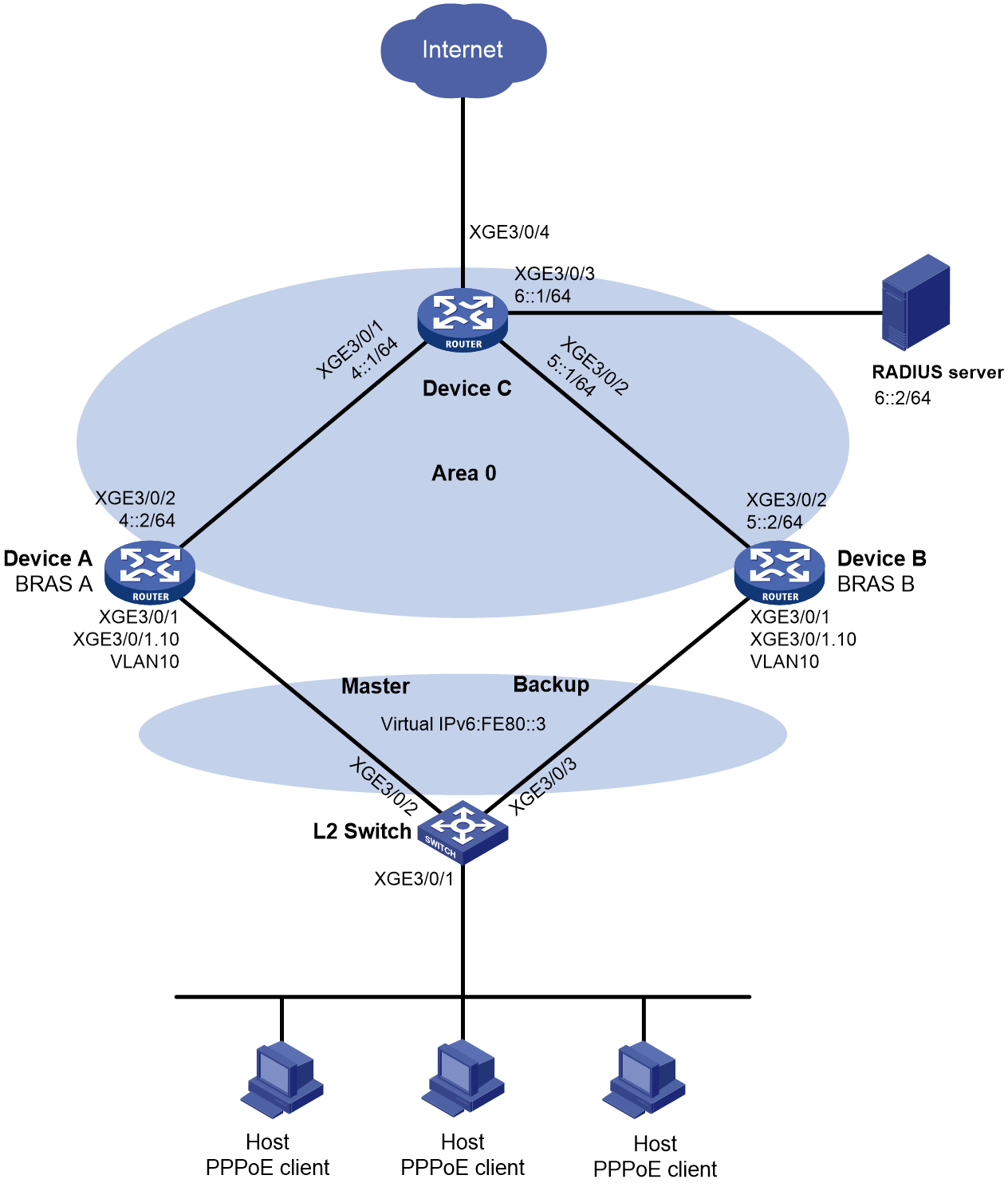

Example: Configuring VSRP for IPoE (IPv6 address pool)
The hosts use IPoE to access the BRAS devices (Device A and Device B). The two BRAS devices are in a VSRP group. IPv6 address pool 1 is enabled on the BRAS devices. The hosts obtain IP addresses through DHCP from the master. Perform the following tasks:
·     Enable IPoE and enable the DHCPv6 user on Ten-GigabitEthernet 3/0/1 of both Device A and Device B.
Figure 4 Network diagram
1.     Assign IPv6 addresses to interfaces, as shown in Figure 4. (Details not shown.)
# Add the NAS IP address and shared key configuration to the clients.conf configuration file. (The NAS IP addresses for the two clients are 4::2 and 5::2, respectively, and the shared key is radius.)
client 4::2/64 {
ipaddr = 4::2
netmask=64
secret=radius
client 5::2/64 {
ipaddr = 5::2
netmask=64
secret=radius
              Framed-Pool = 1
              Framed-Pool = 1
              Framed-Pool = 1
# Specify the primary authentication server and primary accounting server, and set the shared key for secure RADIUS authentication and accounting communication.
[DeviceA-radius-rs1] primary authentication ipv6 100::1
[DeviceA-radius-rs1] primary accounting ipv6 100::1
# Specify the source IPv6 address as 1::1 for outgoing RADIUS packets.
[DeviceA-radius-rs1] nas-ip ipv6 1::1
# Configure authentication, authorization, and accounting methods for IPoE users.
¡     Configure a loopback interface:
# Enable OSPFv3 process 1 and specify Area 0 on Loopback 0.
[DeviceA] interface loopback 0
[DeviceA-LoopBack0] ospfv3 1 area 0
# Set the OSPFv3 cost to 30 for Loopback 0. Make sure this enables the RADIUS server to choose the route to Loopback 0 based on the cost.
[DeviceA-LoopBack0] ospfv3 cost 30
[DeviceA-LoopBack0] quit
¡     Configure the DHCPv6 server:
# Enable DHCP.
# Enable DHCPv6 server on Ten-GigabitEthernet 3/0/1.
[DeviceA–Ten-GigabitEthernet3/0/1] ipv6 dhcp select server
# Disable RA message suppression on Ten-GigabitEthernet 3/0/1.
[DeviceA–Ten-GigabitEthernet3/0/1] undo ipv6 nd ra halt
# Set the M flag to 1 and the O flag to 1 in RA advertisements to be sent. The receiving hosts can obtain IPv6 addresses and other configuration information from the DHCPv6 server.
[DeviceA–Ten-GigabitEthernet3/0/1] ipv6 nd autoconfig managed-address-flag
[DeviceA–Ten-GigabitEthernet3/0/1] ipv6 nd autoconfig other-flag
# Create address pool 1.
[DeviceA] ipv6 pool 1
# Specify subnet 3::/64 in address pool 1 and advertise the subnet.
[DeviceA-ipv6-pool-1] network 3::/64 export-route
[DeviceA-ipv6-pool-1] gateway-list 3::1
# Associate IPv6 address pool 1 with VSRP instance vs1.
[DeviceA-ipv6-pool-1] vsrp-instance vs1
# Configure IPv6 address pool 1 to use the virtual DUID generated based on enterprise number 2 and identifier ff.
[DeviceA-ipv6-pool-1] virtual-duid enterprise-number 2 identifier ff
[DeviceA-ipv6-pool-1] quit
# Exclude IPv6 address 3::1 from dynamic allocation.
[DeviceA] ipv6 dhcp server forbidden-address 3::1
[DeviceA–Ten-GigabitEthernet3/0/1.10] vlan-type dot1q vid 10
# Create IPv6 VRRP group 1 and set its virtual IP address to fe80::2.
[DeviceA–Ten-GigabitEthernet3/0/1.10] vrrp ipv6 vrid 1 virtual-ip fe80::2 link-local
# Configure the interface to automatically generate a link-local address.
[DeviceA–Ten-GigabitEthernet3/0/1.10] ipv6 address auto link-local
# Set the priority of Device A to 250 in VRRP group 1 on GigabitEthernet 1/0/1.10. Device A is assigned a higher priority than Device B in VRRP group 1, so Device A can become the master.
[DeviceA-Ten-GigabitEthernet3/0/1.10] vrrp ipv6 vrid 1 priority 250
# Configure the IPv6 VRRP group to operate in preemptive mode, and set the preemption delay to 90000 centiseconds (15 minutes). When the original master recovers, it has 15 minutes to synchronize data from the new master before switch-back to ensure stability and data consistency of the VRRP group.
[DeviceA–Ten-GigabitEthernet3/0/1.10] vrrp ipv6 vrid 1 preempt-mode delay 90000
# Associate VRRP group 1 with track entry 1 and decrease the device priority by 200 when the state of track entry 1 changes to Negative.
[DeviceA-Ten-GigabitEthernet3/0/1.10] vrrp ipv6 vrid 1 track 1 priority reduced 200
¡     Configure a VSRP instance:
# Specify the local IP address as 4::2 and the peer IP address as 5::2 for VSRP to establish VSRP channels.
[DeviceA-vsrp-peer-pr1] peer ipv6 5::2 local 4::2
# Associate the VSRP instance with VSRP group pr1 and set its backup ID to 1.
# Bind VSRP instance vs1 to IPv6 VRRP group 1 on Ten-GigabitEthernet 3/0/1.10.
[DeviceA-vsrp-instance-vs1] bind vrrp ipv6 vrid 1 interface ten-gigabitethernet 3/0/1.10
# Specify the logical host name as abc.
[DeviceA-vsrp-instance-vs1] nas id abc
¡     Specify a virtual IPv6 address for the interface:
# Specify virtual IPv6 address of fe80::100 for the interface.
[DeviceA–Ten-GigabitEthernet3/0/1] ipv6 virtual-address fe80::100 vsrp vs1
# Configure ISP domain dm1 for DHCPv6 users.
[DeviceA–Ten-GigabitEthernet3/0/1] ipv6 dhcp vsrp-instance vs1
# Specify TCP port 1026 for VSRP to establish data channels for IPoE session backup.
[DeviceA] bras vsrp-port 1026
¡     Configure OSPFv3:
# Enable OSPFv3 process 1 and set its router ID to 1.1.1.1.
[DeviceA] ospfv3
[DeviceA-ospfv3-1]router-id 1.1.1.1
# Configure OSPFv3 to redistribute the user network route filtered by routing policy 1. Device A then advertises the user network route destined for the subnet where the hosts reside to Device C. In this way, Device C can select the route to a host based on the state of Device A and Device B in the VSRP instance.
[DeviceA-ospfv3-1] import-route unr inherit-cost route-policy 1
[DeviceA-ospfv3-1] quit
# Configure routing policy 1 to permit routes destined for network 3::/32.
[DeviceA] ipv6 prefix-list 1 permit 3:: 32
[DeviceA-route-policy-1-1] if-match ipv6 address prefix-list 1
# Enable OSPFv3 and specify Area 0 on Ten-GigabitEthernet 3/0/2.
[DeviceA] interface ten-gigabitethernet 3/0/2
[DeviceA–Ten-GigabitEthernet3/0/2] ospfv3 1 area 0
[DeviceA–Ten-GigabitEthernet3/0/2] quit
[DeviceB-radius-rs1] primary authentication ipv6 100::1
[DeviceB-radius-rs1] primary accounting ipv6 100::1
# Set the OSPFv3 cost to 100 for the interface. The RADIUS server can choose the route to the loopback interface based on the cost.
[DeviceB] interface loopback 0
[DeviceB-LoopBack0] ospfv3 1 area 0
[DeviceB-LoopBack0] ospfv3 cost 100
[DeviceB-LoopBack0] quit
# Enable DHCP.
[DeviceB–Ten-GigabitEthernet3/0/1] ipv6 dhcp select server
[DeviceB–Ten-GigabitEthernet3/0/1] undo ipv6 nd ra halt
[DeviceB–Ten-GigabitEthernet3/0/1] ipv6 nd autoconfig managed-address-flag
[DeviceB–Ten-GigabitEthernet3/0/1] ipv6 nd autoconfig other-flag
# Configure the address pool and gateway settings on the DHCPv6 server.
[DeviceB] ipv6 pool 1
[DeviceB-ipv6-pool-1] network 3::/64 export-route
[DeviceB-ipv6-pool-1] vsrp-instance vs1
[DeviceB-ipv6-pool-1] gateway-list 3::1
[DeviceB-ipv6-pool-1] virtual-duid enterprise-number 2 identifier ff
[DeviceB-ipv6-pool-1] quit
[DeviceB] ipv6 dhcp server forbidden-address 3::1
[DeviceB–Ten-GigabitEthernet3/0/1.10] vlan-type dot1q vid 10
[DeviceB–Ten-GigabitEthernet3/0/1.10] vrrp ipv6 vrid 1 virtual-ip fe80::2 link-local
[DeviceB–Ten-GigabitEthernet3/0/1.10] ipv6 address auto link-local
[DeviceB-Ten-GigabitEthernet3/0/1.10] vrrp ipv6 vrid 1 priority 200
# Specify the local IP address as 5::2 and the peer IP address as 4::2 for VSRP to establish VSRP channels.
[DeviceB-vsrp-peer-pr1] peer ipv6 4::2 local 5::2
[DeviceB-vsrp-instance-vs1] bind vrrp ipv6 vrid 1 interface ten-gigabitethernet 3/0/1.10
[DeviceB-vsrp-instance-vs1] nas id abc
[DeviceB–Ten-GigabitEthernet3/0/1] ipv6 virtual-address fe80::100 vsrp vs1

¡     Configure OSPFv3:
# Enable OSPFv3 process 1 and set its router ID to 2.2.2.2.
[DeviceB] ospfv3
[DeviceB-ospfv3-1]router-id 2.2.2.2
[DeviceB-ospfv3-1] import-route unr inherit-cost route-policy 1
[DeviceB-ospfv3-1] quit
[DeviceB] ipv6 prefix-list 1 permit 3:: 32
[DeviceB-route-policy-1-1] if-match ipv6 address prefix-list 1
[DeviceB] interface ten-gigabitethernet 3/0/2
[DeviceB–Ten-GigabitEthernet3/0/2] ospfv3 1 area 0
[DeviceB–Ten-GigabitEthernet3/0/2] quit
# Enable OSPFv3 process 1 and set its router ID to 3.3.3.3.
[DeviceC] ospfv3
[DeviceC-ospfv3-1] router-id 3.3.3.3
[DeviceC] interface ten-gigabitethernet 3/0/3
[DeviceC-Ten-GigabitEthernet3/0/3] ospfv3 1 area 0
[DeviceC-Ten-GigabitEthernet3/0/3] quit
[DeviceC] interface ten-gigabitethernet 3/0/1
[DeviceC–Ten-GigabitEthernet3/0/1] ospfv3 1 area 0
[DeviceC–Ten-GigabitEthernet3/0/1] quit
[DeviceC] interface ten-gigabitethernet 3/0/2
[DeviceC–Ten-GigabitEthernet3/0/2] ospfv3 1 area 0
[DeviceC–Ten-GigabitEthernet3/0/2] quit
¡     Create VLAN 10.
[L2Switch] vlan 10
·     On the master:
         IPv6 address
0x1      XGE3/0/1                -                   0010-9400-0001  -/-
         001094000001             L2 IPoE dynamic(-/D)
         3::1
0x2      XGE3/0/1                -                   0010-9400-0002  -/-
         001094000002             L2 IPoE dynamic(-/D)
         3::2
0x3      XGE3/0/1                -                   0010-9400-0003  -/-
         001094000003             L2 IPoE dynamic(-/D)
         3::3
·     On the backup:
         IPv6 address
         3::1
         3::2
         3::3
Example: Configuring VSRP for dual-stack IPoE (IPv4 and IPv6 address pools)
As shown in Figure 5, the hosts use IPoE to access BRAS A and BRAS B. The two BRAS devices are in a VSRP group. The hosts obtain IP addresses through DHCP from the master. Perform the following tasks:
·     Enable IPoE on Ten-GigabitEthernet 3/0/1 of both BRAS A and BRAS B.
·     Configure an IPv4 address pool and an IPv6 address pool on the BRAS devices.
·     Enable OSPF on BRAS A and BRAS B to ensure that they can learn and advertise routes on their uplinks.
Figure 5 Network diagram
1.     Assign IP addresses to interfaces, as shown in Figure 5. (Details not shown.)

[BRASA–Ten-GigabitEthernet3/0/1.10] vrrp ipv6 vrid 1 preempt-mode delay 90000
[BRASA–Ten-GigabitEthernet3/0/1.10] quit
[BRASA] track 1 interface ten-gigabitethernet 3/0/2
[BRASA-track-1] quit
[BRASA] interface ten-gigabitethernet 3/0/1.10
[BRASA-Ten-GigabitEthernet3/0/1.10] vrrp ipv6 vrid 1 track 1 priority reduced 200
[BRASA-Ten-GigabitEthernet3/0/1.10] vlan-type dot1q vid 10
[BRASA-Ten-GigabitEthernet3/0/1.10] quit
h.     Configure a VSRP instance:
When VSRP is enabled for IPoE, IPv4 and IPv6 users share a data backup channel. You can configure an IPv4 or IPv6 data backup channel for dual-stack IPoE. This example creates an IPv6 data backup channel.
[BRASA] vsrp peer pr1
[BRASA-vsrp-peer-pr1] peer ipv6 5::2 local 4::2
[BRASA-vsrp-peer-pr1] quit
[BRASA] vsrp instance vs1
[BRASA-vsrp-instance-vs1] backup id 1 peer pr1
[BRASA-vsrp-instance-vs1] bind vrrp ipv6 vrid 1 interface ten-gigabitethernet 3/0/1.10
[BRASA-vsrp-instance-vs1] nas id abc
[BRASA-vsrp-instance-vs1] nas port ten-gigabitethernet 3/0/2
# Enable route advertisement for the backup. Set the route costs for the master and the back to 20 and 30, respectively.
[BRASA-vsrp-instance-vs1] backup route-advertise master-cost 20 backup-cost 30
[BRASA-vsrp-instance-vs1] quit
i.     Specify a virtual IPv6 address for the ser access interface.
[BRASA–Ten-GigabitEthernet3/0/1] ipv6 virtual-address fe80::100 vsrp vs1
j.     Configure IPoE:
[BRASA–Ten-GigabitEthernet3/0/1] ip subscriber l2-connected enable
# Configure ISP domain dm1 for DHCP users.
[BRASA–Ten-GigabitEthernet3/0/1] ip subscriber dhcp domain dm1
# Configure the source MAC addresses as authentication usernames for DHCP users.
[BRASA–Ten-GigabitEthernet3/0/1] ip subscriber dhcp username include source-mac
# Set the password to 123456 in plain text for the dynamic IPoE users.
[BRASA–Ten-GigabitEthernet3/0/1] ip subscriber password plaintext 123456
[BRASA–Ten-GigabitEthernet3/0/1] bras vsrp-instance vs1
[BRASA–Ten-GigabitEthernet3/0/1] quit
5.     Configure BRAS B:
a.     Configure a RADIUS scheme:
<BRASB> system-view
[BRASB] radius scheme rs1
[BRASB-radius-rs1] primary authentication 6.6.6.2
[BRASB-radius-rs1] primary accounting 6.6.6.2
[BRASB-radius-rs1] key authentication simple 123456
[BRASB-radius-rs1] key accounting simple 123456
# Enable the accounting-on feature.
[BRASB-radius-rs1] accounting-on enable
# Specify the source IP address (the gateway address for the hosts) for outgoing RADIUS packets.
[BRASB-radius-rs1] nas-ip 3.3.3.3
[BRASB-radius-rs1] quit
b.     Configure DHCPv4 relay agent:
# Enable DHCP.
[BRASB] dhcp enable
# Enable recording client information in relay entries.
[BRASB] dhcp relay client-information record
# Configure remote BAS IPv4 address pool ipoev4 and associate the pool with VSRP instance vs1.
[BRASB] ip pool ipoev4
[BRASB-ip-pool-ipoev4] gateway-list 3.3.3.3 export-route
[BRASB-ip-pool-ipoev4] remote-server 6.6.6.3
[BRASB-ip-pool-ipoev4] vsrp-instance vs1
# Configure BRAS B to export the user network route for 3.3.3.0/24 to the routing table for OSPF to redistribute the user network route and advertise it to Device C. Device C uses the route to direct traffic of that subnet to BRAS B.
·     In this example, BRAS devices also act as DHCPv4 relay agents. The network 3.3.3.0 24 export-route command is used for OSPF route redistribution instead of IP address assignment.
·     The network 3.3.3.0 24 export-route command is configured on both the master and the backup of a VSRP instance. Only the master exports the route for that subnet. If the master becomes the backup, it deletes the exported route.
[BRASB-ip-pool-ipoev4] network 3.3.3.0 24 export-route
[BRASB-ip-pool-ipoev4] quit
# Associate Ten-GigabitEthernet 3/0/1 with VSRP instance vs1.
[BRASB] interface ten-gigabitethernet 3/0/1
[BRASB-Ten-GigabitEthernet3/0/1] dhcp relay vsrp-instance vs1
c.     Configure DHCPv6 relay agent:
# Disable RA message suppression on Ten-GigabitEthernet 3/0/1. Set the managed address configuration flag (M) to 1 and set the other stateful configuration flag (O) to 1 in RA advertisements to be sent.
[BRASB–Ten-GigabitEthernet3/0/1] undo ipv6 nd ra halt
[BRASB–Ten-GigabitEthernet3/0/1] ipv6 nd autoconfig managed-address-flag
[BRASB–Ten-GigabitEthernet3/0/1] ipv6 nd autoconfig other-flag
# Enable the DHCPv6 relay agent on Ten-GigabitEthernet 3/0/1.
[BRASB–Ten-GigabitEthernet3/0/1] ipv6 dhcp select relay
# Enable recording client information in DHCPv6 relay entries.
[BRASB–Ten-GigabitEthernet3/0/1] ipv6 dhcp relay client-information record
[BRASB–Ten-GigabitEthernet3/0/1] quit
# Configure remote BAS IPv6 address pool ipoev6 and associate the pool with VSRP instance vs1.
[BRASB] ipv6 pool ipoev6
[BRASB-ipv6-pool-ipoev6] gateway-list 3::3
[BRASB-ipv6-pool-ipoev6] remote-server 6::3
[BRASB-ipv6-pool-ipoev6] vsrp-instance vs1
# Configure BRAS B to export the user network route for 3::/64 to the routing table for OSPFv3 to redistribute the route and advertise it to Device C. Device C uses the route to direct traffic of that subnet to BRAS B.
·     In this example, BRAS devices also act as DHCPv6 relay agents. The network 3::/64 export-route command is used for OSPFv3 route redistribution instead of IP address assignment.
·     The network 3::/64 export-route command is configured on both the master and the backup of a VSRP instance. Only the master exports the route for that subnet. If the master becomes the backup, it deletes the exported route.
[BRASB-ipv6-pool-ipoev6] network 3::/64 export-route
[BRASB-ipv6-pool-ipoev6] quit
[BRASB–Ten-GigabitEthernet3/0/1] ipv6 dhcp relay vsrp-instance vs1
d.     Configure an authentication domain:
[BRASB] domain name dm1
[BRASB-isp-dm1] authentication ipoe radius-scheme rs1
[BRASB-isp-dm1] authorization ipoe radius-scheme rs1
[BRASB-isp-dm1] accounting ipoe radius-scheme rs1
# Configure an IPv4 address pool and an IPv6 address pool for users in the ISP domain.
[BRASB-isp-dm1] authorization-attribute ip-pool ipoev4
[BRASB-isp-dm1] authorization-attribute ipv6-pool ipoev6
[BRASB-isp-dm1] quit
e.     Configure OSPF:
# Enable OSPF process 1 and specify its router ID as the IP address of Ten-GigabitEthernet 3/0/1.10.
[BRASB] ospf 1 router-id 3.3.3.2
# Configure OSPF to redistribute the user network route filtered by routing policy 1. When BRAS B acts as the master and assigns an IP address to a host, it advertises the user network route destined for the subnet where the host resides to Device C. In this way, Device C can select the route to the host based on the state of BRAS A and BRAS B in the VSRP instance.
[BRASB-ospf-1] import-route unr inherit-cost route-policy 1
[BRASB-ospf-1] quit
# Configure routing policy 1 to permit routes destined for 3.3.3.0/24.
[BRASB] ip prefix-list 1 permit 3.3.3.0 24
[BRASB] route-policy 1 permit node 1
[BRASB-route-policy-1-1] if-match ip address prefix-list 1
[BRASB-route-policy-1-1] quit
# Configure Area 0.
[BRASB] ospf
[BRASB-ospf-1] area 0.0.0.0
[BRASB-ospf-1-area-0.0.0.0] network 5.5.5.0 0.0.0.255
[BRASB-ospf-1-area-0.0.0.0] quit
[BRASB-ospf-1] quit
f.     Configure OSPFv3:
# Enable OSPFv3 process 1 and set its router ID to 3.3.3.2.
[BRASB] ospfv3
[BRASB-ospfv3-1] router-id 3.3.3.2
# Configure OSPFv3 to redistribute the user network route filtered by routing policy 1. BRAS A then advertises the user network route destined for the subnet where the host resides to Device C. In this way, Device C can select the route to the host based on the state of BRAS A and BRAS B in the VSRP instance.
[BRASB-ospfv3-1] import-route unr inherit-cost route-policy 1
[BRASB-ospfv3-1] quit
# Configure routing policy 1 to permit routes destined for 3::/32.
[BRASB] ipv6 prefix-list 1 permit 3:: 32
[BRASB-route-policy-1-1] if-match ipv6 address prefix-list 1
[BRASB] interface ten-gigabitethernet 3/0/2
[BRASB–Ten-GigabitEthernet3/0/2] ospfv3 1 area 0
[BRASB–Ten-GigabitEthernet3/0/2] quit
g.     Configure an IPv6 VRRP group:
[BRASB] interface ten-gigabitethernet 3/0/1.10
# Create IPv6 VRRP group 1 and set its virtual IP address to fe80::3.
[BRASB–Ten-GigabitEthernet3/0/1.10] vrrp ipv6 vrid 1 virtual-ip fe80::3 link-local
[BRASB–Ten-GigabitEthernet3/0/1.10] ipv6 address auto link-local
# Set the priority of BRAS B to 200 in VRRP group 1. BRAS A is assigned a higher priority than BRAS B in VRRP group 1, so BRAS A can become the master.
[BRASB-Ten-GigabitEthernet3/0/1.10] vrrp ipv6 vrid 1 priority 200
[BRASB-Ten-GigabitEthernet3/0/1.10] vlan-type dot1q vid 10
[BRASB–Ten-GigabitEthernet3/0/1.10] quit
h.     Configure the track entry associated with a BFD session:
# Create track entry 2 and associate it with a BFD session.
[BRASB] track 2 bfd echo interface ten-gigabitethernet 3/0/1.10 remote ip 3.3.3.1 local ip 3.3.3.2
[BRASB-track-2] quit
# Associate IPv6 VRRP group 1 with track entry 2 and switch the master and the backup when the state of track entry 2 changes to Negative.
[BRASB–Ten-GigabitEthernet3/0/1.10] vrrp ipv6 vrid 1 track 2 switchover
i.     Configure a VSRP instance:
[BRASB] vsrp peer pr1
[BRASB-vsrp-peer-pr1] peer ipv6 4::2 local 5::2
[BRASB-vsrp-peer-pr1] quit
[BRASB] vsrp instance vs1
[BRASB-vsrp-instance-vs1] backup id 1 peer pr1
[BRASB-vsrp-instance-vs1] bind vrrp ipv6 vrid 1 interface ten-gigabitethernet 3/0/1.10
[BRASB-vsrp-instance-vs1] nas id abc
[BRASB-vsrp-instance-vs1] nas port ten-gigabitethernet 3/0/2
[BRASB-vsrp-instance-vs1] backup route-advertise master-cost 20 backup-cost 30
[BRASB-vsrp-instance-vs1] quit
j.     Specify a virtual IPv6 address for the user access interface.
[BRASB–Ten-GigabitEthernet3/0/1] ipv6 virtual-address fe80::100 vsrp vs1
k.     Configure IPoE:
[BRASB–Ten-GigabitEthernet3/0/1] ip subscriber l2-connected enable
[BRASB–Ten-GigabitEthernet3/0/1] ip subscriber dhcp domain dm1
[BRASB–Ten-GigabitEthernet3/0/1] ip subscriber dhcp username include source-mac
[BRASB–Ten-GigabitEthernet3/0/1] ip subscriber password plaintext 123456
[BRASB–Ten-GigabitEthernet3/0/1] bras vsrp-instance vs1
6.     Configure Device C:
a.     Configure OSPF:
# Enable OSPF process 1 and set its router ID to the IP address of Ten-GigabitEthernet 3/0/3.
[DeviceC] ospf 1 router-id 6.6.6.1
b.     Configure OSPFv3:
# Enable OSPFv3 process 1 and set its router ID to 6.6.6.1.
[DeviceC] ospfv3
[DeviceC-ospfv3-1] router-id 6.6.6.1
[DeviceC-ospfv3-1] quit
7.     Configure L2 Switch:
# Create VLAN 10.
[L2Switch] vlan 10

Example: Configuring VSRP for PPPoE (PPP address pool)
The host runs PPPoE client dialup software. To ensure service availability, enable VSRP for PPPoE on BRAS A (the master PPPoE server) and BRAS B (the backup PPPoE server). When BRAS A fails, BRAS B takes over the PPPoE services to avoid service interruption. Use the RADIUS server for authentication, authorization, and accounting of the PPPoE client.
Figure 6 Network diagram
1.     Assign IP addresses to interfaces, as shown in Figure 6. Configure routes for the host, the BRASs, the core router, and the RADIUS server to reach one another. (Details not shown.)
# Add the NAS IP address and shared key configuration to the clients.conf configuration file. (The NAS IP addresses for the three clients are 4.4.4.1, 6.6.6.1, and 5.5.5.1, and the shared key is radius.)
client 4.4.4.1/32 {
ipaddr = 4.4.4.1
netmask=24
secret=radius
client 6.6.6.1/32 {
ipaddr = 6.6.6.1
netmask=24
secret=radius
client 5.5.5.1/32 {
ipaddr = 5.5.5.100
netmask=24
secret=radius
# Add the PPPoE client configuration to the users file. (The username of the PPPoE client is user1, and the password is pass1.)
user1  Cleartext-Password :="pass1"
3.     Configure BRAS A:
# Assign an IP address to Ten-GigabitEthernet 3/0/1. Create VRRP group 1 and set its virtual IP address, and set the priority of the local device in the VRRP group.
<BRASA> system-view
[BRASA-Ten-GigabitEthernet3/0/1] ip address 5.5.5.98 255.255.255.0
[BRASA-Ten-GigabitEthernet3/0/1] vrrp vrid 1 virtual-ip 5.5.5.100
[BRASA-Ten-GigabitEthernet3/0/1] vrrp vrid 1 priority 105
# Configure BRAS A to operate in preemptive mode, and set the preemption delay to 90000 centiseconds (15 minutes). When the original master recovers, it has 15 minutes to synchronize data from the new master before switch-back to ensure stability and data consistency of the VRRP group.
[BRASA-Ten-GigabitEthernet3/0/1] vrrp vrid 1 preempt-mode delay 90000
[BRASA-Ten-GigabitEthernet3/0/1] quit
# Associate VRRP group 1 with track entry 1 and decrease the device priority by 100 when the state of track entry 1 changes to Negative.
[BRASA-Ten-GigabitEthernet3/0/1] vrrp vrid 1 track 1 priority reduced 100
# Create interface Loopback 1 and assign the interface an IP address of 1.1.1.1.
[BRASA] interface loopback 1
[BRASA-Loopback1] ip address 1.1.1.1 32
[BRASA-Loopback1] quit
# Create a VSRP group and specify the local and peer addresses for VSRP to establish VSRP channels.
[BRASA] vsrp peer 1
[BRASA-vsrp-peer-1] peer 2.2.2.2 local 1.1.1.1
[BRASA-vsrp-peer-1] quit
# Create VSRP instance 1 and associate it with VSRP group 1. Set the backup ID of the VSRP instance to 1.
[BRASA] vsrp instance 1
[BRASA-vsrp-instance-1] backup id 1 peer 1
# Bind VSRP instance 1 to VRRP group 1 and set VSRP instance 1 to operate in hot backup mode.
[BRASA-vsrp-instance-1] bind vrrp vrid 1 interface ten-gigabitethernet 3/0/1
[BRASA-vsrp-instance-1] backup mode hot
# Specify the logical NAS IP address as 5.5.5.1.
[BRASA-vsrp-instance-1] nas ip 5.5.5.1
[BRASA-vsrp-instance-1] nas port ten-gigabitethernet 3/0/2
[BRASA-vsrp-instance-1] quit
[BRASA] radius scheme rs1
[BRASA-radius-rs1] primary authentication 10.20.30.1
[BRASA-radius-rs1] primary accounting 10.20.30.1
[BRASA-radius-rs1] key authentication simple radius
[BRASA-radius-rs1] key accounting simple radius
# Configure BRAS A to remove the domain name in the username sent to the RADIUS servers for RADIUS scheme rs1.
[BRASA-radius-rs1] user-name-format without-domain
[BRASA-radius-rs1] nas-ip 5.5.5.1
[BRASA-radius-rs1] quit
[BRASA] radius session-control enable
[BRASA] domain name dm1
# Configure the domain to use RADIUS scheme rs1 for authentication, authorization, and accounting for PPP users.
[BRASA-isp-dm1] authentication ppp radius-scheme rs1
[BRASA-isp-dm1] authorization ppp radius-scheme rs1
[BRASA-isp-dm1] accounting ppp radius-scheme rs1
[BRASA-isp-dm1] authorization-attribute ip-pool pool1
[BRASA-isp-dm1] quit
¡     Configure PPPoE authentication:
# Configure local BAS IP pool pool1, and add the IP address range from 5.5.5.2 to 5.5.5.10 to the pool. Specify 5.5.5.1 as a gateway address in the IP pool. Associate the IP pool with VSRP instance 1.
[BRASA] ip pool pool1 bas local
[BRASA-ip-pool-pool1] address range 5.5.5.2 5.5.5.10
[BRASA-ip-pool-pool1] gateway 5.5.5.1 24
[BRASA-ip-pool-pool1] vsrp-instance 1
[BRASA-ip-pool-pool1] quit
# Specify TCP port 10000 as the TCP port for VSRP to establish data channels for PPP and PPPoE session backup.
[BRASA] bras vsrp-port 10000
# Create interface Virtual-Template 10 and assign it an IP address of 5.5.5.1.
[BRASA] interface virtual-template 10
[BRASA-Virtual-Template10] ip address 5.5.5.1 24
# Configure Virtual-Template 10 to use CHAP for authentication and use address pool pool1 to assign IP addresses.
[BRASA-Virtual-Template10] ppp authentication-mode chap domain dm1
[BRASA-Virtual-Template10] remote address pool pool1
[BRASA-Virtual-Template10] quit
# Enable a PPPoE server on Ten-GigabitEthernet 3/0/1 and bind Ten-GigabitEthernet 3/0/1 to interface Virtual-Template 10.
[BRASA-Ten-GigabitEthernet3/0/1] pppoe-server bind virtual-template 10
# Associate Ten-GigabitEthernet 3/0/1 with VSRP instance 1.
[BRASA-Ten-GigabitEthernet3/0/1] bras vsrp-instance 1
4.     Configure BRAS B:
<BRASB> system-view
[BRASB-Ten-GigabitEthernet3/0/1] ip address 5.5.5.99 255.255.255.0
[BRASB-Ten-GigabitEthernet3/0/1] vrrp vrid 1 virtual-ip 5.5.5.100
# Create interface Loopback 1 and assign the interface an IP address of 2.2.2.2.
[BRASB] interface loopback 1
[BRASB-Loopback1] ip address 2.2.2.2 32
[BRASB-Loopback1] quit
[BRASB] vsrp peer 1
[BRASB-vsrp-peer-1] peer 1.1.1.1 local 2.2.2.2
[BRASB-vsrp-peer-1] quit
[BRASB] vsrp instance 1
[BRASB-vsrp-instance-1] backup id 1 peer 1
[BRASB-vsrp-instance-1] bind vrrp vrid 1 interface ten-gigabitethernet 3/0/1
[BRASB-vsrp-instance-1] backup mode hot
[BRASB-vsrp-instance-1] nas ip 5.5.5.1
[BRASB-vsrp-instance-1] nas port ten-gigabitethernet 3/0/2
[BRASB-vsrp-instance-1] quit
[BRASB-radius-rs1] primary authentication 10.20.30.1
[BRASB-radius-rs1] primary accounting 10.20.30.1
[BRASB-radius-rs1] key authentication simple radius
[BRASB-radius-rs1] key accounting simple radius
# Configure BRAS B to remove the domain name in the username sent to the RADIUS servers for RADIUS scheme rs1.
[BRASB-radius-rs1] user-name-format without-domain
[BRASB-radius-rs1] nas-ip 5.5.5.1
[BRASB] radius session-control enable
a.     Configure an authentication domain:
[BRASB-isp-dm1] authentication ppp radius-scheme rs1
[BRASB-isp-dm1] authorization ppp radius-scheme rs1
[BRASB-isp-dm1] accounting ppp radius-scheme rs1
[BRASB-isp-dm1] authorization-attribute ip-pool pool1
[BRASB] ip pool pool1 bas local
[BRASB-ip-pool-pool1] address range 5.5.5.2 5.5.5.10
[BRASB-ip-pool-pool1] gateway 5.5.5.1 24
[BRASB-ip-pool-pool1] vsrp-instance 1
[BRASB-ip-pool-pool1] quit
[BRASB] bras vsrp-port 10000
[BRASB] interface virtual-template 10
[BRASB-Virtual-Template10] ip address 5.5.5.1 24
[BRASB-Virtual-Template10] ppp authentication-mode chap domain dm1
[BRASB-Virtual-Template10] remote address pool pool1
[BRASB-Virtual-Template10] quit
[BRASB-Ten-GigabitEthernet3/0/1] pppoe-server bind virtual-template 10
[BRASB-Ten-GigabitEthernet3/0/1] bras vsrp-instance 1
[BRASB-Ten-GigabitEthernet3/0/1] quit
1.     Enter username user1 and password pass1 on the PPPoE client software to initiate a connection request to the PPPoE server.
2.     Verify that BRAS A (the master) and BRAS B (the backup) have the same PPP and PPPoE sessions after the client accesses the network.
# Display PPP sessions synchronized by VSRP instances on BRAS A.
[BRASA] display access-user
         IPv6 address
0x1      XGE3/0/1                5.5.5.2             00e0-2984-90d2  -/-
         user1                    PPPoE users
# Display PPP sessions synchronized by VSRP instances on BRAS B.
[BRASB] display access-user
         Username                 IPv6 address        Access type
         IPv6 address
         user1                    PPPoE users
3.     Verify that BRAS B becomes the master and takes over the PPPoE services when BRAS A fails (for example, Ten-GigabitEthernet 3/0/1 is down).
         IPv6 address
         user1                    PPPoE users

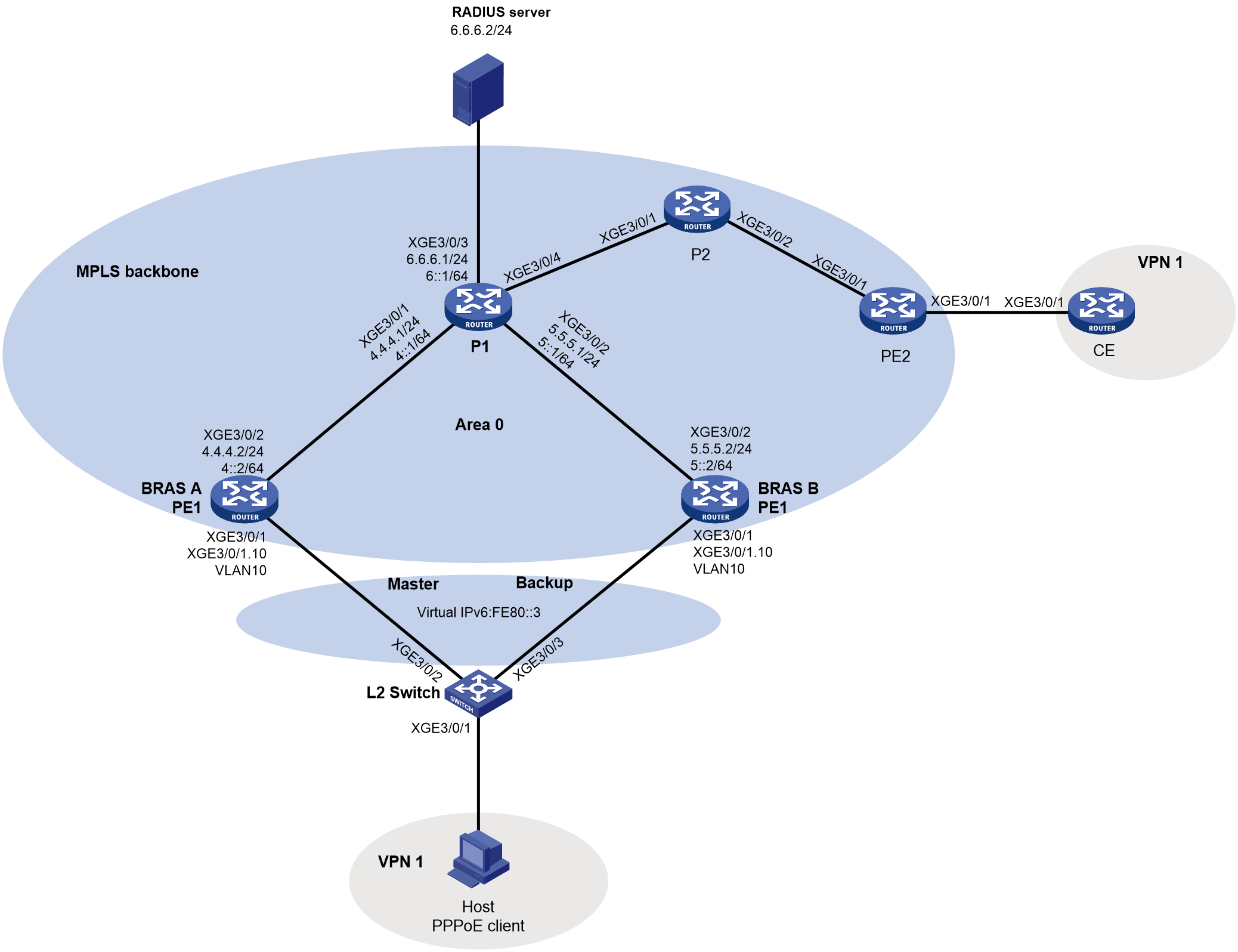

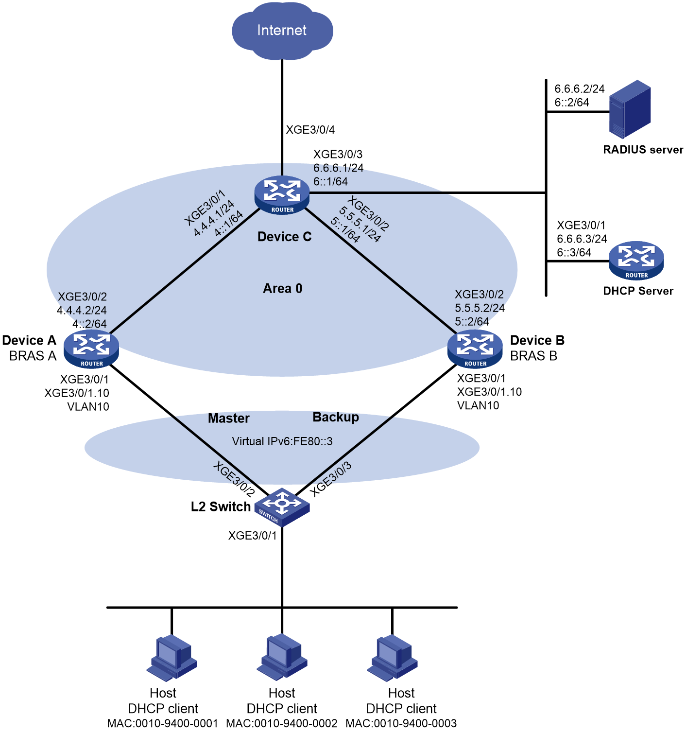

Example: Configuring VSRP for PPPoE (NDRA one prefix per user)
As shown in Figure 7, the hosts run PPPoE client dialup software. To ensure service availability, enable VSRP for PPPoE on BRAS A (the master PPPoE server) and BRAS B (the backup PPPoE server). When BRAS A fails, BRAS B takes over the PPPoE services to avoid service interruption. Perform the following tasks:
·     Configure NDRA for IPv6 address assignment on the BRAS devices. With NDRA configured, a host obtains an IPv6 prefix in an RA message. The host then generates an IPv6 global unicast address by combining the IPv6 prefix and the negotiated IPv6 interface identifier. The IPv6 prefix in the RA message is from a prefix pool.
·     Enable VSRP for PPPoE to back up PPPoE sessions in real time.
·     Use the RADIUS server for authentication, authorization, and accounting of PPPoE users.
Figure 7 Network diagram
1.     Assign IP addresses to interfaces, as shown in Figure 7. (Details not shown.)
# Add the NAS IP address and shared key configuration to the clients.conf configuration file. (The NAS IP addresses for the two clients are 4::2, and 5::2, respectively, and the shared key is 123456.)
client 3::3/64 {
ipaddr = 3::3
netmask=64
secret=123456
client 4::2/64 {
ipaddr = 4::2
netmask=64
secret=123456
client 5::2/64 {
ipaddr = 5::2
netmask=64
secret=123456
# Add the PPPoE client configuration to the users file. (The usernames of the three PPPoE clients are user1, user2, and user3. The password is 123456.)
user1  Cleartext-Password :="123456"
user2  Cleartext-Password :="123456"
user3  Cleartext-Password :="123456"
<BRASA> system-view

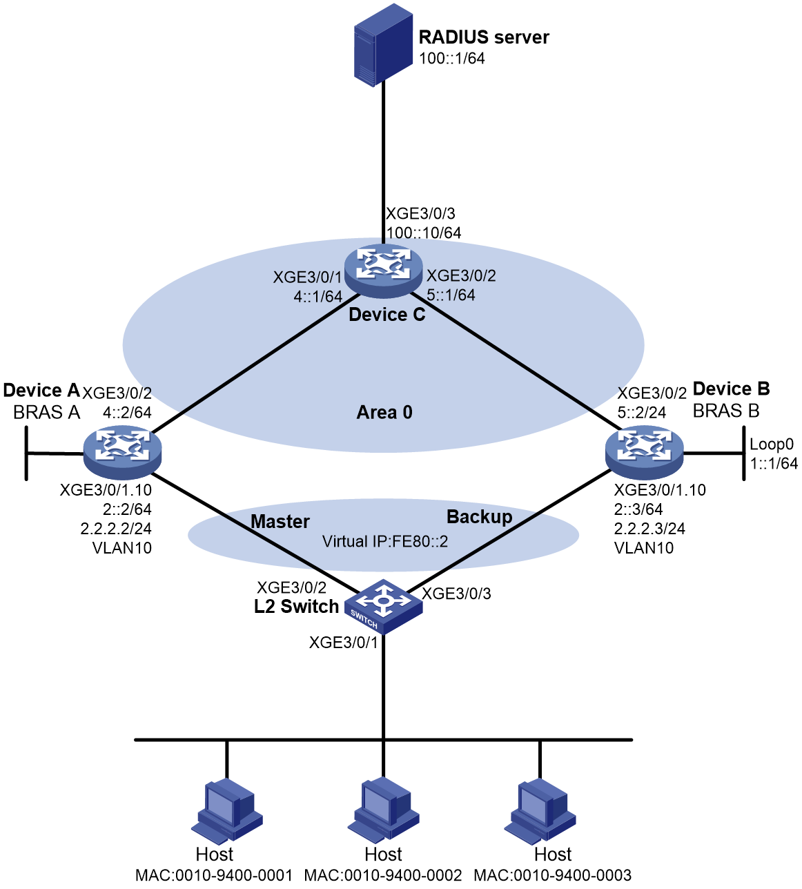

[BRASA-radius-rs1] primary authentication ipv6 6::2
[BRASA-radius-rs1] primary accounting ipv6 6::2
[BRASA-radius-rs1] key authentication simple 123456
[BRASA-radius-rs1] key accounting simple 123456
[BRASA-radius-rs1] accounting-on enable
[BRASA-radius-rs1] nas-ip ipv6 3::3
b.     Configure a prefix pool:
# Create prefix pool 1, and specify the prefix 3::/32 with the assigned prefix length 64. Prefix pool 1 contains 4294967296 prefixes from 3::/64 to 3:0:FFFF:FFFF::/64.
[BRASA] ipv6 dhcp prefix-pool 1 prefix 3::/32 assign-len 64
# Create IPv6 address pool pppoev6.
[BRASA] ipv6 pool pppoev6
# Apply prefix pool 1 to IPv6 address pool pppoev6.
[BRASA-ipv6-pool-pppoev6] prefix-pool 1 export-route
# Associate IPv6 address pool pppoev6 with VSRP instance vs1.
[BRASA-ipv6-pool-pppoev6] vsrp-instance vs1
[BRASA-ipv6-pool-pppoev6] quit
c.     Configure an authentication domain:
# Specify the prefix pool and primary DNS server address for users in the ISP domain.
[BRASA-isp-dm1] authorization-attribute ipv6-nd-prefix-pool pppoev6
[BRASA-isp-dm1] authorization-attribute primary-dns ipv6 8::8
d.     Configure OSPFv3:
[BRASA] interface loopback 0
[BRASA-LoopBack0] ospfv3 1 area 0
[BRASA-LoopBack0] ospfv3 cost 30
[BRASA-LoopBack0] quit
# Enable OSPFv3 process 1 and set its router ID to 3.3.3.1.
[BRASA] ospfv3
[BRASA-ospfv3-1] router-id 3.3.3.1
[BRASA-ospfv3-1] import-route unr inherit-cost route-policy 1
[BRASA-ospfv3-1] quit
[BRASA] ipv6 prefix-list 1 permit 3:: 32
[BRASA] route-policy 1 permit node 1
[BRASA-route-policy-1-1] if-match ipv6 address prefix-list 1
[BRASA-route-policy-1-1] quit
[BRASA] interface ten-gigabitethernet 3/0/2
[BRASA–Ten-GigabitEthernet3/0/2] ospfv3 1 area 0
[BRASA–Ten-GigabitEthernet3/0/2] quit
e.     Configure an IPv6 VRRP group:
[BRASA–Ten-GigabitEthernet3/0/1.10] vrrp ipv6 vrid 1 virtual-ip fe80::3 link-local
[BRASA–Ten-GigabitEthernet3/0/1.10] ipv6 address auto link-local
# Set the priority of BRAS A to 250 in VRRP group 1. BRAS A is assigned a higher priority than BRAS B in VRRP group 1, so BRAS A can become the master.
[BRASA-Ten-GigabitEthernet3/0/1.10] vrrp ipv6 vrid 1 priority 250
f.     Configure a VSRP instance:
[BRASA-vsrp-instance-vs1] bind vrrp ipv6 vrid 1 interface Ten-GigabitEthernet3/0/1.10
g.     Configure PPPoE:
# Create interface Virtual-Template 1.
# Enable PAP authentication on Virtual-Template 1.
[BRASA-Virtual-Template1] ppp authentication-mode pap domain dm1
# Configure Virtual-Template 1 to automatically generate a link-local address.
[BRASA-Virtual-Template1] ipv6 address auto link-local
# Disable RA message suppression on Virtual-Template 1.
[BRASA-Virtual-Template1] undo ipv6 nd ra halt
# Enable DHCPv6 server on Virtual-Template 1, and associate the interface with VSRP instance vs1.
[BRASA-Virtual-Template1] ipv6 dhcp select server
[BRASA-Virtual-Template1] ipv6 dhcp vsrp-instance vs1
[BRASA-Virtual-Template1] quit
# Enable a PPPoE server on Ten-GigabitEthernet 3/0/1, and bind the interface to Virtual-Template 1.
[BRASA-Ten-GigabitEthernet3/0/1] bras vsrp-instance vs1
<BRASB> system-view
[BRASB-radius-rs1] primary authentication ipv6 6::2
[BRASB-radius-rs1] primary accounting ipv6 6::2
[BRASB-radius-rs1] nas-ip ipv6 3::3
[BRASB] ipv6 dhcp prefix-pool 1 prefix 3::/32 assign-len 64
[BRASB] ipv6 pool pppoev6
[BRASB-ipv6-pool-pppoev6] prefix-pool 1 export-route
[BRASB-ipv6-pool-pppoev6] vsrp-instance vs1
[BRASB-ipv6-pool-pppoev6] quit
[BRASB-isp-dm1] authorization-attribute ipv6-nd-prefix-pool pppoev6
[BRASB-isp-dm1] authorization-attribute primary-dns ipv6 8::8
[BRASB] interface loopback 0
[BRASB-LoopBack0] ospfv3 1 area 0
[BRASB-LoopBack0] ospfv3 cost 30
[BRASB-LoopBack0] quit
[BRASB] ospfv3
# Configure OSPFv3 to redistribute the user network route filtered by routing policy 1. BRAS B then advertises the user network route destined for the subnet where the host resides to Device C. In this way, Device C can select the route to the host based on the state of BRAS A and BRAS B in the VSRP instance.
[BRASB-vsrp-instance-vs1] bind vrrp ipv6 vrid 1 interface Ten-GigabitEthernet3/0/1.10
g.     Configure PPPoE:
[BRASB-Virtual-Template1] ppp authentication-mode pap domain dm1
[BRASB-Virtual-Template1] ipv6 address auto link-local
[BRASB-Virtual-Template1] undo ipv6 nd ra halt
[BRASB-Virtual-Template1] ipv6 dhcp select server
[BRASB-Virtual-Template1] ipv6 dhcp vsrp-instance vs1
[BRASB-Virtual-Template1] quit
[BRASB-Ten-GigabitEthernet3/0/1] bras vsrp-instance vs1
[DeviceC] ospfv3
6.     Configure L2 Switch:
# Create VLAN 10.
[L2Switch] vlan 10
1.     Enter username user1 and password 123456 on the PPPoE client software to initiate a connection request to the PPPoE server.
         IPv6 address
0x1      XGE3/0/1                -                   001b-21a8-0949  -/-
         user1                    PPPoE users

Example: Configuring VSRP for dual-stack PPPoE (IPv4 address pool and NDRA one prefix per user)
As shown in Figure 8, the hosts run PPPoE client dialup software. To ensure service availability, enable VSRP for PPPoE on BRAS A (the master PPPoE server) and BRAS B (the backup PPPoE server). When BRAS A fails, BRAS B takes over the PPPoE services to avoid service interruption. Perform the following tasks:
·     Configure an IPv4 address pool for IPv4 address assignment on the BRAS devices.
Figure 8 Network diagram
1.     Assign IP addresses to interfaces, as shown in Figure 8. (Details not shown.)

e.     Configure OSPF:
# Configure OSPF to redistribute the user network route filtered by routing policy 1. BRAS B then advertises the user network route destined for the subnet where the host resides to Device C. In this way, Device C can select the route to the host based on the state of BRAS A and BRAS B in the VSRP instance.
[BRASB-ospf-1] quit
# Configure Area 0.
[BRASB] ospf
[BRASB-ospf-1] quit
# Enable OSPFv3 process 1 and set its router ID to 3.3.3.2:
[BRASB] ospfv3
# Associate VRRP group 1 with track entry 2 and switch the master and the backup when the state of track entry 2 changes to Negative.
When VSRP is enabled for PPPoE, IPv4 and IPv6 users share a data backup channel. You can configure an IPv4 or IPv6 data backup channel for dual-stack PPPoE. This example creates an IPv6 data backup channel.
j.     Configure PPPoE:
# Associate Virtual-Template 1 with VSRP instance vs1.
[BRASB-Virtual-Template1] dhcp relay vsrp-instance vs1
a.     Configure OSPF:
# Enable OSPFv3 process 1 and set its router ID to 6.6.6.1:
[DeviceC] ospfv3
# Create VLAN 10.
[L2Switch] vlan 10
         IPv6 address
0x1      XGE3/0/1                3.3.3.6             001b-21a8-0949  -/-
         user1                    PPPoE users
         3::4C0B:9D77:3D96:F2B
         IPv6 address
         user1                    3::4C0B:9D77:3D96:F PPPoE users
                                  2B
         IPv6 address
         user1                    PPPoE users
Example: Configuring VSRP for dual-stack PPPoE (IPv4 address pool and IPv6 address pool for a VPN instance)
As shown in Figure 9, the hosts run PPPoE client dialup software. To ensure service availability, enable VSRP for PPPoE on BRAS A (the master PPPoE server) and BRAS B (the backup PPPoE server). When BRAS A fails, BRAS B takes over the PPPoE services to avoid service interruption. Perform the following tasks:
·     Configure an IPv4 address pool and an IPv6 address pool for IP address assignment for uses in a VPN instance on the BRAS devices.
Figure 9 Network diagram
Configure MPLS L3VPN before you configure PPPoE. Assign matching VPN targets to the sites of VPN 1 for the sites to communicate with each other. This example provides only access authentication configuration on PE 1. For more information about other MPLS L3VPN configuration, see MPLS Configuration Guide.
1.     Assign IP addresses to interfaces, as shown in Figure 9. (Details not shown.)
# Add the NAS IP address and shared key configuration to the clients.conf configuration file. (The NAS IP addresses for the two clients are 4.4.4.2, and 5.5.5.2, respectively, and the shared key is 123456.)
client 3.3.3.3/32 {
ipaddr = 3.3.3.3
netmask=32
secret=123456
client 4.4.4.2/32 {
ipaddr = 4.4.4.2
netmask=32
secret=123456
client 5.5.5.2/32 {
ipaddr = 5.5.5.2
netmask=24
secret=123456
# Add the PPPoE client configuration to the users file. (The username of the PPPoE client is user1. The password is 123456.)
a.     Create VPN instance vpn1.
<BRASA> system-view
[BRASA] ip vpn-instance vpn1
[BRASA-vpn-instance-vpn1] quit
b.     Configure a RADIUS scheme:
[BRASA-radius-rs1] primary authentication 6.6.6.2
[BRASA-radius-rs1] primary accounting 6.6.6.2
[BRASA-radius-rs1] nas-ip 3.3.3.3
c.     Configure PBR:
Configure static routes and PBR for the RADIUS packets sent by BRAS devices to reach the RADIUS server.
# Configure a static route for users in VPN instance vpn1 to reach the RADIUS server.
[BRASA] ip route-static vpn-instance vpn1 6.6.6.2 32 4.4.4.1 public
# Configure ACL 3030 to match traffic with source address 6.6.6.2/32 and destination address 3.3.3.3/32.
[BRASA] acl advanced 3030
[BRASA-acl-ipv4-adv-3030] rule permit ip source 6.6.6.2 0 destination 3.3.3.3 0
[BRASA-acl-ipv4-adv-3030] quit
# Create PBR policy public_to_vpn1. Configure the policy to permit traffic that matches ACL 3030 in VPN instance vpn1.
[BRASA] policy-based-route public_to_vpn1 permit node 0
[BRASA-pbr-public_to_vpn1-0] if-match acl 3030
[BRASA-pbr-public_to_vpn1-0] apply access-vpn vpn-instance vpn1
[BRASA-pbr-public_to_vpn1-0] quit
# Apply PBR policy public_to_vpn1 to Ten-GigabitEthernet 3/0/2.
[BRASA–Ten-GigabitEthernet3/0/2] ip policy-based-route public_to_vpn1
d.     Configure an IPv4 address pool:
# Enable DHCP.
[BRASA] dhcp enable
# Create IPv4 address pool pppoev4 and enter its view.
[BRASA] ip pool pppoev4
# Assign subnet 3.3.3.0/24 to the hosts, and specify the gateway address and DNS server address.
[BRASA-ip-pool-pppoev4] network 3.3.3.0 24 export-route
[BRASA-ip-pool-pppoev4] gateway-list 3.3.3.3 export-route
[BRASA-ip-pool-pppoev4] dns-list 8.8.8.8
# Exclude the gateway address and the IP addresses of host-facing interfaces on the BRAS devices from dynamic allocation.
[BRASA-ip-pool-pppoev4] forbidden-ip 3.3.3.1
[BRASA-ip-pool-pppoev4] forbidden-ip 3.3.3.2
[BRASA-ip-pool-pppoev4] forbidden-ip 3.3.3.3
# Associate the address pool with VSRP instance vs1 and VPN instance vpn1.
[BRASA-ip-pool-pppoev4] vsrp-instance vs1
[BRASA-ip-pool-pppoev4] vpn-instance vpn1
[BRASA-ip-pool-pppoev4] quit
e.     Configure an IPv6 address pool:
# Create IPv6 address pool pppoev6. Assign subnet 3::/64 to the hosts and specify the DNS server address.
[BRASA-ipv6-pool-pppoev6] network 3::/64 export-route
[BRASA-ipv6-pool-pppoev6] dns-server 8::8
[BRASA-ipv6-pool-pppoev6] vpn-instance vpn1
[BRASA] ipv6 dhcp server forbidden-address 3::1 vpn-instance vpn1
[BRASA] ipv6 dhcp server forbidden-address 3::2 vpn-instance vpn1
[BRASA] ipv6 dhcp server forbidden-address 3::3 vpn-instance vpn1
f.     Configure an authentication domain:
# Specify the IPv4 address pool, IPv6 address pool, and VPN instance for users in the ISP domain.
[BRASA-isp-dm1] authorization-attribute ip-pool pppoev4
[BRASA-isp-dm1] authorization-attribute ipv6-pool pppoev6
[BRASA-isp-dm1] authorization-attribute vpn-instance vpn1
g.     Configure OSPF:
[BRASA] ospf 1 router-id 3.3.3.1
# Configure Area 0.
[BRASA-ospf-1] area 0.0.0.0
[BRASA-ospf-1-area-0.0.0.0] network 4.4.4.0 0.0.0.255
[BRASA-ospf-1-area-0.0.0.0] quit
[BRASA-ospf-1] quit
h.     Configure OSPFv3:
[BRASA] ospfv3
i.     Configure an IPv6 VRRP group:
j.     Configure a VSRP instance:
k.     Configure PPPoE:
# Set the managed address configuration flag (M) to 1 and set the other stateful configuration flag (O) to 1 in RA advertisements to be sent.
[BRASA-Virtual-Template1] ipv6 nd autoconfig managed-address-flag
[BRASA-Virtual-Template1] ipv6 nd autoconfig other-flag
[BRASA-Virtual-Template1] dhcp vsrp-instance vs1
# Enable DHCPv6 server on Virtual-Template 1 and associate the interface with VSRP instance vs1.
<BRASB> system-view
[BRASB] ip vpn-instance vpn1
[BRASB-vpn-instance-vpn1] quit
c.     Configure PBR:
[BRASB] ip route-static vpn-instance vpn1 6.6.6.2 32 5.5.5.1 public
[BRASB] acl advanced 3030
[BRASB-acl-ipv4-adv-3030] rule permit ip source 6.6.6.2 0 destination 3.3.3.3 0
[BRASB-acl-ipv4-adv-3030] quit
[BRASB] policy-based-route public_to_vpn1 permit node 0
[BRASB-pbr-public_to_vpn1-0] if-match acl 3030
[BRASB-pbr-public_to_vpn1-0] apply access-vpn vpn-instance vpn1
[BRASB-pbr-public_to_vpn1-0] quit
[BRASB–Ten-GigabitEthernet3/0/2] ip policy-based-route public_to_vpn1
# Enable DHCP.
[BRASB] dhcp enable
[BRASB] ip pool pppoev4
[BRASB-ip-pool-pppoev4] network 3.3.3.0 24 export-route
[BRASB-ip-pool-pppoev4] gateway-list 3.3.3.3 export-route
[BRASB-ip-pool-pppoev4] dns-list 8.8.8.8
[BRASB-ip-pool-pppoev4] forbidden-ip 3.3.3.1
[BRASB-ip-pool-pppoev4] forbidden-ip 3.3.3.2
[BRASB-ip-pool-pppoev4] forbidden-ip 3.3.3.3
[BRASB-ip-pool-pppoev4] vsrp-instance vs1
[BRASB-ip-pool-pppoev4] vpn-instance vpn1
[BRASB-ip-pool-pppoev4] quit
[BRASB-ipv6-pool-pppoev6] network 3::/64 export-route
[BRASB-ipv6-pool-pppoev6] dns-server 8::8
[BRASB-ipv6-pool-pppoev6] vpn-instance vpn1
[BRASB] ipv6 dhcp server forbidden-address 3::1 vpn-instance vpn1
[BRASB] ipv6 dhcp server forbidden-address 3::2 vpn-instance vpn1
[BRASB] ipv6 dhcp server forbidden-address 3::3 vpn-instance vpn1
[BRASB-isp-dm1] authorization-attribute ip-pool pppoev4
[BRASB-isp-dm1] authorization-attribute ipv6-pool pppoev6
[BRASB-isp-dm1] authorization-attribute vpn-instance vpn1
g.     Configure OSPF:
# Configure Area 0.
[BRASB-ospf-1] quit
[BRASB] ospfv3
j.     Configure the track entry associated with a BFD session:
k.     Configure a VSRP instance:
l.     Configure PPPoE:
[BRASB-Virtual-Template1] ipv6 nd autoconfig managed-address-flag
[BRASB-Virtual-Template1] ipv6 nd autoconfig other-flag
[BRASB-Virtual-Template1] dhcp vsrp-instance vs1

5.     Configure P1:
a.     Configure OSPF:
<P1> system-view
[P1] ospf 1 router-id 6.6.6.1
[P1-ospf-1] area 0.0.0.0
[P1-ospf-1-area-0.0.0.0] network 4.4.4.0 0.0.0.255
[P1-ospf-1-area-0.0.0.0] network 5.5.5.0 0.0.0.255
[P1-ospf-1-area-0.0.0.0] quit
[P1-ospf-1] quit
[P1] ospfv3
[P1-ospfv3-1] router-id 6.6.6.1
[P1-ospfv3-1] quit
[P1] interface ten-gigabitethernet 3/0/1
[P1–Ten-GigabitEthernet3/0/1] ospfv3 1 area 0
[P1–Ten-GigabitEthernet3/0/1] quit
[P1] interface ten-gigabitethernet 3/0/2
[P1–Ten-GigabitEthernet3/0/2] ospfv3 1 area 0
[P1–Ten-GigabitEthernet3/0/2] quit
[P1] interface ten-gigabitethernet 3/0/3
[P1-Ten-GigabitEthernet3/0/3] ospfv3 1 area 0
[P1-Ten-GigabitEthernet3/0/3] quit
c.     Configure static routes for P1 to reach 3.3.3.3:
# Configure a static route with BRAS A as the next hop.
[P1] ip route-static 3.3.3.3 32 4.4.4.2
# Configure a static route with BRAS B as the next hop.
[P1] ip route-static 3.3.3.3 32 5.5.5.2
# Create VLAN 10.
[L2Switch] vlan 10
         IPv6 address
0x1      XGE3/0/1                3.3.3.4             001b-21a8-0949  -/-
         user1                    PPPoE users
         3::4
         IPv6 address
         user1                    PPPoE users
         3::4
3.     Verify that BRAS B becomes the master and takes over the PPPoE services when BRAS A fails (for example, Ten-GigabitEthernet 3/0/2 is down).
         IPv6 address
         user1                    PPPoE users
         3::4
Example: Configuring VSRP for L2TP
As shown in Figure 10, enable VSRP for L2TP on LAC 1 (the master) and LAC 2 (the backup). When LAC 1 fails, LAC 2 can take over the L2TP services to avoid service interruption.
Figure 10 Network diagram
1.     Assign IP addresses to interfaces, as shown in Figure 10. Configure routes for the remote user, the LACs, the LNS, and the RADIUS servers to reach one another. (Details not shown.)
2.     Configure RADIUS server 1 and RADIUS server 2. (Details not shown.)
3.     Configure the LNS:
# Create a RADIUS scheme named rad and enter RADIUS scheme view.
<LNS> system-view
[LNS] radius scheme rad
[LNS-radius-rad] primary authentication 7.7.7.2
[LNS-radius-rad] primary accounting 7.7.7.2
[LNS-radius-rad] key authentication simple auth2pass
[LNS-radius-rad] key accounting simple auth2pass
# Specify the source IP address as 7.7.7.1 (the IP address of Ten-GigabitEthernet 3/0/2) for outgoing RADIUS packets.
[LNS-radius-rad] nas-ip 7.7.7.1
[LNS-radius-rad] quit
# Enable DHCP and configure an address pool.
[LNS] dhcp enable
[LNS] ip pool pool1
[LNS-ip-pool-pool1] network 192.168.1.0 mask 255.255.255.0 export-route
[LNS-ip-pool-pool1] gateway-list 192.168.1.1 export-route
[LNS-ip-pool-pool1] forbidden-ip 192.168.1.1
[LNS-ip-pool-pool1] quit
# Create ISP domain bbb and configure the domain to use RADIUS scheme rad for authentication, authorization, and accounting for PPP users.
[LNS] domain name bbb
[LNS-isp-bbb] authentication ppp radius-scheme rad
[LNS-isp-bbb] authorization ppp radius-scheme rad
[LNS-isp-bbb] accounting ppp radius-scheme rad
[LNS-isp-bbb] authorization-attribute ip-pool pool1
[LNS-isp-bbb] quit
# Enable L2TP.
[LNS] l2tp enable
# Create interface Virtual-Template 1, and set the PPP authentication mode to PAP.
[LNS] interface virtual-template 1
[LNS-Virtual-Template1] ppp authentication-mode pap domain bbb
[LNS-Virtual-Template1] quit
# Create L2TP group 1 in LNS mode.
[LNS] l2tp-group 1 mode lns
# Configure the local tunnel name as LNS.
[LNS-l2tp1] tunnel name LNS
# Specify Virtual-Template 1 for receiving calls from the specified LAC.
[LNS-l2tp1] allow l2tp virtual-template 1 remote LAC
# Disable tunnel authentication.
[LNS-l2tp1] undo tunnel authentication
[LNS-l2tp1] quit
4.     Configure LAC 1:
<LAC1> system-view
[LAC1] radius scheme rad
# Specify the primary authentication server with IP address 10.1.1.2 and UDP port number 1812.
[LAC1-radius-rad] primary authentication 10.1.1.2 1812
# Specify the primary accounting server with IP address 10.1.1.2 and UDP port number 1813.
[LAC1-radius-rad] primary accounting 10.1.1.2 1813
[LAC1-radius-rad] key authentication simple auth1pass
[LAC1-radius-rad] key accounting simple auth1pass
# Specify the source IP address as 1.1.1.100 (the virtual IP address of VRRP group 1) for outgoing RADIUS packets.
[LAC1-radius-rad] nas-ip 1.1.1.100
[LAC1-radius-rad] quit
# Create ISP domain bbb and enter ISP domain view.
[LAC1] domain name bbb
# Configure the domain to use RADIUS scheme rad for authentication, authorization, and accounting for PPP users.
[LAC1-isp-bbb] authentication ppp radius-scheme rad
[LAC1-isp-bbb] authorization ppp radius-scheme rad
[LAC1-isp-bbb] accounting ppp radius-scheme rad
[LAC1-isp-bbb] quit
# Create interface Virtual-Template 1 and set the PPP authentication mode to PAP.
[LAC1] interface virtual-template 1
[LAC1-Virtual-Template1] ppp authentication-mode pap domain bbb
[LAC1-Virtual-Template1] quit
# Enable L2TP.
[LAC1] l2tp enable
# Create L2TP group 1 in LAC mode.
[LAC1] l2tp-group 1 mode lac
# Configure the local tunnel name as LAC.
[LAC1-l2tp1] tunnel name LAC
[LAC1-l2tp1] user fullusername user1
# Specify the LNS IP address as 5.5.5.1.
[LAC1-l2tp1] lns-ip 5.5.5.1
[LAC1-l2tp1] undo tunnel authentication
# Associate L2TP group 1 with VSRP instance l2tp1.
[LAC1-l2tp1] vsrp-instance l2tp1
# Specify the source IP address for the L2TP tunnel as 6.6.6.1. After successful VSRP master and backup negotiation, only the master LAC generates a static route to the source address with the loopback interface as the output interface. To forward downstream traffic from LNS to the remote end always through the master LAC, use a dynamic routing protocol to advertise this static route. (Details not shown.)
[LAC1-l2tp1] tunnel vsrp source-ip 6.6.6.1
[LAC1-l2tp1] quit
# Configure the PPPoE server.
[LAC1] interface ten-gigabitethernet 3/0/1
[LAC1-Ten-GigabitEthernet3/0/1] pppoe-server bind virtual-template 1
# Associate the PPPoE server-enabled interface with VSRP instance l2tp1.
[LAC1-Ten-GigabitEthernet3/0/1] bras vsrp-instance l2tp1
[LAC1-Ten-GigabitEthernet3/0/1] quit
# Create track entry 2 to monitor the link status of uplink interface Ten-GigabitEthernet 3/0/2.
[LAC1] track 2 interface ten-gigabitethernet 3/0/2
# Create VRRP group 1 and set its virtual IP address to 1.1.1.100.
[LAC1-Ten-GigabitEthernet3/0/1] vrrp vrid 1 virtual-ip 1.1.1.100
# Set the priority of LAC 1 to 120 in VRRP group 1.
[LAC1-Ten-GigabitEthernet3/0/1] vrrp vrid 1 priority 120
# Configure LAC 1 to operate in preemptive mode, and set the preemption delay to 90000 centiseconds (15 minutes). When the original master recovers, it has 15 minutes to synchronize data from the new master before switch-back to ensure stability and data consistency of the VRRP group.
[LAC1-Ten-GigabitEthernet3/0/1] vrrp vrid 1 preempt-mode delay 90000
# Associate VRRP group 1 on Ten-GigabitEthernet 3/0/1 with track entry 2 and decrease the device priority by 50 when the state of track entry 2 changes to Negative.
[LAC1-Ten-GigabitEthernet3/0/1] vrrp vrid 1 track 2 priority reduced 50
# Create VSRP group pname, and enter VSRP peer view.
[LAC1] vsrp peer pname
# Specify the local IP address as 2.2.2.2 and the peer IP address as 3.3.3.3 for VSRP to establish VSRP channels. The default TCP port number for the control channel is used.
[LAC1-vsrp-peer-pname] peer 3.3.3.3 local 2.2.2.2
[LAC1-vsrp-peer-pname] quit
# Create VSRP instance l2tp1 and associate it with VSRP group pname. Set the backup ID of the VSRP instance to 1.
[LAC1] vsrp instance l2tp1
[LAC1-vsrp-instance-l2tp1] backup id 1 peer pname
# Bind VSRP instance l2tp1 to VRRP group 1.
[LAC1-vsrp-instance-l2tp1] bind vrrp vrid 1 interface ten-gigabitethernet 3/0/1
[LAC1-vsrp-instance-l2tp1] quit
5.     Configure LAC 2:
<LAC2> system-view
[LAC2] radius scheme rad
[LAC2-radius-rad] primary authentication 10.1.1.2 1812
[LAC2-radius-rad] primary accounting 10.1.1.2 1813
[LAC2-radius-rad] key authentication simple auth1pass
[LAC2-radius-rad] key accounting simple auth1pass
[LAC2-radius-rad] nas-ip 1.1.1.100
[LAC2-radius-rad] quit
[LAC2] domain name bbb
[LAC2-isp-bbb] authentication ppp radius-scheme rad
[LAC2-isp-bbb] authorization ppp radius-scheme rad
[LAC2-isp-bbb] accounting ppp radius-scheme rad
[LAC2-isp-bbb] quit
[LAC2] interface virtual-template 1
[LAC2-Virtual-Template1] ppp authentication-mode pap domain bbb
[LAC2-Virtual-Template1] quit
# Enable L2TP.
[LAC2] l2tp enable
[LAC2] l2tp-group 1 mode lac
[LAC2-l2tp1] tunnel name LAC
# Specify PPP user user1 as the condition for the LAC to initiate tunneling requests.
[LAC2-l2tp1] user fullusername user1
[LAC2-l2tp1] lns-ip 5.5.5.1
[LAC2-l2tp1] undo tunnel authentication
[LAC2-l2tp1] vsrp-instance l2tp1
[LAC2-l2tp1] tunnel vsrp source-ip 6.6.6.1
[LAC2-l2tp1] quit
[LAC2] interface ten-gigabitethernet 3/0/1
[LAC2-Ten-GigabitEthernet3/0/1] pppoe-server bind virtual-template 1
# Associate the PPPoE server with VSRP instance l2tp1.
[LAC2-Ten-GigabitEthernet3/0/1] bras vsrp-instance l2tp1
[LAC2-Ten-GigabitEthernet3/0/1] quit
[LAC2-Ten-GigabitEthernet3/0/1] vrrp vrid 1 virtual-ip 1.1.1.100
# Create VSRP group pname and enter VSRP peer view.
[LAC2] vsrp peer pname
# Specify the local IP address as 3.3.3.3 and the peer address as 2.2.2.2 for VSRP to establish VSRP channels. The default TCP port number for the control channel is used.
[LAC2-vsrp-peer-pname] peer 2.2.2.2 local 3.3.3.3
[LAC2-vsrp-peer-pname] quit
[LAC2] vsrp instance l2tp1
[LAC2-vsrp-instance-l2tp1] backup id 1 peer pname
[LAC2-vsrp-instance-l2tp1] bind vrrp vrid 1 interface ten-gigabitethernet 3/0/1
[LAC2-vsrp-instance-l2tp1] quit
¡     # To enable RADIUS server 1 to always interact with the master LAC, configure the following settings. After configuration, when both the master and backup LACs redistribute the direct route of subnet 1.1.1.0/24 (where NAS IP address 1.1.1.100 resides) into the dynamic routing protocol (such as OSPF) and advertise the direct route to the upstream CR, the CR learns the subnet route 1.1.1.0/24 advertised by only the master device.
¡     # Create track entry 1 and associate it with VRRP group 1 on interface Ten-GigabitEthernet 3/0/1. When the device is in master state, the associated track entry changes to Positive state. When the device is in backup state, the associated track entry changes to Negative state.
[LAC2] track 1 vrrp interface ten-gigabitethernet 3/0/1 vrid 1
[LAC2-track-1] quit
¡     # On Ten-GigabitEthernet 3/0/1, associate the direct route with track entry 1 and apply the cost 100 to the direct route when the state of track entry 1 changes to Negative.

Example: Configuring VSRP and VRRP collaboration for ARP
As shown in Figure 11, configure VSRP to back up ARP entries between Device A and Device B.
·     Enable VSRP for ARP on Ten-GigabitEthernet 3/0/1 of Device A and Device B.
·     Configure VRRP on Ten-GigabitEthernet 3/0/1.10 of Device A and Device B, and configure these subinterfaces to terminate VLAN 10.
·     Enable OSPF on Device A and Device B to ensure that they can learn and advertise routes on their upstream links.
Figure 11 Network diagram
1.     Assign IP addresses to the interfaces, as shown in Figure 11. (Details not shown.)
2.     Configure Device A:

3.     Configure Device B:

4.     Configure Device C:

5.     Configure the L2 Switch:
¡     Create VLAN 10.

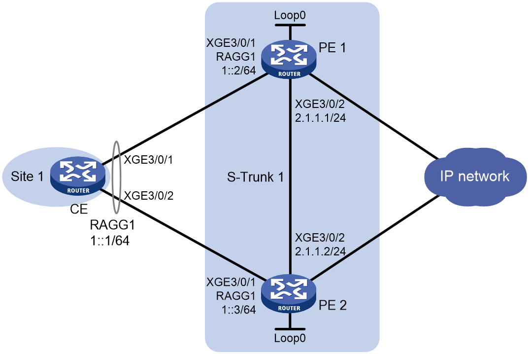

Example: Configuring VSRP and S-Trunk collaboration for ARP
As shown in Figure 12, configure VSRP to back up ARP entries between PE 1 and PE 2.
·     Configure smart trunk 1 on PE 1 and PE 2, and assign Route-Aggregation 1 of PE 1 and PE 2 to the smart trunk. Configure Route-Aggregation 1 of PE 1 as the primary member interface, and configure Route-Aggregation 1 of PE 2 as the secondary member interface.
·     Enable VSRP for ARP on Route-Aggregation 1 of PE 1 and PE 2.
·     Configure VSRP and S-Trunk collaboration.
Figure 12 Network diagram
Configuring the CE
