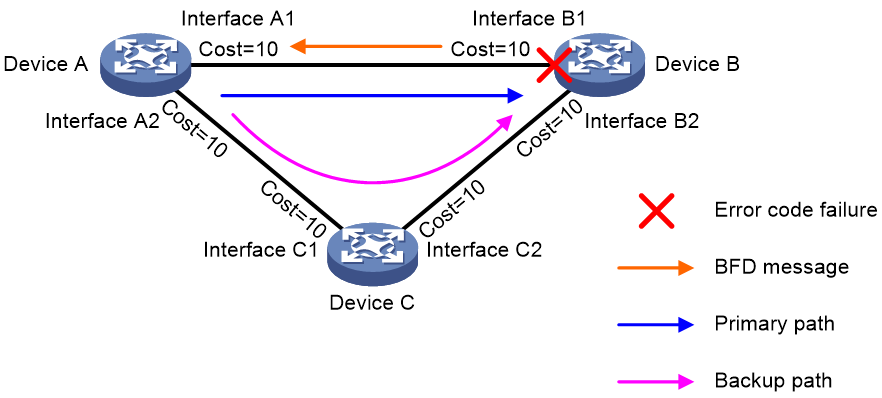

As shown in Figure 1, each interface has error code detection enabled for triggering LSP switchover. LDP labels are distributed among nodes. Typically, MPLS traffic is forwarded over the primary LSP. When error codes are detected on Device B, the following events occur:
¡     Device B senses the primary LSP failure, and switches traffic to the secondary LSP. At the same, Device B sends BFD messages to notify Device A of the error code failure.
¡     After Device A receives BFD messages from Device B, Device A also senses the primary LSP failure, and switches traffic to the secondary LSP.
Figure 1 Schematic diagram for error code detection for triggering LSP switchover

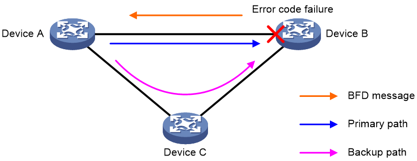

As shown in Figure 2, each interface has error code detection enabled for triggering section layer service protection. All nodes can reach each other through IS-IS routes. Normally, both Device A and Device B preferentially use the primary path for  IS-IS routes. Therefore, traffic in each direction is forwarded by the primary path. When error codes are detected on Device B, the following events occur:
¡     The link layer protocol state of the corresponding interface on Device B becomes DOWN(Bit-error down) to trigger switching the IS-IS route to the backup path, so the traffic from Device B to Device A is forwarded through the backup path. At the same time, Device B sends BFD messages to notify Device A of the error code failure.
¡     After Device A receives the BFD messages from Device B, the link layer protocol state of the corresponding interface on Device A becomes DOWN(Bit-error down) to trigger switching the IS-IS route to the backup path, so the traffic from Device A to Device B is forwarded through the backup path.
Figure 2 Schematic diagram for error code detection for triggering section layer service protection
