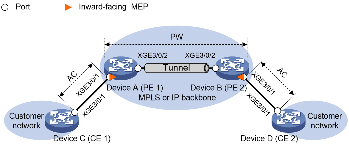

In an Ethernet network, an MA serves the specified VLAN or no VLAN. An MA that serves a VLAN is considered to be carrying VLAN attribute. An MA that serves no VLAN is considered to be carrying no VLAN attribute.
In an MPLS Layer 2 VPN, an MA can only serve the specified cross-connect or virtual switch instance (VSI).

An MP is configured on a port and belongs to an MA. MPs include the following types: maintenance association end points (MEPs) and maintenance association intermediate points (MIPs).
MEPs define the boundary of the MA. Each MEP is identified by a MEP ID.
In an Ethernet network, the MA to which a MEP belongs defines the VLAN of packets sent by the MEP.
In an MPLS Layer 2 VPN, the MA to which a MEP belongs defines the cross-connect or VSI of packets sent by the MEP.
MEPs include inward-facing MEPs and outward-facing MEPs:
·     An inward-facing MEP does not send packets to its host port. Rather, it sends packets to other ports on the device. In an Ethernet network, the packets are broadcast in the VLAN that the MA of the MEP serves. In an MPLS Layer 2 VPN, the packets are broadcast in the cross-connect or VSI to which the MEP belongs.
·     An outward-facing MEP sends packets to its host port.
A MIP is internal to an MA. It cannot send CFD packets actively, but it can handle and respond to CFD packets. MIPs are automatically created by the device. By cooperating with MEPs, a MIP can perform a function similar to ping and traceroute.
The MA to which a MIP belongs defines the VLAN of packets that the MIP can receive.
The MIP-related configuration takes effect only in Ethernet networks.

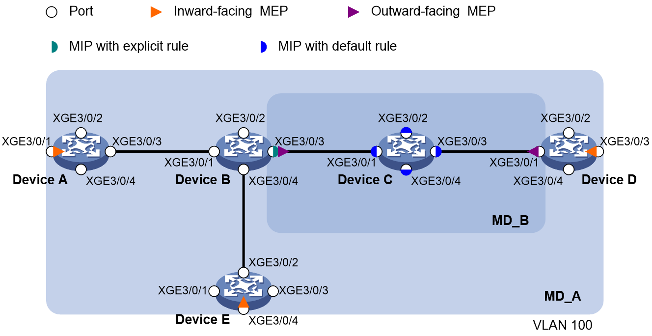

To accurately locate faults, CFD introduces eight levels (from 0 to 7) to MDs. The bigger the number, the higher the level and the larger the area covered. Domains can touch or nest (if the outer domain has a higher level than the nested one) but cannot intersect or overlap.
MD levels facilitate fault location and make fault location more accurate. As shown in Figure 1, MD_A in light blue nests MD_B in dark blue. If a connectivity fault is detected at the boundary of MD_A, any of the devices in MD_A, including Device A through Device E, might fail. If a connectivity fault is also detected at the boundary of MD_B, the failure points can be any of Device B through Device D. If the devices in MD_B can operate correctly, at least Device C is operational.
This section assumes that physical links between devices are in good condition.
Figure 1 Two nested MDs
CFD exchanges messages and performs operations on a per-domain basis. By planning MDs correctly in a network, you can use CFD to rapidly locate failure points.

Figure 3 demonstrates a grading example of the CFD module. Four levels of MDs (0, 2, 3, and 5) are designed. The bigger the number, the higher the level and the larger the area covered. MPs are configured on the ports of Device A through Device F. Port A of Device B is configured with the following MPs:
·     A level 5 MIP.
·     A level 3 inward-facing MEP.
·     A level 2 inward-facing MEP.
·     A level 0 outward-facing MEP.
Figure 3 CFD grading example

CFD is implemented through various operations on MEPs. As a MEP is configured on a service instance, the MD level and VLAN attribute or cross-connect or VSI attribute of the service instance become the attributes of the MEP.
In an Ethernet network:
·     You can specify an interface as the MEP for only one of the non-VLAN-specific MAs at the same level. In addition, the MEP must be outward facing.
On a Layer 3 Ethernet interface, you cannot create a MEP for an MA that carries VLAN attribute.
In an MPLS Layer 2 VPN:
·     You can configure only one inward-facing MEP for a CFD service instance.
·     An inward-facing MEP can only be configured on an AC interface to detect PW or AC connectivity.
·     To specify the VLAN ID when creating a MEP, you must first configure the vlan-type dot1q vid vlan-id-list command and set the same value for the vlan-id-list and vlan vlan-id parameters. For more information about the vlan-type dot1q vid vlan-id-list command, see VLAN termination commands in Layer 2—LAN Switching Command Reference.
·     To specify the outer and inner VLAN IDs when creating a MEP, you must first configure the vlan-type dot1q vid second-dot1q command and set the same outer VLAN ID and the same inner VLAN ID in the two commands. For more information about the vlan-type dot1q vid second-dot1q command, see VLAN termination commands in Layer 2—LAN Switching Command Reference.
Before you configure MEPs, you must configure service instances.
Configuring MEPs in an Ethernet network
2.     Configure a MEP list.
cfd meplist mep-list service-instance instance-id
The created MEP must be included in the configured MEP list.
3.     Enter interface view.
4.     Create a MEP.
¡     Create a MEP in Layer 2 Ethernet interface view, Layer 2 FlexE logical interface view, or Layer 2 aggregate interface view.
cfd mep mep-id service-instance instance-id { inbound | outbound }
¡     Create a MEP in Layer 3 Ethernet interface view or Layer 3 FlexE logical interface view.
cfd mep mep-id service-instance instance-id outbound
Configuring MEPs in an MPLS Layer 2 VPN
¡     Enter Layer 3 Ethernet interface, Layer 3 FlexE logical interface, or Layer 3 aggregate interface view.
¡     Enter Layer 3 Ethernet subinterface or Layer 3 aggregate subinterface view.
interface interface-type interface-number.subnumber
4.     Create a MEP.
¡     In Layer 3 aggregate interface view or Layer 3 aggregate subinterface view:
cfd mep mep-id service-instance instance-id inbound
¡     In Layer 3 Ethernet interface view:
¡     In Layer 3 Ethernet subinterface view or Layer 3 FlexE logical interface view:
cfd mep mep-id service-instance instance-id [ vlan vlan-id | service-vid vlan-id customer-vid vlan-id ] outbound
Configuring MIP auto-generation rules
As functional entities in a service instance, MIPs respond to various CFD frames, such as LTM and LBM frames. You can configure MIP auto-generation rules for the system to automatically create MIPs.
Any of the following events can cause MIPs to be created or deleted after you have configured the cfd mip-rule command:
·     Enabling or disabling CFD.
·     Creating or deleting MEPs on a port.
·     Changes occur to the VLAN attribute of a port.
·     The rule specified in the cfd mip-rule command changes.
·     An MA carrying no VLAN attribute is typically used to detect direct link status. The system cannot generate MIPs for such MAs.
·     For an MA carrying VLAN attribute, the system does not generate MIPs if the same or a higher level MEP exists on the interface.
·     The MIP-related configuration takes effect only in Ethernet networks.
2.     Configure MIP auto-generation rules.
cfd mip-rule { default | explicit } service-instance instance-id
By default, no rules for generating MIPs are configured, and the system does not automatically create any MIP.

As shown in Figure 4:
·     The network comprises five devices and is divided into two MDs: MD_A (level 5) and MD_B (level 3). All ports belong to VLAN 100, and the MAs in the two MDs all serve VLAN 100. Assume that the MAC addresses of Device A through Device E are 0010-FC01-6511, 0010-FC02-6512, 0010-FC03-6513, 0010-FC04-6514, and 0010-FC05-6515, respectively.
·     MD_A has three edge ports: Ten-GigabitEthernet 3/0/1 on Device A, Ten-GigabitEthernet 3/0/3 on Device D, and Ten-GigabitEthernet 3/0/4 on Device E. They are all inward-facing MEPs. MD_B has two edge ports: Ten-GigabitEthernet 3/0/3 on Device B and Ten-GigabitEthernet 3/0/1 on Device D. They are both outward-facing MEPs.
·     In MD_A, Device B is designed to have MIPs when its port is configured with low level MEPs. Port Ten-GigabitEthernet 3/0/3 is configured with MEPs of MD_B, and the MIPs of MD_A can be configured on this port. You must configure the MIP generation rule of MD_A as explicit.
·     The MIPs of MD_B are designed on Device C, and are configured on all ports. You must configure the MIP generation rule as default.
·     Configure CC to monitor the connectivity among all the MEPs in MD_A and MD_B. Configure LB to locate link faults, and use the AIS and EAIS functions to suppress the error alarms that are reported.
·     After the status information of the entire network is obtained, use LT, LM, DM, and TST to detect link faults.
Figure 4 Network diagram
1.     Configure a VLAN and assign ports to it:
On each device shown in Figure 4, create VLAN 100 and assign ports Ten-GigabitEthernet 3/0/1 through Ten-GigabitEthernet 3/0/4 to VLAN 100.

4.     Configure MEPs:
# On Device A, configure a MEP list in service instance 1, and create inward-facing MEP 1001 in service instance 1 on Ten-GigabitEthernet 3/0/1.
[DeviceA] cfd meplist 1001 4002 5001 service-instance 1
[DeviceA] interface ten-gigabitethernet 3/0/1
[DeviceA-Ten-GigabitEthernet3/0/1] cfd mep 1001 service-instance 1 inbound
[DeviceA-Ten-GigabitEthernet3/0/1] quit
# On Device B, configure a MEP list in service instances 1 and 2.
[DeviceB] cfd meplist 1001 4002 5001 service-instance 1
[DeviceB] cfd meplist 2001 4001 service-instance 2
# Create outward-facing MEP 2001 in service instance 2 on Ten-GigabitEthernet 3/0/3.
[DeviceB] interface ten-gigabitethernet 3/0/3
[DeviceB-Ten-GigabitEthernet3/0/3] cfd mep 2001 service-instance 2 outbound
[DeviceB-Ten-GigabitEthernet3/0/3] quit
# On Device D, configure a MEP list in service instances 1 and 2.
[DeviceD] cfd meplist 1001 4002 5001 service-instance 1
[DeviceD] cfd meplist 2001 4001 service-instance 2
# Create outward-facing MEP 4001 in service instance 2 on Ten-GigabitEthernet 3/0/1.
[DeviceD] interface ten-gigabitethernet 3/0/1
[DeviceD-Ten-GigabitEthernet3/0/1] cfd mep 4001 service-instance 2 outbound
[DeviceD-Ten-GigabitEthernet3/0/1] quit
# Create inward-facing MEP 4002 in service instance 1 on Ten-GigabitEthernet 3/0/3.
[DeviceD] interface ten-gigabitethernet 3/0/3
[DeviceD-Ten-GigabitEthernet3/0/3] cfd mep 4002 service-instance 1 inbound
[DeviceD-Ten-GigabitEthernet3/0/3] quit
# On Device E, configure a MEP list in service instance 1.
[DeviceE] cfd meplist 1001 4002 5001 service-instance 1
# Create inward-facing MEP 5001 in service instance 1 on Ten-GigabitEthernet 3/0/4.
[DeviceE] interface ten-gigabitethernet 3/0/4
[DeviceE-Ten-GigabitEthernet3/0/4] cfd mep 5001 service-instance 1 inbound
[DeviceE-Ten-GigabitEthernet3/0/4] quit
5.     Configure MIPs:
# Configure the MIP generation rule in service instance 1 on Device B as explicit.
[DeviceB] cfd mip-rule explicit service-instance 1
# Configure the MIP generation rule in service instance 2 on Device C as default.
[DeviceC] cfd mip-rule default service-instance 2
6.     Configure CC:
# On Device A, enable the sending of CCM frames for MEP 1001 in service instance 1 on Ten-GigabitEthernet 3/0/1.
[DeviceA-Ten-GigabitEthernet3/0/1] cfd cc service-instance 1 mep 1001 enable
# On Device B, enable the sending of CCM frames for MEP 2001 in service instance 2 on Ten-GigabitEthernet 3/0/3.
[DeviceB-Ten-GigabitEthernet3/0/3] cfd cc service-instance 2 mep 2001 enable
# On Device D, enable the sending of CCM frames for MEP 4001 in service instance 2 on Ten-GigabitEthernet 3/0/1.
[DeviceD-Ten-GigabitEthernet3/0/1] cfd cc service-instance 2 mep 4001 enable
# Enable the sending of CCM frames for MEP 4002 in service instance 1 on Ten-GigabitEthernet 3/0/3.
[DeviceD-Ten-GigabitEthernet3/0/3] cfd cc service-instance 1 mep 4002 enable
# On Device E, enable the sending of CCM frames for MEP 5001 in service instance 1 on Ten-GigabitEthernet 3/0/4.
[DeviceE-Ten-GigabitEthernet3/0/4] cfd cc service-instance 1 mep 5001 enable
7.     Configure AIS:
# Enable AIS on Device B. Configure the AIS frame transmission level as 5 and AIS frame transmission interval as 1 second in service instance 2.
[DeviceB] cfd ais enable
[DeviceB] cfd ais level 5 service-instance 2
[DeviceB] cfd ais period 1 service-instance 2
8.     Configure EAIS:
# Enable port status-AIS collaboration on Device B.
[DeviceB] cfd ais-track link-status global
# On Ten-GigabitEthernet 3/0/3 of Device B, configure the EAIS frame transmission level as 5 and the EAIS frame transmission interval as 60 seconds. Specify the VLANs where the EAIS frames can be transmitted as VLAN 100.
[DeviceB-Ten-GigabitEthernet3/0/3] cfd ais-track link-status level 5
[DeviceB-Ten-GigabitEthernet3/0/3] cfd ais-track link-status period 60
[DeviceB-Ten-GigabitEthernet3/0/3] cfd ais-track link-status vlan 100

Example: Configuring CFD in a Layer 2 VPN (L2VPN networking)
As shown in Figure 5:
·     Configure a static PW between PE 1 and PE 2 to enable CE 1 and CE 2 to communicate with each other. Assume that the MAC addresses of Device A through Device D are 0010-FC01-6511, 0010-FC02-6512, 0010-FC03-6513, and 0010-FC04-6514, respectively.
·     Configure Ten-GigabitEthernet 3/0/1.1 on Device A and Device B as AC interfaces, and associate them with cross-connect svc of cross-connect group vpna.
·     Assign the network to MD_A (level 5). MD_A has two edge interfaces: Ten-GigabitEthernet 3/0/1.1 on Device A and Ten-GigabitEthernet 3/0/1.1 on Device B. They are both inward-facing MEPs.
·     Configure CC to monitor the connectivity between the inward-facing MEPs. Configure LB to locate link faults.
·     After the status information of the entire network is obtained, use LT, LM, and DM to detect link faults.
Figure 5 Network diagram
