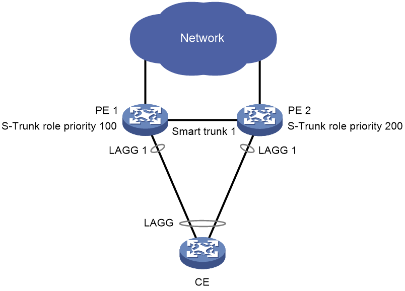

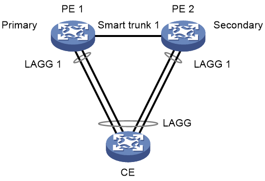

Application scenario
S-Trunk is used in the dual-homing scenario shown in Figure 1 to ensure service continuity upon failure of one PE. S-Trunk virtualizes the PEs into an S-Trunk system. To the CE, the S-Trunk system is one device. A smart trunk is configured on the PEs to aggregate the links between the CE and PEs. When a link or PE fails, its traffic is automatically switched to the other available links or PE.
Figure 1 S-Trunk application scenario

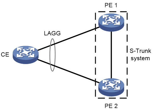

S-Trunk system setup process
As shown in Figure 3, perform the following tasks to configure a smart trunk:
1.     Create a CE-facing aggregate interface and a smart trunk with the same ID on each PE, and assign the aggregate interfaces to the smart trunk.
2.     Configure a link aggregation group on the CE and assign the interfaces connected to the PEs to the link aggregation group.
The PEs set up an S-Trunk system as follows:
3.     PE 1 and PE 2 exchange S-Trunk protocol packets to advertise their S-Trunk configuration. The PEs form an S-Trunk system if the following requirements are met:
¡     They use the same LACP system MAC address and LACP system priority.
¡     They use different LACP system numbers.
¡     The S-Trunk protocol packets are destined for the same UDP port, and the source and destination IP addresses of incoming S-Trunk protocol packets are consistent with those configured on each PE.
¡     The IP addresses used for S-Trunk protocol packet transmission are reachable to each other.
4.     The PEs determine the device roles and interface roles for the smart trunk.
¡     Determining device roles—The PEs compare their role priorities and elect the primary device through S-Trunk protocol packets. As shown in Figure 3, PE 1 is assigned the primary role, and PE 2 is assigned the secondary role.
¡     Determining interface roles—Each PE assigns the primary or secondary role to its smart trunk member interface based on its S-Trunk role and peer status. As shown in Figure 3, interface LAGG 1 on PE 1 is assigned the primary role, and interface LAGG 1 on PE 2 is assigned the secondary role.
5.     The S-Trunk system forwards traffic through the primary S-Trunk member device.
Figure 3 S-Trunk system setup process

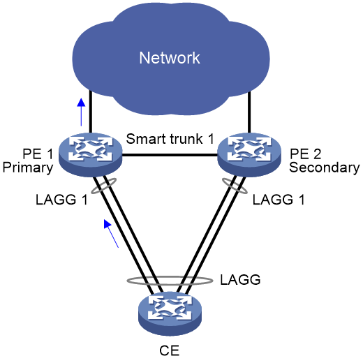

Typical traffic forwarding process
When both S-Trunk member devices are operating correctly, the smart trunk member interface on the primary member device forwards traffic. As shown in Figure 4, interface LAGG 1 on primary member device PE 1 is forwarding the traffic of CE 1. Interface LAGG 1 on PE 2 is the secondary member interface and is placed in down state.
Figure 4 Typical traffic forwarding process

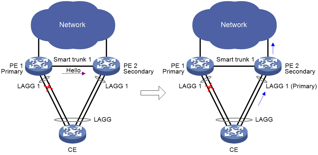

Primary member interface failure handling mechanism
When the primary member interface in a smart trunk fails, the smart trunk forwards traffic through the other member interface.
As shown in Figure 5, when the link between the CE and PE 1 fails, PE 1 notifies PE 2 of the failure of LAGG 1 through S-Trunk hello packets. After receiving the S-Trunk hello packets, PE 2 assigns the primary role to its LAGG 1 and brings the interface up to forward the traffic of the CE.
Figure 5 Primary interface failure handling mechanism

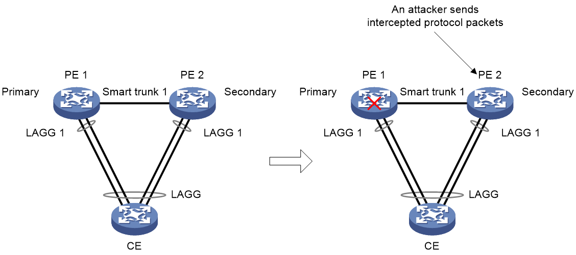

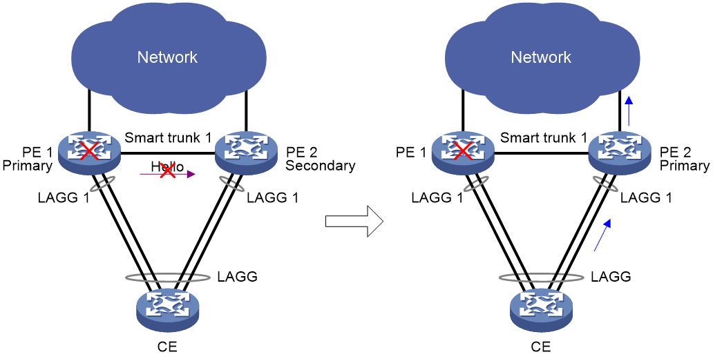

Primary member device failure handling mechanism
When the primary member device fails, the secondary member device takes over the primary role to forward all traffic.
As shown in Figure 6, if PE 1 fails, PE 2 cannot receive S-Trunk hello packets and determines that PE 1 is down upon expiration of the S-Trunk protocol packet timeout. Then, PE 2 becomes the primary member device and brings up LAGG 1 to forward the traffic of the CE.
Figure 6 Primary member device failure handling mechanism

S-Trunk configuration examples

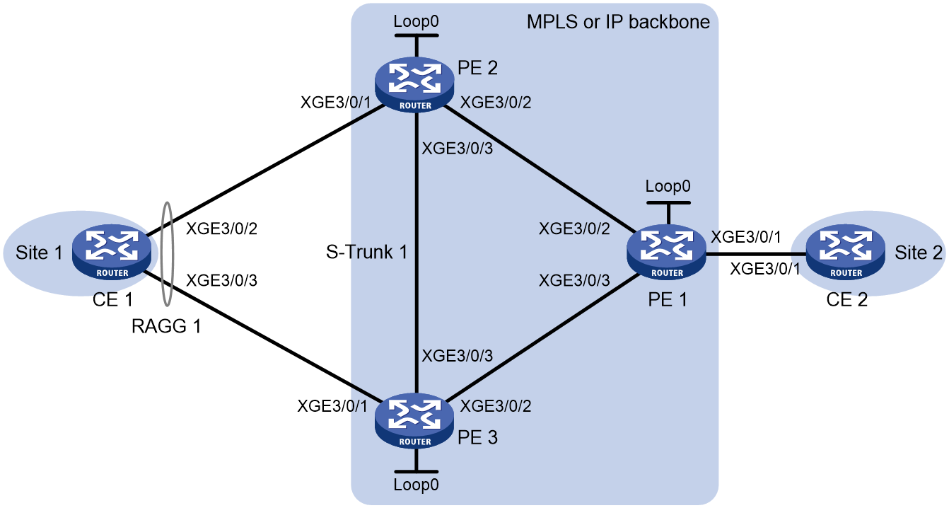

Example: Configuring S-Trunk in an MPLS L2VPN network
As shown in Figure 8:
·     Configure MPLS L2VPN for CE 1 and CE 2 to communicate. CE 1 is dual-homed to PE 2 and PE 3.
·     Configure S-Trunk on PE 2 and PE 3 to establish a multichassis aggregate link with CE 1. Configure PE 2 and PE 3 as the primary and secondary devices, respectively.
Figure 8 Network diagram
Table 1 IP address assignment
Device
Interface
IP address
Device
Interface
IP address
CE 1
RAGG 1
192.1.1.2/24
PE 1
Loop 0
1.1.1.1/32
PE 2
Loop 0
2.2.2.2/32
XGE3/0/2
10.1.1.1/24
XGE3/0/2
10.1.1.2/24
XGE3/0/3
10.1.2.1/24
XGE3/0/3
10.1.3.1/24
CE 2
XGE3/0/1
192.1.1.1/24
PE 3
Loop 0
3.3.3.3/32
XGE3/0/2
10.1.2.2/24
XGE3/0/3
10.1.3.2/24
1.     Assign IP addresses to interfaces as described in Table 1. (Details not shown.)

plit horizon
Total number of PWs: 2
1 up, 1 blocked, 0 down, 0 defect, 0 idle, 0 duplicate
Xconnect-group Name: vpna
Peer            PW ID/Rmt Site    In/Out Label    Proto   Flag  Link ID  State
2.2.2.2         11                65657/1151      LDP     M     0        Up
3.3.3.3         22                65656/1151      LDP     B     0        Blocked
The output shows that the PW to PE 2 is the primary PW and the PW to PE 3 is the backup PW.
# Verify that PE 2 and PE 3 have established two LDP PWs between them.
[PE2] display l2vpn pw
Flags: M - main, B - backup, E - ecmp, BY - bypass, H - hub link, S - spoke link
       N - no split horizon, A - administration, ABY - ac-bypass
       PBY - pw-bypass
Total number of PWs: 3
1 up, 2 blocked, 0 down, 0 defect, 0 idle, 0 duplicate
Xconnect-group Name: 1
Peer            PWID/RmtSite/SrvID In/Out Label   Proto  Flag Link ID  State
3.3.3.3         44                 24125/24127    LDP    ABY  0        Blocked
1.1.1.1         11                 24129/24124    LDP    M    1        Up
3.3.3.3         33                 24128/24128    LDP    PBY  1        Blocked
[PE3] display l2vpn pw
       PBY - pw-bypass
2 up, 1 blocked, 0 down, 0 defect, 0 idle, 0 duplicate
2.2.2.2         33                 24128/24128    LDP    ABY  0        Up
1.1.1.1         22                 24129/24123    LDP    M    1        Up
2.2.2.2         44                 24127/24125    LDP    PBY  1        Blocked
# Verify that the BFD session between PE 2 and PE 3 is up.
[PE2] display bfd session
 Total sessions: 1        Up sessions: 1        Init mode: Active
 IPv4 static session working in control packet mode:
 LD/RD           SourceAddr      DestAddr        State   Holdtime    Interface
 1/2             10.1.3.1        10.1.3.2        Up      1870ms      N/A
[PE3] display bfd session
 2/1             10.1.3.2        10.1.3.1        Up      1947ms      N/A
# Verify that Ten-GigabitEthernet 3/0/2 is a Selected aggregation member port on CE 1.
[CE1] display link-aggregation verbose route-aggregation 1
Loadsharing Type: Shar -- Loadsharing, NonS -- Non-Loadsharing
Port Status: S -- Selected, U -- Unselected, I -- Individual
Port: A -- Auto
Flags:  A -- LACP_Activity, B -- LACP_Timeout, C -- Aggregation,
        G -- Defaulted, H -- Expired
Aggregate Interface: Route-Aggregation1
Aggregation Mode: Dynamic
System ID: 0x8000, 90e7-10f9-5000
Local:
  Port                Status   Priority Index    Oper-Key               Flag
  XGE3/0/2            S        32768    1        1                      {ACDEF}
  XGE3/0/3            U        32768    2        1                      {ACD}
Remote:
  Actor               Priority Index    Oper-Key SystemID               Flag
  XGE3/0/2            32768    16385    24577    0xa   , 0001-0001-0001 {ACDEF}
  XGE3/0/3            32768    32769    24577    0xa   , 0001-0001-0001 {AC}
# Verify that PE 2 and PE 3 are the primary and secondary S-Trunk member devices, respectively.
[PE2] display s-trunk verbose 1
                            Trunk-wide info and statistics
S-Trunk ID: 1
Revert: Enabled                       Revert-delay(s): 120
Local bridge MAC: 00fc-3423-d800      Peer bridge MAC: 84d9-3125-7800
Local priority: 32768                 Peer priority: 32768
DevRole (Trigger): Primary (PRIORITY)
DestIP: 10.1.3.2
SrcIP: 10.1.3.1
Local hello interval(100ms): 100      Local hello timeout(100ms): 2000
InStrunkPDUs: 16571                   OutStrunkPDUs: 16603
InDrops: 0                            OutDrops: 36
Peer hello interval(100ms): 100       Peer hello timeout(100ms): 2000
Sequence number check: Disabled
BFD-Session: bfd1
VPN instance: -
Description: -
                            Trunk member info
Local    LinkState   ConfigRole    OperRole (Trigger)            Peer
RAGG1    UP          auto          Primary (PEER_MEMBER_DOWN)    RAGG1
[PE3] display s-trunk verbose 1
S-Trunk ID: 1
Local bridge MAC: 84d9-3125-7800      Peer bridge MAC: 00fc-3423-d800
DevRole (Trigger): Secondary (PRIORITY)
DestIP: 10.1.3.1
SrcIP: 10.1.3.2
InStrunkPDUs: 16580                   OutStrunkPDUs: 16621
InDrops: 0                            OutDrops: 37
BFD-Session: bfd1
VPN instance: -
Description: -
                            Trunk member info
RAGG1    DOWN        auto          Secondary (PEER_MEMBER_UP)    RAGG1
